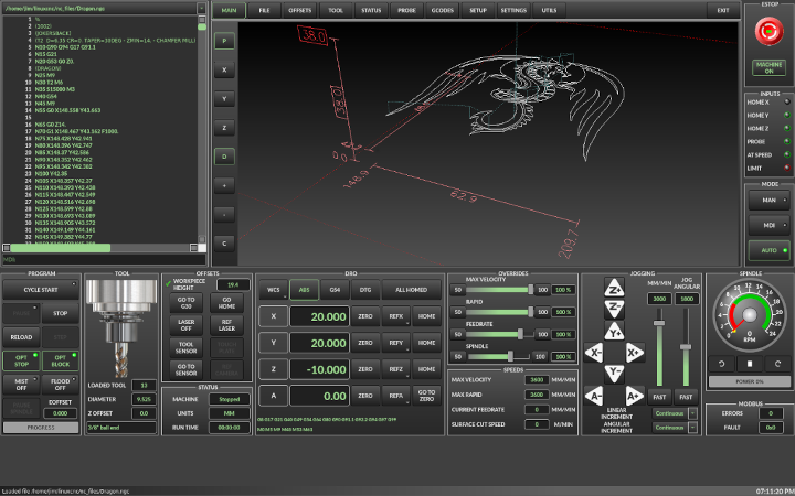

1. Introducción
QtDragon and QtDragon_hd are built with the QtVCP framework. It is the creative vision of forum personality Persei8. Much of it is based on the excellent work of others in the LinuxCNC community. LinuxCNC’s version is adapted from Persei8’s Github versions. It is primarily meant for 3-5 axes machines such as mills or routers. It works well with a touchscreen and/or mouse. QtDragon supports multiple ways to touch off tools and probing work pieces. You can use LinuxCNC’s external offsets capability to automatically raise the spindle during a pause. If you the VersaProbe option and remap code you can add auto tool length probing at tool changes.
Nota
QtDragon and QtVCP are relatively new programs added into LinuxCNC. Bugs and oddities are possible. Please test carefully when using a dangerous machine. Please forward reports to the forum or maillist.

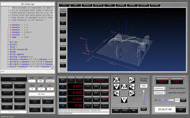

1.1. QtDragon
QtDragon Router
Figura 1. QtDragon - 3 to 5 axis sample (1440x860) in silver theme
QtDragon is resizable from a resolution of 1280x768 to 1680x1200. It will work in window mode on any monitor with higher resolution but not on monitors with lower resolution.

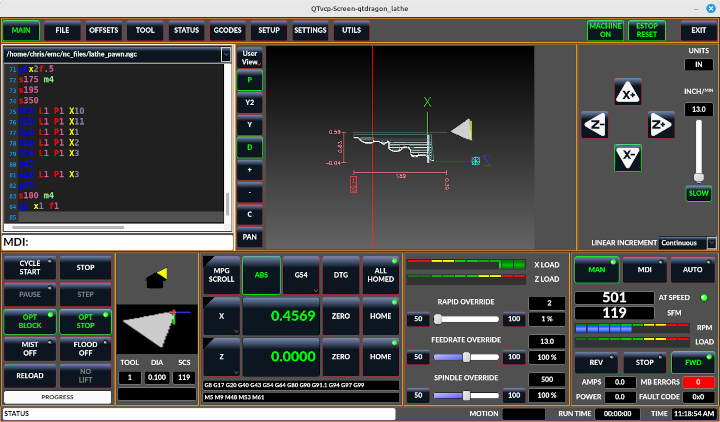

1.2. QtDragon_lathe
QtDragon Lathe
QtDragon_lathe is a modified version of QtDragon more suitable for lathes.
It is resizable from a resolution of 1280x768 to 1680x1200.

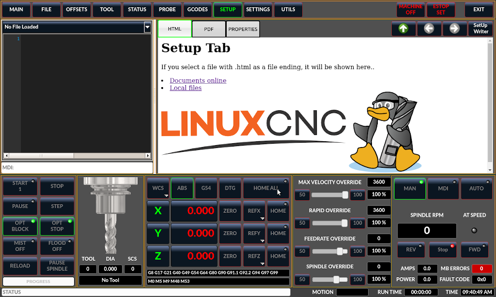

1.3. QtDragon_hd
QtDragon_hd
Figura 2. QtDragon_hd - 3 to 5 axis sample for larger monitors (1920x1056) in dark theme
QtDragon_hd is a similar design as QtDragon but modified to utilize the extra space of modern larger monitors. There are some small differences in layout and utility.
QtDragon_hd has a resolution of 1920x1056 and is not resizeable. It will work in window mode on any monitor with higher resolution but not on monitors with lower resolution.

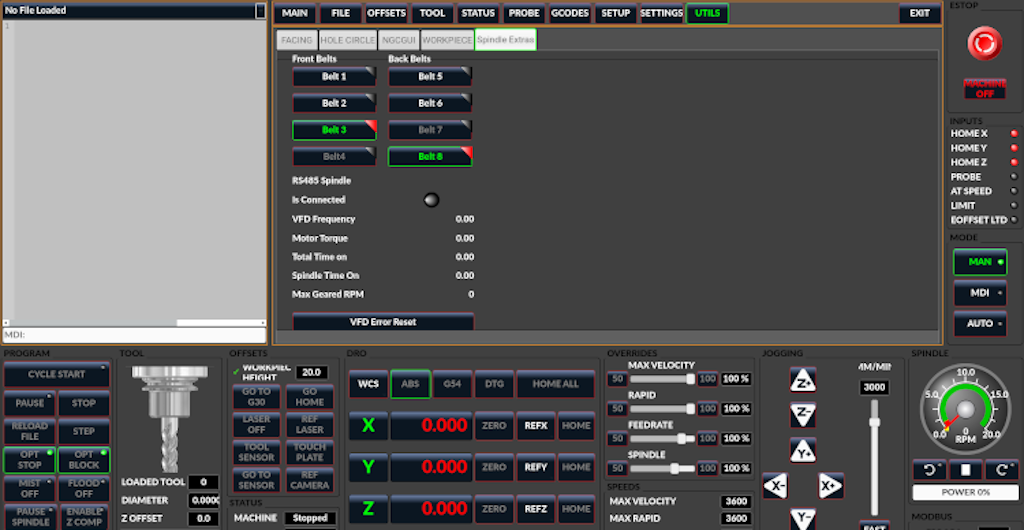

2.10.2. Embedding Spindle Belts Panel
This example panel is designed to display additional RS485 VFD data and also to configure a 4 sheave, 2 belt spindle drive via a series of buttons.
QtDragon spindle_belts Panel - Spindle Belts VCP
[DISPLAY]
EMBED_TAB_NAME = Spindle Belts
EMBED_TAB_COMMAND = qtvcp spindle_belts
EMBED_TAB_LOCATION = tabWidget_utilities

11.1. Using G-code Ripper for Z level Compensation
QtDragon G-code Ripper
Figura 3. QtDragon_hd showing G-code Ripper
Nota
G-code Ripper offers many functions that we will not go in to here. This is only available in the QtDragon_hd version.
  • In qtdragon_hd, switch to the file tab and press the load G-code Ripper button.
  • Set origin to match the origin of the G-code file to be probed.
  • Under G-Code Operations, check Auto Probe.
  • File -> Open G-Code File (The file you will run after compensation)
  • If necessary, make adjustments and press Recalculate.
  • Press Save G-Code File - Probe Only.
  • Save the generated file to the nc_files folder.
  • Exit gcode_ripper.
  • Without changing the offsets, run this program. Make sure the probe tool is installed. When complete, there will be a file in the config directory called probe_points.txt.
  • In qtdragon_hd, press the Enable Z Comp button to enable compensation. Look at the status line for indication of success or failure. Active compensation will be displayed beside the label: Z Level Comp While jogging that display should change based on the compensation component.

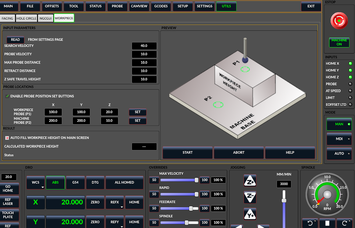

12. Probing
The probe screen has been through basic testing but there could still be some minor bugs. When running probing routines, use extreme caution until you are familiar with how everything works. Probe routines run without blocking the main GUI. This gives the operator the opportunity to watch the DROs and stop the routine at any time.
Nota
Probing is very unforgiving to mistakes; be sure to check settings before using.
QtDragon has 2 methods for setting Z0. The first is a touchplate, where a metal plate of known thickness is placed on top of the workpiece, then the tool is lowered until it touches the plate, triggering the probe signal. The current user system’s (G5x) Z0 is set to probe height - the entered plate thickness.
The second method uses a tool setter in a fixed position and a known height above the table where the probe signal will be triggered. In order to set Z0 to the top of the workpiece, it has to know
  1. how far above the table the probe trigger point is (tool setter height) and
  2. how far above the table the top of the workpiece is.
This operation has to be done every time the tool is changed as the tool length is not saved.

14.4. Work Piece Height Probing in QtDragon_hd
The [TOOL_CHANGE] Z position should be high enough so the tool will not hit the tool probe when moving to the [VERSA_TOOLSETTER] X and Y position. MAXPROBE distance needs to be high enough for the tool to touch the probe.
14.5. Work Piece Height Probing
QtDragon_hd height probing
Figura 8. QtDragon_hd - Work piece Height probing
This program probes 2 user specified locations in the Z axis and calculates the difference in heights.
Nota
Enable Probe Position Set Buttons
  • When checked, the SET buttons are enabled.
  • This allows the user to automatically fill in the X, Y and Z parameters with the current position as displayed on the DROs.
Autofill Workpiece Height on Main Screen
  • When checked, the calculated height is automatically transferred to the Workpiece Height field in the main screen.
  • Otherwise, the main screen is not affected.
Workpiece Probe At
  • the X, Y and Z coordinates specify where the first probing routine should start, in current WCS
Machine Probe At
  • the X, Y and Z coordinates specify where the second probing routine should start, in current WCS
Z Safe Travel Height
  • The machine is raised to the Z safe travel height before jogging to the X and Y coordinates.
  • El husillo entonces baja a la coordenada Z especificada.
  • It should be selected so that the tool clears all obstructions while jogging.
START button
  • The machine will jog to the first location and then probe down.
  • The machine then jogs to the second location and probes down again.
  • The difference in probed values is reported as Calculated Workpiece Height.
  • The parameters for search velocity, probe velocity, maximum probe distance and return distance are read from the main GUI Settings page.

  • causes all jog and probe routines currently executing to stop.
HELP button
  • displays this help file.
  • Any 2 points within the machine operating volume can be specified.
  • If the first point is higher than the second, the calculated height will be a positive number.
  • If the first point is lower than the second, the calculated height will be a negative number.
  • Units are irrelevant in this program. The probed values are not saved and only the difference is reported.
Atención
Setting incorrect values can lead to crashes into fixtures on the machine work surface. Initial testing with no tool and safe heights is recommended.

17.1. Main tab
This tab displays the graphical representation of the current program. The side buttons will control the display.
  • User View: Select/restore a user set view of the current program.
  • P,X,Y,Z: Set standard views.
  • D: Toggle display of dimensions.
  • +, -: Zoom controls.
  • C: Clear graphics of tool movement lines.
In qtdragon_hd there are also macro buttons available on the right side. Up to tens buttons can be defined in the INI.

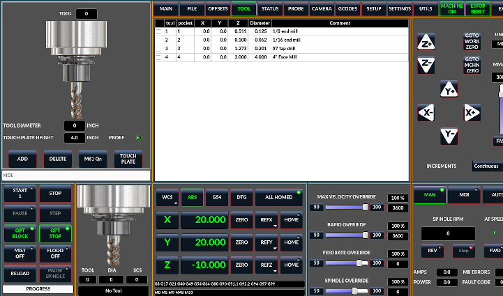

You can monitor/modify tool offsets from this tab. Adding and deleting tools from the tool file can also be done from this tab. When this tab is selected the individual home buttons in the DRO area will change to tool offset setting buttons. They will return to home buttons when you select another tab. Pressing this tool button will drop down a when menu of options:
  • Set Current Tool Position
  • Adjust Current Tool Position
  • Zero Current Tool Position
  • Set Tool Offset Directly
  • Reset To Last

17.9. Setup Tab
It’s possible to load HTML or PDF file (.html / .pdf ending) with setup notes, and will be displayed in the setup tab.
If you load a G-code program and there is an HTML/PDF file of the same name, it will load automatically.
Some program, such as Fusion 360 and Aspire will create these files for you. You can also write your own HTML docs with the included SetUp Writer button.
There are three sub tabs:
  • HTML - any loaded HTML pages are displayed here. The navigation buttons work on this page.
  • PDF - any loaded PDF setup pages are displayed here.
  • PROPERTIES - when a program is loaded its G-code properties are displayed here.
Hay botones de navegación para la página HTML:
  • The up arrow returns you to the default HTML page.
  • The left arrow moves backward one HTML page.
  • The right arrow moves forward one HTML page.
If you wish to include a custom default HTML page, name it default_setup.html and place it in your configuration folder.
Custom QtVCP panels can be displayed in this tab by setting the EMBED_TAB_LOCATION option to tabWidget_setup.
QtDragon Setup Tab
Figura 9. QtDragon - Setup Tab Sample

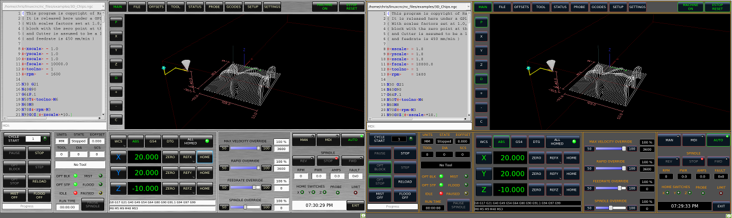

18. Styles
Nearly all aspects of the GUI appearance are configurable via the QtDragon.qss stylesheet file. The file can be edited manually or through the stylesheet dialog widget in the GUI. To call up the dialog, press F12 on the main window. New styles can be applied temporarily and then saved to a new qss file, or overwrite the current qss file.
QtDragon styles
Figura 10. QtDragon - Two Style Examples

Some widget customization is available for basic probe and versa probe.
QtDragon customized
Figura 11. QtDragon - Customized QtDragon
