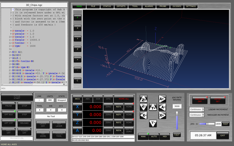

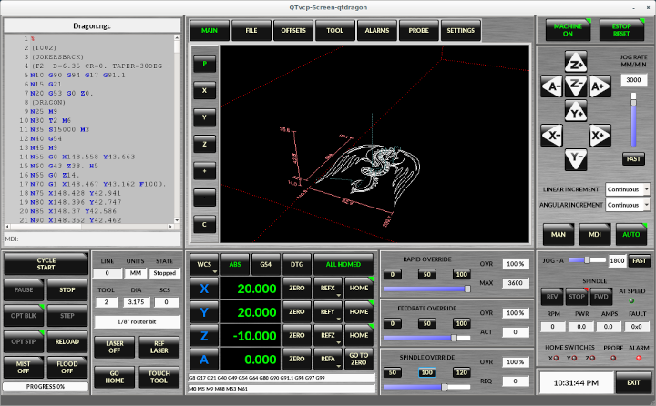

1.1. QtDragon
QtDragon Router
Figure 1. QtDragon - 3 to 5 axis sample (1440x860) in silver theme
QtDragon is resizable from a resolution of 1280x768 to 1680x1200. It will work in window mode on any monitor with higher resolution but not on monitors with lower resolution.

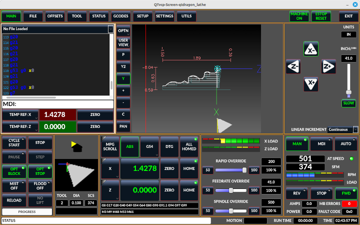

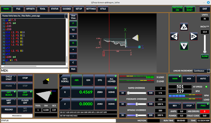

1.2. QtDragon_lathe
QtDragon Lathe
QtDragon_lathe is a modified version of QtDragon more suitable for lathes.
It is resizable from a resolution of 1280x768 to 1680x1200.

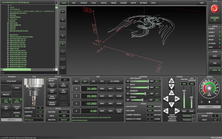

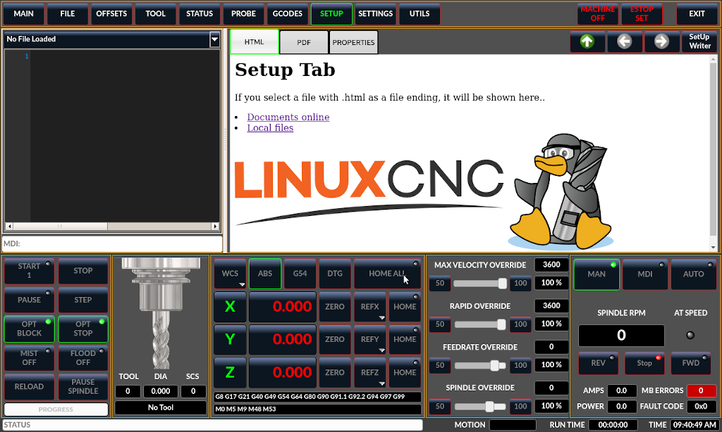

1.3. QtDragon_hd
QtDragon_hd
Figure 2. QtDragon_hd - 3 to 5 axis sample for larger monitors (1920x1056) in dark theme
QtDragon_hd is a similar design as QtDragon but modified to utilize the extra space of modern larger monitors. There are some small differences in layout and utility.
QtDragon_hd has a resolution of 1920x1056 and is not resizeable. It will work in window mode on any monitor with higher resolution but not on monitors with lower resolution.

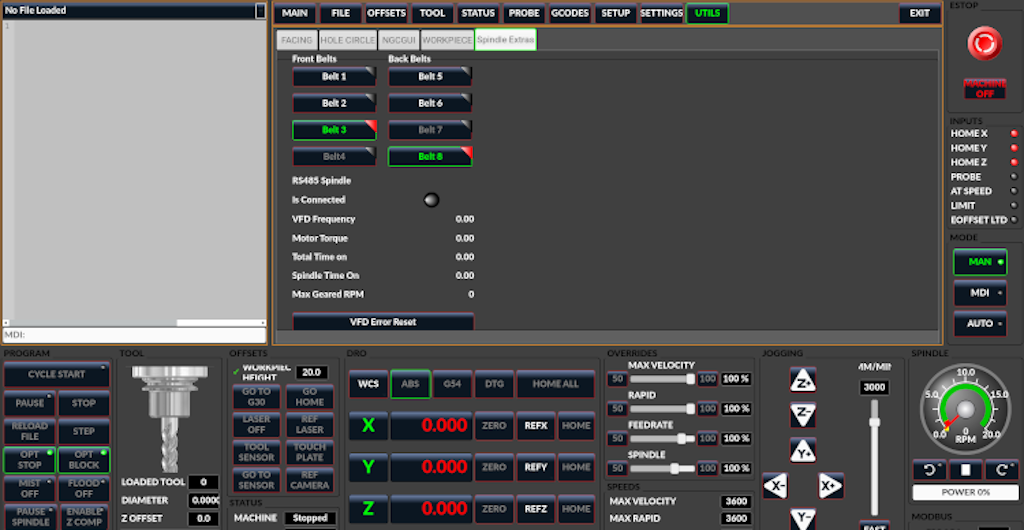

2.10.2. Embedding Spindle Belts Panel
This example panel is designed to display additional RS485 VFD data and also to configure a 4 sheave, 2 belt spindle drive via a series of buttons.
QtDragon spindle_belts Panel - Spindle Belts VCP
[DISPLAY]
EMBED_TAB_NAME = Spindle Belts
EMBED_TAB_COMMAND = qtvcp spindle_belts
EMBED_TAB_LOCATION = tabWidget_utilities

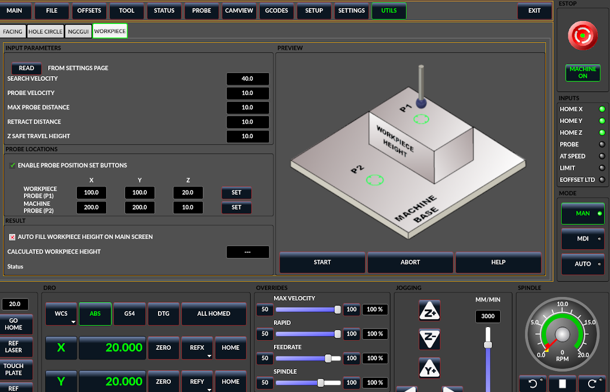

2.14. Probe/Touchplate/Laser Settings
QtDragon has INI entries for two optional probing tab screens available. Comment/uncomment which ever you prefer.
  • Versa probe is a QtVCP ported version of a popular GladeVCP probing panel.
  • Basic Probe is a QtVCP ported version based on the third party basic probe screen.
Both perform similar probing routines, though Versa probe optionally handles auto tool measurement.
[PROBE]
#USE_PROBE = versaprobe
USE_PROBE = basicprobe

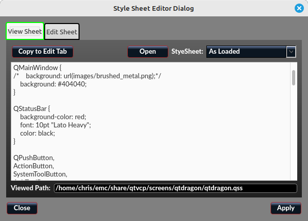

F1 - Estop on/off
F2 - Machine on/off
F12 - Style Editor

14.5. Work Piece Height Probing
QtDragon_hd height probing
Figure 8. QtDragon_hd - Work piece Height probing
This program probes 2 user specified locations in the Z axis and calculates the difference in heights.
Note
This is only available in the QtDragon_hd version.
Enable Probe Position Set Buttons
  • When checked, the SET buttons are enabled.
  • This allows the user to automatically fill in the X, Y and Z parameters with the current position as displayed on the DROs.
Autofill Workpiece Height on Main Screen
  • When checked, the calculated height is automatically transferred to the Workpiece Height field in the main screen.
  • Otherwise, the main screen is not affected.
Workpiece Probe At
  • the X, Y and Z coordinates specify where the first probing routine should start, in current WCS
Machine Probe At
  • the X, Y and Z coordinates specify where the second probing routine should start, in current WCS
Z Safe Travel Height
  • The machine is raised to the Z safe travel height before jogging to the X and Y coordinates.
  • The spindle then lowers to the specified Z coordinate.
  • It should be selected so that the tool clears all obstructions while jogging.
START button
  • The machine will jog to the first location and then probe down.
  • The machine then jogs to the second location and probes down again.
  • The difference in probed values is reported as Calculated Workpiece Height.
  • The parameters for search velocity, probe velocity, maximum probe distance and return distance are read from the main GUI Settings page.
ABORT button
  • causes all jog and probe routines currently executing to stop.
HELP button
  • displays this help file.
Note
  • Any 2 points within the machine operating volume can be specified.
  • If the first point is higher than the second, the calculated height will be a positive number.
  • If the first point is lower than the second, the calculated height will be a negative number.
  • Units are irrelevant in this program. The probed values are not saved and only the difference is reported.
Caution
Setting incorrect values can lead to crashes into fixtures on the machine work surface. Initial testing with no tool and safe heights is recommended.

17.1. Main tab
This tab displays the graphical representation of the current program. The side buttons will control the display.
  • User View: Select/restore a user set view of the current program.
  • P,X,Y,Z: Set standard views.
  • D: Toggle display of dimensions.
  • +, -: Zoom controls.
  • C: Clear graphics of tool movement lines.
In qtdragon_hd there are also macro buttons available on the right side. Up to tens buttons can be defined in the INI.

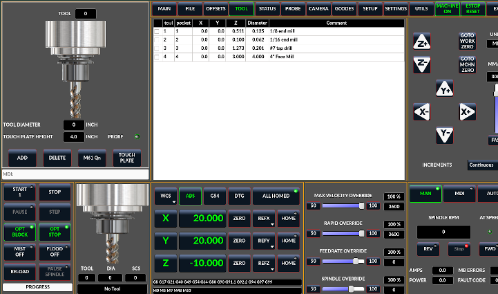

17.3. Offsets Tab
You can monitor/modify system offsets from this tab. There are convenience buttons for zeroing the rotation.G92 and current G5x user offset.
17.4. Tool Tab
You can monitor/modify tool offsets from this tab. Adding and deleting tools from the tool file can also be done from this tab. When this tab is selected the individual home buttons in the DRO area will change to tool offset setting buttons. They will return to home buttons when you select another tab. Pressing this tool button will drop down a when menu of options:

17.9. Setup Tab
It’s possible to load HTML or PDF file (.html / .pdf ending) with setup notes, and will be displayed in the setup tab.
If you load a G-code program and there is an HTML/PDF file of the same name, it will load automatically.
Some program, such as Fusion 360 and Aspire will create these files for you. You can also write your own HTML docs with the included SetUp Writer button.
There are three sub tabs:
  • HTML - any loaded HTML pages are displayed here. The navigation buttons work on this page.
  • PDF - any loaded PDF setup pages are displayed here.
  • PROPERTIES - when a program is loaded its G-code properties are displayed here.
There are navigation buttons for HTML page:
  • The up arrow returns you to the default HTML page.
  • The left arrow moves backward one HTML page.
  • The right arrow moves forward one HTML page.
If you wish to include a custom default HTML page, name it default_setup.html and place it in your configuration folder.
Custom QtVCP panels can be displayed in this tab by setting the EMBED_TAB_LOCATION option to tabWidget_setup.
QtDragon Setup Tab
Figure 9. QtDragon - Setup Tab Sample

21.1. Stylesheets
Stylesheets can be leveraged to do a fair amount of customization, but you usually need to know a bit about the widget names. Pressing F12 will display a stylesheet editor dialog to load/test/save modification.
The View Sheet tab will allow you to select and apply what stylesheet QtDragon will use when it’s first loaded.
Press the button Copy to Edit Tab to copy the current stylesheet to the edit tab.
The Edit Sheet tab allows editing, applying and saving of changes od the displayed stylesheet.
QtDragon stylesheet editor
Sometimes these lines will be present and you can change them, otherwise you will need to add them.
For instance, to change the DRO font (look for this entry and change the font name):

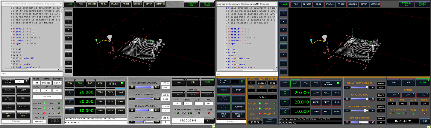

21.2. Qt Designer and Python code
All aspects of the GUI are fully customization through Qt Designer and/or Python code.
This capability is included with the QtVCP development environment.
The extensive use of QtVCP widgets keeps the amount of required Python code to a minimum, allowing relatively easy modifications.
The LinuxCNC website has extensive documentation on the installation and use of QtVCP libraries.
See QtVCP for more information about QtVCP in general.
Custom modifications can be added by subclassing the handler file. This adds code on top of the original.
QtDragon can also utilize QtVCP’s rc file to do minor python code modifications without using a custom handler file.
See Modifying Screens for more information about customization.
Some widget customization is available for basic probe and versa probe.
QtDragon customized
Figure 11. QtDragon - Customized QtDragon
