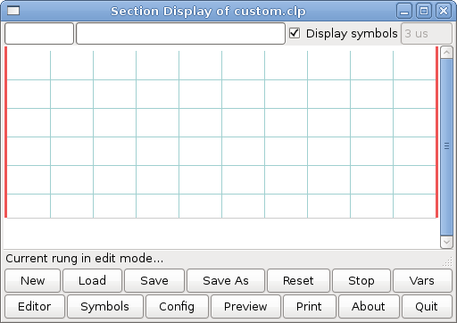

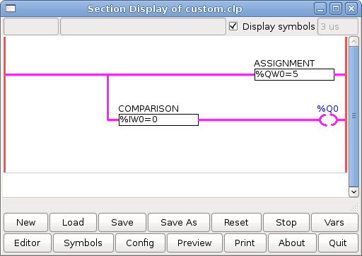

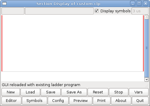

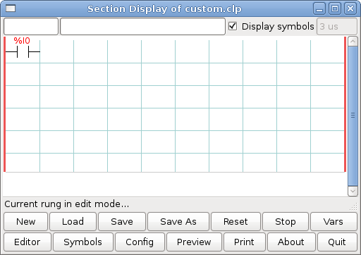

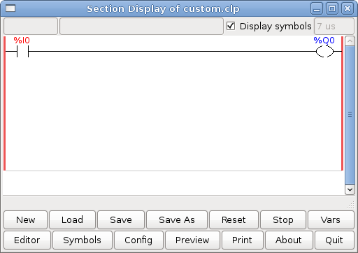

5.2. Section Display
When you first start up ClassicLadder you get an empty Section Display window. Displayed is one empty rung.
Section Display Default Window
Figure 2. Section Display Default Window
Most of the buttons are self explanatory:
The Vars button is for looking at variables, toggle it to display one, the other, both, then none of the windows.
The Config button is used for modbus and shows the max number of ladder elements that was loaded with the real time module.
The Symbols button will display an editable list of symbols for the variables (hint you can name the inputs, outputs, coils etc).
The Quit button will shut down the non-realtime program, i.e. Modbus and the display. The realtime ladder program will still run in the background.
The check box at the top right allows you to select whether variable names or symbol names are displayed
You might notice that there is a line under the ladder program display that reads "Project failed to load…​". That is the status bar that gives you info about elements of the ladder program that you click on in the display window. This status line will now display HAL signal names for variables %I, %Q and the first %W (in an equation). You might see some funny labels, such as (103) in the rungs. This is displayed (on purpose) because of an old bug- when erasing elements older versions sometimes didn’t erase the object with the right code. You might have noticed that the long horizontal connection button sometimes did not work in the older versions. This was because it looked for the free code but found something else. The number in the brackets is the unrecognized code. The ladder program will still work properly, to fix it erase the codes with the editor and save the program.

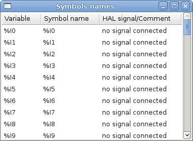

5.4. Symbol Window
Symbol Names window
Figure 5. Symbol Names window
This is a list of symbol names to use instead of variable names to be displayed in the section window when the display symbols check box is checked. You add the variable name (remember the % symbol and capital letters), symbol name. If the variable can have a HAL signal connected to it (%I, %Q, and %W-if you have loaded s32 pin with the real time module) then the comment section will show the current HAL signal name or lack thereof. Symbol names should be kept short to display better. Keep in mind that you can display the longer HAL signal names of %I, %Q and %W variable by clicking on them in the section window. Between the two, one should be able to keep track of what the ladder program is connected to!

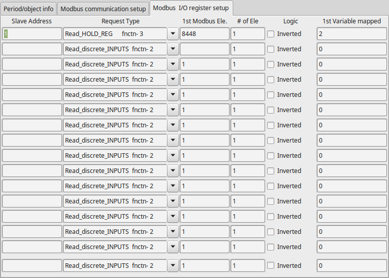

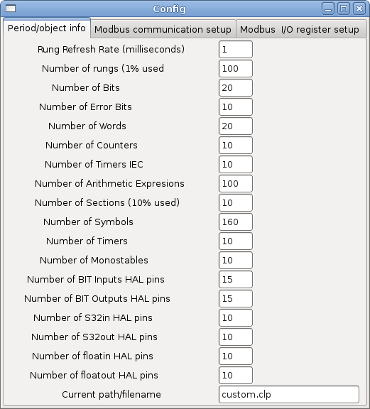

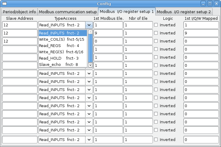

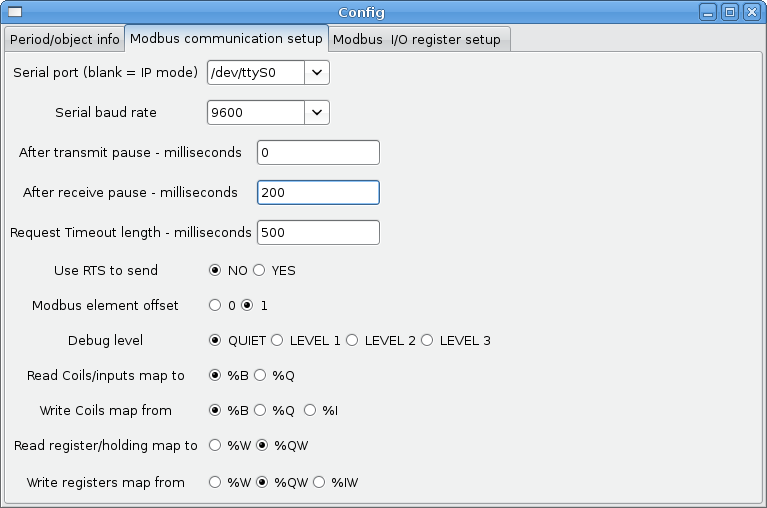

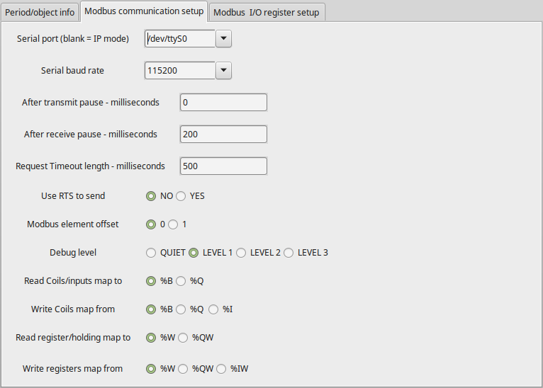

5.6. Config Window
The config window shows the current project status and has the Modbus setup tabs.
Config Window
Figure 7. Config Window

The following figure shows an Assignment and a Comparison Example. %QW0 is a S32out bit and %IW0 is a S32in bit. In this case the HAL pin classicladder.0.s32out-00 will be set to a value of 5 and when the HAL pin classicladder.0.s32in-00 is 0 the HAL pin classicladder.0.out-00 will be set to True.
Assign/Compare Example
Figure 8. Assign/Compare Ladder Example
Assignment Expression
Figure 9. Assignment Expression Example
Comparison Expression
Figure 10. Comparison Expression Example

  • SERIAL PORT - For IP blank. For serial the location/name of serial driver, e.g., /dev/ttyS0 ( or /dev/ttyUSB0 for a USB-to-serial converter).
  • SERIAL SPEED - Should be set to speed the slave is set for - 300, 600, 1200, 2400, 4800, 9600, 19200, 38400, 57600, 115200 are supported.
  • PAUSE AFTER TRANSMIT - Pause (milliseconds) after transmit and before receiving answer, some devices need more time (e.g., USB-to-serial converters).
  • PAUSE INTER-FRAME - Pause (milliseconds) after receiving answer from slave. This sets the duty cycle of requests (it’s a pause for EACH request).
  • REQUEST TIMEOUT LENGTH - Length (milliseconds) of time before we decide that the slave didn’t answer.
  • MODBUS ELEMENT OFFSET - used to offset the element numbers by 1 (for manufacturers numbering differences).
  • DEBUG LEVEL - Set this to 0-3 (0 to stop printing debug info besides no-response errors).
  • READ COILS/INPUTS MAP TO - Select what variables that read coils/inputs will update. (B or Q).

  • 1st%I%Q IQ WQ MAPPED - This is the starting number of %B, %I, %Q, %W, %IW, or %QW variables that are mapped onto/from the modbus element group (starting at the first modbus element number).
In the example above: Port number - for my computer /dev/ttyS0 was my serial port.
The serial speed is set to 9600 baud.
Slave address is set to 12 (on my VFD I can set this from 1-31, meaning I can talk to 31 VFDs maximum on one system).
The first line is set up for 8 input bits starting at the first register number (register 1). So register numbers 1-8 are mapped onto ClassicLadder’s %B variables starting at %B1 and ending at %B8.
The second line is set for 2 output bits starting at the ninth register number (register 9) so register numbers 9-10 are mapped onto ClassicLadder’s %Q variables starting at %Q9 ending at %Q10.
The third line is set to write 2 registers (16 bits each) starting at the 0th register number (register 0), so register numbers 0-1 are mapped onto ClassicLadder’s %W variables starting at %W0 ending at %W1.
It’s easy to make an off-by-one error as sometimes the modbus elements are referenced starting at one rather then 0 (actually by the standard that is the way it’s supposed to be!). You can use the modbus element offset radio button to help with this.
The documents for your modbus slave device will tell you how the registers are set up- there is no standard way.

Config I/O Register Setting
Figure 14. Modbus I/O Register Setup

Communication Setting
Figure 15. Modbus Communication Setup

Lets look at an example of reading one hold register at 8448 Decimal (0x2100 Hex).
Looking in the Modbus protocol reference:
Table 2. Read holding register request
Name number of bytes Value (hex)
Function code
(1 Byte)
3 (0x03)
Starting Address
(2 Bytes)
0 - 65535 (0x0000 to 0xFFFF)
Number of Registers
(2 Bytes)
1 to 125 (0x7D)
Checksum
(2 bytes)
Calculated automatically
Here is an example sent command as printed in the terminal (all Hex):
INFO CLASSICLADDER-   Modbus I/O module to send: Lgt=8 <-  Slave address-1  Function code-3  Data-21 0 0 1 8E 36
Meaning (Hex):
  • Lgt = 8 = message is 8 bytes long including slave number and checksum number
  • Slave number = 1 (0x1) = Slave address 1
  • Function code = 3 (0x3) = read holding register
  • Start at address = highbyte 33 (0x21) lowbyte 0 (0x00) = combined address = 8448 (0x2100)
  • Number of Registers = 1 (0x1) = return 1 2-byte register (holding and reading registers are always 2 bytes wide)
  • Checksum = high byte 0x8E lowbyte 0x36 = (0x8E36)

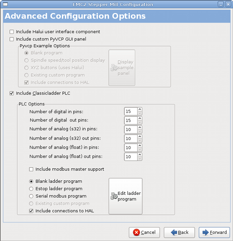

In this section we will cover the steps needed to add ClassicLadder to a StepConf Wizard generated config. On the advanced Configuration Options page of StepConf Wizard check off "Include ClassicLadder PLC".
Stepconf ClassicLadder

Now start up your config and select "File/Ladder Editor" to open up the ClassicLadder GUI. You should see a blank Section Display and Sections Manager window as shown above. In the Section Display window open the Editor. In the Editor window select Modify. Now a Properties window pops up and the Section Display shows a grid. The grid is one rung of ladder. The rung can contain branches. A simple rung has one input, a connector line and one output. A rung can have up to six horizontal branches. While it is possible to have more than one circuit in a run the results are not predictable.
Section Display with Grid

Now click in the upper left grid to place the N.O. Input into the ladder.
Section Display with Input
Figure 19. Section Display with Input

Now click on the OK button in the Editor window. Now your Section Display should look like this:
Section Display Finished
Figure 21. Section Display Finished

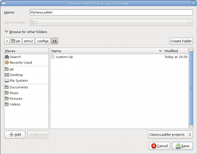

To save the new file select Save As and give it a name. The .clp extension will be added automatically. It should default to the running config directory as the place to save it.
Save As Dialog
Figure 22. Save As Dialog
