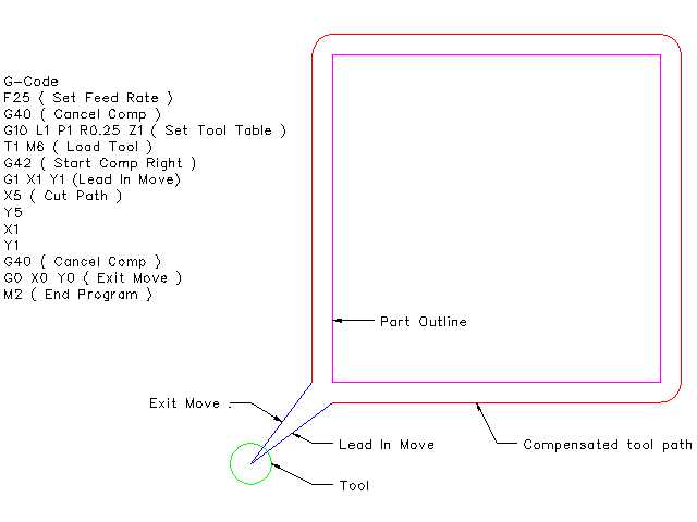

Start a program with G40 to make sure compensation is off.
4.2. Examples
4.2.1. Outside Profile Example
Outside Profile
Figure 4. Outside Profile

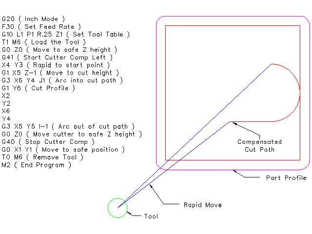

4.2.2. Inside Profile Example
Inside Profile
Figure 5. Inside Profile
