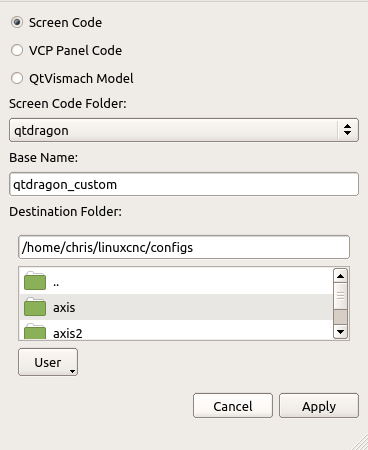

1.1. copy
Used for copying QtVCP’s builtin Screens/VCP Panels/QtVismach code to a folder so one can customize it.
In a terminal run:
qtvcp copy
QtVCP copy Dialog - Screen, Panel or Vismach Code Copy Panel
Figure 1. QtVCP copy Dialog - Screen, VCP Panel or QtVismach Code Copy Panel

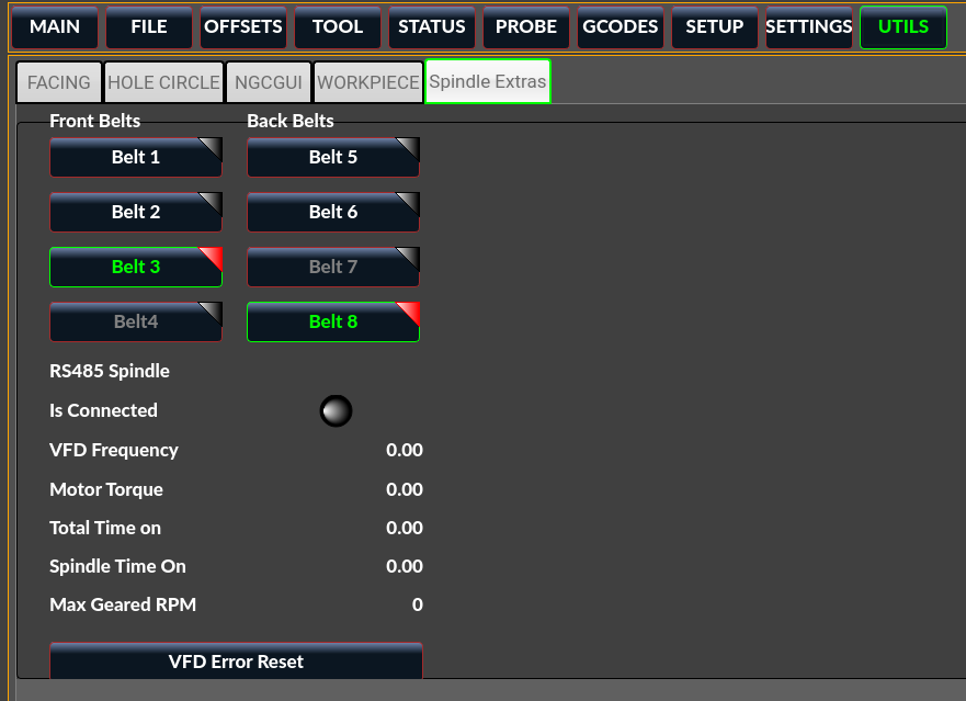

1.2. spindle_belts
This panel is designed to display additional RS485 VFD data and also to configure a 4 sheave, 2 belt spindle drive via a series of buttons.
QtVCP spindle_belts Panel - Spindle Belts VCP
In addition, it is also a useful template to use for your custom panel because it includes:
  • Display of additional HAL data
  • Buttons and button groups
  • Dynamic changes to button enabled/disabled state based on the state of other buttons
  • Saving data to the qtdragon.prefs file
  • Custom button to reset the VFD
Modify this panel to suit your own requirements. Most common features are used. The advantage of using panels is that it separates your custom display code from the qtdragon core code so upgrading the system will not break your customization.
1.2.1. Additional Requirements
  • A spindle drive (for instance VFDMOD)
  • A custom component that scales the VFD frequency to obtain the desired spindle speed.
  • A belt driven spindle that uses two belts and an intermediate idler pulley much like a drill press.
  • Connect the input pins qtdragon.belts.<pin-name> in your postgui HAL file.
1.2.2. Function
The belts are broken into two button groups, the front belts and the rear belts. These are numbered as per the plate on the machine. Buttons in a group are mutually exclusive, i.e., only one can be selected in the group.
Additionally, it’s not possible to have both belts on the same level with this kind of mechanism because you cannot fit two belts to the one idler pulley sheave. So if a belt is selected, its opposite button is disabled. E.g., if belt 3 is selected, belt 7 is disabled.
1.2.3. Embedding commands
Add these lines to the [DISPLAY] section in your .ini file
The example tab_location is for the QtDragon screen.
EMBED_TAB_NAME=Spindle Extras
EMBED_TAB_COMMAND=qtvcp spindle_belts
EMBED_TAB_LOCATION=tabWidget_utilities
Here is how to load spindle_belt from a HAL script:
loadusr qtvcp spindle_belts
1.2.4. Customization Hints
Customizing the panel:
  • Copy the files located in /user/share/qtvcp/qtdragon/panels/belts to: ~/linuxcnc/configs/<my_configuration_folder>/qtvcp/panels/belts (you can use the copy dialog panel to do this)
  • Edit belts.ui with designer.
  • Edit belts_handler.py with a text editor
  • Connect the relevant pins in a postgui.hal file
  • Make sure your postgui file is loaded by your .ini file.
For information on the finer points, consult the QtVCP and QtDragon documentation. The Python handler file also provides a useful template for any custom panel.

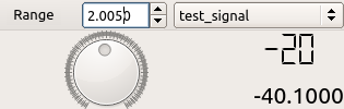

1.3. test_dial
  • This panel has a dial that adjusts S32 and Float HAL output pins.
  • The dial’s range can be adjusted from a drop down menu.
  • The output can be scaled with the spinbox.
  • A combobox can be used to automatically select and connect to a signal.
loadusr qtvcp test_dial
QtVCP test_dial Panel - Test Dial VCP
Figure 2. QtVCP test_dial Panel - Test Dial VCP

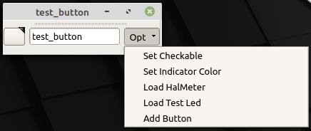

1.4. test_button
  • This panel has a button that will set a HAL pin.
  • The button can be selected as a momentary or a toggle button.
  • A HAL pin will be created that follows the button state.
  • The button’s indicator color can be adjusted from a drop down menu.
  • A HAL pin or signal can be selected to follow the button state.
  • You can add more buttons from the drop down menu.
  • You can load a Halmeter from the drop down menu.
  • You can load a test LED from the drop down menu.
  • The button can be detached from the main windows.
Here is how to load test_button from a HAL script:
loadusr qtvcp test_button
loadusr qtvcp -o 4 test_button
The -o switch sets how many buttons the panel starts with.
If loading directly from a terminal omit the loadusr.
QtVCP test_button - Test Button VCP
Figure 3. QtVCP test_button - Test Button VCP

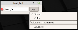

1.5. test_led
  • This panel has an LED that can selected to watch HAL bit pins/signals.
  • The LED’s color can be adjusted from a drop down menu.
  • The text box and state can be output as speech if sound is selected.
  • A combobox can be used to automatically select and connect to a pin/signal.
  • You can add more LEDs from the drop down menu.
  • The LED can be detached from the main windows.
Here is how to load test_led from a HAL script:
loadusr qtvcp test_led
loadusr qtvcp -o 4 test_led
The -o switch sets how many LEDs the panel starts with.

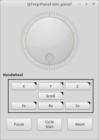

1.8. sim_panel
Small control panel to simulate MPG jogging controls etc for simulated configurations.
The MPG, selection buttons and control buttons export HAL pins to connect to linuxcnc.
The selection and control group boxes can be hidden if not needed by using the -o hide= option.
groupBoxControl and groupBoxSelection are the widget names that can be hidden.
If you want to hide both, use a comma between them with no spaces.
The -a option will make the panel always-on-top of all windows.
loadusr qtvcp sim_panel
Here we load the panel with no MPG selection buttons and the always-on-top option.
loadusr qtvcp -a -o hide=groupBoxSelection sim_panel
QtVCP sim_panel - Simulated Controls Panel For Screen Testing
Figure 7. QtVCP sim_panel - Simulated Controls Panel For Screen Testing.

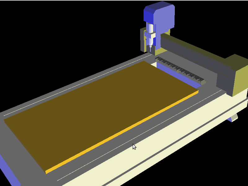

2.2. QtVCP vismach_router_atc
3D OpenGL view of a 3-Axis router style, gantry bed milling machine.
This particular panel shows how to define and connect the model parts in the handler file, rather then importing the pre-built model from QtVCP’s vismach library.
loadusr qtvcp vismach_router_atc
QtVCP vismach_router_atc - 3-Axis Gantry Bed Mill 3D View Panel
Figure 10. QtVCP vismach_router_atc - 3-Axis Gantry Bed Mill 3D View Panel

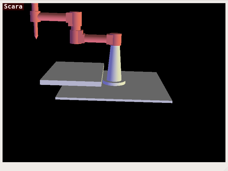

2.3. QtVCP vismach_scara
3D OpenGL view of a SCARA based milling machine.
loadusr qtvcp vismach_scara
QtVCP vismach_scara - SCARA Mill 3D View Panel
Figure 11. QtVCP vismach_scara - SCARA Mill 3D View Panel

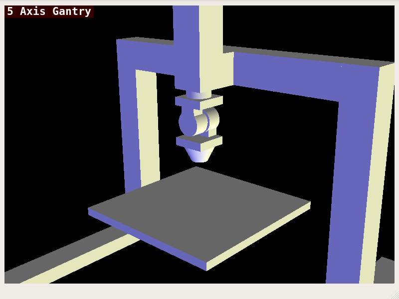

2.5. QtVCP vismach_mill_5axis_gantry
3D OpenGL view of a 5-Axis gantry type milling machine.
loadusr qtvcp vismach_mill_5axis_gantry
QtVCP vismach_mill_5axis_gantry - 5-Axis Gantry Mill 3D View Panel
Figure 13. QtVCP vismach_mill_5axis_gantry - 5-AxIs Gantry Mill 3D View Panel
