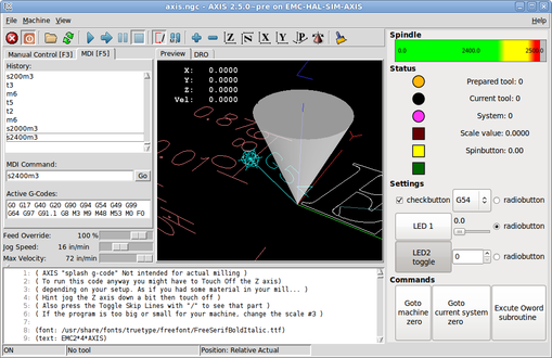

Run the sample GladeVCP panel integrated into AXIS like PyVCP as follows:
$ cd configs/sim/axis/gladevcp
$ linuxcnc gladevcp_panel.ini
example panel small

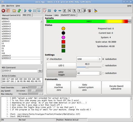

Run the same panel, but as a tab inside AXIS:
$ linuxcnc gladevcp_tab.ini
example tabbed small

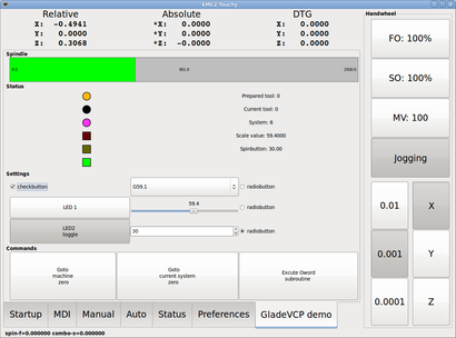

To run this panel inside Touchy:
$ cd configs/sim/touchy/gladevcp
$ linuxcnc gladevcp_touchy.ini
touchy tab 33
Functionally these setups are identical - they only differ in screen real estate requirements and visibility. Since it is possible to run several GladeVCP components in parallel (with different HAL component names), mixed setups are possible as well - for instance a panel on the right hand side, and one or more tabs for less-frequently used parts of the interface.
2.1. Exploring the example panel
While running configs/sim/axis/gladevcp_panel.ini or configs/sim/axis/gladevcp_tab.ini, explore Show HAL Configuration - you will find the gladevcp HAL component and may observe their pin values while interacting with the widgets in the panel. The HAL setup can be found in configs/axis/gladevcp/manual-example.hal.
The example panel has two frames at the bottom. The panel is configured so that resetting ESTOP activates the Settings frame and turning the machine on enables the Commands frame at the bottom. The HAL widgets in the Settings frame are linked to LEDs and labels in the Status frame, and to the current and prepared tool number - play with them to see the effect. Executing the T<toolnumber> and M6 commands in the MDI window will change the current and prepared tool number fields.
The buttons in the Commands frame are MDI Action widgets - pressing them will execute an MDI command in the interpreter. The third button Execute Oword subroutine is an advanced example - it takes several HAL pin values from the Settings frame, and passes them as parameters to the Oword subroutine. The actual parameters received by the routine are displayed by (DEBUG, ) commands - see ../../nc_files/oword.ngc for the subroutine body.
To see how the panel is integrated into AXIS, see the [DISPLAY]GLADEVCP statement in configs/sim/axis/gladevcp/gladevcp_panel.ini, the [DISPLAY]EMBED* statement in configs/sim/axis/gladevcp/gladevcp_tab.ini and [HAL]POSTGUI_HALFILE statements in both configs/sim/axis/gladevcp/gladevcp_tab.ini and configs/sim/axis/gladevcp/gladevcp_panel.ini.

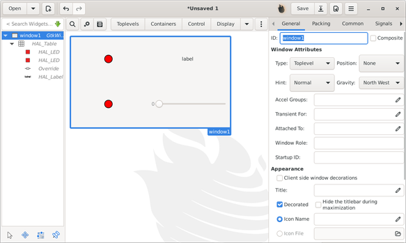

3.2. Running Glade to create a new user interface
This section just outlines the initial LinuxCNC-specific steps. For more information and a tutorial on Glade, see http://glade.gnome.org. Some Glade tips & tricks may also be found on YouTube.
Either modify an existing UI component by running glade <file>.ui or start a new one by just running the glade command from the shell.
  • If LinuxCNC was not installed from a package, the LinuxCNC shell environment needs to be set up with source <linuxcncdir>/scripts/rip-environment, otherwise Glade won’t find the LinuxCNC-specific widgets.
  • When asked for unsaved preferences, just accept the defaults and hit Close.
  • From Toplevels (toolbar), pick GtkWindow (first entry) as top level window. Set window1 as ID in the right pane under the tab General. This naming is important because GladeVCP relies on it.
  • From the button with the three dots you can find the LinuxCNC specific widgets.
  • Add a container like a HAL_Box or a HAL_Table from HAL Python to the frame.
  • Pick and place some elements like LED, button, etc. within a container.
This will look like this:
glade manual small
Glade tends to write a lot of messages to the shell window, which mostly can be ignored. Select FileSave as, give it a name like myui.ui and make sure it is saved as GtkBuilder file (radio button left bottom corner in Save dialog). GladeVCP will also process the older libglade format correctly but there is no point in using it. The convention for GtkBuilder file extension is .ui.

3.5. Integrating into AXIS, like PyVCP
Place the GladeVCP panel in the righthand side panel by specifying the following in the INI file:
[DISPLAY]
# add GladeVCP panel where PyVCP used to live:
GLADEVCP= -u ./hitcounter.py ./manual-example.ui
[HAL]

6.4. The hal-pin-changed signal
Event-driven programming means that the UI tells your code when "something happens" - through a callback, like when a button was pressed. The output HAL widgets (those which display a HAL pin’s value) like LED, Bar, VBar, Meter, etc., support the hal-pin-changed signal, which may cause a callback into your Python code when - well, a HAL pin changes its value. This means there’s no more need for permanent polling of HAL pin changes in your code, the widgets do that in the background and let you know.
Here is an example how to set a hal-pin-changed signal for a HAL_LED in the Glade UI editor:
hal pin change 66
The example in configs/apps/gladevcp/complex shows how this is handled in Python.

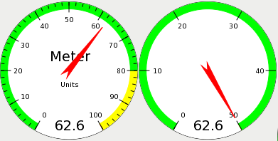

6.17. Meter
HAL_Meter is a widget similar to PyVCP meter - it represents a float value.
6.17.1. Pins
HAL_Meter has one input FLOAT HAL pin.
6.17.2. Properties
HAL Meter has the following properties:
min, max
Minimum and maximum value of desired range.
It is not an error condition if the current value is outside this range.
force_size
Forced diameter of widget.
If not set then size will be deduced from packing or from fixed widget size, and meter will fill all available space with respect to aspect ratio.
text_template
Like in Label, sets text format for current value.
Can be used to turn off value display.
label
Large label above center of meter.
sublabel
Small label below center of meter.
bg_color
Background color of meter.
z0_color, z1_color, z2_color
Colors of different value zones.
Defaults are green, yellow and red.
For description of zones see z*_border properties.
z0_border, z1_border
Define up bounds of color zones.
By default only one zone is enabled. If you want more then one zone set z0_border and z1_border to desired values so zone 0 will fill from min to first border, zone 1 will fill from first to second border and zone 2 from last border to max.
Borders are set as values in range min-max.
hal meter
Figure 13. Example HAL Meters

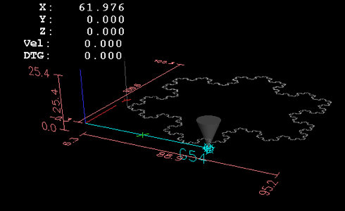

6.19. Gremlin tool path preview for NGC files
Gremlin is a plot preview widget similar to the AXIS preview window. It assumes a running LinuxCNC environment like AXIS or Touchy. To connect to it, inspects the INI_FILE_NAME environment variable. Gremlin displays the current NGC file - it does monitor for changes and reloads the ngc file if the file name in AXIS/Touchy changes. If you run it in a GladeVCP application when LinuxCNC is not running, you might get a traceback because the Gremlin widget can’t find LinuxCNC status, like the current file name.
6.19.1. Pins
Gremlin does not export any HAL pins.
6.19.2. Properties
Gremlin has the following properties:
enable_dro
This displays the dro on the graphics.
Default = true.
show_velocity
This displays the tool speed.
Default = true.
use_commanded
This selects the DRO to use: commanded or actual values.
Default = true.
metric_units
This selects the DRO to use: metric or imperial units.
Default = true.
show_rapids
This tells the plotter to show the rapid moves.
Default = true.
show_dtg_
This selects the DRO to display the distance-to-go value.
Default = true.
use_relative
This selects the DRO to show values relative to user system or machine coordinates.
Default = true.
show_live_plot
This tells the plotter to draw or not.
Default = true.
show_limits
This tells the plotter to show the machine’s limits.
Default = true.
show_lathe_radius
This selects the DRO to display the X axis in radius or diameter, if in lathe mode (selectable in the INI file with LATHE = 1).
Default = true.
show_extents_option
This tells the plotter to show the machine’s extents.
Default = true.
show_tool
This tells the plotter to draw the tool.
Default = true.
show_program
Shows the G-code program.
Default = True
use_joints_mode
Used in non trivialkins machines (e.g., robots).
Default = false.
grid_size
Sets the size of the grid (only visible in the X, Y and Z views).
Defaults to 0
use_default_controls
This disables the default mouse controls.
This is most useful when using a touchscreen as the default controls do not work well. You can programmatically add controls using Python and the handler file technique.
Default = true.
view
May be any of x, y, y2 , z, z2 , p (perspective).
Defaults to z view.
enable_dro
Type = boolean.
Whether to draw a DRO on the plot or not.
Default = true.
mouse_btn_mode
Type = integer.
Mouse button handling: leads to different functions of the button:
  • 0 = default: left rotate, middle move, right zoom
  • 1 = left zoom, middle move, right rotate
  • 2 = left move, middle rotate, right zoom
  • 3 = left zoom, middle rotate, right move
  • 4 = left move, middle zoom, right rotate
  • 5 = left rotate, middle zoom, right move
  • 6 = left move, middle zoom, right zoom
Mode 6 is recommended for plasmas and lathes, as rotation is not needed for such machines.
6.19.3. Direct program control
There a couple ways to directly control the widget using Python.
Using GObject to set the above listed properties:
[widget name].set_property('view','P')
[widget name].set_property('metric_units',False)
[widget name].set_property('use_default_controls',False)
[widget name].set_property('enable_dro' False)
[widget name].set_property('show_program', False)
[widget name].set_property('show_limits', False)
[widget name].set_property('show_extents_option', False)
[widget name].set_property('show_live_plot', False)
[widget name].set_property('show_tool', False)
[widget name].set_property('show_lathe_radius',True)
[widget name].set_property('show_dtg',True)
[widget name].set_property('show_velocity',False)
[widget name].set_property('mouse_btn_mode', 4)
There are Python methods:
[widget name].show_offsets = True
[widget name].grid_size = .75
[widget name].select_fire(event.x,event.y)
[widget name].select_prime(event.x,event.y)
[widget name].start_continuous_zoom(event.y)
[widget name].set_mouse_start(0,0)
[widget name].gremlin.zoom_in()
[widget name].gremlin.zoom_out()
[widget name].get_zoom_distance()
[widget name].set_zoom_distance(dist)
[widget name].clear_live_plotter()
[widget name].rotate_view(x,y)
[widget name].pan(x,y)
Hints
  • If you set all the plotting options false but show_offsets true you get an offsets page instead of a graphics plot.
  • If you get the zoom distance before changing the view then reset the zoom distance, it is much more user friendly.
  • if you select an element in the preview, the selected element will be used as rotation center point
gremlin
Figure 14. Gremlin Example

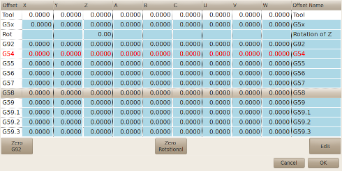

6.20. HAL_Offset
The HAL_Offset widget is used to display the offset of a single axis.
6.20.1. Properties
HAL_Offset has the following properties:
display_units_mm
Display in metric units.
joint_number
Used to select which axis (technically which joint) is displayed.
On a trivialkins machine (mill, lathe, router) axis vs. joint number are:
0:X 1:Y 2:Z 3:A 4:B 5:C 6:U 7:V 8:W
mm_text_template
You can use Python formatting to display the position with different precision.
imperial_text_template
reference_type
0:G5x 1:tool 2:G92 3:Rotation around Z

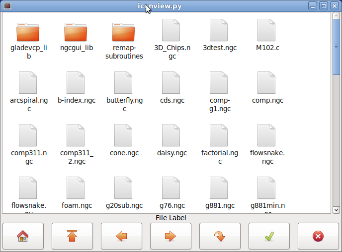

6.23. IconView (File Select)
This is a touch screen friendly widget to select a file and to change directories.
6.23.1. Properties
IconView widget has the following properties:
icon_size
Sets the size of the displayed icon.
Allowed values are integers in the range from 12 to 96.
Default is 48.
start_dir
Sets the directory to start in when the widget is shown first time.
Must be a string, containing a valid directory path.
Default is "/".
jump_to_dir
Sets the "jump to" directory, which is selected by the corresponding button in the bottom button list (the 5th button counting from the left).
Default is "\~".
filetypes
Sets the file filter for the objects to be shown.
Must be a string containing a comma separated list of extensions to be shown.
Default is "ngc,py".
sortorder
Sets the sorting order of the displayed icon.
Must be an integer value from 0 to 3, where:
  • 0 = ASCENDING (sorted according to file names)
  • 1 = DESCENDING (sorted according to file names)
  • 2 = FOLDERFIRST (show the folders first, then the files), default
  • 3 = FILEFIRST (show the files first, then the folders)
6.23.2. Direct program control
[widget name].set_property(property,Value)
There are Python methods to control the widget:
  • [widget name].show_buttonbox(state)
    If False the bottom button box will be hidden.
    This is helpful in custom screens, with special buttons layouts to not alter the layout of the GUI. Good example for that is GMOCCAPY.
    state = boolean (True or False).
    Default is True.
  • [widget name].show_filelabel(state)
    If True the file label (between the IconView window and the bottom button box) will be shown.
    Hiding this label may save place, but showing it is very useful for debugging reasons.
    Default is True.
  • [widget name].set_icon_size(iconsize)
    Sets the icon size.
    Must be an integer in the range from 12 to 96.
    Default = 48.
  • [widget name].set_directory(directory)
    Allows to set an directory to be shown.
    directory = string (a valid file path).
  • [widget name].set_filetypes(filetypes)
    Sets the file filter to be used.
    Only files with the given extensions will be shown.
    filetypes = string containing a comma separated list of extensions.
    Default = "ngc,py".
  • [widget name].get_selected()
    Returns the path of the selected file, or None if a directory has been selected.
  • [widget name].refresh_filelist()
    Refreshes the filelist.
    Needed if you add a file without changing the directory.
If the button box has been hidden, you can reach the functions of this button through its clicked signals like so:
[widget name].btn_home.emit("clicked")
[widget name].btn_jump_to.emit("clicked")
[widget name].btn_sel_prev.emit("clicked")
[widget name].btn_sel_next.emit("clicked")
[widget name].btn_get_selected.emit("clicked")
[widget name].btn_dir_up.emit("clicked")
[widget name].btn_exit.emit("clicked")
6.23.3. Signals
The widget will emit the following signals:
  • selected
    This signal is emitted when the user selects an icon.
    It will return a string containing a file path if a file has been selected, or None if a directory has been selected.
  • sensitive
    This signal is emitted when the buttons change their state from sensitive to not sensitive or vice versa.
    This signal is useful to maintain surrounding GUI synchronized with the button of the widget. See GMOCCAPY as example.
    It will return the buttonname and the new state:
    • buttonname is one of btn_home, btn_dir_up, btn_sel_prev, btn_sel_next, btn_jump_to or btn_select.
    • state is a boolean and will be True or False.
  • exit
    This signal is emitted when the exit button has been pressed to close the IconView.
    Mostly needed if the application is started as stand alone.
iconview
Figure 16. Iconview Example

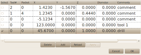

6.25. Tooleditor widget
This is a tooleditor widget for displaying and modifying a tool file.
If in lathe mode, it will display wear offsets and tool offsets separately.
Wear offsets are designated by tool number above 10000 (Fanuc style).
It checks the current file once a second to see if LinuxCNC updated it.
Note
LinuxCNC requires remapping of tool calls to actually use wear offsets.
6.25.1. Properties
tooleditor has the following properties:
font
Display font to use
hide_columns
This will hide the given columns.
The columns are designated (in order) as such: s,t,p,x,y,z,a,b,c,u,v,w,d,i,j,q.
You can hide any number of columns including the select and comments.
lathe_display_type
Show lathe format
6.25.2. Direct program control
Using goobject to set the above listed properties:
[widget name].set_properties('hide_columns','uvwijq')
This would hide the uvwij and q columns and show all others.
  • [widget name].set_visible("ijq",False)
    Would hide ij and Q columns and leave the rest as they were.
  • [widget name].set_filename(path_to_file)
    Sets and loads the tool file.
  • [widget name].reload(None)
    Reloads the current toolfile.
  • [widget name].set_font('sans 16,tab='1')
    Sets the (Pango) font on the Tab, column title, and tool data.
    The all_offsets, wear_offsets, tool_offsets can be set at the same time by adding 1, 2 and/or 3 to the tab string.
    Default is all the tabs set.
  • [widget name].set_title_font('sans 16,tab='1')
    Sets the (Pango) font on the column titles only.
  • [widget name].set_tab_font('sans 16,tab='1')
    Sets the (Pango) font on the tabs only.
  • [widget name].set_col_visible("abcUVW", False, tab='1')
    This would hide (False) the abcuvw columns on tab 1 (all_offsets)
  • [widget name].set_lathe_display(value)
    Hides or shows the wear and tool offset tabs used for lathes
  • [widget name].get_toolinfo(toolnum)
    Returns the tool information array of the requested toolnumber or current tool if no tool number is specified.
    Returns None if tool not found in table or if there is no current tool.
  • [widget name].hide_buttonbox(self, True)
    Convenience method to hide buttons.
    You must call this after show_all().
  • [widget name].get_selected_tool()
    Return the user selected (highlighted) tool number.
  • [widget name].set_selected_tool(toolnumber)
    Selects (highlights) the requested tool.
gtk tooledit
Figure 17. Tooleditor Example
6.26. Offsetpage
The Offsetpage widget is used to display/edit the offsets of all the axes.
It has convenience buttons for zeroing G92 and Rotation-Around-Z offsets.
It will only allow you to select the edit mode when the machine is on and idle.
You can directly edit the offsets in the table at this time. Unselect the edit button to allow the OffsetPage to reflect changes.
6.26.1. Properties
It has the following properties:
display_units_mm
Display in metrice units
hide_columns
A no-space list of columns to hide. The columns are designated (in order) as such: xyzabcuvwt.
You can hide any of the columns.
hide_rows
A no-space list of rows to hide.
The rows are designated (in order) as such: 0123456789abc.
You can hide any of the rows.
font
Sets text font type and size.
highlight_color
When editing this is the highlight color.
foreground_color
When OffsetPage detects an active user coordinate system it will use this color for the text.
mm_text_template
6.26.2. Direct program control
[widget name].set_property("highlight_color",gdk.Color('blue'))
[widget name].set_property("foreground_color",gdk.Color('black'))
[widget name].set_property("hide_columns","xyzabcuvwt")
[widget name].set_property("hide_rows","123456789abc")
[widget name].set_property("font","sans 25")
  • [widget name].set_filename("../../../configs/sim/gscreen/gscreen_custom/sim.var")
  • [widget name].set_col_visible("Yabuvw",False)
  • [widget name].set_row_visible("456789abc",False)
  • [widget name].set_to_mm()
  • [widget name].set_to_inch()
  • [widget name].hide_button_box(True)
  • [widget name].set_font("sans 20")
  • [widget name].set_highlight_color("violet")
  • [widget name].set_foreground_color("yellow")
  • [widget name].mark_active("G55")
    Allows you to directly set a row to highlight, e.g., in case you wish to use your own navigation controls. See the chapter on GMOCCAPY.
  • [widget name].selection_mask = ("Tool","Rot","G5x")
    These rows are NOT selectable in edit mode.
  • [widget name].set_names([['G54','Default'],["G55","Vice1"],['Rot','Rotational']])
    This allows you to set the text of the T column of each/any row.
    This is a list of a list of offset-name/user-name pairs.
    The default text is the same as the offset name.
  • [widget name].get_names()
    This returns a list of a list of row-keyword/user-name pairs.
    The user name column is editable, so saving this list is user friendly.
    See set_names above.
offsetpage
Figure 18. Offsetpage Example

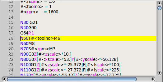

6.27. HAL_sourceview widget
This is for displaying and simple editing of G-code. It looks for .ngc highlighting specs in ~/share/gtksourceview-4/language-specs/. The current running line will be highlighted.
With external Python glue code it can:
  • Search for text, undo and redo changes.
  • Be used for program line selection.
6.27.1. Direct program control
  • [widget name].redo()
    Redo one level of changes.
  • [widget name].undo()
    Undo one level of changes
  • [widget name].text_search(direction=True,mixed_case=True,text='G92')
    Searches forward (direction = True) or backward,
    Searches with mixed case (mixed_case = True) or exact match
  • [widget name].set_line_number(linenumber)
    Sets the line to highlight.
    Uses the sourceview line numbers.
  • [widget name].get_line_number()
    Returns the currently highlighted line.
  • [widget name].line_up()
    Moves the highlighted line up one line.
  • [widget name].line_down()
    Moves the highlighted line down one line.
  • [widget name].load_file('filename')
    Loads a file.
    Using None (not a filename string) will reload the same program.
  • [widget name].get_filename()
    FIXME description
hal sourceview
Figure 19. Sourceview Example

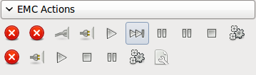

GladeVCP includes a collection of "canned actions" called VCP Action Widgets for the Glade user interface editor.
Note
Other than HAL widgets, which interact with HAL pins, VCP Actions interact with LinuxCNC and the G-code interpreter.
VCP Action Widgets are derived from the Gtk.Action widget.
The Action widget in a nutshell:
  • It is an object available in Glade
  • It has no visual appearance by itself
  • Its purpose: Associate a visible, sensitive UI component like menu, toolbutton, button with a command. See these widget’s General→Related→Action property.
  • The "canned action" will be executed when the associated UI component is triggered (button press, menu click..).
  • It provides an easy way to execute commands without resorting to Python programming.
The appearance of VCP Actions in Glade is roughly as follows:
vcp actions
Figure 21. Action Widgets
Tooltip hovers provide a description.

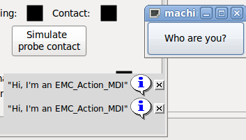

7.5. A simple example: Execute MDI command on button press
configs/apps/gladevcp/mdi-command-example/whoareyou.ui is a Glade UI file which conveys the basics:
  1. Open it in Glade and study how it is done.
  2. Start AXIS, and then start this from a terminal window with gladevcp whoareyou.ui.
  3. See the hal_action_mdi1 action and its MDI command property - this just executes (MSG, "Hi, I'm an VCP_Action_MDI") so there should be a message popup in AXIS like so:
whoareyou
Figure 22. Action_MDI Simple Example
You’ll notice that the button associated with the Action_MDI action is grayed out if the machine is off, in E-Stop or if the interpreter is running. It will automatically become active when the machine is turned on and out of E-Stop, and the program is idle.

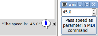

7.6. Parameter passing with Action_MDI and ToggleAction_MDI widgets
Optionally, MDI command strings may have parameters substituted before they are passed to the interpreter. Parameters currently may be names of HAL pins in the GladeVCP component. This is how it works:
  • assume you have a HAL SpinBox named speed, and you want to pass its current value as a parameter in an MDI command.
  • The HAL SpinBox will have a float-type HAL pin named speed-f (see HalWidgets description).
  • To substitute this value in the MDI command, insert the HAL pin name enclosed like so: ${pin-name}
  • for the above HAL SpinBox, we could use (MSG, "The speed is: ${speed-f}") just to show what’s happening.

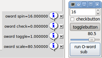

7.7. An advanced example: Feeding parameters to an O-word subroutine
It’s perfectly OK to call an O-word subroutine in an MDI command, and pass HAL pin values as actual parameters. An example UI file is in configs/apps/gladevcp/mdi-command-example/owordsub.ui.
Place nc_files/gladevcp_lib/oword.ngc so AXIS can find it, and run gladevcp owordsub.ui from a terminal window. This looks like so:
oword
Figure 24. Action_MDI Advanced Example

In the following example (assuming a HAL Meter widget called meter), the meter’s min value is set from an INI file parameter at startup, and the max value is set via a HAL pin, which causes the widget’s scale to readjust dynamically:
import linuxcnc
import os
import hal
import hal_glib
class HandlerClass:
    def _on_max_value_change(self,hal_pin,data=None):
        self.meter.max = float(hal_pin.get())
        self.meter.queue_draw() # force a widget redraw
    def __init__(self, halcomp,builder,useropts):
        self.builder = builder
        # HAL pin with change callback.
        # When the pin's value changes the callback is executed.
        self.max_value = hal_glib.GPin(halcomp.newpin('max-value',  hal.HAL_FLOAT, hal.HAL_IN))
        self.max_value.connect('value-changed', self._on_max_value_change)
        inifile = linuxcnc.ini(os.getenv("INI_FILE_NAME"))
        mmin = inifile.getreal("METER", "MIN", fallback=0.0)
        self.meter = self.builder.get_object('meter')
        self.meter.min = mmin
def get_handlers(halcomp,builder,useropts):
    return [HandlerClass(halcomp,builder,useropts)]
