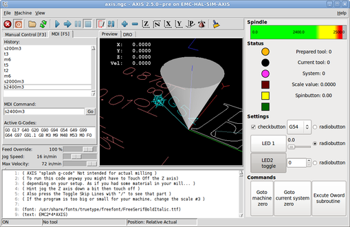

Run the sample GladeVCP panel integrated into AXIS like PyVCP as follows:
$ cd configs/sim/axis/gladevcp
$ linuxcnc gladevcp_panel.ini
images/example-panel-small.png

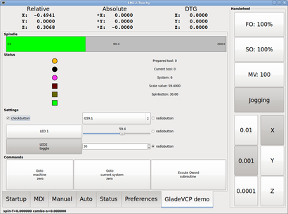

To run this panel inside Touchy:
$ cd configs/sim/touchy/gladevcp
$ linuxcnc gladevcp_touchy.ini
images/touchy-tab-33.png
Functionally these setups are identical - they only differ in screen real estate requirements and visibility. Since it is possible to run several GladeVCP components in parallel (with different HAL component names), mixed setups are possible as well - for instance a panel on the right hand side, and one or more tabs for less-frequently used parts of the interface.
2.1. Exploring the example panel
While running configs/sim/axis/gladevcp_panel.ini or configs/sim/axis/gladevcp_tab.ini, explore Show HAL Configuration - you will find the gladevcp HAL component and may observe their pin values while interacting with the widgets in the panel. The HAL setup can be found in configs/axis/gladevcp/manual-example.hal.
The example panel has two frames at the bottom. The panel is configured so that resetting ESTOP activates the Settings frame and turning the machine on enables the Commands frame at the bottom. The HAL widgets in the Settings frame are linked to LEDs and labels in the Status frame, and to the current and prepared tool number - play with them to see the effect. Executing the T<toolnumber> and M6 commands in the MDI window will change the current and prepared tool number fields.
The buttons in the Commands frame are MDI Action widgets - pressing them will execute an MDI command in the interpreter. The third button Execute Oword subroutine is an advanced example - it takes several HAL pin values from the Settings frame, and passes them as parameters to the Oword subroutine. The actual parameters received by the routine are displayed by (DEBUG, ) commands - see ../../nc_files/oword.ngc for the subroutine body.
To see how the panel is integrated into AXIS, see the [DISPLAY]GLADEVCP statement in configs/sim/axis/gladevcp/gladevcp_panel.ini, the [DISPLAY]EMBED* statement in configs/sim/axis/gladevcp/gladevcp_tab.ini and [HAL]POSTGUI_HALFILE statements in both configs/sim/axis/gladevcp/gladevcp_tab.ini and configs/sim/axis/gladevcp/gladevcp_panel.ini.

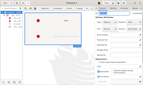

3.2. Running Glade to create a new user interface
This section just outlines the initial LinuxCNC-specific steps. For more information and a tutorial on Glade, see http://glade.gnome.org. Some Glade tips & tricks may also be found on youtube.
Either modify an existing UI component by running glade <file>.ui or start a new one by just running the glade command from the shell.
  • If LinuxCNC was not installed from a package, the LinuxCNC shell environment needs to be set up with source <linuxcncdir>/scripts/rip-environment, otherwise Glade won’t find the LinuxCNC-specific widgets.
  • When asked for unsaved preferences, just accept the defaults and hit Close.
  • From Toplevels (toolbar), pick GtkWindow (first entry) as top level window. Set window1 as ID in the right pane under the tab General. This naming is important because GladeVCP relies on it.
  • From the button with the three dots you can find the LinuxCNC specific widgets.
  • Add a container like a HAL_Box or a HAL_Table from HAL Python to the frame.
  • Pick and place some elements like LED, button, etc. within a container.
This will look like this:
images/glade-manual-small.png
Glade tends to write a lot of messages to the shell window, which mostly can be ignored. Select File'→'Save as, give it a name like myui.ui and make sure it is saved as GtkBuilder file (radio button left bottom corner in Save dialog). GladeVCP will also process the older libglade format correctly but there is no point in using it. The convention for GtkBuilder file extension is .ui.

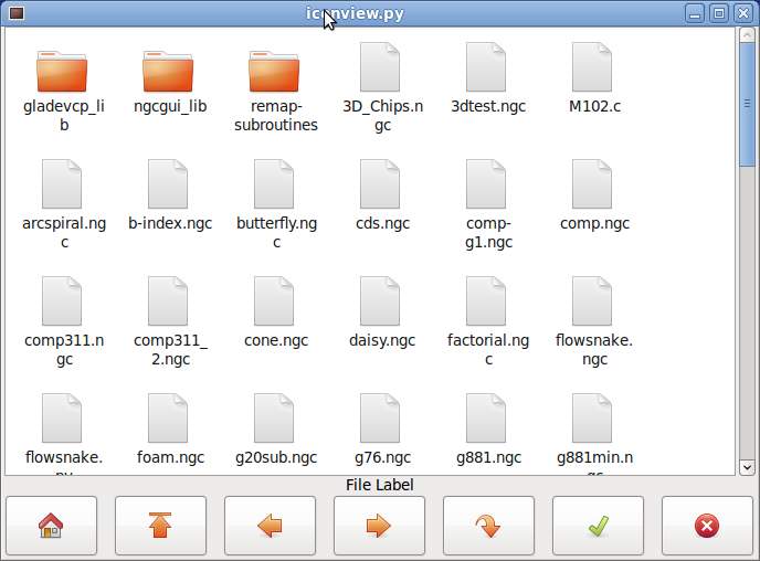

6.23. IconView (File Select)
This is a touch screen friendly widget to select a file and to change directories.
6.23.1. Properties
IconView widget has the following properties:
icon_size
Sets the size of the displayed icon.
Allowed values are integers in the range from 12 to 96.
Default is 48.
start_dir
Sets the directory to start in when the widget is shown first time.
Must be a string, containing a valid directory path.
Default is "/".
jump_to_dir
Sets the "jump to" directory, which is selected by the corresponding button in the bottom button list (the 5th button counting from the left).
Default is "\~".
filetypes
Sets the file filter for the objects to be shown.
Must be a string containing a comma separated list of extensions to be shown.
Default is "ngc,py".
sortorder
Sets the sorting order of the displayed icon.
Must be an integer value from 0 to 3, where:
  • 0 = ASCENDING (sorted according to file names)
  • 1 = DESCENDING (sorted according to file names)
  • 2 = FOLDERFIRST (show the folders first, then the files), default
  • 3 = FILEFIRST (show the files first, then the folders)
6.23.2. Direct program control
Using GObject to set the above listed properties:
[widget name].set_property(property,Value)
There are Python methods to control the widget:
  • [widget name].show_buttonbox(state)
    If False the bottom button box will be hidden.
    This is helpful in custom screens, with special buttons layouts to not alter the layout of the GUI. Good example for that is GMOCCAPY.
    state = boolean (True or False).
    Default is True.
  • [widget name].show_filelabel(state)
    If True the file label (between the IconView window and the bottom button box) will be shown.
    Hiding this label may save place, but showing it is very useful for debugging reasons.
    Default is True.
  • [widget name].set_icon_size(iconsize)
    Sets the icon size.
    Must be an integer in the range from 12 to 96.
    Default = 48.
  • [widget name].set_directory(directory)
    Allows to set an directory to be shown.
    directory = string (a valid file path).
  • [widget name].set_filetypes(filetypes)
    Sets the file filter to be used.
    Only files with the given extensions will be shown.
    filetypes = string containing a comma separated list of extensions.
    Default = "ngc,py".
  • [widget name].get_selected()
    Returns the path of the selected file, or None if a directory has been selected.
  • [widget name].refresh_filelist()
    Refreshes the filelist.
    Needed if you add a file without changing the directory.
If the button box has been hidden, you can reach the functions of this button through its clicked signals like so:
[widget name].btn_home.emit("clicked")
[widget name].btn_jump_to.emit("clicked")
[widget name].btn_sel_prev.emit("clicked")
[widget name].btn_sel_next.emit("clicked")
[widget name].btn_get_selected.emit("clicked")
[widget name].btn_dir_up.emit("clicked")
[widget name].btn_exit.emit("clicked")
6.23.3. Signals
The widget will emit the following signals:
  • selected
    This signal is emitted when the user selects an icon.
    It will return a string containing a file path if a file has been selected, or None if a directory has been selected.
  • sensitive
    This signal is emitted when the buttons change their state from sensitive to not sensitive or vice versa.
    This signal is useful to maintain surrounding GUI synchronized with the button of the widget. See GMOCCAPY as example.
    It will return the buttonname and the new state:
    • buttonname is one of btn_home, btn_dir_up, btn_sel_prev, btn_sel_next, btn_jump_to or btn_select.
    • state is a boolean and will be True or False.
  • exit
    This signal is emitted when the exit button has been pressed to close the IconView.
    Mostly needed if the application is started as stand alone.
images/iconview.png

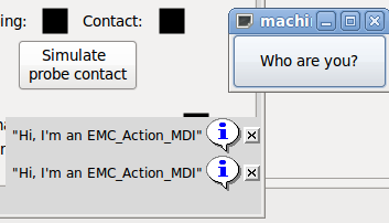

7.5. A simple example: Execute MDI command on button press
configs/apps/gladevcp/mdi-command-example/whoareyou.ui is a Glade UI file which conveys the basics:
  1. Open it in Glade and study how it is done.
  2. Start AXIS, and then start this from a terminal window with gladevcp whoareyou.ui.
  3. See the hal_action_mdi1 action and its MDI command property - this just executes (MSG, "Hi, I'm an VCP_Action_MDI") so there should be a message popup in AXIS like so:
images/whoareyou.png
You’ll notice that the button associated with the Action_MDI action is grayed out if the machine is off, in E-Stop or if the interpreter is running. It will automatically become active when the machine is turned on and out of E-Stop, and the program is idle.

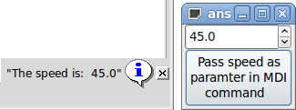

7.6. Parameter passing with Action_MDI and ToggleAction_MDI widgets
Optionally, MDI command strings may have parameters substituted before they are passed to the interpreter. Parameters currently may be names of HAL pins in the GladeVCP component. This is how it works:
  • assume you have a HAL SpinBox named speed, and you want to pass its current value as a parameter in an MDI command.
  • The HAL SpinBox will have a float-type HAL pin named speed-f (see HalWidgets description).
  • To substitute this value in the MDI command, insert the HAL pin name enclosed like so: ${pin-name}
  • for the above HAL SpinBox, we could use (MSG, "The speed is: ${speed-f}") just to show what’s happening.
The example UI file is configs/apps/gladevcp/mdi-command-example/speed.ui. Here’s what you get when running it:
images/speed.png

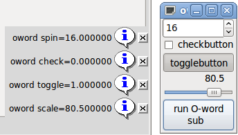

7.7. An advanced example: Feeding parameters to an O-word subroutine
It’s perfectly OK to call an O-word subroutine in an MDI command, and pass HAL pin values as actual parameters. An example UI file is in configs/apps/gladevcp/mdi-command-example/owordsub.ui.
Place nc_files/gladevcp_lib/oword.ngc so AXIS can find it, and run gladevcp owordsub.ui from a terminal window. This looks like so:
images/oword.png

LinuxCNC Stat has no visible component - you just add it to your UI with Glade. Once added, you can associate handlers with its following signals:
  • state-related:
    • state-estop: emitted when E-Stop condition occurs,
    • state-estop-reset: emitted when machine is reset,
    • state-on: emitted when machine is turned on,
    • state-off: emitted when machine is turned off.
  • mode-related:
    • mode-manual: emitted when LinuxCNC enters manual mode,
    • mode-mdi: emitted when LinuxCNC enters MDI mode,
    • mode-auto: emitted when LinuxCNC enters automatic mode,
  • interpreter-related: emitted when the G-code interpreter changes into that mode
    • interp-run
    • interp-idle
    • interp-paused
    • interp-reading
    • interp-waiting
    • file-loaded
    • line-changed
  • homing-related: emitted when LinuxCNC is homed or not
    • all-homed
    • not-all-homed
8. GladeVCP Programming
