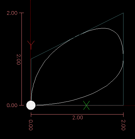

7. G5 Cubic Spline
G5 X- Y- <I- J-> P- Q-
I - X incremental offset from start point to first control point
J - Y incremental offset from start point to first control point
P - X incremental offset from end point to second control point
Q - Y incremental offset from end point to second control point
G5 creates a cubic B-spline in the XY plane with the X and Y axes only. P and Q must both be specified for every G5 command.
For the first G5 command in a series of G5 commands, I and J must both be specified. For subsequent G5 commands, either both I and J must be specified, or neither. If I and J are unspecified, the starting direction of this cubic will automatically match the ending direction of the previous cubic (as if I and J are the negation of the previous P and Q).
For example, to program a curvy N shape:
G90 G17 G0 X0 Y0 G5 I0 J3 P0 Q-3 X1 Y1
A second curvy N that attaches smoothly to this one can now be made without specifying I and J:
G5 P0 Q-3 X2 Y2

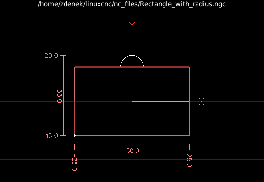

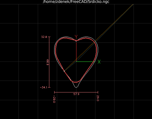

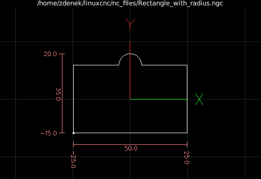

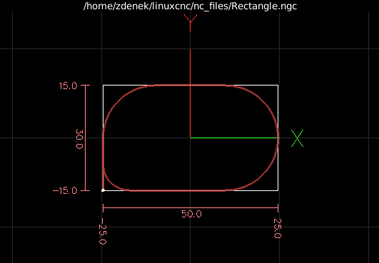

37. G64 Path Blending
G64 <P- <Q->>
P - motion blending tolerance
Q - naive cam tolerance
G64 - best possible speed. Without P (Or a default value in RS274NGC) means to keep the best speed possible, no matter how far away from the programmed point you end up.
G64 P- - Blend between best speed and deviation tolerance
G64 P- <Q- > blending with tolerance. It is a way to fine tune your system for best compromise between speed and accuracy. The P- tolerance means that the actual path will be no more than P- away from the programmed endpoint. The velocity will be reduced if needed to maintain the path. If you set Q to a non-zero value it turns on the Naive CAM Detector: when there are a series of linear XYZ feed moves at the same feed rate that are less than Q- away from being collinear, they are collapsed into a single linear move. On G2/G3 moves in the G17 (XY) plane when the maximum deviation of an arc from a straight line is less than the G64 P- tolerance the arc is broken into two lines (from start of arc to midpoint, and from midpoint to end). those lines are then subject to the naive cam algorithm for lines. Thus, line-arc, arc-arc, and arc-line cases as well as line-line benefit from the Naive CAM Detector. This improves contouring performance by simplifying the path. It is OK to program for the mode that is already active. See also the Trajectory Control section for more information on these modes. If Q is not specified then it will have the same behavior as before and use the value of P-. Set Q to zero to disable the Naive CAM Detector.
It is a good idea to include a path control specification in the preamble of each G-code file.
G64 P0.015 Q0.015 (set path following to be within 0.015 of the actual path)
The P- and Q- values are chosen small. Usually smaller than the machine accuracy or the accuracy of commonly manufactured parts. Below are examples with extreme P- and Q- values to understand the G64 function.
G64 (set without P- and Q- values)
G64 P0.015 Q6
G64 P0.015 Q2
