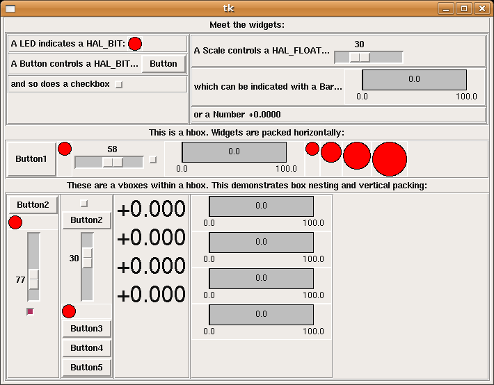

The following graphic displays many of the PyVCP widgets.
images/pyvcp_group.png

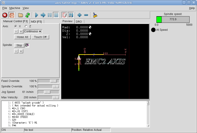

Here we’ve made a panel with a Label and a Bar widget, specified that the HAL pin connected to the Bar should be named spindle-speed, and set the maximum value of the bar to 5000 (see widget reference below for all options). To make AXIS aware of this file, and call it at start up, we need to specify the following in the [DISPLAY] section of the INI file:
PYVCP = spindle.xml
If the panel should appear at the bottom of the AXIS user interface then we need to specify the following in the [DISPLAY] section of the INI file:
PYVCP_POSITION = BOTTOM
Anything other than BOTTOM or omitting this variable will place the PYVCP panel at the right.
To make our widget actually display the spindle-speed it needs to be hooked up to the appropriate HAL signal. A HAL file that will be run once AXIS and PyVCP have started can be specified in the [HAL] section of the INI file:
POSTGUI_HALFILE = spindle_to_pyvcp.hal
This change will run the HAL commands specified in spindle_to_pyvcp.hal. In our example the contents could look like this:
net spindle-rpm-filtered => pyvcp.spindle-speed
assuming that a signal called spindle-rpm-filtered already exists. Note that when running together with AXIS, all PyVCP panel widget HAL pins have names that start with pyvcp., all PyVCP embedded tab widget HAL pins start with the name specified as EMBED_TAB_NAME converted to lower case.
images/pyvcp_axis_lathe.png
This is what the newly created PyVCP panel should look like in AXIS. The sim/lathe configuration is already configured this way.
