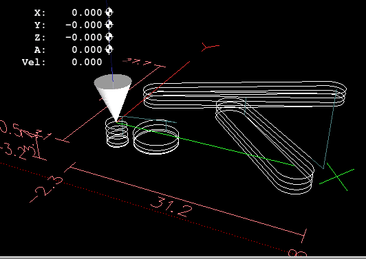

1.1. Helical Hole Milling
  • File Name: useful-subroutines.ngc
  • Description: Subroutine for milling a hole using parameters.
1.2. Slotting
  • Description: Subroutine for milling a slot using parameters.

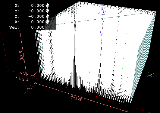

1.3. Grid Probe
  • File Name: gridprobe.ngc
  • Description: Rectangular Probing
This program repeatedly probes in a regular XY grid and writes the probed location to the file probe-results.txt in the same directory as the .ini file.
Grill probe

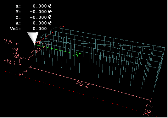

1.4. Smart Probe
  • File Name: smartprobe.ngc
This program repeatedly probes in a regular XY grid and writes the probed location to the file probe-results.txt in the same directory as the .ini file. This is improved from the grid probe file.
The finer probing grid
