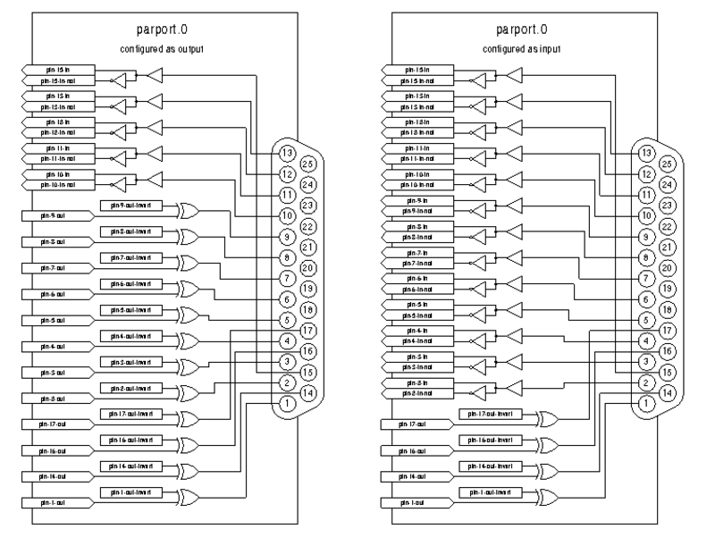

Parport block diagram

For each parallel port handled by the hal_parport driver, a type can optionally be specified. The type is one of in, out, epp, or x.
Pin in out/epp x

If the type is not specified, the default is out.
A type of epp is the same as out, but the hal_parport driver requests that the port switch into EPP mode. The hal_parport driver does not use the EPP bus protocol, but on some systems EPP mode changes the electrical characteristics of the port in a way that may make some marginal hardware work better. The Gecko G540’s charge pump is known to require this on some parallel ports.
See the Note above about mode x.
