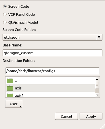

1.1. copy
Used for copying QtVCP’s builtin Screens/VCP Panels/QtVismach code to a folder so one can customize it.
In a terminal run:
qtvcp copy
QtVCP copy Dialog - Screen, Panel or Vismach Code Copy Panel
Figure 1. QtVCP copy Dialog - Screen, VCP Panel or QtVismach Code Copy Panel

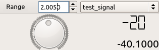

1.3. test_dial
  • This panel has a dial that adjusts S32 and Float HAL output pins.
  • The dial’s range can be adjusted from a drop down menu.
  • The output can be scaled with the spinbox.
  • A combobox can be used to automatically select and connect to a signal.
loadusr qtvcp test_dial
QtVCP test_dial Panel - Test Dial VCP
Figure 2. QtVCP test_dial Panel - Test Dial VCP

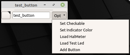

1.4. test_button
  • This panel has a button that will set a HAL pin.
  • The button can be selected as a momentary or a toggle button.
  • A HAL pin will be created that follows the button state.
  • The button’s indicator color can be adjusted from a drop down menu.
  • A HAL pin or signal can be selected to follow the button state.
  • You can add more buttons from the drop down menu.
  • You can load a Halmeter from the drop down menu.
  • You can load a test LED from the drop down menu.
  • The button can be detached from the main windows.
Here is how to load test_button from a HAL script:
loadusr qtvcp test_button
loadusr qtvcp -o 4 test_button
The -o switch sets how many buttons the panel starts with.
If loading directly from a terminal omit the loadusr.
QtVCP test_button - Test Button VCP
Figure 3. QtVCP test_button - Test Button VCP

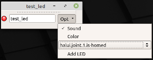

1.5. test_led
  • This panel has an LED that can selected to watch HAL bit pins/signals.
  • The LED’s color can be adjusted from a drop down menu.
  • The text box and state can be output as speech if sound is selected.
  • A combobox can be used to automatically select and connect to a pin/signal.
  • You can add more LEDs from the drop down menu.
  • The LED can be detached from the main windows.
Here is how to load test_led from a HAL script:
loadusr qtvcp test_led
loadusr qtvcp -o 4 test_led
The -o switch sets how many LEDs the panel starts with.
QtVCP test_dial Panel - Test LED VCP
Figure 4. QtVCP test_dial Panel - Test LED VCP

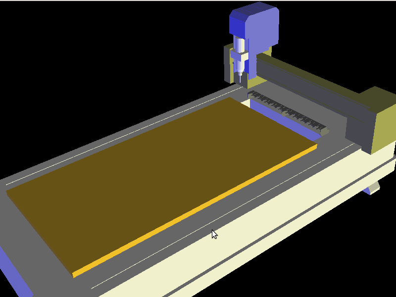

2.2. QtVCP vismach_router_atc
3D OpenGL view of a 3-Axis router style, gantry bed milling machine.
This particular panel shows how to define and connect the model parts in the handler file, rather then importing the pre-built model from QtVCP’s vismach library.
loadusr qtvcp vismach_router_atc
QtVCP vismach_router_atc - 3-Axis Gantry Bed Mill 3D View Panel
Figure 10. QtVCP vismach_router_atc - 3-Axis Gantry Bed Mill 3D View Panel

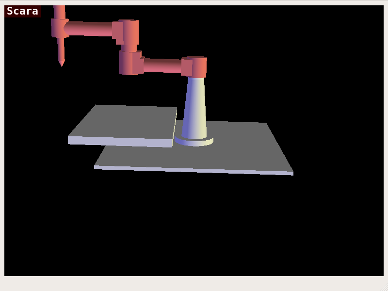

2.3. QtVCP vismach_scara
3D OpenGL view of a SCARA based milling machine.
loadusr qtvcp vismach_scara
QtVCP vismach_scara - SCARA Mill 3D View Panel
Figure 11. QtVCP vismach_scara - SCARA Mill 3D View Panel

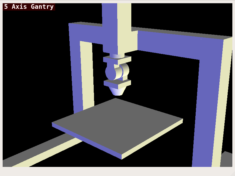

2.5. QtVCP vismach_mill_5axis_gantry
3D OpenGL view of a 5-Axis gantry type milling machine.
loadusr qtvcp vismach_mill_5axis_gantry
QtVCP vismach_mill_5axis_gantry - 5-Axis Gantry Mill 3D View Panel
Figure 13. QtVCP vismach_mill_5axis_gantry - 5-AxIs Gantry Mill 3D View Panel

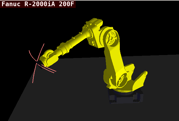

2.6. QtVCP vismach_fanuc_200f
3D openGL view of a 6 joint robotic arm.
loadusr qtvcp vismach_fanuc_200f
QtVCP vismach_fanuc_200f - 6 Joint Robotic Arm
Figure 14. QtVCP vismach_fanuc_200f - 6 Joint Robotic Arm
