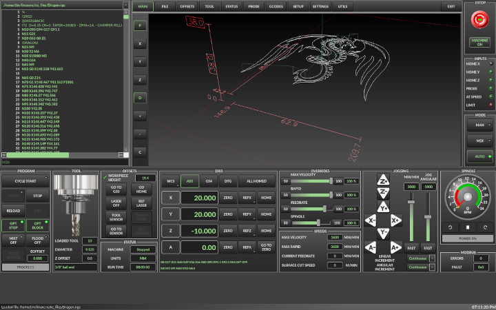

1. 简介
QtDragon and QtDragon_hd are built with the QtVCP framework. It is the creative vision of forum personality Persei8. Much of it is based on the excellent work of others in the LinuxCNC community. LinuxCNC’s version is adapted from Persei8’s Github versions. It is primarily meant for 3-5 axes machines such as mills or routers. It works well with a touchscreen and/or mouse. QtDragon supports multiple ways to touch off tools and probing work pieces. You can use LinuxCNC’s external offsets capability to automatically raise the spindle during a pause. If you the VersaProbe option and remap code you can add auto tool length probing at tool changes.
QtDragon and QtVCP are relatively new programs added into LinuxCNC. Bugs and oddities are possible. Please test carefully when using a dangerous machine. Please forward reports to the forum or maillist.

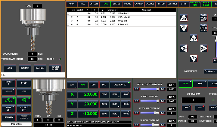

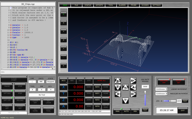

1.1. QtDragon
QtDragon Router
QtDragon is resizable from a resolution of 1280x768 to 1680x1200. It will work in window mode on any monitor with higher resolution but not on monitors with lower resolution.

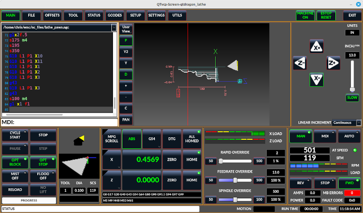

1.2. QtDragon_lathe
QtDragon Lathe
QtDragon_lathe is a modified version of QtDragon more suitable for lathes.
It is resizable from a resolution of 1280x768 to 1680x1200.

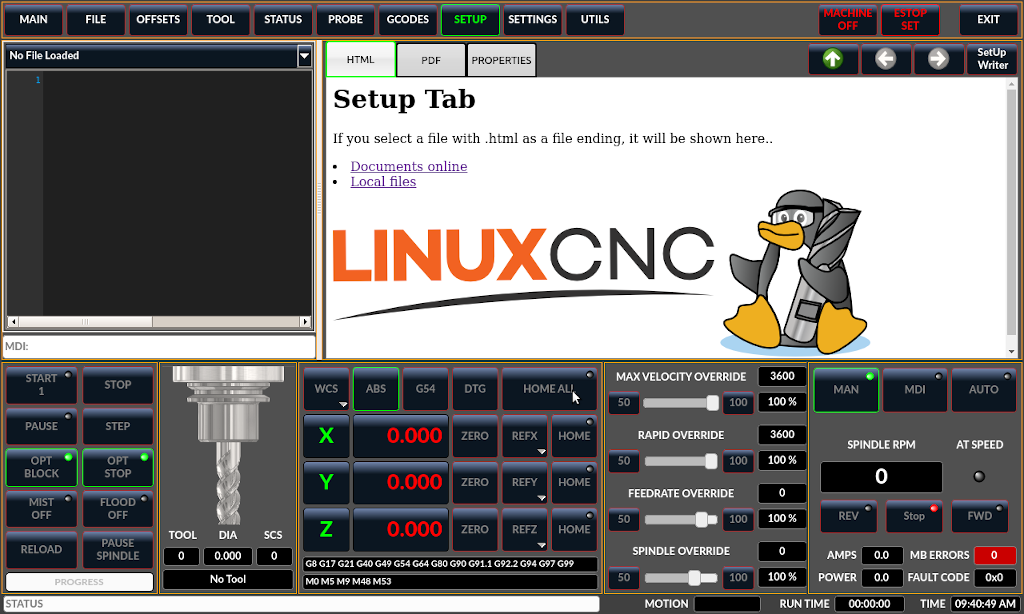

1.3. QtDragon_hd
QtDragon_hd
QtDragon_hd is a similar design as QtDragon but modified to utilize the extra space of modern larger monitors. There are some small differences in layout and utility.
QtDragon_hd has a resolution of 1920x1056 and is not resizeable. It will work in window mode on any monitor with higher resolution but not on monitors with lower resolution.
1.4. QtDragon_hd_vertical
QtDragon_hd_vertical is a vertical orientated version. It is not resizable.

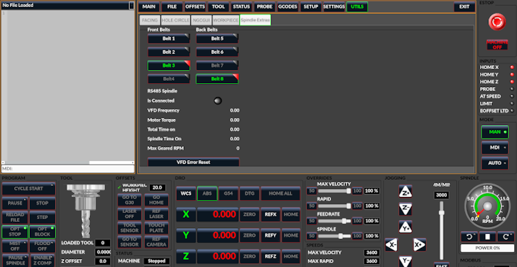

2.10.2. Embedding Spindle Belts Panel
This example panel is designed to display additional RS485 VFD data and also to configure a 4 sheave, 2 belt spindle drive via a series of buttons.
QtDragon spindle_belts Panel - Spindle Belts VCP
[DISPLAY]
EMBED_TAB_NAME = Spindle Belts
EMBED_TAB_COMMAND = qtvcp spindle_belts
EMBED_TAB_LOCATION = tabWidget_utilities

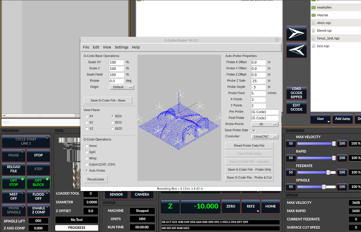

The following lines add support for the image-to-gcode converter included with LinuxCNC and running Python based filter programs:
[FILTER]
png = image-to-gcode
gif = image-to-gcode
jpg = image-to-gcode
py = python

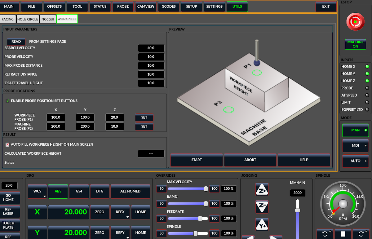

2.14. Probe/Touchplate/Laser Settings
QtDragon has INI entries for two optional probing tab screens available. Comment/uncomment which ever you prefer.
  • Versa probe is a QtVCP ported version of a popular GladeVCP probing panel.
  • Basic Probe is a QtVCP ported version based on the third party basic probe screen.
Both perform similar probing routines, though Versa probe optionally handles auto tool measurement.
[PROBE]
#USE_PROBE = versaprobe
USE_PROBE = basicprobe

14.4. Work Piece Height Probing in QtDragon_hd
The [TOOL_CHANGE] Z position should be high enough so the tool will not hit the tool probe when moving to the [VERSA_TOOLSETTER] X and Y position. MAXPROBE distance needs to be high enough for the tool to touch the probe.
14.5. Work Piece Height Probing
QtDragon_hd height probing
This program probes 2 user specified locations in the Z axis and calculates the difference in heights.
This is only available in the QtDragon_hd version.
Enable Probe Position Set Buttons
  • When checked, the SET buttons are enabled.
  • This allows the user to automatically fill in the X, Y and Z parameters with the current position as displayed on the DROs.
Autofill Workpiece Height on Main Screen
  • When checked, the calculated height is automatically transferred to the Workpiece Height field in the main screen.
  • Otherwise, the main screen is not affected.
Workpiece Probe At
  • the X, Y and Z coordinates specify where the first probing routine should start, in current WCS
Machine Probe At
  • the X, Y and Z coordinates specify where the second probing routine should start, in current WCS
Z Safe Travel Height
  • The machine is raised to the Z safe travel height before jogging to the X and Y coordinates.
  • The spindle then lowers to the specified Z coordinate.
  • It should be selected so that the tool clears all obstructions while jogging.
START button
  • The machine will jog to the first location and then probe down.
  • The machine then jogs to the second location and probes down again.
  • The difference in probed values is reported as Calculated Workpiece Height.
  • The parameters for search velocity, probe velocity, maximum probe distance and return distance are read from the main GUI Settings page.
ABORT button
  • causes all jog and probe routines currently executing to stop.
HELP button
  • displays this help file.
  • Any 2 points within the machine operating volume can be specified.
  • If the first point is higher than the second, the calculated height will be a positive number.
  • If the first point is lower than the second, the calculated height will be a negative number.
  • Units are irrelevant in this program. The probed values are not saved and only the difference is reported.
Setting incorrect values can lead to crashes into fixtures on the machine work surface. Initial testing with no tool and safe heights is recommended.

17.1. Main tab
This tab displays the graphical representation of the current program. The side buttons will control the display.
  • User View: Select/restore a user set view of the current program.
  • P,X,Y,Z: Set standard views.
  • D: Toggle display of dimensions.
  • +, -: Zoom controls.
  • C: Clear graphics of tool movement lines.
In qtdragon_hd there are also macro buttons available on the right side. Up to tens buttons can be defined in the INI.

17.4. Tool Tab
You can monitor/modify tool offsets from this tab. Adding and deleting tools from the tool file can also be done from this tab. When this tab is selected the individual home buttons in the DRO area will change to tool offset setting buttons. They will return to home buttons when you select another tab. Pressing this tool button will drop down a when menu of options:
  • Set Current Tool Position
  • Adjust Current Tool Position
  • Zero Current Tool Position
  • Set Tool Offset Directly
  • Reset To Last

17.11. Utilities Tab
This tabs will display another stab election of G-code utility programs:
  • Facing: allows quick face milling of a definable area at angles of 0,45 and 90 degrees.
  • Hole Circle: allows quick setting of a program to drill a bolt circle of definable diameter and number of holes.
  • NGCGUI: is a QtVCP version of the popular G-code subroutine builder/selector, see Widgets-NGCGUI.
Custom QtVCP panels can be displayed here by setting the EMBED_TAB_LOCATION option to tabWidget_utilities

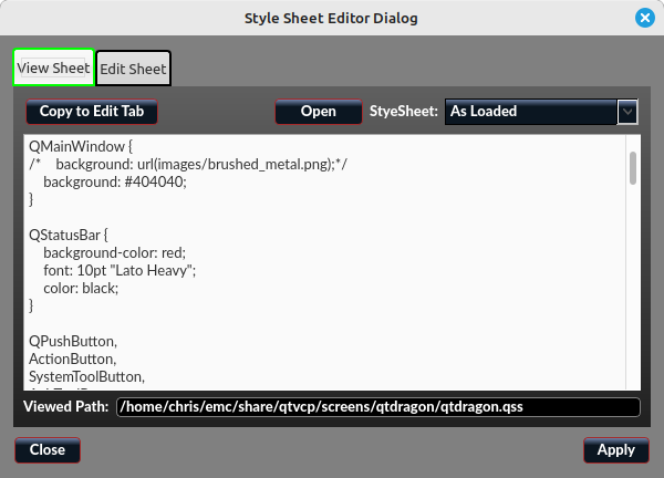

20.1. Stylesheets
Stylesheets can be leveraged to do a fair amount of customization, but you usually need to know a bit about the widget names. Pressing F12 will display a stylesheet editor dialog to load/test/save modification.
The View Sheet tab will allow you to select and apply what stylesheet QtDragon will use when it’s first loaded.
Press the button Copy to Edit Tab to copy the current stylesheet to the edit tab.
The Edit Sheet tab allows editing, applying and saving of changes od the displayed stylesheet.
QtDragon stylesheet editor
Sometimes these lines will be present and you can change them, otherwise you will need to add them.
