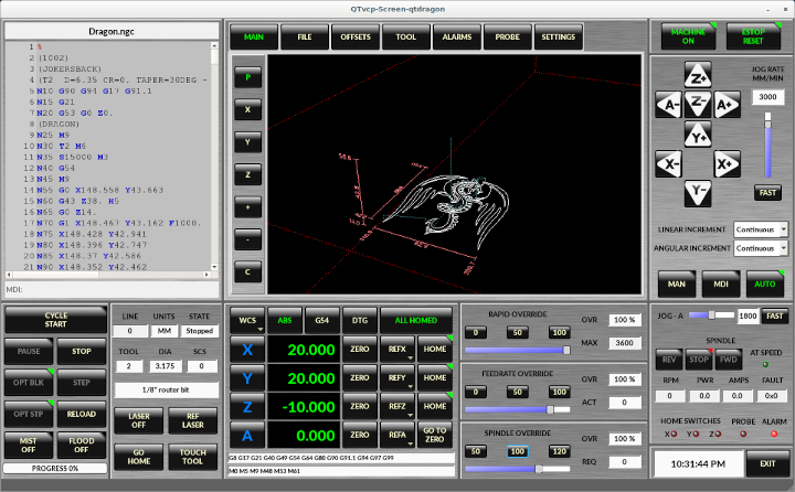

QtDragon Router
Figure 1. QtDragon - 3/4-Axis Sample

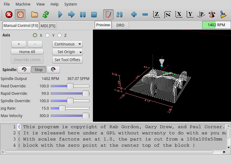

Qtscreen QtAxis
Figure 3. QtAxis - Self Adjusting Axis Sample

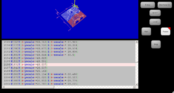

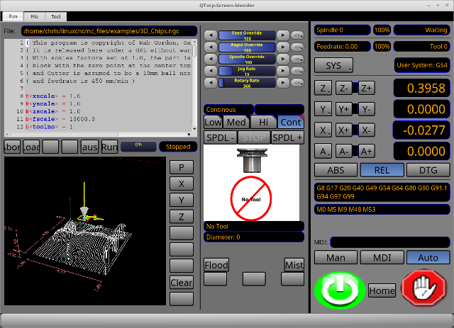

Qtscreen Blender
Figure 4. Blender - 4-Axis Sample

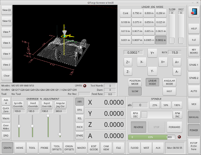

Figure 5. X1mill - 4-Axis Sample

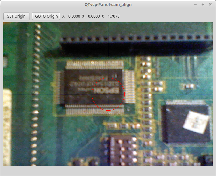

Qtscreen x1mill
Figure 6. cam_align - Camera Alignment VCP

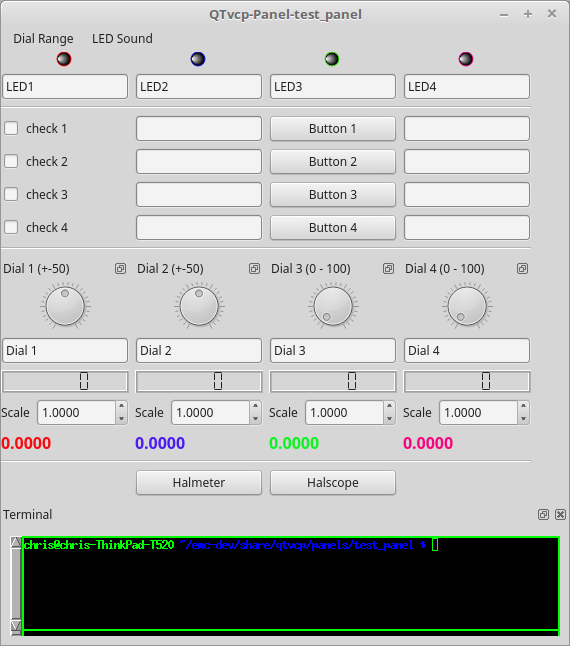

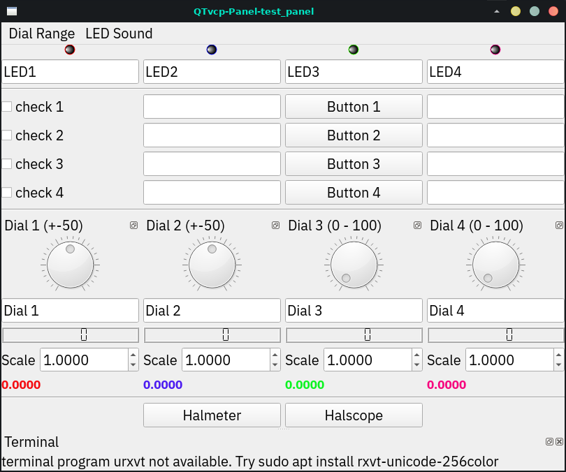

Test Panel
Figure 7. test_panel - Test Panel VCP

3. VCP Panels
QtVCP can be used to create control panels that interface with HAL.
3.1. Builtin Panels
There are several builtin HAL panels available.
In a terminal type qtvcp <return> to see a list:
test_panel
Collection of useful widgets for testing HAL components, including speech of LED state.
QtVCP HAL Test Builtin Panel
Figure 8. QtVCP HAL Test Builtin Panel
cam_align
A camera display widget for rotational alignment.
Qtscreen x1mill
Figure 9. cam_align - Camera Alignment VCP

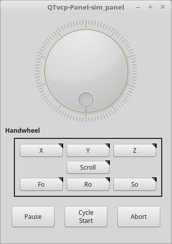

sim_panel
A small control panel to simulate MPG jogging controls etc.
For simulated configurations.
QtVCP Sim Builtin Panel
Figure 10. QtVCP Sim Builtin Panel
vismach_mill_xyz
3D OpenGL view of a 3-axis milling machine.
QtVismach - 3-Axis Mill Builtin Panel
Figure 11. QtVismach - 3-Axis Mill Builtin Panel
You can load these from the terminal or from a HAL file with this basic command:
loadusr qtvcp test_panel
But more typically like this:
loadusr -Wn test_panel qtvcp test_panel
In this way HAL will wait till the HAL pins are made before continuing on.

Add Action Buttons
Add 7 action buttons on to the main window.
If you double click the button, you can add text.
Edit the button labels for Estop, Machine On, Home, Load, Run, Pause and stop.
Action buttons default to no action so we must change the properties for defined functions. You can edit the properties:
  • directly in the property editor on the right side of Qt Designer, or
  • conveniently, left double clicking on the button to launch a properties dialog that allows selecting actions while only displaying relevant data to the action.
We will describe the convenient way first:
  • Right click the Machine On button and select Set Actions.
  • When the dialog displays, use the combobox to navigate to MACHINE CONTROLS - Machine On.
  • In this case there is no option for this action so select OK.
Now the button will turn the machine on when pressed.
And now the direct way with Qt Designer’s property editor:
  • Select the Machine On button.
  • Go to the Property Editor on the right side of Qt Designer.
  • Scroll down until you find the ActionButton heading.
  • Click the machine_on action checkbox you will see in the list of properties and values.
The button will now control machine on/off.
Do the same for all the other button with the addition of:
  • With the Home button we must also change the joint_number property to -1.
    This tells the controller to home all the axes rather then a specific axis.
  • With the Pause button:
    • Under the Indicated_PushButton heading check the indicator_option.
    • Under the QAbstactButton heading check checkable.
Qt Designer: Selecting Pause Button’s Properties
Figure 13. Qt Designer: Selecting Pause Button’s Properties
