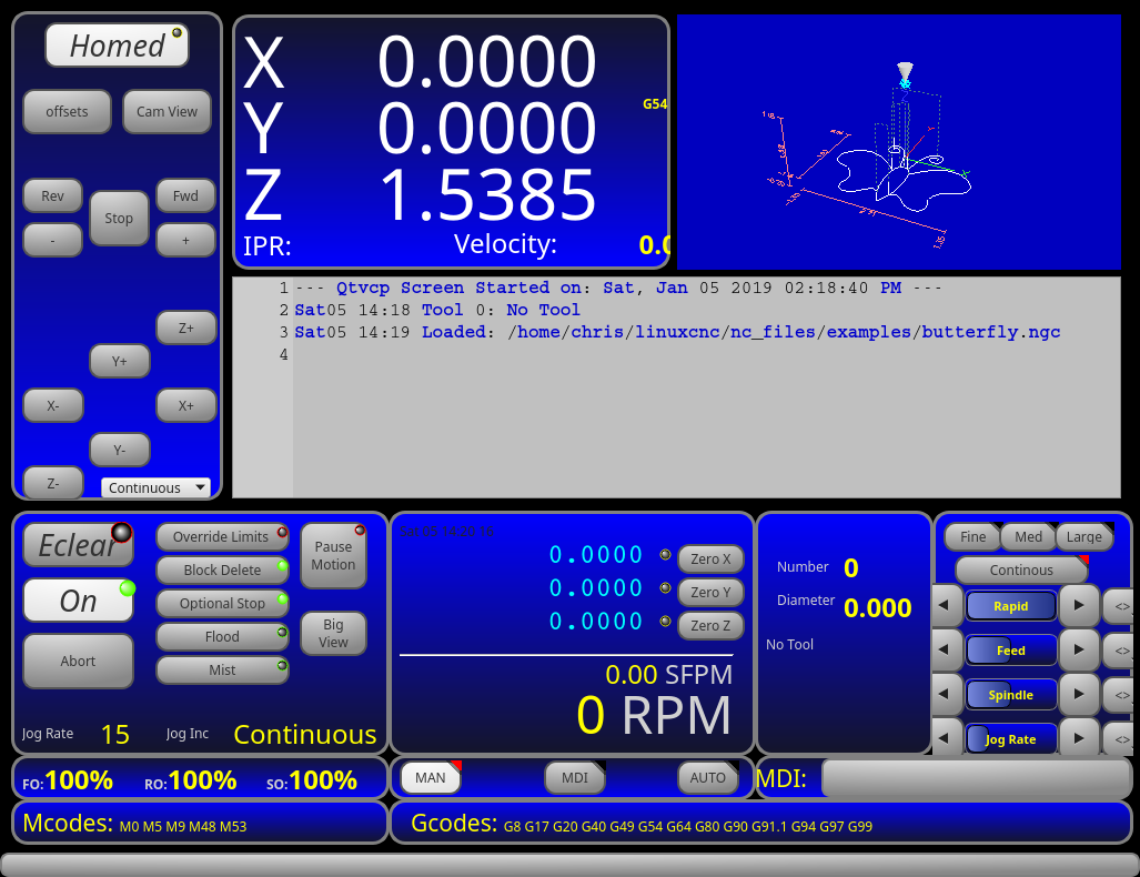

Qtscreen Mill
Figura 2. QtDefault - 3-Axis Sample

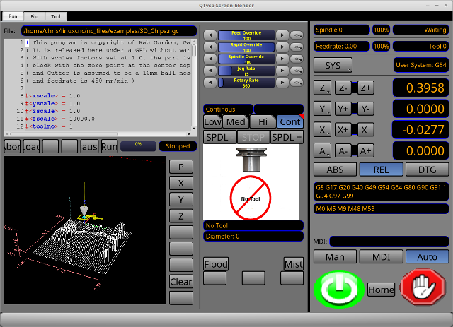

Qtscreen Blender
Figura 4. Blender - 4-Axis Sample

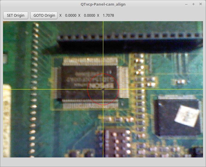

Qtscreen x1mill
Figura 6. cam_align - Camera Alignment VCP

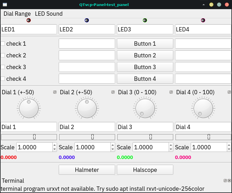

Test Panel
Figura 7. test_panel - Test Panel VCP

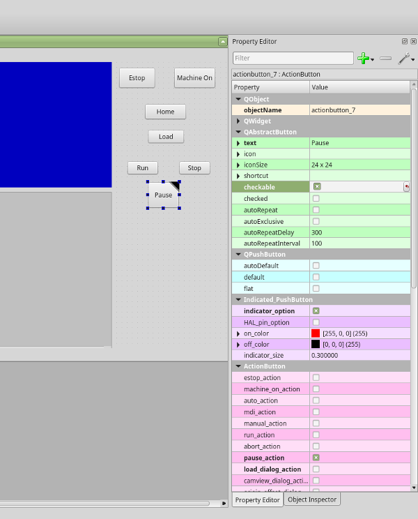

2.1. QtVCP Widgets
QtVCP uses the PyQt5 toolkit’s widgets for LinuxCNC integration.
Widget is the general name for user interface objects such as buttons and labels in PyQt5.
There are also special widgets made for LinuxCNC that make integration easier.
These are split in three heading on the left side of the editor:
  • Uno es para HAL only widgets;
  • One is for CNC control widgets;
  • Uno es para Widgets del diálogo.
A very important widget for CNC control is the ScreenOptions widget: It does not add anything visually to the screen but, allows important details to be selected rather then be coded in the handler file.

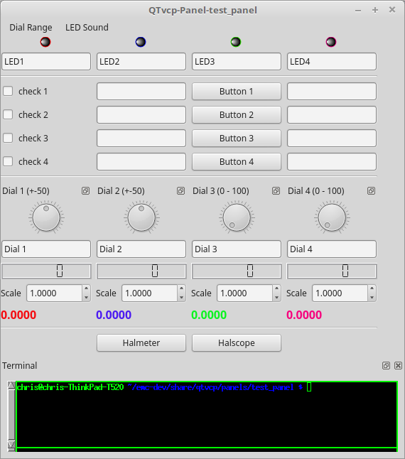

test_panel
Collection of useful widgets for testing HAL components, including speech of LED state.
QtVCP HAL Test Builtin Panel
Figura 8. QtVCP HAL Test Builtin Panel
cam_align
Un widget de visualización de cámara para alineación rotacional.
Qtscreen x1mill
Figura 9. cam_align - Camera Alignment VCP

Puede cargarlos desde la terminal o desde un archivo HAL con este comando básico:
loadusr qtvcp test_panel
But more typically like this:
loadusr -Wn test_panel qtvcp test_panel
In this way HAL will wait till the HAL pins are made before continuing on.

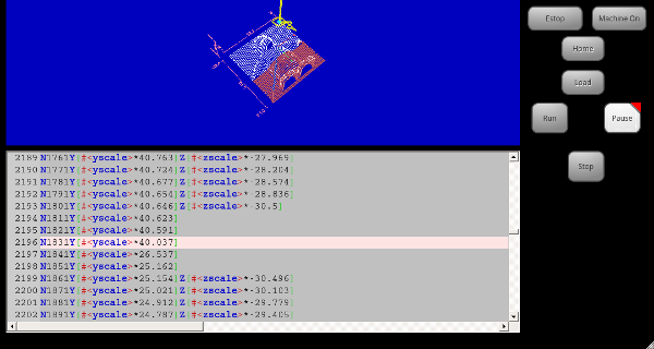

Add Action Buttons
Add 7 action buttons on to the main window.
If you double click the button, you can add text.
Edit the button labels for Estop, Machine On, Home, Load, Run, Pause and stop.
Action buttons default to no action so we must change the properties for defined functions. You can edit the properties:
  • directly in the property editor on the right side of Qt Designer, or
  • conveniently, left double clicking on the button to launch a properties dialog that allows selecting actions while only displaying relevant data to the action.
We will describe the convenient way first:
  • Haga clic derecho sobre el botón Encender máquina y seleccione Establecer acciones.
  • When the dialog displays, use the combobox to navigate to MACHINE CONTROLS - Machine On.
  • In this case there is no option for this action so select OK.
Now the button will turn the machine on when pressed.
Y ahora el camino directo con el editor de propiedades de Qt Designer:
  • Select the Machine On button.
  • Go to the Property Editor on the right side of Qt Designer.
  • Scroll down until you find the ActionButton heading.
  • Click the machine_on action checkbox you will see in the list of properties and values.
The button will now control machine on/off.
Do the same for all the other button with the addition of:
  • Con el botón Inicio también debemos cambiar la propiedad joint_number a -1.
    Esto le dice al controlador que lleve a casa a todos los ejes en lugar de un eje específico.
  • Con el botón Pause:
    • Under the Indicated_PushButton heading check the indicator_option.
    • Under the QAbstactButton heading check checkable.
Qt Designer: Selecting Pause Button's Properties
Figura 13. Qt Designer: Selecting Pause Button’s Properties
Save The .ui File
We then need to save this design as tester.ui in the sim/qtvcp folder.
We are saving it as tester as that is a file name that QtVCP recognizes and will use a built in handler file to display it.

When you have loaded your screen into Qt Designer, add a plain PushButton to the screen.
You could change the name of the button to something interesting like test_button.
There are two ways to edit connections - This is the graphical way.
  • There is a button in the top tool bar of Qt Designer for editing signals. After pushing it, if you click-and-hold on the button it will show an arrow (looks like a ground signal from electrical schematic).
  • Slide this arrow to a part of the main window that does not have widgets on it.
  • A Configure Connections dialog will pop up.
    • The list on the left are the available signals from the widget.
    • The list on the right are the available slots on the main window and you can add to it.
  • Pick the signal clicked() - this makes the slots side available.
  • Click Edit on the slots list.
  • A Slots/Signals of MainWindow dialog will pop up.
  • On the slots list at the top there is a + icon - click it.
  • You can now edit a new slot name.
  • Erase the default name slot() and change it to test_button().
  • Press the OK button.
  • You’ll be back to the Configure Connections dialog.
  • Ahora puede seleccionar su ranura nueva en la lista de ranuras.
  • Then press OK and save the file.
