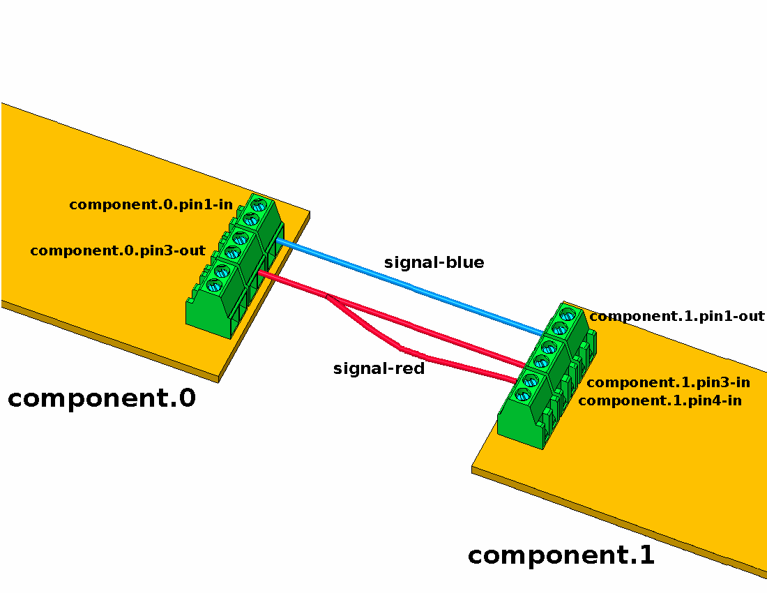

3. Diseño del sistema HAL
.HAL is based on traditional system design techniques.
HAL is based on the same principles that are used to design hardware circuits and systems, so it is useful to examine those principles first. Any system, including a CNC machine, consists of interconnected components. For the CNC machine, those components might be the main controller, servo amps or stepper drives, motors, encoders, limit switches, pushbutton pendants, perhaps a VFD for the spindle drive, a PLC to run a toolchanger, etc. The machine builder must aselect, mount and wire these pieces together to make a complete system.
Concepto de circuito HAL
Figure 1. Concepto de HAL - Conexiones como en un circuito eléctrico.
La figura se transcribe a código HAL de esta manera:
net signal-blue    component.0.pin1-in      component.1.pin1-out
net signal-red     component.0.pin3-out     component.1.pin3-in     component.1.pin4-in
