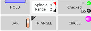

1.13. LED - Indicator Widget
QtVCP LED: LED Indicator Widget
Figura 5. QtVCP LED: LED Indicator Widget
A LED like indicator that optionally follows a HAL pin’s logic.
halpin_option
Selects if the LED follows an input HAL pin or program state.
diameter
Diámetro del LED (predeterminado a 15).
color
Color del LED cuando esta encendido (predeterminado a verde).
off_color
Color del LED cuando esta apagado (predeterminado a negro).
gradient
turns the gradient high light on or off (defaults to on).
on_gradient_color
Color highlight of the LED when on (defaults to white).
off_gradient_color
Color highlight of the LED when off (defaults to white).
alignment
Sugerencia de alineación de Qt.
state
Current state of LED
flashing
Enciende y apaga la opción de parpadeo.
flashRate
Sets the flash rate.
The LED properties can be defined in a stylesheet with the following code added to the .qss file, name_of_led being the widget name defined in Qt Designer’s editor:
LED #name_0f_led{
  qproperty-color: red;
  qproperty-diameter: 20;
  qproperty-flashRate: 150;

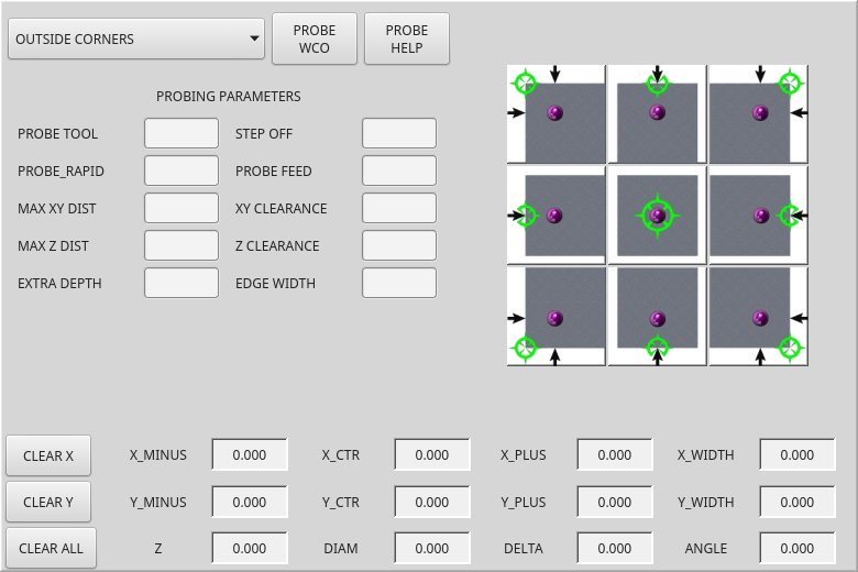

2.4. BasicProbe - Simple Mill Probing Widget
QtVCP BasicProbe: Simple Mill Probing Widget
Figura 6. QtVCP BasicProbe: Simple Mill Probing Widget
Widget for probing on a mill. Used by the QtDragon screen.

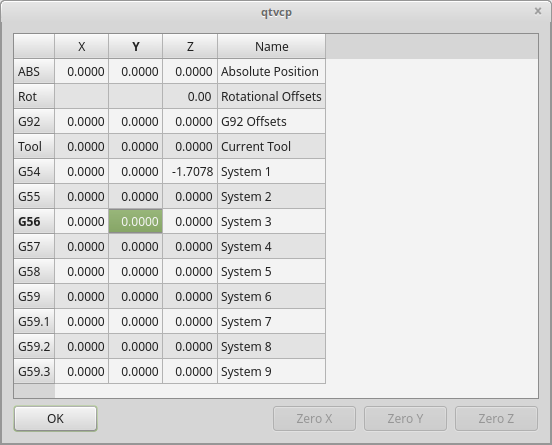

2.6. DROLabel - Axis Position Display Widget
Esto mostrará la posición actual de un eje.
También puede hacer clic en la etiqueta y ver una lista de acciones.

These are the click-on-menu options:
showLast
Muestra la acción Set to last.
showDivide
Show the Divide by 2 action.
showGotoOrigin
Show the Go to G53/G5x origin action.
showZeroOrigin
Show the Zero Origin action.
showSetOrigin
Show the Set Origin action.
dialogName
Sets which dialog window will pop up with numerical entry, i.e. ENTRY or CALCULATOR.

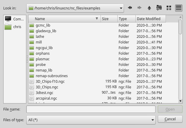

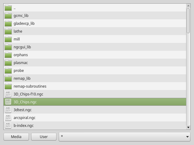

2.7. FileManager - File Loading Selector Widget
QtVCP FileManager: File Loading Selector Widget
Figura 7. QtVCP FileManager: File Loading Selector Widget
This widget is used to select files to load.
It has a the ability to scroll the names with hardware such as a MPG.
One can class patch the function load(self,fname) to customize file loading.
The function getCurrentSelected() will return a Python tuple, containing the file path and whether it is a file.
temp = FILEMANAGER.getCurrentSelected()
print('filepath={}'.format(temp[0]))
if temp[1]:
    print('Is a file')
Stylesheets Properties
doubleClickSelection (bool)
Determines whether or not to require double clicking on a folder.
Single clicking a folder (False) is enabled by default and is intended for touch screen users.
The following shows an example of how to set this property:
#filemanager {
    qproperty-doubleClickSelection: True;
showListView (bool)
Determines whether or not to show the file/folder structure in list form.
Table view (False) is enabled by default.
#filemanager {
    qproperty-showListView: True;
It is based on PyQt’s FIXME

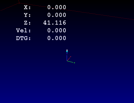

2.10. GCodeGraphics - G-code Graphic Backplot Widget
QtVCP GcodeGraphics: G-code Graphic Backplot Widget
Figura 8. QtVCP GcodeGraphics: G-code Graphic Backplot Widget
This displays the current G-code in a graphical form.
dro-font/dro-large-font (string)
Sets the small and large DRO font properties
Here we reference with the widget base name; GCodeGraphics
GCodeGraphics{
    qproperty-dro_font:"monospace  bold 12";
GCodeGraphics{
    qproperty-dro_large_font:"Times 25";
_view (string)
Sets the default view orientation on GUI load.
Valid choices for a lathe are p, y, y2. For other screens, valid choices are p, x, y, z, z2.
The following shows an example of how to set this property (referenced using the widget user selected name):
#gcodegraphics{
    qproperty-_view: z;
_dro (bool)
Determines whether or not to show the DRO.
#gcodegraphics{
    qproperty-_dro: False;
_dtg (bool)
Determine whether or not to show the Distance To Go.
#gcodegraphics{
    qproperty-_dtg: False;
_metric (bool)
Determines whether or not to show the units in metric by default.
#gcodegraphics{
    qproperty-_metric: False;
_overlay (bool)
Determines whether or not to show the overlay by default.
#gcodegraphics{
    qproperty-_overlay: False;
_offsets (bool)
Determines whether or not to show the offsets by default.
#gcodegraphics{
    qproperty-_offsets: False;
_small_origin (bool)
Determines whether or not to show the small origin by default.
#gcodegraphics{
    qproperty-_small_origin: False;
overlay_color (primary, secondary, or RGBA formatted color)
Sets the default overlay color.
#gcodegraphics{
    qproperty-overlay_color: blue;
overlay_alpha (float)
Sets the default overlay alpha value. This affects the opacity of the overlay when set between 0.0 and 1.0.
#gcodegraphics{
    qproperty-overlay_alpha: 0.15;
background_color (primary, secondary, or RGBA formatted color)
Sets the default background color.
#gcodegraphics{
    qproperty-background_color: blue;
+_use_gradient_background+ (bool)
Determines whether or not use a gradient background by default.
#gcodegraphics{
    qproperty-_use_gradient_background: False;
jog_color (primary, secondary, or RGBA formatted color)
Sets the default jog color.
#gcodegraphics{
    qproperty-jog_color: red;
Feed_color (primary, secondary, or RGBA formatted color)
Sets the default feed color.
#gcodegraphics{
    qproperty-Feed_color: green;
Rapid_color (primary, secondary, or RGBA formatted color)
Sets the default rapid color.
#gcodegraphics{
    qproperty-Rapid_color: rgba(0, 0, 255, .5);
InhibitControls (bool)
Determines whether or not to inhibit external controls by default.
#gcodegraphics{
    qproperty-InhibitControls:True;
MouseButtonMode (int)
Changes the mouse button behavior to rotate, move or zoom within the preview.
#gcodegraphics{
    qproperty-MouseButtonMode: 1;
There are 12 valid modes:
Mode
Move
Zoom
Rotate
0
Left
Middle
Right
1
Middle
Right
Left
2
Middle
Left
Right
3
Left
Right
Middle
4
Right
Left
Middle
5
Right
Middle
Left
Modes 6-11 are intended for machines that only require a 2D preview such as plasma or some lathes and have no rotate button assigned.
Mode
Move
Zoom
6
Left
Middle
7
Middle
Left
8
Right
Left
9
Left
Right
10
Middle
Right
11
Right
Middle
MouseWheelInvertZoom (bool)
Determines whether or not to invert the zoom direction when zooming with the mouse wheel.
#gcodegraphics{
    qproperty-MouseWheelInvertZoom:True;
ACTION functions
The ACTION library can control the G-code graphics widget.
ACTION.RELOAD_DISPLAY()
Reload the current program which recalculates the origin/offsets.
ACTION.SET_GRAPHICS_VIEW(_view_)
The following view commands can be sent:
  • clear
  • zoom-in
  • zoom-out
  • pan-up
  • pan-down
  • pan-right
  • pan-left
  • rotate-cw
  • rotate-ccw
  • rotate-up
  • rotate-down
  • overlay-dro-on
  • overlay-dro-off
  • overlay-offsets-on
  • overlay-offsets-off
  • alpha-mode-on
  • alpha-mode-off
  • inhibit-selection-on
  • inhibit-selection-off
  • dimensions-on
  • dimensions-off
  • grid-size
  • record-view
  • set-recorded-view
  • P
  • X
  • Y
  • Y2
  • Z
  • Z2
  • set-large-dro
  • set-small-dro
ACTION.ADJUST_PAN(_X,Y_)
Directly set the relative pan of view in x and y direction.
ACTION.ADJUST_ROTATE(_X,Y_)
Directly set the relative rotation of view in x and y direction.
It is based on PyQt’s OpenGL widget.

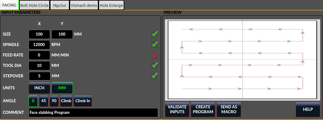

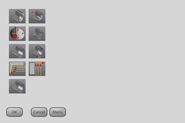

2.13. MacroTab - Special Macros Widget
QtVCP MacroTab: Special Macros Widget
Figura 9. QtVCP MacroTab: Special Macros Widget
This widget allows a user to select and adjust special macro programs for doing small jobs.
It uses images for visual representation of the macro and for an icon.
It searches for special macros using the INI definition:
[RS274NGC]
SUBROUTINE_PATH =
The macros are O-word subroutines with special comments to work with the launcher. The first three lines must have the keywords below, the fourth is optional.
Here is a sample for the first four lines in an O-word file:
; MACROCOMMAND = Entry1,Entry2
; MACRODEFAULTS = 0,true
; MACROIMAGE = my_image.svg,Icon layer number,Macro layer number
; MACROOPTIONS = load:yes,save:yes,default:default.txt,path:~/macros
MACROCOMMAND
This is the first line in the O-word file.
It is a comma separated list of text to display above an entry.
There will be one for every variable required in the O-word function.
If the macro does not require variables, leave it empty:
; MACROCOMMAND=
MACRODEFAULTS
This must be the second line in the O-word file.
It is a comma separated list of the default values for each variable in the O-word function.
If you use the word radiotrue, radiofalse, true or false in the list, a *radiobutton* will be shown.
If you use the word checktrue or checkfalse in the list, a *checkbox* will be shown.
If you use the word buttontrue or buttonfalse in the list, a *Checkable Pushbutton* will be shown.
If the default has a decimal, macroTab assumes you want a float value otherwise an integer.
Nota
When using radiobuttons, only set one radiobutton as true. Radio button are used for exclusive choices.
MACROIMAGE
This must be the third line in the O-word file.
  • SVG Images
    If using SVG image files, they must end with the .svg extension.
    The images must be added to SVG layers which are used to define the different images for macro and icon.
    Value is comma separated list of three ordered fields:
    ; MACROIMAGE=filename.svg,macro_layer_name[,icon_layer_name]
    With:
    _filename_.svg
    SVG image file name as first field.
    It is assumed to be in the same folder as the O-word file.
    *macro_layer_name
    Macro image layer name as second field.
    icon_layer_name
    Icon image layer name as optional third field. If the third entry is missing, the same image will be used for macro and icon.
  • PNG/JPG Images:
    Value remains a comma separated list:
    ; MACROIMAGE=macro_image.(png|jpg)[,icon_image.(png|jpg)]
    With:
    _macro_image_.(png|jpg)
    Macro image file name as first field.
    It is assumed that the image file are in the same folder than the macro.
    _icon_image_.(png|jpg)
    Icon image file name as optional second field.
    If the second entry is missing the same image will be used for macro and image.
If the keyword is present but the entries are missing, no images will be used.
MACROOPTIONS
This optional line must be the fourth line in the O-word file.
It is a comma separated list of keyword and data, all of which are optional:
LOAD:yes
Shows a load button.
SAVE:yes
Shows a save button.
DEFAULT:ThisMacroData.txt
Sets the default preselected filename when loading/saving data for this macro.
It can be any valid filename but must end in .txt.
PATH:~/linuxcnc/nc_files/mySavedMacrosData
Sets the default directory folder to preselect when loading/saving data for this macro.

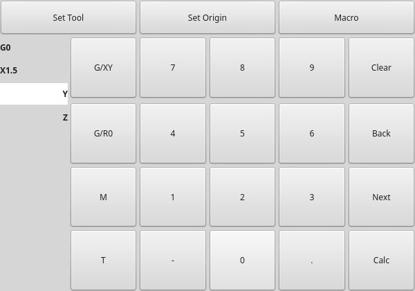

2.17. MDITouchy - Touch Screen MDI Entry Widget
QtVCP MDITouchy: Touch Screen MDI Entry Widget
Figura 10. QtVCP MDITouchy: Touch Screen MDI Entry Widget
This widget displays buttons and entry lines to use for entering MDI commands.
Based on LinuxCNC’s Touchy screen’s MDI entry process, its large buttons are most useful for touch screens.
Para usar MDITouchy:
  • First press one of the G/XY, G/RO, M or T button. On the left will show the entry fields that can be filled out.
  • Then press Next and Back to navigate between fields.
  • Calc will pop up a calculator dialog.
  • Clear limpia la entrada actual.
  • Set Tool invocará un cambio de herramienta.
  • Set Origin will allow setting the origin of the current G6x system.
  • Macro will call any available macro ngc programs.
The widget requires an explicit call to MDITouchy Python code to actually run the MDI command:
  • For handler file code
    If the widget was named mditouchy in Qt Designer, the command below would run the displayed MDI command:
    self.w.mditouchy.run_command()
  • For action button use
    If the widget was named mditouchy in Qt Designer, use the action button’s Call Python commands option and enter:
    INSTANCE.mditouchy.run_command()

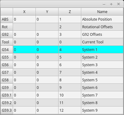

2.18. OriginOffsetView - Origins View and Setting Widget
QtVCP OriginOffsetsView: Origins View and Setting Widget
Figura 11. QtVCP OriginOffsetsView: Origins View and Setting Widget
This widget allows one to visualize and modify User System Origin offsets directly.
It will update LinuxCNC’s Parameter file for changes made or found.
The settings can only be changed in LinuxCNC after homing and when the motion controller is idle.
The display and entry will change between metric and imperial, based on LinuxCNC’s current G20 / G21 setting.
The current in-use user system will be highlighted.
Extra actions can be integrated to manipulate settings.
These actions depend on extra code added either to a combined widget, like originoffsetview dialog, or the screens handler code.
Typical actions might be Clear Current User offsets or Zero X.
Clicking on the columns and rows allows one to adjust the settings.
A dialog can be made to popup for data or text entry.
The comments section will be recorded in the preference file.
It is based on PyQt’s QTableView, QAbstractTableModel, and ItemEditorFactory.
Properties, functions and styles of the PyQt base objects are always available.
Properties
OriginOffsetView has the following properties:
dialog_code_string
Sets which dialog will pop up with numerical entry.
test_dialog_code_string
Sets which dialog will pop up with text entry.
metric_template
Metric numerical data format.
imperial_template
Imperial numerical data format.
styleCodeHighlight
Current in-use user system highlight color.
These can be set in:
  • Qt Designer, in
  • Python handler code
    self.w.originoffsetview.setProperty('dialog_code','CALCULATOR')
    self.w.originoffsetview.setProperty('metric_template','%10.3f')
  • Or (if appropriate) in stylesheets
    OriginOffsetView{
      qproperty-styleColorHighlist: lightblue;

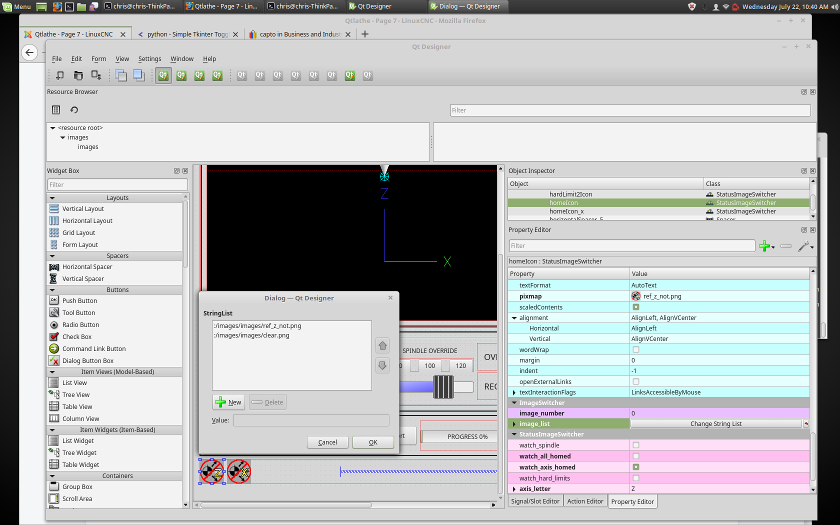

2.23. StatusImageSwitcher - Controller Status Image Switcher
Status image switcher will switch between images based on LinuxCNC states.
*watch_spindle
Toggles between 3 images: stop, fwd, revs.
*watch_axis_homed
Toggles between 2 images: axis not homed, axis homed.
*watch_all_homed
Would toggle between 2 images: not all homed, all homed.
*watch_hard_limits
Would toggle between 2 images or one per joint.
Here is an example of using it to display an icon of Z axis homing state:
QtVCP StatusImageSwitcher: Controller Status Image Switcher
Figura 12. QtVCP StatusImageSwitcher: Controller Status Image Switcher
In the properties section notice that:
  • watch_axis_homed is checked
  • axis_letter is set to Z
If you double click the image_list a dialog will show and allow you to add image paths to.
If you have one image as an icon and one clear image then that will look like it shows and hides the icon.
Selecting image paths can be done by selecting the pixmap property and selecting an image.
Nota
The pixmap setting is for test display only and will be ignored outside of Qt Designer.
  • Right click the image name and you should see Copy path.
  • Click Copy path.
  • Now double click the image list property so the dialog shows.
  • Click the New button.
  • Paste the image path in the entry box.
Do that again for the next image.
Use a clear image to represent a hidden icon.
You can test the images display from the image list by changing the image number. In this case 0 is unhomed and 1 would be homed.
This is for test display only and will be ignored outside of Qt Designer.

2.28. StatusAdjustmentBar - Controller Value Setting Widget
This widget allows setting values using buttons while displaying a bar.
It also has an optional hi/low toggle button that can be held down to set the levels.
The widget can adjust:
  • Jog rate
  • Angular jog rate
  • Velocidad de alimentación
  • Spindle override rate
  • Rapid override rate
It is based on PyQt’s QProgressBar.

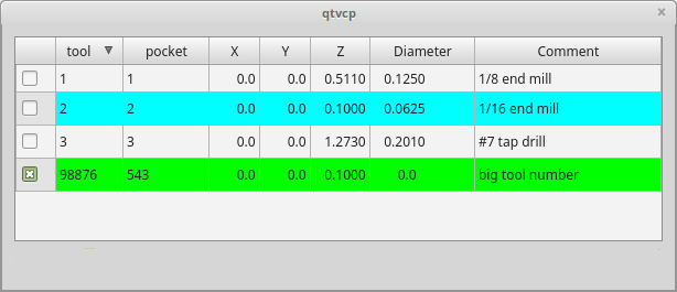

2.32. ToolOffsetView - Tools Offsets View And Edit Widget
QtVCP ToolOffsetView: Tools Offsets View And Edit Widget
Figura 13. QtVCP ToolOffsetView: Tools Offsets View And Edit Widget
This widget displays and allows one to modify tools offsets.
It will update LinuxCNC’s tool table for changes made or found.
The tool settings can only be changed in LinuxCNC after homing and when the motion controller is idle.
The display and entry will change between metric and imperial based on LinuxCNC’s current G20/G21 setting.
The current in-use tool will be highlighted, and the current selected tool will be highlighted in a different color.
The checkbox beside each tool can be used to select too for an action that depends on extra code added either to a combined widget, like the toolOffsetView dialog or the screens handler code.
Typical actions are load selected tool, delete selected tools, etc.
The comments section will typically be displayed in the manual tool change dialog.
If using a lathe configuration, there can be columns for X and Z wear.
To use these columns to adjust the tool wear, it requires a remapped tool change routine.

2.33. VersaProbe - Mill Probing Widget
QtVCP VersaProbe: Mill Probing Widget
Figura 14. QtVCP VersaProbe: Mill Probing Widget

3.3. FileDialog - Load and Save File Chooser Dialog Widget
QtVCP FileDialog: Load and Save File Chooser Widget
Figura 16. QtVCP FileDialog: Load and Save File Chooser Widget
Se usa para cargar archivos de código G.
If there is a Focus Overlay widget present, it will signal it to display.
When using STATUS 's request-dialog function, the default launch names are LOAD or SAVE.
There are options that can be set when requesting a dialog, these would be added to the message dict:
EXTENSIONS
FILENAME
DIRECTORY
An example Python call, for a load dialog:
mess = {'NAME':'LOAD','ID':'_MY_DIALOG_',
            'TITLE':'Load Some text File',
            'FILENAME':'~/linuxcnc/nc_files/someprogram.txt',
            'EXTENSIONS':'Text Files (*.txt);;ALL Files (*.*)'
ACTION.CALL_DIALOG(mess)

3.4. OriginOffsetDialog - Origin Offset Setting Dialog Widget
QtVCP `OriginOffsetDialog`: Origin Offset Setting Widget
Figura 17. QtVCP OriginOffsetDialog: Origin Offset Setting Widget
This widget allows one to modify User System origin offsets directly in a dialog form.
If there is an Focus Overlay widget present, it will signal it to display.
When using STATUS 's request-dialog function, the default launch name is ORIGINOFFSET.
It is based on PyQt’s QDialog.

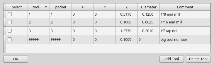

3.5. ToolOffsetDialog - Tool Offset Setting Dialog Widget
QtVCP `ToolOffsetDialog`: Tool Offset Setting Dialog Widget
Figura 18. QtVCP ToolOffsetDialog: Tool Offset Setting Dialog Widget
This widget allows one to modify Tool offsets directly in a dialog form.
When using STATUS 's request-dialog function, the default launch name is TOOLOFFSET.

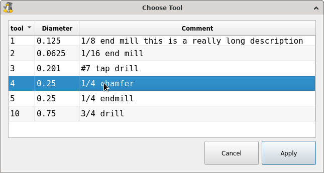

3.6. ToolChooserDialog - Tool Chooser Dialog Widget
QtVCP `ToolChooserDialog`: Tool Chooser Dialog Widget
Figura 19. QtVCP ToolChooserDialog: Tool Chooser Dialog Widget
This widget allows the operator to select one of the tools defined in the tool table. If a tool is selected and Apply is pressed or the tool is double-clicked, the dialog will return the tool number selected. This can be used in conjunction with the OperatorValueLine widget to create a tool change widget, for example.
When using STATUS 's request-dialog function, the default launch name is TOOLCHOOSER.

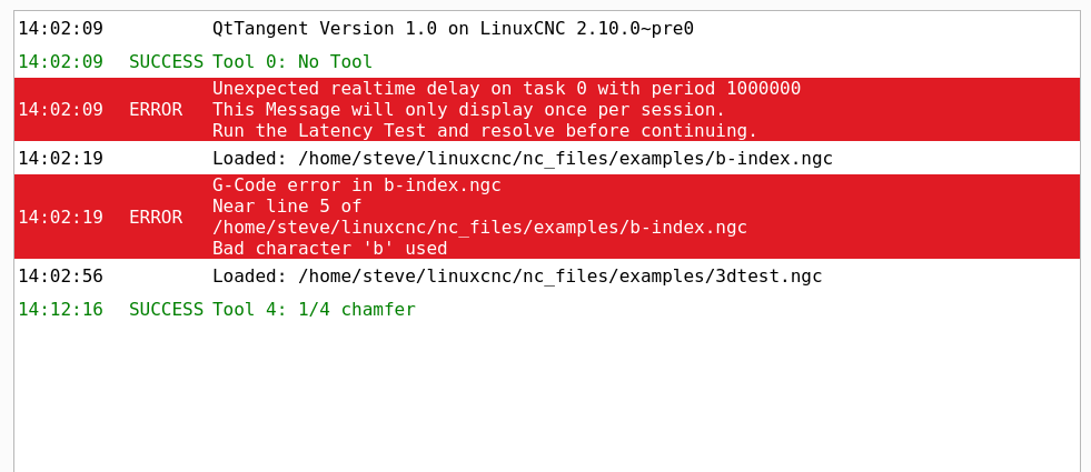

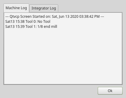

3.7. MachineLog - Machine Events Journal Display Widget
This widget displays various log event messages that have been output by the system during the current session. This includes informational messages as well as errors.
QtVCP `MachineLog`: Machine Log Widget
Figura 20. QtVCP MachineLog: Machine Events Log in machine_log (plain) mode
Figura 21. QtVCP MachineLog: Machine Events Log in machine_log_severity mode
Two distinct types of logs may be displayed:
  • machine log (plain text or severity highlighted)
  • integrator log (plain text only)
The type of log shown by the widget is controlled by the option properties of the widget. By selecting machine_log_option or integrator_log_option the appropriate log will be displayed. These options will display plain styled logs in a Qt QTextEdit widget.
Additionally, there is a machine_log_severity_option property that may be chosen that will display the machine log in a variety of colors depending on the severity of the message, by using a QTableWidget. The colors may be configured with the properties of the widget.
3.7.1. Emitting Log messages with Severity
Severity is conveyed via the option value sent along with the STATUS signal called update-machine-log. The option parameter is a comma-delimited list, containing typically
``` text = an error has occurred. STATUS.emit(update-machine-log, text, TIME,ERROR) ```
3.7.2. Clearing the Log
The log may be cleared by calling the clear() method of the widget.

3.14. MachineLogDialog - Machine and Debugging Logs Dialog Widget
QtVCP MachineLogDialog: Machine and Debugging Logs Dialog Widget
Figura 25. QtVCP MachineLogDialog: Machine and Debugging Logs Dialog Widget
This is a dialog to display the machine log and QtVCP’s debugging log.

QtVCP IndicatedPushButton: Indicated Action Button, LED Indicator Option
Figura 27. QtVCP PushButton: IndicatedPushButton Button, LED Indicator Option
It can be a triangle, circle, top bar, or side bar.
The triangle and circle LEDs can display double vertical LEDs optionally each with it’s own HAL pin. + The size and position can be adjusted.
It will indicate:
  • the current state of the button, or
  • el estado de un pin HAL, o
  • estado de LinuxCNC.

6.3. Facing
QtVCP Facing: Shown from QtDragon
Slab or face a definable area with different strategies.

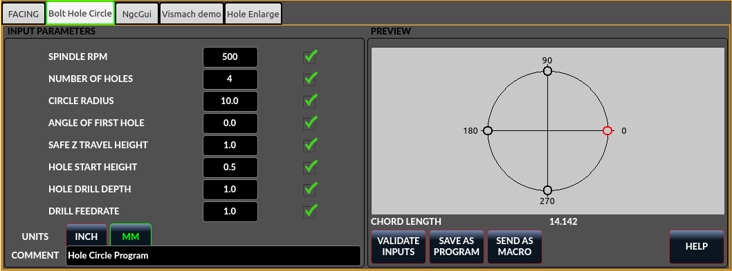

6.4. Hole Circle
QtVCP BHC: Shown from QtDragon
Drill multiple holes on a bolt hole circle.

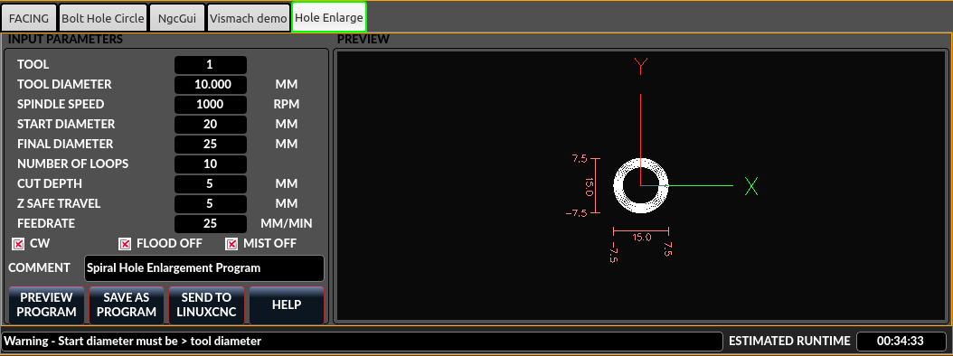

6.5. Hole Enlarge
Use an end mill to enlarge a drilled hole.
6.6. Qt NGCGUI
QtVCP NGCGUI: Shown from QtDragon
QtVCP’s version of NGC subroutine selector (Shown as used in QtDragon).

6.6.3. Adding Custom Subroutines

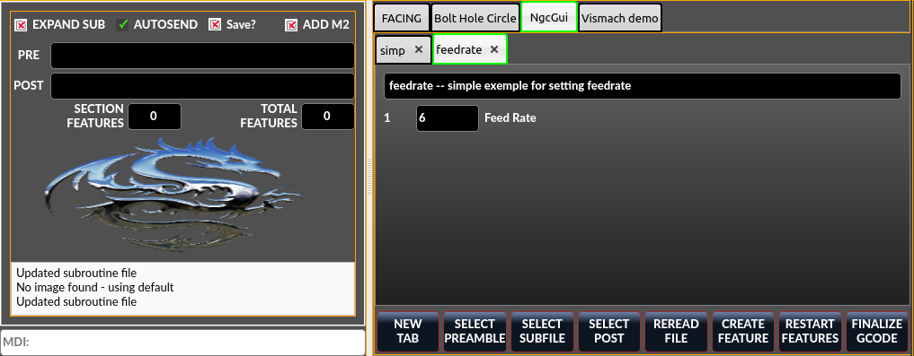

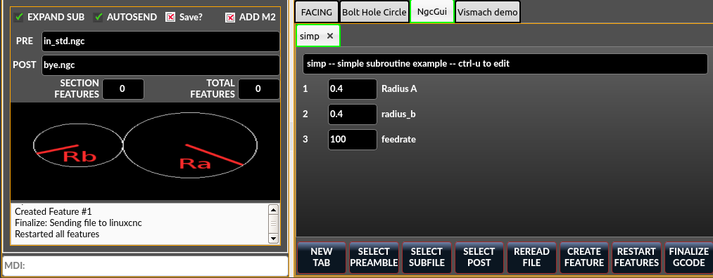

You can create your own subroutines for use with NGCGUI. They must follow these rules:
  • For creating a subroutine for use with NGCGUI, the filename and the subroutine name must be the same.
  • The subroutine must be in a folder within LinuxCNC’s INI designated search path.
  • En la primer línea puede estar un comentario de tipo información:
  • The subroutine must be surrounded by the sub and endsub tags.
  • The variables used must be numbered variables and must not skip number.
  • Comments and presets may be included.
  • If an image file of the same name is in the folder, it will be shown.
(info: feedrate -- simple example for setting feedrate)
o<feedrate> sub
    #<feedrate>       = #1 (= 6 Feed Rate) ; comments in brackets will be shown in ngcui
    f#<feedrate>
o<feedrate> endsub
