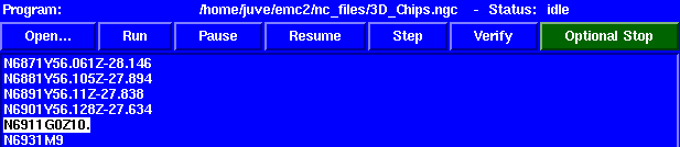

3.4. TkLinuxCNC Interpreter / Automatic Program Control
TkLinuxCNC Interpreter / program control
Control Buttons
The buttons in the lower part of TkLinuxCNC are used to control the execution of a program:
+ * Open to load a program, * Verify to check it for errors, * Run to start the actual cutting, * Pause to stop it while running, * Resume to resume an already paused program, * Step to advance one line in the program and * Optional Stop to toggle the optional stop switch (if the button is green the program execution will be stopped on any M1 encountered).
Text Program Display Area
When the program is running, the line currently being executed is highlighted in white. The text display will automatically scroll to show the current line.
