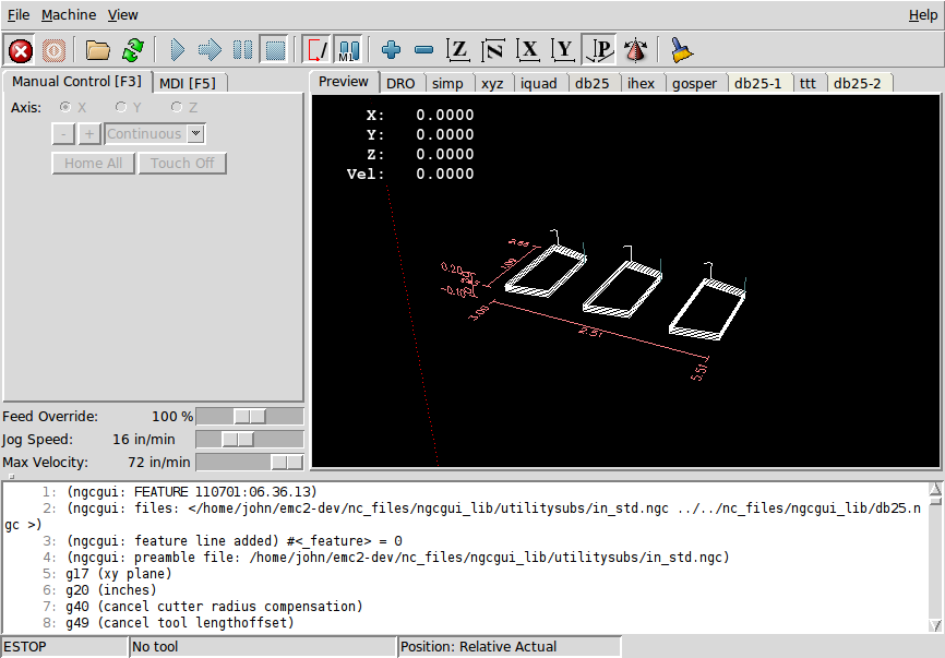

Figure 1. NGCGUI embedded into AXIS

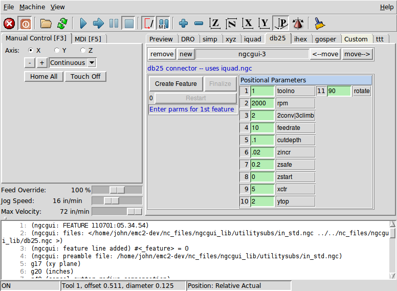

Using NGCGUI or PyNGCGUI:
  • Tab pages are provided for each subroutine specified in the INI file.
  • New subroutines tab pages can be added on the fly using the custom tab.
  • Each subroutine tab page provides entry boxes for all subroutine parameters.
  • The entry boxes can have a default value and an label that are identified by special comments in the subroutine file.
  • Subroutine invocations can be concatenated together to form a multiple step program.

To try a demonstration, select a sim configuration and start the LinuxCNC program.
If using the AXIS GUI, press the E-Stop images/tool_estop.png then Machine Power images/tool_power.png then Home All. Pick a NGCGUI tab, fill in any empty blanks with sensible values and press Create Feature then Finalize. Finally press the Run images/tool_run.png button to watch it run. Experiment by creating multiple features and features from different tab pages.

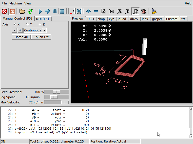

To create several subroutines concatenated into a single file, go to each tab fill in the blanks, press Create Feature then using the arrow keys move any tabs needed to put them in order. Now press Finalize and answer the prompt to create

  • GCMC_INCLUDE_PATH = dirname1:dirname2 - search directories for gcmc include files
This is an example of embedding NGCGUI into AXIS. The subroutines need to be in a directory specified by the [RS274NGC]SUBROUTINE_PATH. Some example subroutines use other subroutines so check to be sure you have the dependences, if any, in a SUBROUTINE_PATH directory. Some subroutines may use custom M-files which must be in a directory specified by the [RS274NGC]USER_M_PATH.
The G-code-meta-compiler (gcmc) can include statements like:
include("filename.inc.gcmc");
By default, gcmc includes the current directory which, for LinuxCNC, will be the directory containing the LinuxCNC INI file. Additional directories can be prepended to the gcmc search order with the GCMC_INCLUDE_PATH item.
Sample AXIS-GUI-based INI
[RS274NGC]
SUBROUTINE_PATH   = ../../nc_files/ngcgui_lib:../../ngcgui_lib/utilitysubs
USER_M_PATH       = ../../nc_files/ngcgui_lib/mfiles
[DISPLAY]
TKPKG             = Ngcgui    1.0
TKPKG             = Ngcguittt 1.0
# Ngcgui must precede Ngcguittt
NGCGUI_FONT       = Helvetica -12 normal
# specify filenames only, files must be in [RS274NGC]SUBROUTINE_PATH
NGCGUI_PREAMBLE   = in_std.ngc
NGCGUI_SUBFILE    = simp.ngc
NGCGUI_SUBFILE    = xyz.ngc
NGCGUI_SUBFILE    = iquad.ngc
NGCGUI_SUBFILE    = db25.ngc
NGCGUI_SUBFILE    = ihex.ngc
NGCGUI_SUBFILE    = gosper.ngc
# specify "" for a custom tab page
NGCGUI_SUBFILE    = ""
#NGCGUI_SUBFILE   = "" use when image frame is specified if
#                      opening other files is required
#                      images will be put in a top level window
NGCGUI_OPTIONS    =
#NGCGUI_OPTIONS   = opt1 opt2 ...
# opt items:
#   nonew      -- disallow making a new custom tab
#   noremove   -- disallow removing any tab page
#   noauto     -- no auto send (makeFile, then manually send)
#   noiframe   -- no internal image, image on separate top level
GCMC_INCLUDE_PATH = /home/myname/gcmc_includes
TTT               = truetype-tracer
TTT_PREAMBLE      = in_std.ngc
PROGRAM_PREFIX    = ../../nc_files
Note
The above is not a complete AXIS GUI INI — the items show are those used by NGCGUI. Many additional items are required by LinuxCNC to have a complete INI file.

Each defining statement may optionally include a special comment and a default value for the parameter.
Statement Prototype
#<vname> = #n (=default_value)
or
#<vname> = #n (comment_text)
or
#<vname> = #n (=default_value comment_text)
Parameter Examples
#<xparm> = #1 (=0.0)
#<yparm> = #2 (Ystart)
#<zparm> = #3 (=0.0 Z start setting)
If a default_value is provided, it will be entered in the entry box for the parameter on startup. If comment_text is included, it will be used to identify the input instead of the parameter name.

The following shows the DB25 subroutine. In the first photo you see where you fill in the blanks for each variable.
images/ngcgui-db25-1.png
This photo shows the backplot of the DB25 subroutine.
images/ngcgui-db25-2.png
This photo shows the use of the new button and the custom tab to create three DB25 cutouts in one program.
images/ngcgui-db25-3.png
