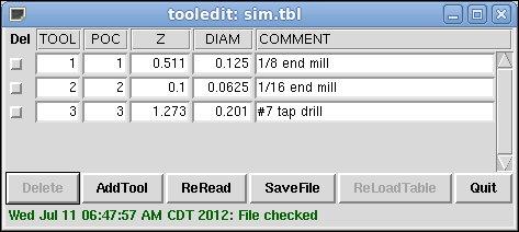

Tool Edit GUI - Overview
Figure 1. Tool Edit GUI - Overview
The tooledit program can update the tool table file with edited changes by using the SaveFile button. The SaveFile button updates the system file but a separate action is required to update the tool table data used by a running LinuxCNC instance. With the AXIS GUI, both the file and the current tool table data used by LinuxCNC can be updated with the ReloadTable button. This button is enabled only when the machine is ON and IDLE.

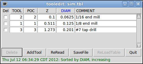

2. Column Sorting
The tool table display can be sorted on any column in ascending order by clicking on the column header. A second click sorts in descending order. Column sorting requires that the machine is configured with the default Tcl version >= 8.5.
Tool Edit GUI - Column Sorting
Figure 2. Tool Edit GUI - Column Sorting
In Ubuntu Lucid 10.04 Tcl/Tk8.4 it is installed by default. The installation is performed as follows:
sudo apt-get install tcl8.5 tk8.5
Depending upon other applications installed on the system, it may be necessary to enable Tcl/Tk8.5 with the commands:
sudo update-alternatives --config tclsh  ;# select the option for tclsh8.5
sudo update-alternatives --config wish   ;# select the option for wish8.5

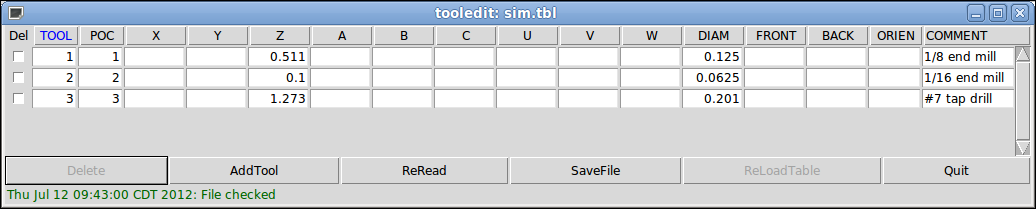

3. Columns Selection
By default, the tooledit program will display all possible tool table parameter columns. Since few machines use all parameters, the columns displayed can be limited with the following INI file setting:
Syntax of INI file
[DISPLAY]
TOOL_EDITOR = tooledit column_name column_name ...
Example for Z and DIAM columns
[DISPLAY]
TOOL_EDITOR = tooledit Z DIAM
Tool Edit GUI - Columns Selection Example
Figure 3. Tool Edit GUI - Columns Selection Example
