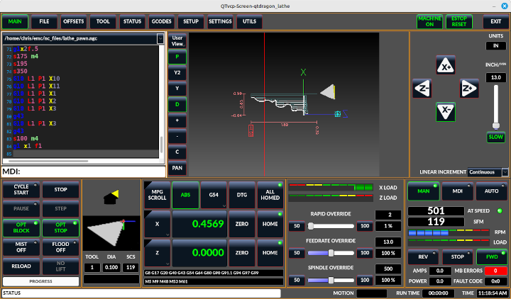

1.2. QtDragon_lathe
QtDragon Lathe
QtDragon_lathe is a modified version of QtDragon more suitable for lathes.
It is resizable from a resolution of 1280x768 to 1680x1200.
It will work in window mode on any monitor with higher resolution but not on monitors with lower resolution.

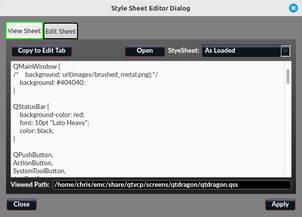

F1 - Estop on/off
F2 - Machine on/off
F12 - Style Editor

To have the manual spindle buttons also incrementally increase/decrease speed:
#action_spindle_fwd{
    qproperty-spindle_up_action: true;
#action_spindle_rev{
    qproperty-spindle_down_action: true;
21.2. Qt Designer and Python code
All aspects of the GUI are fully customization through Qt Designer and/or Python code.
This capability is included with the QtVCP development environment.
The extensive use of QtVCP widgets keeps the amount of required Python code to a minimum, allowing relatively easy modifications.
The LinuxCNC website has extensive documentation on the installation and use of QtVCP libraries.
See QtVCP for more information about QtVCP in general.
Custom modifications can be added by subclassing the handler file. This adds code on top of the original.
QtDragon can also utilize QtVCP’s rc file to do minor python code modifications without using a custom handler file.
See Modifying Screens for more information about customization.
