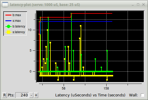

2.2. Latency Plot
latency-plot makes a strip chart recording for a base and a servo thread. It may be useful to see spikes in latency when other applications are started or used. Usage:
latency-plot --help
Usage:
      latency-plot --help | -?
      latency-plot --hal [Options]
Options:
      --base ns  (base  thread interval in nanoseconds, default:   25000)
      --servo ns (servo thread interval in nanoseconds, default: 1000000)
      --time ms  (report interval in milliseconds, default: 1000)
      --relative (relative clock time (default))
      --actual   (actual clock time)

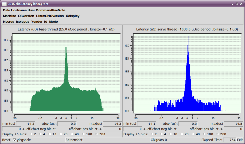

2.3. Latency Histogram
The application latency-histogram displays a histogram of latency (jitter) for a base and servo thread.
Usage:
   latency-histogram --help | -?
   latency-histogram [Options]
Options:
  --base      ns   (base  thread interval in nanoseconds, default:   25000, min:  5000)
  --servo     ns   (servo thread interval in nanoseconds, default: 1000000, min: 25000)
  --bbinsize  ns   (base  bin size in nanoseconds, default: 100
  --sbinsize  ns   (servo bin size in nanoseconds, default: 100
  --bbins     n    (base  bins, default: 200
  --sbins     n    (servo bins, default: 200
  --logscale  0|1  (y axis log scale, default: 1)
  --text      note (additional note, default: "" )
  --show           (show count of undisplayed bins)
  --nobase         (servo thread only)
  --verbose        (progress and debug)
  --nox            (no gui, display elapsed,min,max,sdev for each thread)
Note
When determining the latency, LinuxCNC and HAL should not be running, stop with halrun -U. Large number of bins and/or small binsizes will slow updates. For single thread, specify --nobase (and options for servo thread). Measured latencies outside the +/- bin range are reported with special end bars. Use --show to show count for the off-chart [pos|neg] bin.
latency-histogram Window
Figure 3. latency-histogram Window
