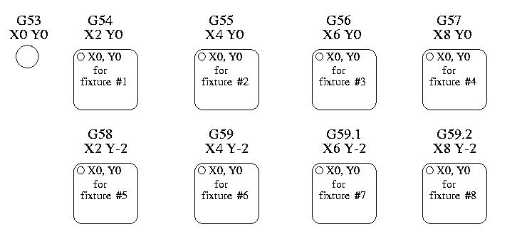

3. Coordinate Systems
Coordinate Systems Example
Figure 1. Coordinate Systems Example

Coordinate system offsets are used to shift the coordinate system from the machine coordinate system. This allows the G-code to be programmed for the part without regard to the part location on the machine. Using coordinate system offsets would allow you to machine parts in multiple locations with the same G-code.
