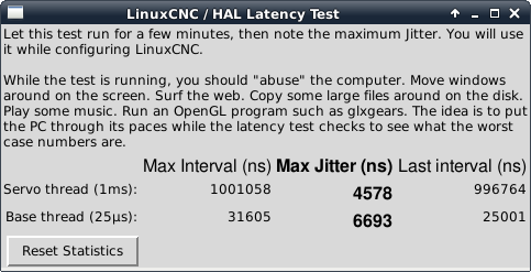

After starting a latency test you should see something like this:
While the test is running, you should abuse the computer. Move windows around on the screen. Surf the web. Copy some large files around on the disk. Play some music. Run an OpenGL program such as glxgears. The idea is to put the PC through its paces while the latency test checks to see what the worst case numbers are.
The important number for software stepping is the max jitter of the base thread. In the example above, that is 6693 nanoseconds (ns), or 6.693 microseconds (µs). Record this number, and enter it in StepConf when it is requested.
In the example above, latency-test only ran for a few seconds. You should run the test for at least several minutes; sometimes the worst case latency doesn’t happen very often, or only happens when you do some particular action. For instance, one Intel motherboard worked pretty well most of the time, but every 64 seconds it had a very bad 300 µs latency. Fortunately that was fixable, see Latency tuning.

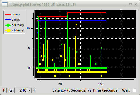

2.2. Latency Plot
latency-plot makes a strip chart recording for a base and a servo thread. It may be useful to see spikes in latency when other applications are started or used. Usage:
latency-plot --help

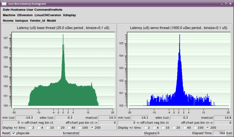

latency-plot Window2.3. Latency Histogram
The application latency-histogram displays a histogram of latency (jitter) for a base and servo thread.
Usage: latency-histogram --help | -? latency-histogram [Options] Options: --base ns (base thread interval in nanoseconds, default: 25000, min: 5000) --servo ns (servo thread interval in nanoseconds, default: 1000000, min: 25000) --bbinsize ns (base bin size in nanoseconds, default: 100 --sbinsize ns (servo bin size in nanoseconds, default: 100 --bbins n (base bins, default: 200 --sbins n (servo bins, default: 200 --logscale 0|1 (y axis log scale, default: 1) --text note (additional note, default: "" ) --show (show count of undisplayed bins) --nobase (servo thread only) --verbose (progress and debug) --nox (no gui, display elapsed,min,max,sdev for each thread)
