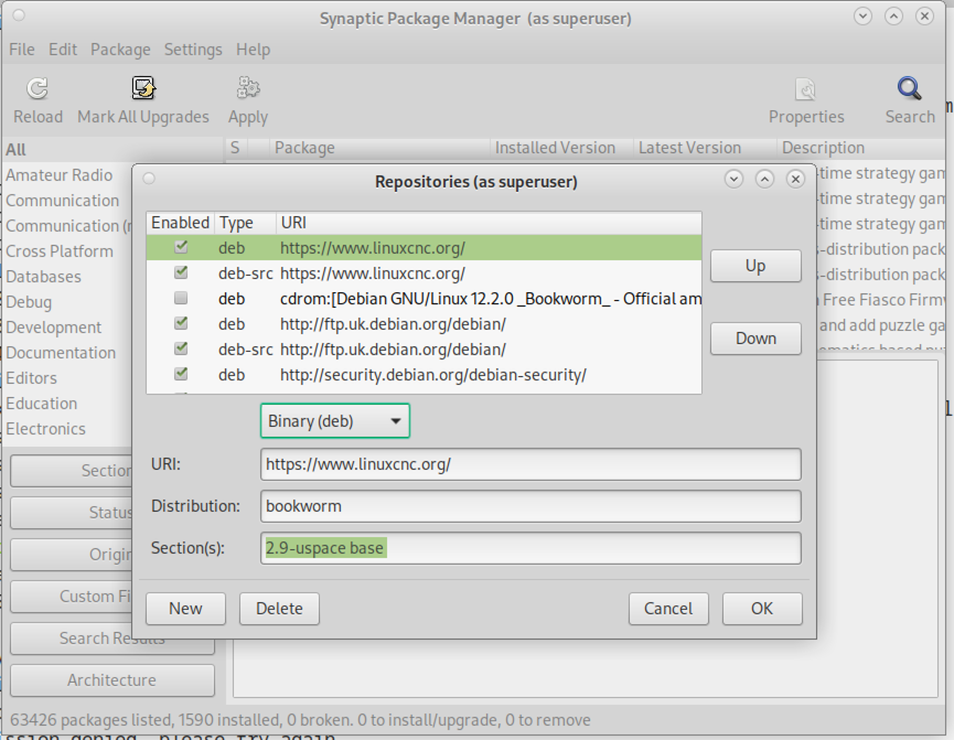

1.1. Apt Sources Configuration
  • Open the Software Sources window. The process for doing this differs slightly on the three supported platforms:
    • Debian:
      • Click on Applications Menu, then System, then Synaptic Package Manager.
      • In Synaptic, click on the Settings menu, then click Repositories to open the Software Sources window.

  • In the Software Sources window, select the Other Software tab.
  • Delete or un-check all the old linuxcnc.org entries (leave all non-linuxcnc.org lines as they are).
  • Click the Add button and add a new apt line. The line will be slightly different on the different platforms:

Setting apt sources
Figure 1. Figure with a screenshot of the repository configuration of the synaptic package manager.
  • Click Add Source, then Close in the Software Sources window. If it pops up a window informing you that the information about available software is out-of-date, click the Reload button.
