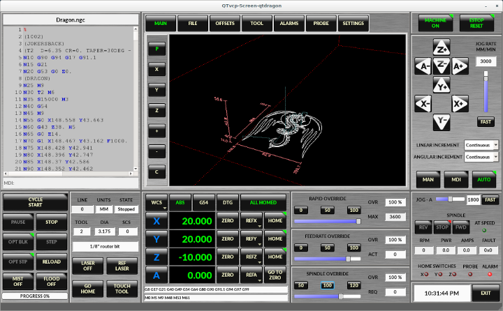

QtDragon Router
Figure 1. QtDragon - 3/4-Axis Sample

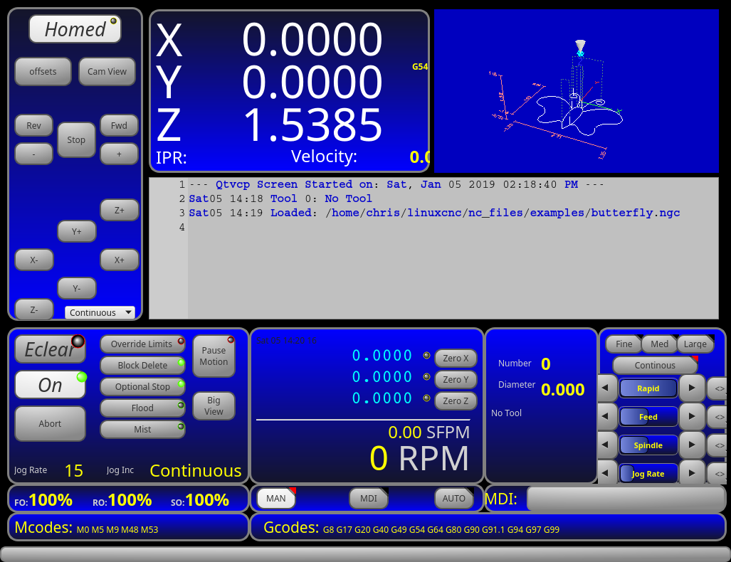

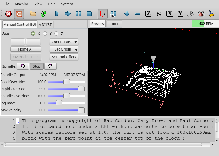

Qtscreen QtAxis
Figure 3. QtAxis - Self Adjusting Axis Sample

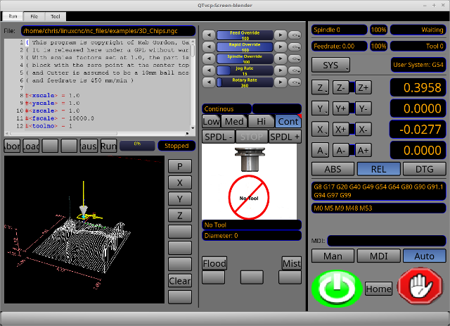

Qtscreen Blender

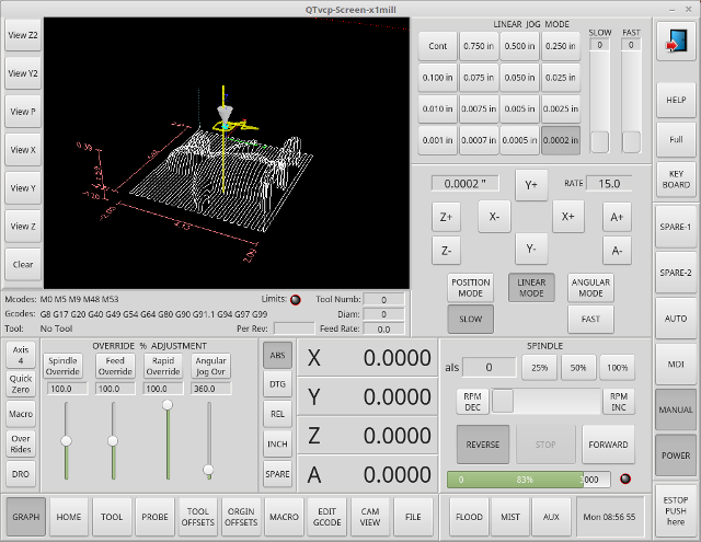

Figure 4. Blender - 4-Axis Sample
Qtscreen x1mill
Figure 5. X1mill - 4-Axis Sample

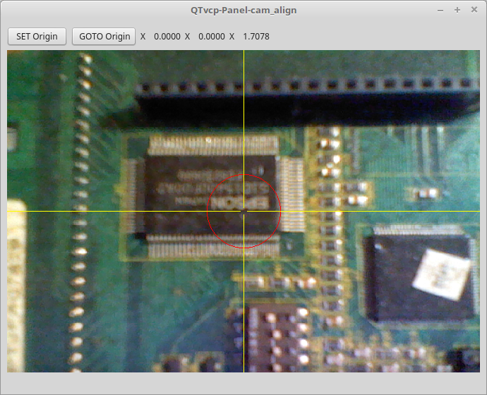

Figure 6. cam_align - Camera Alignment VCP

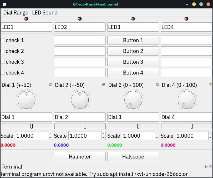

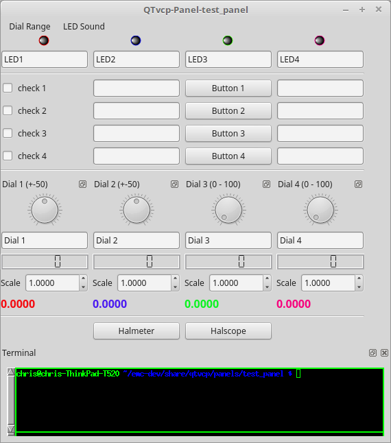

Test Panel
Figure 7. test_panel - Test Panel VCP

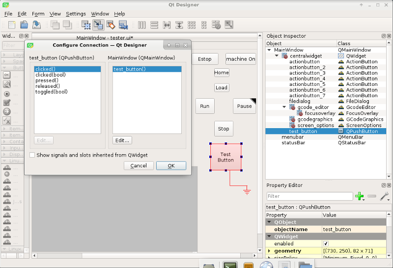

2.3. Qt Designer UI File
A Qt Designer file is a text file organized in the XML standard that describes the layout and widgets of the screen.
PyQt5 uses this file to build the display and react to those widgets.
The Qt Designer editor makes it relatively easy to build and edit this file.

test_panel
Collection of useful widgets for testing HAL components, including speech of LED state.
QtVCP HAL Test Builtin Panel
Figure 8. QtVCP HAL Test Builtin Panel
cam_align
A camera display widget for rotational alignment.
Qtscreen x1mill
Figure 9. cam_align - Camera Alignment VCP

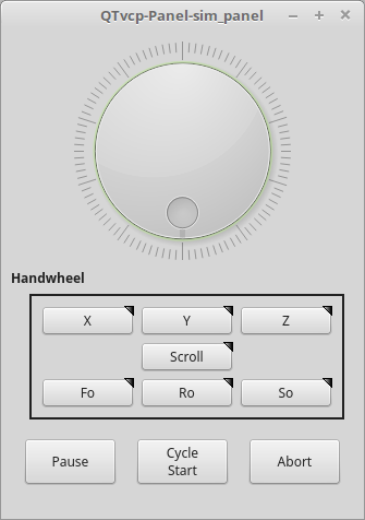

sim_panel
A small control panel to simulate MPG jogging controls etc.
For simulated configurations.
QtVCP Sim Builtin Panel
Figure 10. QtVCP Sim Builtin Panel
vismach_mill_xyz
3D OpenGL view of a 3-axis milling machine.
QtVismach - 3-Axis Mill Builtin Panel
Figure 11. QtVismach - 3-Axis Mill Builtin Panel
You can load these from the terminal or from a HAL file with this basic command:
loadusr qtvcp test_panel
But more typically like this:
loadusr -Wn test_panel qtvcp test_panel
In this way HAL will wait till the HAL pins are made before continuing on.

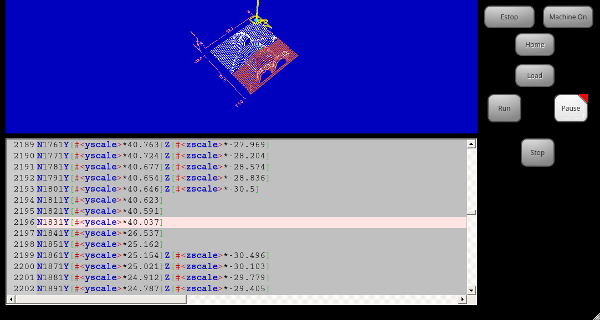

4. Build A Simple Clean-sheet Custom Screen
QtVCP Ugly custom screen
Figure 12. QtVCP Ugly custom screen
4.1. Overview
To build a panel or screen:
  • Use Qt Designer to build a design you like and save it to your configuration folder with a name of your choice, ending with .ui
  • Modify the configuration INI file to load QtVCP using your new .ui file.
  • Then connect any required HAL pins in a HAL file.

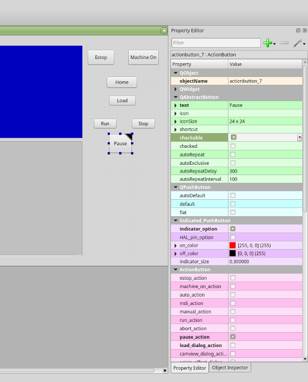

Add Action Buttons
Add 7 action buttons on to the main window.
If you double click the button, you can add text.
Edit the button labels for Estop, Machine On, Home, Load, Run, Pause and stop.
Action buttons default to no action so we must change the properties for defined functions. You can edit the properties:
  • directly in the property editor on the right side of Qt Designer, or
  • conveniently, left double clicking on the button to launch a properties dialog that allows selecting actions while only displaying relevant data to the action.
We will describe the convenient way first:
  • Right click the Machine On button and select Set Actions.
  • When the dialog displays, use the combobox to navigate to MACHINE CONTROLS - Machine On.
  • In this case there is no option for this action so select OK.
Now the button will turn the machine on when pressed.
And now the direct way with Qt Designer’s property editor:
  • Select the Machine On button.
  • Go to the Property Editor on the right side of Qt Designer.
  • Scroll down until you find the ActionButton heading.
  • Click the machine_on action checkbox you will see in the list of properties and values.
The button will now control machine on/off.
Do the same for all the other button with the addition of:
  • With the Home button we must also change the joint_number property to -1.
    This tells the controller to home all the axes rather then a specific axis.
  • With the Pause button:
    • Under the Indicated_PushButton heading check the indicator_option.
    • Under the QAbstactButton heading check checkable.
Qt Designer: Selecting Pause Button’s Properties
Figure 13. Qt Designer: Selecting Pause Button’s Properties

6.2. Using Qt Designer to add Slots
When you have loaded your screen into Qt Designer, add a plain PushButton to the screen.
You could change the name of the button to something interesting like test_button.
There are two ways to edit connections - This is the graphical way.
  • There is a button in the top tool bar of Qt Designer for editing signals. After pushing it, if you click-and-hold on the button it will show an arrow (looks like a ground signal from electrical schematic).
  • Slide this arrow to a part of the main window that does not have widgets on it.
  • A Configure Connections dialog will pop up.
    • The list on the left are the available signals from the widget.
    • The list on the right are the available slots on the main window and you can add to it.
  • Pick the signal clicked() - this makes the slots side available.
  • Click Edit on the slots list.
  • A Slots/Signals of MainWindow dialog will pop up.
  • On the slots list at the top there is a + icon - click it.
  • You can now edit a new slot name.
  • Erase the default name slot() and change it to test_button().
  • Press the OK button.
  • You’ll be back to the Configure Connections dialog.
  • Now you can select your new slot in the slot list.
  • Then press OK and save the file.
Qt Designer Signal/Slot Selection
Figure 14. Qt Designer Signal/Slot Selection
