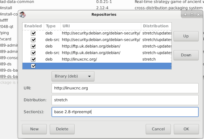

1.1. Setting apt sources
Open the
Software Sourceswindow. The process for doing this differs slightly on the three supported platforms:-
Debian:
Click on
Applications Menu, thenSystem, thenSynaptic Package Manager. -
In Synaptic, click on the
Settingsmenu, then clickRepositoriesto open theSoftware Sourceswindow.
Ubuntu:
Click on the
Dash Homeicon in the top left. -
In the
Searchfield, type "software", then click on theUbuntu Software Centericon. -
In the Ubuntu Software Center window, click on the
Editmenu, then click onSoftware Sources...to open theSoftware Sourceswindow.
In the
Software Sourceswindow, select theOther Softwaretab. -
Delete or un-check all the old linuxcnc.org entries (leave all non-linuxcnc.org lines as they are).
Click the
Addbutton and add a new apt line. The line will be slightly different on the different platforms:
| Platform | apt source line |
Debian Stretch |
Debian Wheezy |
Ubuntu Precise |
Debian Jessie - preempt |
Debian Jessie - RTAI |
Debian Buster - preempt |
Debian Buster - RTAI |
Click
Add Source, thenClosein the Software Sources window. If it pops up a window informing you that the information about available software is out-of-date, click theReloadbutton.
1.2. Upgrading to the new version
Now your computer knows where to get the new version of the software, next we need to install it.
The process again differs depending on your platform.
