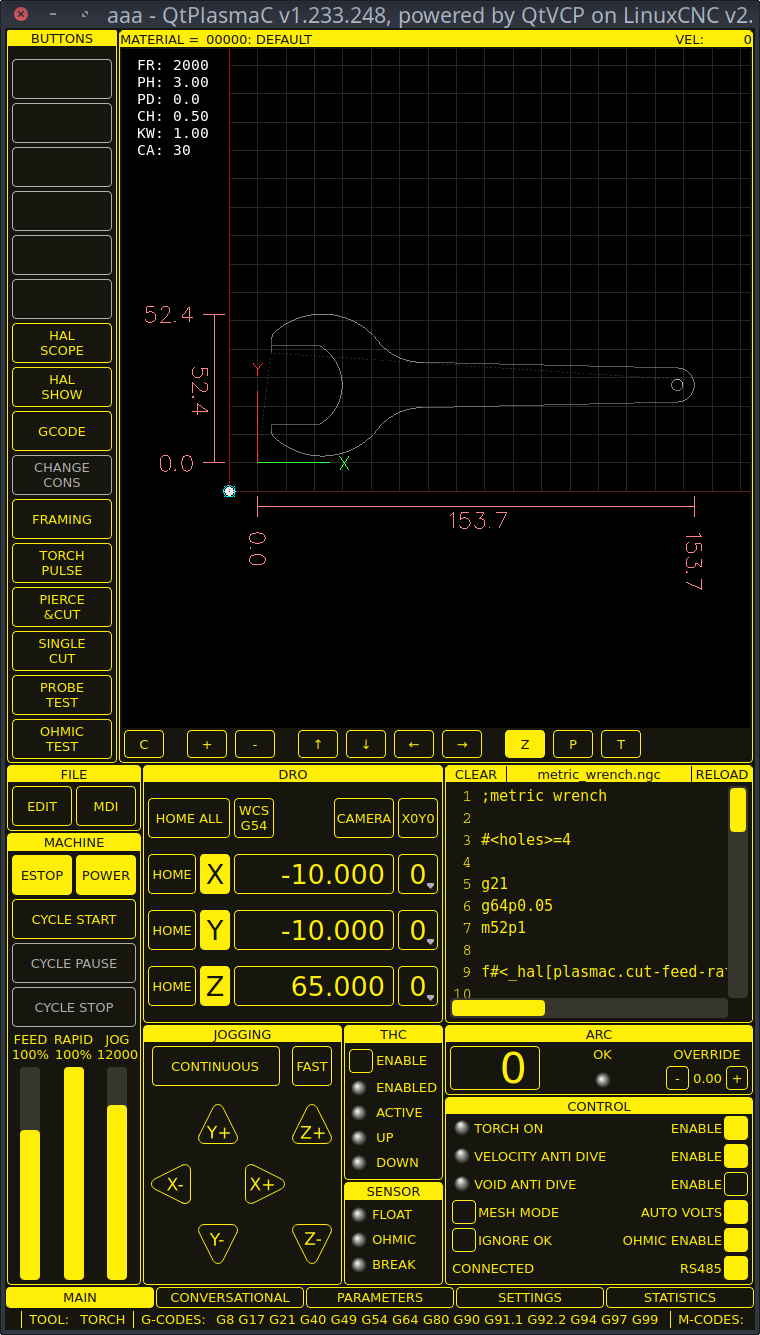

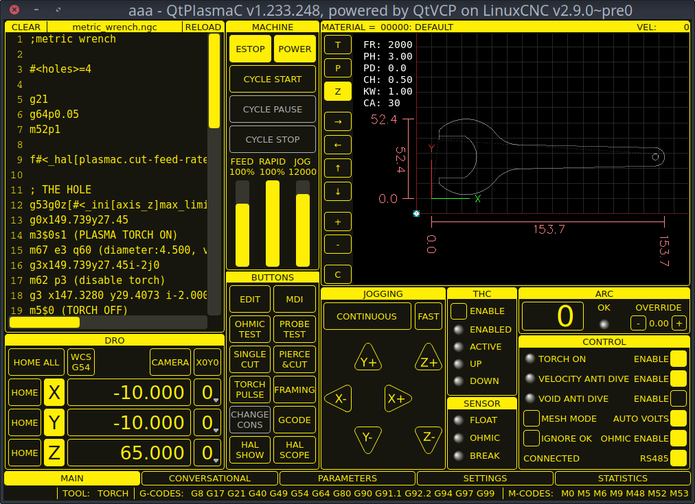

QtPlasmaC is a GUI for plasma cutting which utilises the plasmac component for controlling a plasma table from LinuxCNC v2.9 or later using the Debian Buster or similar distribution.
The QtPlasmaC GUI supports up to five axes and uses the QtVCP infrastructure provided with LinuxCNC.
The standard theme is based on a design by user "pinder" on the LinuxCNC Forum and the colors are able to be changed by the user.
The QtPlasmaC GUI will run on any hardware that is supported by LinuxCNC v2.9 or later provided there are enough hardware I/O pins to fulfill the requirements of a plasma configuration.
There are three available formats:
  • 16:9 with a minimum resolution of 1366 x 768
  • 9:16 with a minimum resolution of 768 x 1366
  • 4:3 with a minimum resolution of 1024 x 768

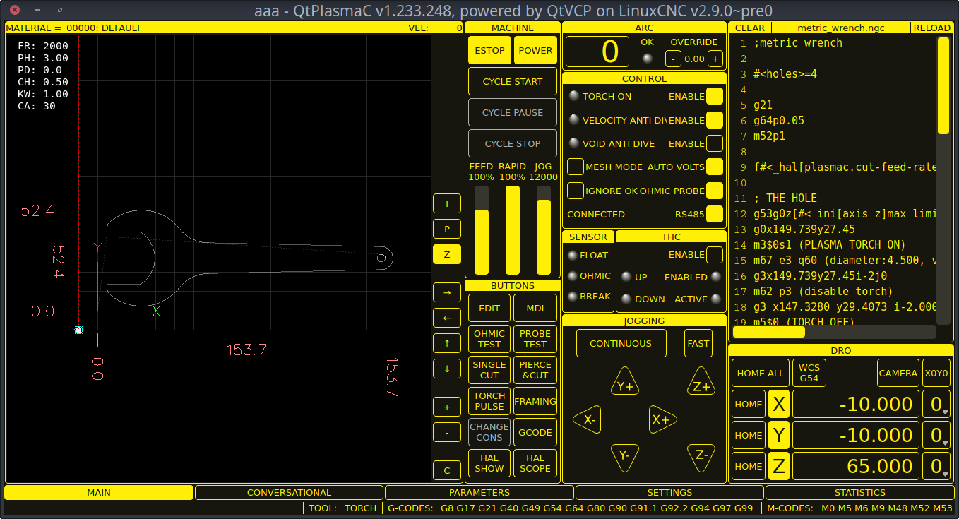

Screenshot examples of QtPlasmaC are below:
images/qtplasmac_16x9.png
Abbildung 1. 16:9
images/qtplasmac_9x16.png
Abbildung 2. 9:16
images/qtplasmac_4x3.png
Abbildung 3. 4:3

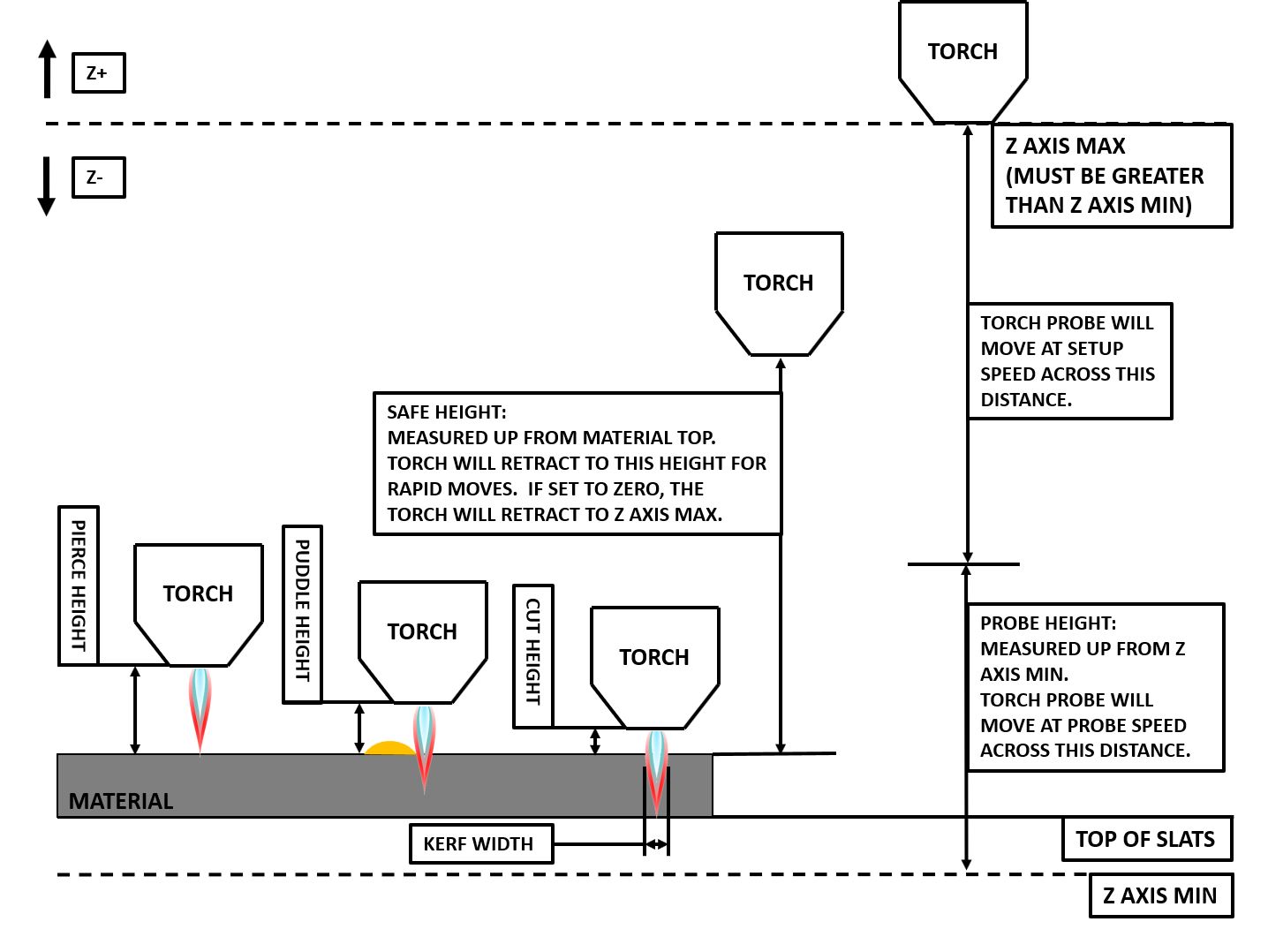

5.3. Recommended Settings:
Refer to the Heights Diagram diagram for a visual representation of the terms below.
  • [AXIS_Z] MIN_LIMIT should be just below top of the slats with allowances for float_switch_travel and over travel tolerance. For example, if the user’s float switch takes 4 mm (0.157") to activate then set the Z minimum to 5 mm (0.2") plus an allowance for overrun (either calculated using the equation below or allow 5 mm (0.2") below the lowest slat).
  • [AXIS_Z] MAX_LIMIT should be the highest the user wants the Z axis to travel (it must not be lower than Z HOME_OFFSET).
  • [AXIS_Z] HOME should be set to be approximately 5 mm-10 mm (0.2"-0.4") below the maximum limit.
  • Floating Head - it is recommended that a floating head be used and that it has enough movement to allow for overrun during probing. Overrun can be calculated using the following formula:
o = 0.5 * a * (v / a)^2
where: o = overrun, a = acceleration in units/s2 and v = velocity in units/s.
Metric example: given a Z axis MAX_ACCELERATION of 600 mm/s2 and MAX_VELOCITY of 60 mm/s, the overrun would be 3 mm.
Imperial example: given a Z axis MAX_ACCELERATION of 24 in/s2 and MAX_VELOCITY of 2.4 in/s, the overrun would be 0.12 in.
On machines that will utilize an ohmic probe as the primary method of probing, it is highly recommended to install a switch on the floating head as a backup means of stopping Z motion in the event of ohmic probe failure due to dirty surfaces.

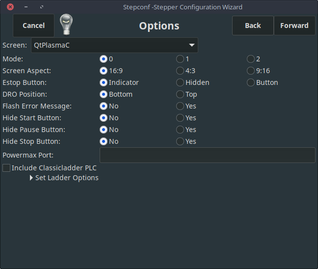

If using a parallel port, use the StepConf wizard by running the stepconf command in a terminal window or launching it using the Application -> CNC -> StepConf Wizard desktop menu entry.
If using a Mesa Electronics board, use the PnCconf wizard by running the pncconf command in a terminal window or launching it using the Application -> CNC -> PnCConf Wizard desktop menu entry.
If using a Pico Systems board, this LinuxCNC forum thread may be helpful.
Die gerätespezifischen Einstellungen werden hier nicht beschrieben, sondern sind in der Dokumentation des jeweiligen Konfigurationsassistenten nachzulesen, der verwendet wird.
There are LinuxCNC forum sections available for these wizards:
Füllen Sie die erforderlichen Einträge entsprechend der Konfiguration der Maschinenverdrahtung/Breakout-Platine aus.

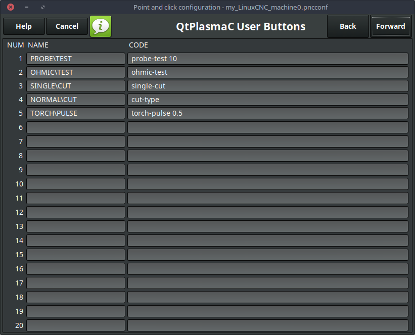

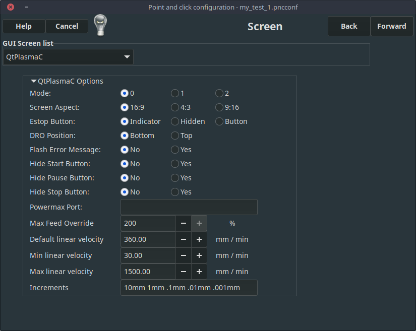

QtPlasmaC adds two pages to the LinuxCNC configuration wizards for QtPlasmaC specific parameters, the two pages are QtPlasmaC options and User Buttons. Complete each of the wizards QtPlasmaC page to suit the machine that is being configured and the user button requirements.
Note that PnCconf options allow user selection of Feed Override, Linear Velocity, and Jog Increments, whereas in StepConf these are automatically calculated and set.
images/qtplasmac_pncconf_screen.png
Abbildung 4. PnCConf QtPlasmaC Options
images/qtplasmac_stepconf_options.png
Abbildung 5. StepConf QtPlasmaC Options
images/qtplasmac_pncconf_buttons.png
Abbildung 6. QtPlasmaC User Buttons

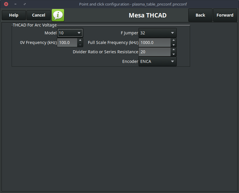

images/qtplasmac_pncconf_thcad.png
Abbildung 7. QtPlasmaC THCAD
The THCAD screen will only appear if a Plasma Encoder is selected in the card screen. The the dedicated section on Mesa THCAD for more information.
When the configuration is complete, the wizard will save a copy of the configuration that may be loaded and edited at a later time, a working QtPlasmaC configuration will be created in the following directory: ~/linuxcnc/configs/<machine_name>.

5.6. Erstmalige Einrichtung
Das folgende Höhendiagramm soll dem Benutzer helfen, die verschiedenen Höhen beim Plasmaschneiden und deren Messung zu veranschaulichen:
images/qtplasmac_heights_diagram.png

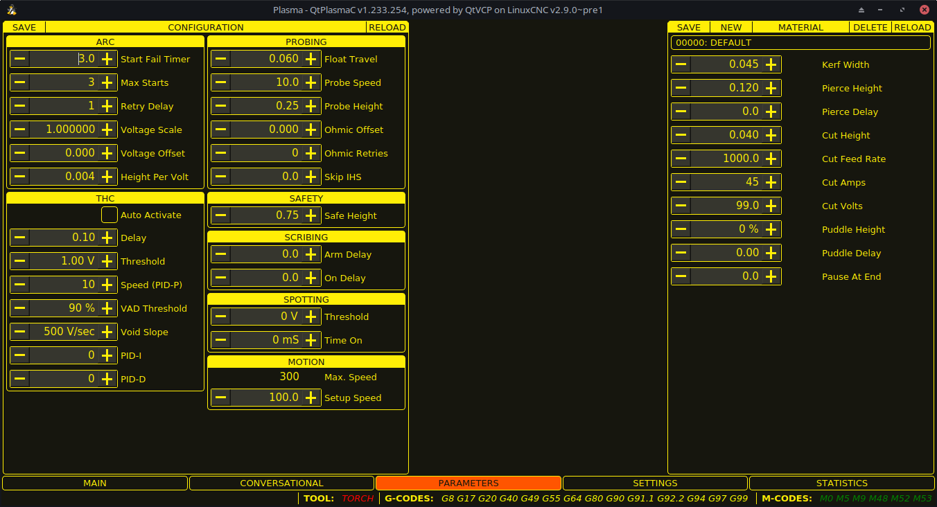

Click on the Parameters Tab to view the CONFIGURATION section which shows the user settable parameters. It is necessary to ensure every one of these settings is tailored to the machine.
To set the Z axis DRO relative to the Z axis MINIMUM_LIMIT, the user should perform the following steps. It is important to understand that in QtPlasmaC, touching off the Z axis DRO has no effect on the Z axis position while running a G-code program. These steps simply allow the user to more easily set the probe height as after performing the steps, the displayed Z axis DRO value will be relative to Z axis MINIMUM_LIMIT.
Anmerkung
The user should be familiar with the recommended Z Axis Settings.
  1. Referenzierung der Z-Achse.
  2. Vergewissern Sie sich, dass sich nichts unter dem Brenner befindet, dann bewegen Sie die Z-Achse nach unten, bis sie am MINIMUM_LIMIT der Z-Achse anhält, und klicken Sie dann auf die 0 neben der Z-Achsen-Anzeige, um die Z-Achse mit der ausgewählten Z-Achse auf Nullpunktverschiebung zu setzen. Dieser Schritt dient nur dazu, dem Benutzer eine einfachere Visualisierung und Einstellung der Sondenhöhe zu ermöglichen - dieser Wert wird vom MINIMUM_LIMIT der Z-Achse aufwärts gemessen.
  3. Erneute Referenzierfahrt der Z-Achse.

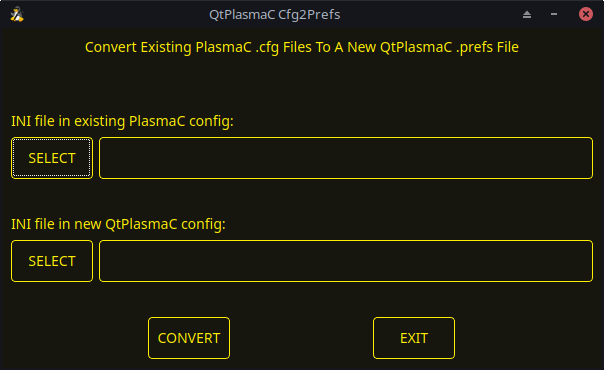

images/qtplasmac_cfg2prefs.png
Abbildung 8. qtplasmac-cfg2prefs
Select the INI file of the old PlasmaC configuration, select the INI file of the new QtPlasmaC configuration, then press CONVERT.

Screenshot example of the QtPlasmaC MAIN Tab in 16:9 aspect ratio:
Einige Funktionen/Merkmale werden nur für bestimmte Modi verwendet und werden nicht angezeigt, wenn sie für den gewählten QtPlasmaC-Modus nicht erforderlich sind.

ESTOP (engl. für Notaus)
Setting Estop type = 0 in the [GUI_OPTIONS] section of the <machine_name>.prefs file, will change this button to an indicator of the hardware E-stop’s status only. This is the default behavior.
Setting the option Estop type = 1 in the [GUI_OPTIONS] section of the <machine_name>.prefs file, will hide this button.
Setting the option Estop type = 2 in the [GUI_OPTIONS] section of the <machine_name>.prefs file, will enable this button to act as a GUI E-stop.
POWER (engl. für Leistung oder Strom)
Diese Schaltfläche schaltet die GUI ein und erlaubt QtPlasmaC/LinuxCNC die Steuerung der Hardware.
Wenn Sie die POWER-Taste länger als zwei Sekunden gedrückt halten, wird ein Dialog zum Beenden der QtPlasmaC-Anwendung angezeigt.
ZYKLUSSTART
Mit dieser Button startet den Zyklus für jede geladene G-Code-Datei.
ZYKLUSPAUSE
Mit diesem Button wird der Zyklus für jede geladene G-Code-Datei angehalten.
Wenn ein Zyklus pausiert wird, zeigt dieser Button "ZYKLUS FORTSETZEN (engl. CYCLE RESUME) an und blinkt.
Durch Drücken von ZYKLUS FORTSETZEN wird der Zyklus fortgesetzt.
ZYKLUS STOP (engl. cycle stop)
This button stops any actively running or paused cycle.
This includes:
- G-code Programs
- Torch pulse if the pulse was started during CYCLE PAUSE (this will cancel the paused G-code program execution as well)
- Probe Test
- Framing
- Manual Cut
FEED
This slider overrides the feed rate for all feed moves.
Any value other than 100% will cause the label to flash.
Clicking the label will return the slider to 100%.
RAPID
This slider overrides the rapid rate for all rapid moves.
JOG
This slider sets the jog rate.
Clicking the label will return the slider to the default linear velocity as set in the <machine_name>.ini file.
BUTTONS
The Button Panel contains buttons useful for the operation of the machine.
The EDIT and MDI buttons are permanent, all other buttons are user programmable in the <machine_name>.prefs file.
See custom user buttons for detailed information on custom user buttons.
Name Beschreibung
EDIT
This button opens a G-code editor for the currently loaded program.
MDI
This button places QtPlasmaC into Manual Data Input (MDI) mode which will display the MDI HISTORY and an entry box over top of the G-code window.
Once pressed, this button will display "MDI CLOSE".
Pressing MDI CLOSE will close the MDI.
Please see the MDI section for additional MDI information.
OHMIC TEST
This button will enable the Ohmic Probe Enable output signal and if the Ohmic Probe input is sensed, the LED indicator in the SENSOR Panel will light.
The main purpose of this is to allow a quick test for a shorted torch tip.
PROBE TEST
This button will initiate a Probe Test.
SINGLE CUT
This button will show the dialog box to start an automatic Single Cut.
NORMAL CUT
This button will toggle between Cut Types (NORMAL CUT and PIERCE ONLY).
TORCH PULSE
This button will initiate a Torch Pulse.
Tabelle 4. ARC
Name Modi Beschreibung
Arc Voltage
0, 1
Displays the actual arc voltage.
OK
0, 1, 2
Indicates the status of the Arc OK signal.
0, 1
Each press of this button will raise the target voltage by the THC Threshold voltage (The distance changed will be Height Per Volt * THC Threshold voltage).
0, 1
Each press of this button will lower the target voltage by the THC Threshold voltage (The distance changed will be Height Per Volt * THC Threshold voltage).
OVERRIDE
0, 1
Clicking this label will return any voltage override to 0.00.
Tabelle 5. CONTROL
TORCH ON
0, 1, 2
Indicates the status of the Torch On output signal.
TORCH ON ENABLE
0, 1, 2
This box toggles between Enabling and Disabling the torch.
This box defaults to unfilled (disabled) when QtPlasmaC is first run.
This box must be filled to change it to "Torch Enabled" before material cutting can commence.
If this box is not filled, then running a loaded program will cause the machine to run the cycle without firing the torch. This is sometimes referred to as a "dry run".
VELOCITY ANTI DIVE
0, 1, 2
Indicates that the THC is locked at the current height due to the cut velocity falling below the Velocity Anti Dive (VAD) Threshold percentage set on the PARAMETERS Tab.
VELOCITY ANTI DIVE ENABLE
0, 1, 2
This box toggles between Enabling and Disabling VELOCITY ANTI DIVE.
VOID ANTI DIVE
0, 1
Indicates that the THC is locked due to a void being sensed.
VOID ANTI DIVE ENABLE
0, 1
This box toggles between Enabling and Disabling VOID ANTI DIVE.
MESH MODE
0, 1, 2
This box will enable or disable Mesh Mode for the cutting of expanded metal. This check box may be enabled or disabled at any time during normal cutting.
Mesh mode:
- Will require an Arc OK signal to start machine motion.
- Will disable the THC.
- Will not stop machine motion if the Arc OK signal is lost.
- Will automatically select CPA mode if PowerMax communications are being used.
For more information see Mesh Mode (expanded metal).
AUTO VOLTS
0, 1
This box will enable or disable Auto Volts.
IGNORE OK
0, 1, 2
This box will determine if QtPlasmaC ignores the Arc OK signal. This check box may be enabled or disabled at any time during normal cutting. Additionally this mode may be enabled or disabled via proper M codes in a running program.
Ignore Arc OK mode:
- Will not require an Arc OK signal be received before starting machine motion after the "Torch On" signal is given.
For more information see Ignore Arc Ok.
OHMIC PROBE
0, 1, 2
Dieses Feld aktiviert oder deaktiviert den Eingang der ohmschen Sonde.
Wenn der Eingang der ohmschen Sonde deaktiviert ist, zeigt die LED der ohmschen Sonde weiterhin den Status des Sondeneingangs an, aber die Ergebnisse der ohmschen Sonde werden ignoriert.
RS485
0, 1, 2
This box will enable or disable the communications to a PowerMax. This button is only visible if a PM_PORT option is configured in the [POWERMAX] section of the <machine_name>.prefs file.
Status
0, 1, 2
When PowerMax communications are enabled, this will display one of the following:
CONNECTING, CONNECTED, COMMS ERROR, or a Fault Code.
For more information, see the PowerMax Communications section.
Tabelle 6. SENSOR
Name Beschreibung
FLOAT
Indicates that the float switch is activated.
OHMIC
Indicates that the probe has sensed the material.
BREAK
Indicates that the torch breakaway sensor is activated.
Tabelle 7. THC
Name Beschreibung
ENABLE (AKTIVIEREN)
This box determines whether the THC will be enabled or disabled during a cut.
ENABLED
This LED indicates whether the THC is enabled or disabled.
ACTIVE
This LED indicates that the THC is actively controlling the Z axis.
UP
This LED indicates that the THC is commanding the Z axis to raise.
DOWN
This LED indicates that the THC is commanding the Z axis to lower.
Anmerkung
JOGGING.
During Paused Motion, this section will become CUT RECOVERY
Name Beschreibung
CONTINUOUS
This drop down button will change the jog increment. Options are determined by the values in the [DISPLAY] section of the <machine_name>.ini file and begin with the label "INCREMENTS =".
FAST
This button will toggle between FAST which is the default linear velocity in the <machine_name>.ini file or SLOW which is 10% of the default value.
Y+
This button moves the Y axis in the positive direction.
Y-
This button moves the Y axis in the negative direction.
X+
This button moves the X axis in the positive direction.
X-
This button moves the X axis in the negative direction.
Z+
This button moves the Z axis in the positive direction.
Z-
This button moves the Z axis in the negative direction.
Anmerkung
CUT RECOVERY
During Paused Motion, this section will be shown on top of the JOGGING panel. The following section will cover each button encountered in this panel. Please see CUT RECOVERY for a detailed description of the cut recovery functionality.
Name Beschreibung
PAUSED MOTION FEED SLIDER
In the event of a paused program, this interface allows X/Y motion to follow the programmed path in the reverse or forward direction.
This slider’s range is from 1%-100% of the Cut Feed Rate for the currently selected material.
FEED
This displays the paused motion feed rate.
REV
In the event of a paused program, this button will move the machine in reverse along the programmed path until it reaches the last M3 command that was either executed or that QtPlasmaC was attempting to execute before the program became paused.
FWD
In the event of a paused program, this button will move the machine forward along the programmed path indefinitely until the program’s end, skipping over M3 commands.
CANCEL MOVE
This button will cancel any Cut Recovery movement that was made, and return the torch to the position the Cut Recovery movement was initiated.
Note that if FWD or REV were used to move the torch, CANCEL will not return to the position of the torch when the pause occurred.
MOVE x.xxx
This displays the amount of travel that will be incurred with each press of an arrow key, in the direction the arrow key was pressed.
This value displayed below MOVE represents the Kerf Width of the currently selected material.
DIRECTIONAL ARROWS
These buttons will move the torch in the direction indicated by a distance of one Kerf Width (of the currently selected material) per press.
Tabelle 8. G-CODE WINDOW
Name Beschreibung
CLEAR
This button will clear the currently opened program.
If a file is open, the default material will be selected.
If no file is open, the preview will be reset to a top down full table view.
The torch (T0) will be selected if it was not the active tool.
OPEN
Diese Schaltfläche öffnet ein DATEI-ÖFFNEN-Panel über dem VORSCHAU-FENSTER.
NEU LADEN
Diese Schaltfläche lädt die aktuell geladene G-Code-Datei neu.
Tabelle 9. DRO
Name Beschreibung
HOME ALL
This button will home all of the axes in the order set by HOME_SEQUENCE in the <machine_name>.ini file.
WCS G54
This drop down button will change the current work offset.

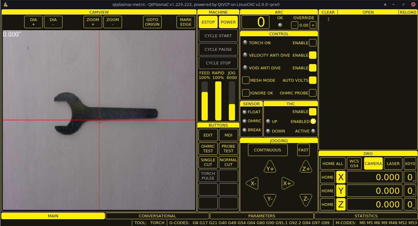

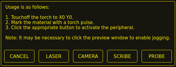

CAMERA
This button will display a CAMVIEW panel on top of the PREVIEW WINDOW and will allow the user to set an origin with or without rotation. See the CAMERA section for detailed instructions.
LASER
This button will allow the user to use a laser to set an origin with or without rotation. See the LASER section for detailed instructions.
X0 Y0
This button will set the current position to X0 Y0.
HOME [AXIS]
This button will home the corresponding axis.
0 [AXIS]
This drop down button will display the following options:
Zero - zeros the axis.
Set - launches a dialog box to manually input the axis' coordinate.
Divide By 2 - divides the currently displayed coordinate in the DRO by two.
Set To Last - sets the axis to the previously set coordinate.

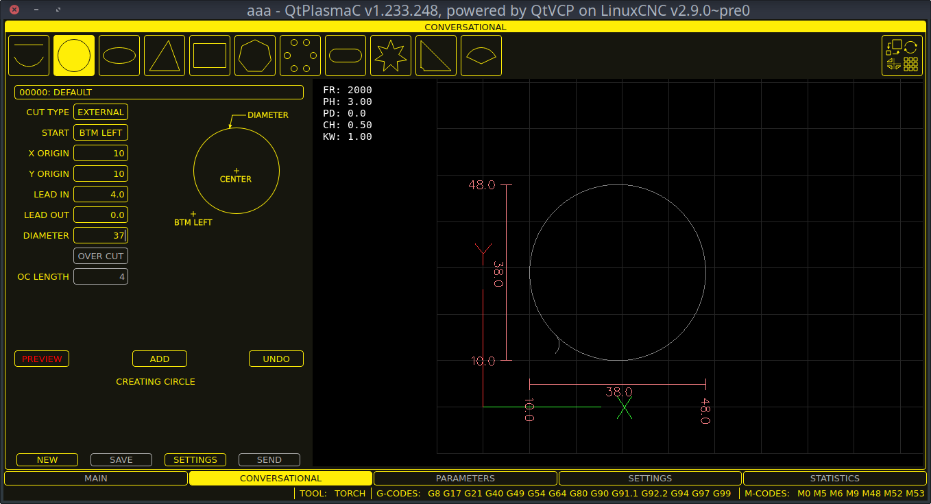

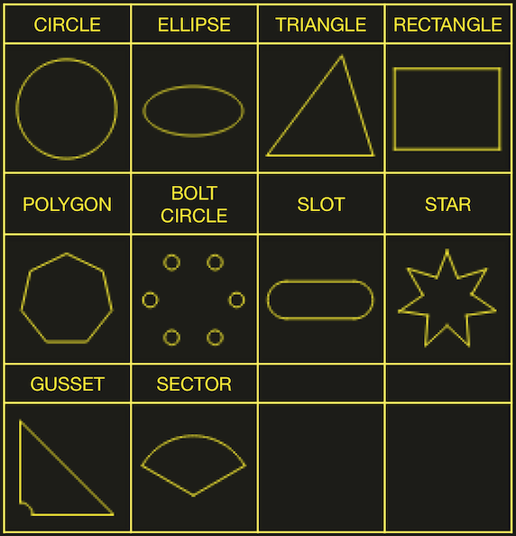

8.4. CONVERSATIONAL Tab
Screenshot example of the QtPlasmaC CONVERSATIONAL Tab in 16:9 aspect ratio:
images/qtplasmac_conversational.png
The CONVERSATIONAL Tab enables the user to quickly program various simple shapes for quick cutting without the need for CAM software.
See Conversational Shape Library for detailed information on the Conversational feature.

8.5. PARAMETERS Tab
Screenshot example of the QtPlasmaC PARAMETERS Tab in 16:9 aspect ratio:
images/qtplasmac_parameters.png
This tab is used to display configuration parameters that are modified infrequently.
It is possible to hide this tab so machine settings cannot be modified by unauthorized personnel. This may be achieved either by wiring the pin to a physical key-switch or similar or it may also be set in a HAL file using the following command:
setp qtplasmac.param_disable 1
Tabelle 10. CONFIGURATION - ARC
Start Fail Timer
0, 1, 2
This sets the amount of time (in seconds) QtPlasmaC will wait between commanding a "Torch On" and receiving an Arc OK signal before timing out and displaying an error message.
Max. Starts
0, 1, 2
This sets the number of times QtPlasmaC will attempt to start the arc.
Retry Delay
0, 1, 2
This sets the time (in seconds) between an arc failure and another arc start attempt.
Voltage Scale
0, 1
This sets the arc voltage input scale and is used to display the correct arc voltage.
For initial setup, see Calibration Values.
Voltage Offset
0, 1
This sets the arc voltage offset and is used to display zero volts when there is zero arc voltage input.
Height Per Volt
0, 1, 2
This sets the distance the torch would need to move to change the arc voltage by one volt.
Used for manual height manipulation only.
OK High Volts
0
This sets the voltage threshold below which Arc OK signal is valid.
OK Low Volts
0
This sets the voltage threshold above which the Arc OK signal is valid.
Anmerkung
When setting the OK Low Volts and OK High Volts in Mode 0, the cut voltage of a stable arc must be greater than the OK Low Volts value but lower than the OK High Volts value for QtPlasmaC to receive a valid Arc OK signal. To further clarify, to have a valid Arc OK, the arc voltage must fall between the two limits.
Tabelle 11. CONFIGURATION - PROBING
Name Beschreibung
Float Travel
This sets the amount of travel the float switch moves before completing the float switch circuit. This distance can be measured by using the Probe Test button, and the method described in Initial Setup.
Sonden-Geschwindigkeit
This sets the speed at which the torch will probe to find the material after it moves to the Probe Height.
Probe Height
This sets the height above the Z axis minimum limit that Probe Speed begins. Refer to the Heights Diagram diagram for a visual representation.
Ohmic Offset
This sets the distance above the material the torch will should go after a successful ohmic probe. It is mainly used to compensate for high probing speeds.
Ohmic Retries
This sets the number of times QtPlasmaC will retry a failed ohmic probe before falling back to the float switch for material detection.
Skip IHS
This sets the distance threshold used to determine if an Initial Height Sense (probe) can be skipped for the current cut, see IHS Skip.
Anmerkung
If the amount of time between the torch contacting the material and when the torch moves up and comes to rest at the Pierce Height seems excessive, see the probing section for a possible solution.
Tabelle 12. CONFIGURATION - SAFETY
Name Beschreibung
Safe Height
This sets the height above the material that the torch will retract to before executing rapid moves.
If set to Zero then Z axis maximum height will be used for the safe height. Refer to the Heights Diagram diagram for a visual representation.
Tabelle 13. CONFIGURATION - SCRIBING
Name Beschreibung
Arm Delay
This sets the delay (in seconds) from the time the scribe command is received to the activation of the scribe. This allows the scribe to reach surface of the material before activating the scribe.
On Delay
This sets the delay (in seconds) to allow the scribe mechanism to start before beginning motion.
Tabelle 14. CONFIGURATION - SPOTTING
Name Beschreibung
Threshold
This sets the arc voltage at which the delay timer will begin.
0 V starts the delay when the torch on signal is activated.
Time On
This sets the length of time (in milliseconds) the torch is on after threshold voltage is reached.
Tabelle 15. CONFIGURATION - MOTION

CONFIGURATION - THC
Two methods of THC activation are available and are selected with the Auto Activation checkbutton. Both methods begin their calculations when the current velocity of the torch matches the cut feed rate specified for the selected material:
  1. Delay Activation (the default) is selected when Auto Activation is unchecked. This method uses a time delay set with the Delay parameter.
  2. Auto Activation is selected when Auto Activation is checked. This method determines that the arc voltage is stable by using the Sample Counts and Sample Threshold parameters.
Delay
0, 1, 2
This sets the delay (in seconds) measured from the time the Arc OK signal is received until Torch Height Controller (THC) activates. This is only available when Auto THC is not enabled.
Sample Counts
0, 1
This sets the number of consecutive arc voltage readings within THC Sample Threshold required to activate the Torch Height Controller (THC). This is only available when Auto THC is enabled.
Sample Threshold
0, 1
This sets the maximum voltage deviation allowed for THC Sample Counts. This is only available when Auto THC is enabled.
Threshold
0, 1
This sets the voltage variation allowed from the target voltage before for THC makes movements to correct the torch height.
Speed (PID-P)
0, 1, 2
This sets the Proportional gain for the THC PID loop. This roughly equates to how quickly the THC attempts to correct changes in height.
VAD Threshold
0, 1, 2
(Velocity Anti Dive) This sets the percentage of the current cut feed rate the machine can slow to before locking the THC to prevent torch dive.
Void Slope
0, 1
(Void Anti Dive) This sets the size of the change in cut voltage per seconds necessary to lock the THC to prevent torch dive (higher values need greater voltage change to lock THC).
PID-I
0, 1
This sets the Integral gain for the THC PID loop. Integral gain is associated with the sum of errors in the system over time and is not always needed.
PID-D
0, 1
This sets the Derivative gain for the THC PID loop. Derivative gain works to dampen the system and reduce over correction oscillations and is not always needed.
Anmerkung
PID loop tuning is a complicated process and is outside the scope of this User Guide. There are many sources of information available to assist with understanding and tuning PID loops. If the THC is not making corrections fast enough, it is recommended to increase the P gain in small increments until the system operates favorably. Large P gain adjustments can result in over correction and oscillations.
SAVE & RELOAD Buttons
The SAVE button will save the currently displayed parameters to the <machine_name>.prefs file.
The RELOAD button will reload all the parameters from the <machine_name>.prefs file.
Tabelle 16. MATERIAL - The parameters which are active for the current cut.
Name Beschreibung
Material
The top drop down menu is used to manually select the current material cut parameters. If there are no materials in the material file then only the default material will be displayed.
Kerf Width
This sets the kerf width for the currently selected material. Refer to the Heights Diagram diagram for a visual representation.
Pierce Height
This sets the pierce height for the currently selected material. Refer to the Heights Diagram diagram for a visual representation.
Pierce Delay
This sets the pierce delay (in seconds) for the currently selected material.
Cut Height
This sets the cut height for the currently selected material. Refer to the Heights Diagram diagram for a visual representation.
Cut Feed Rate
This sets the cut feed rate for the currently selected material.
Cut Amps
This sets the cut amperage for the currently selected material.
This is a visual indicator to the operator only, unless PowerMax communications are being used.
Cut Volts
This sets the cut voltage for the currently selected material.
Puddle Height
Expressed as a percentage of Pierce Height, this sets the Puddle Jump height for the currently selected material.
Typically used for thicker materials, Puddle Jump allows the torch to have an intermediate step between Pierce Height and Cut Height.
If set, the torch will proceed from Pierce Height to P-Jump Height for a period of time (P-Jump Delay) before proceeding to Cut Height to effectively "jump" over the molten puddle. Refer to the Heights Diagram diagram for a visual representation.
Puddle Delay
This sets the amount of time (in seconds) the torch will stay at the P-Jump Height before proceeding to Cut Height.
Pause At End
This sets the amount of time (in seconds) the torch will stay on at the end of the cut before proceeding with the M5 command to turn off and raise the torch. For more information see Pause At End Of Cut.
Gas Pressure
This sets the gas pressure for the currently selected material.
This setting is only valid if PowerMax communications are being used.
0 = Use the PowerMax’s automatic pressure mode.
Cut Mode
This sets the cut mode for the currently selected material.
1 = Normal
2 = CPA (Constant Pilot Arc)
3 = Gouge/Mark
Anmerkung
See the thick materials section for more information on puddle jump.
SAVE, RELOAD, NEW, & DELETE Buttons
The SAVE button will save the current material set to the <machine_name>_material.cfg file.
The RELOAD button will reload the material set from the <machine_name>_material.cfg file.

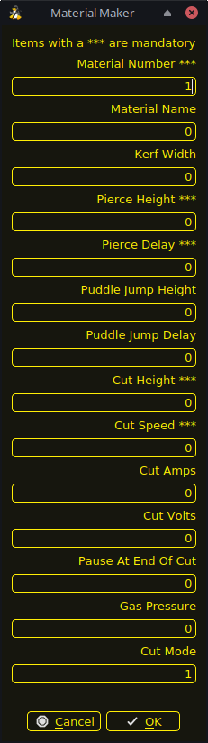

The NEW button will allow a new material to be added to the material file. The user will be prompted for a material number and a material name, all other parameters will be read from the currently selected material. Once entered, QtPlasmaC will reload the material file and display the new material. The Cut Parameters for the new material will then need to be adjusted and saved.
The DELETE this button is used to delete a material. After pressing it, the user will be prompted for a material number to be deleted, and prompted again to ensure the user is sure. After deletion, the material file will be reloaded and the drop down list will display the default material.

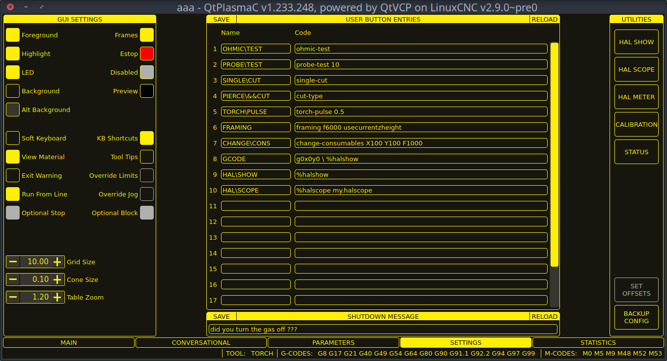

8.6. SETTINGS Tab
Screenshot example of the QtPlasmaC SETTINGS Tab in 16:9 aspect ratio:
images/qtplasmac_settings.png
Diese Registerkarte wird verwendet, um GUI-Konfigurationsparameter, Schaltflächentext und Herunterfahrtext anzuzeigen, die selten geändert werden, sowie einige Dienstprogrammschaltflächen.
setp qtplasmac.settings_disable 1
GUI SETTINGS
This section shows parameters that effect the GUI appearance and GUI behaviors.
To return any of the color changes to their default values, see the Returning To The Default Styling section.
Tabelle 17. GUI SETTINGS Parameters that effect the GUI appearance and GUI behaviors.
Name Beschreibung
Foreground
This button allows the user to change the color of the GUI Foreground.
Highlight
This button allows the user to change the color of the GUI Highlight.
LED
This button allows the user to change the color of the GUI LED.
Background
This button allows the user to change the color of the GUI Background.
Alt Background
This button allows the user to change the color of the GUI Alternate Background.
Frames
This button allows the user to change the color of the GUI Frames.
Estop
This button allows the user to change the color of the GUI Estop.
Disabled
This button allows the user to change the color of the GUI’s Disabled features.
Vorschau
This button allows the user to change the color of the GUI Preview Window Background.

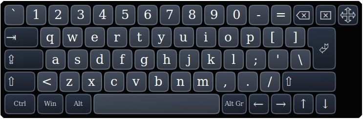

Soft Keyboard
This radio button allows the user to enable or disable the soft touchscreen keyboard.
If the "onboard" virtual keyboard is installed then the custom layouts will be enabled.
KB Shortcuts
This radio button allows the user to enable or disable Keyboard Shortcuts within the GUI (such as keyboard jogging).
In addition to the standard jog keys, a list of the additional shortcuts is available in the keyboard shortcuts section.
View Material
This radio button allows the user to enable or disable the addition of a visual reference showing key material cut settings to the Preview Windows of the MAIN and CONVERSATIONAL tabs.
Examples are: Feed Rate, Pierce Height, Pierce Delay, and Cut Height. Cut Amps will be shown if PowerMax communications are enabled.
Exit Warning
This radio button allows the user to enable or disable whether a warning will always be displayed during shutdown.
It is possible to add a custom message to the warning by editing the EXIT WARNING MESSAGE option in the [GUI_OPTIONS] section of the <machine_name>.prefs file.
The custom message can be made multi-line by adding a "\" between lines.
Optional Stop
This radio button allows the user to enable or disable whether or not a running program will pause at an M1 command.

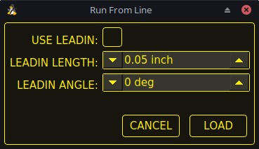

Run From Line
This radio button allows the user to enable or disable Run From Line. If enabled, the user can click on a line of G-code and have the program start from that line.
Grenzwerte überschreiten
This radio button allows the user to temporarily Override the input from a Limit Switch in the event the limit switch becomes tripped during operation. This button can only be clicked when a limit switch is tripped.
Override Jog
This radio button will also allow jogging while jogging is inhibited due to a float switch, breakaway switch, or ohmic probe activation. This button can only be clicked when a jog is inhibited.
Optional Block
This radio button allows the user to enable or disable whether or not lines starting with "/" will be skipped if present in a running program.
Grid Size
This allows a user to change the size of the grid in the Preview Window on the MAIN Tab. Grid size of 0.0 will disable the grid.
Cone Size
This allows a user to change the size of the cone (which represents the current tool) in the Preview Window on the MAIN Tab.
Table Zoom
This allows a user to change the default zoom level for the top down full table view in the Preview Window on the MAIN Tab.
USER BUTTON ENTRIES USERBUTTON
This section shows the text that appears on the Custom User Buttons as well as the code associated with the user button. User buttons may be changed and the new settings used without restarting LinuxCNC.
The text and/or code may be edited at any time and will be loaded ready for use if the SAVE button is clicked.
Deleting the Name and Code text will cause that user button to be hidden if the SAVE button is clicked.
To return all the Name and Code text to their last saved values press the RELOAD button.
Name Code
The text that is displayed on the button
The code that is run when the button is pressed.
Anmerkung
There are 20 user buttons available but not all may be displayed depending on the window size.
Dieser Abschnitt zeigt den Text, der im Dialogfeld zum Herunterfahren angezeigt wird, wenn die Option Exit-Warnung aktiviert ist.
The text may be edited at any time and will be loaded ready for use if the SAVE button is clicked.
To return the EXIT WARNING MESSAGE text to the last saved value press the RELOAD button.
UTILITIES
Some standard LinuxCNC utilities are provided as an aid in the diagnosis of issues that may arise:
In addition the following two QtPlasmaC specific utilities are provided:

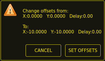

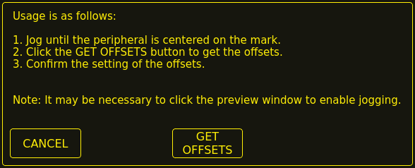

Die Schaltfläche OFFSETS SETZEN wird verwendet, wenn der Tisch mit einem Laser oder einer Kamera zur Bogenausrichtung (engl. sheet alignment), einem Ritzgerät (engl. scribe) oder einem Offset-Taster ausgestattet ist. Die erforderlichen Offsets für diese Peripheriegeräte müssen nach dem unter << peripheral-offsets, Peripherie-Offsets>> beschriebenen Verfahren angewendet werden.
The BACKUP CONFIG button will create a complete machine configuration backup for archiving or to aid in fault diagnosis. A compressed backup of the machine configuration will be saved in the user’s Linux home directory. The file name will be <machine_name><version><date>_<time>.tar.gz, where <machine_name> is the machine name entered in the configuration wizard, <version> is the current QtPlasmaC version the user is on, <date> is the current date (YY-MM-DD), and <time> is the current time (HH-MM-SS).
Prior to the backup being made, the machine log will be saved to a file in the configuration directory named machine_log_<date>_<time>.txt where <date> and <time> are formatted as described above. This file along with up to five previous machine logs will also be included in the backup.
These files are not required by QtPlasmaC and are safe to delete at any time.

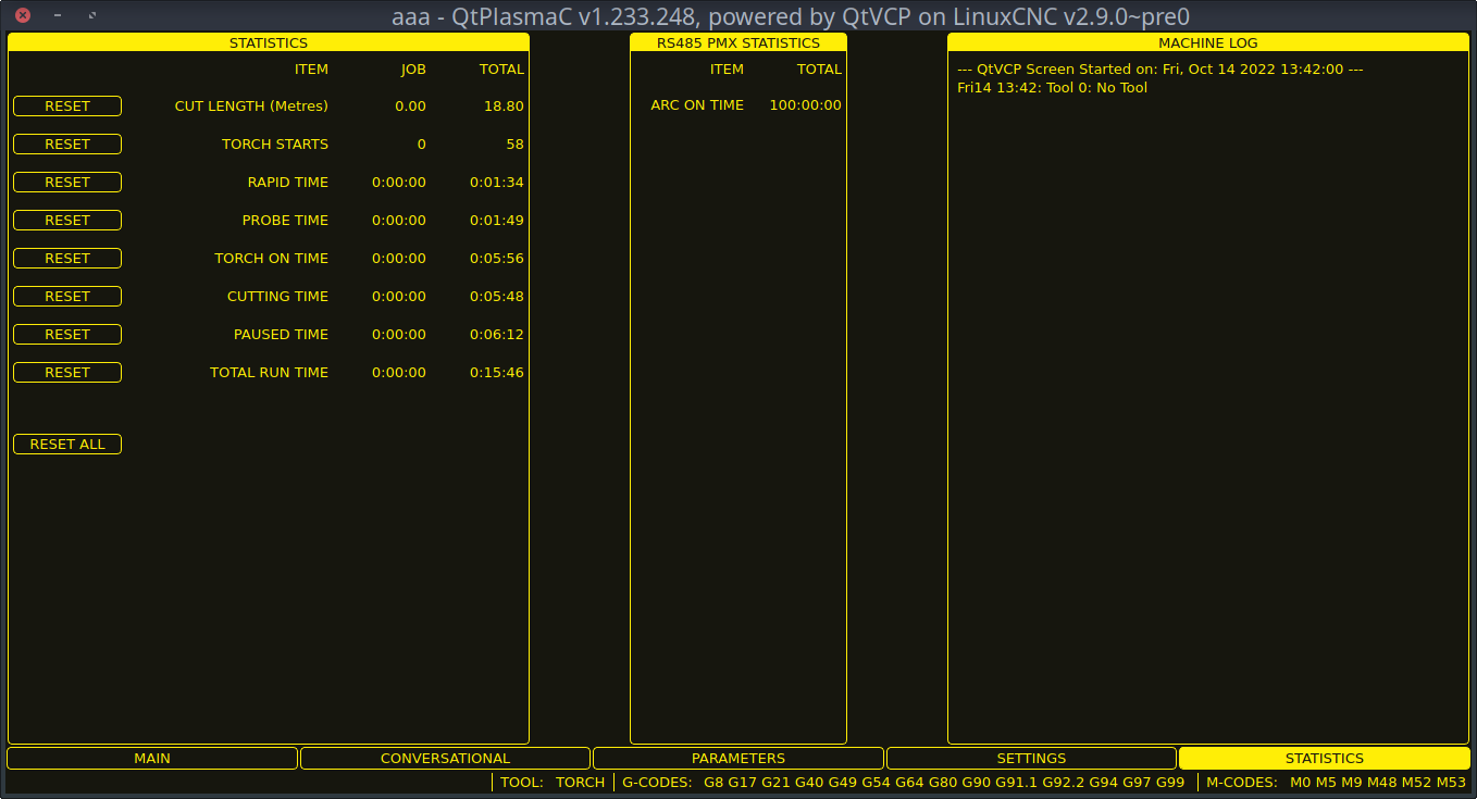

8.7. STATISTICS Tab
The STATISTICS Tab provides statistics to allow for the tracking of consumable wear and job run times. These statistics are shown for the current job as well as the running total. Previous job statistics are reset once the next program is run. The total values may be reset either individually by clicking the corresponding "RESET" button, or they may all be reset together by clicking "RESET ALL".
The RS485 PMX STATISTICS panel will be only be displayed if the user has Hypertherm PowerMax communications and a valid RS485 connection to the PowerMax is established. This panel will show the ARC ON TIME for the PowerMax in hh:mm:ss format.
The MACHINE LOG is also displayed on the STATISTICS Tab, this log will display any errors and/or important information that occurs during the current LinuxCNC session. If the user makes a backup of the configuration from the SETTINGS Tab then the machine log is also included in the backup.
images/qtplasmac_stats.png

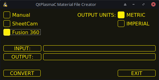

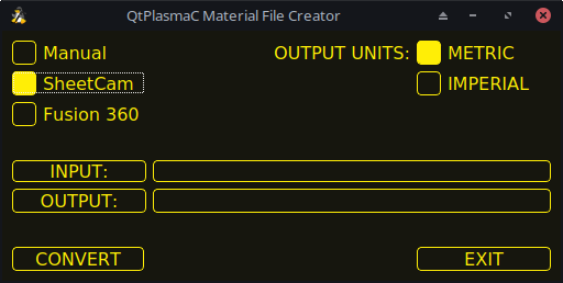

9.10. Material Konverter
Diese Anwendung dient der Konvertierung bestehender Werkzeugtabellen in QtPlasmaC Materialdateien. Sie kann auch eine Materialdatei aus manuellen Benutzereingaben in Eingabefeldern erstellen.
In diesem Stadium sind nur Konvertierungen für Werkzeugtabellen verfügbar, die aus SheetCam oder Fusion 360 exportiert wurden.
SheetCam tool tables are complete and the conversion is fully automatic. The SheetCam tool file must be in the SheetCam .tools format.
Fusion 360 tool tables do not have all of the required fields so the user will be prompted for missing parameters. The Fusion 360 tool file must be in the JSON format of Fusion 360.
Wenn der Benutzer ein Format aus einer anderen CAM-Software hat, das er konvertiert haben möchte, erstellen Sie ein Neues Thema im Abschnitt PlasmaC-Forum des LinuxCNC-Forum, um diese Ergänzung zu beantragen.
Der Materialkonverter kann mit einer der beiden folgenden Methoden von einem Terminal aus gestartet werden.
Geben Sie für eine Paketinstallation (Buildbot) den folgenden Befehl in einem Terminalfenster ein:
qtplasmac-materials
Geben Sie für eine "run in place"-Installation die folgenden beiden Befehle in ein Terminalfenster ein:
source ~/linuxcnc-dev/scripts/rip-environment
qtplasmac-materials

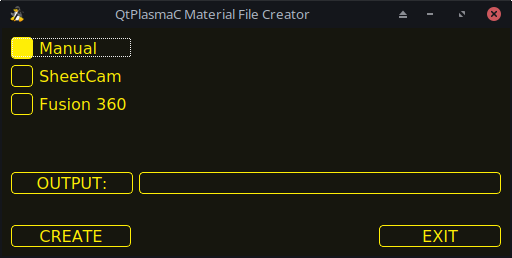

Daraufhin wird das Hauptdialogfeld Materialkonverter mit der Standardeinstellung Manuell angezeigt.
Wählen Sie eines aus:
  • Manuell - um manuell eine neue Materialdatei zu erstellen.
images/qtplasmac_material_main_manual.png
  • SheetCam - um eine SheetCam-Werkzeugdatei zu konvertieren.
images/qtplasmac_material_main_sheetcam.png
Wählen Sie nur für SheetCam, ob der Benutzer eine metrische oder imperiale Ausgabedatei benötigt.
  • Fusion 360 - zum Konvertieren einer Fusion 360 Werkzeugdatei.
images/qtplasmac_material_main_fusion360.png
Um zu konvertieren:
  1. Wählen Sie die zu konvertierende Eingabedatei, drücken Sie INPUT, um eine Dateiauswahl aufzurufen, oder geben Sie die Datei direkt in das Eingabefeld ein.
  2. Select the Output File to write to, press OUTPUT to bring up a file selector or directly enter the file in the entry box. This would normally be ~/linuxcnc/configs/<machine_name>_material.cfg. If necessary, the user could select a different file and hand edit the <machine_name>_material.cfg file.
  3. Klicken Sie auf CREATE/CONVERT und die neue Materialdatei wird erstellt.
Sowohl bei einer manuellen Erstellung als auch bei einer Fusion 360-Konvertierung wird ein Dialogfeld mit allen verfügbaren Parametern angezeigt, die eingegeben werden können. Jeder mit *** markierte Eintrag ist obligatorisch, alle anderen Einträge sind je nach den Konfigurationsanforderungen des Benutzers optional.
images/qtplasmac_material_manual_dialog.png
Anmerkung
If the user selects ~/linuxcnc/configs/<machine_name>_material.cfg and the file already exists, it will be overwritten.
9.11. LASER
QtPlasmaC has the ability to use a laser to set the origin with or without rotation compensation. Rotation compensation can be used to align the work offset to a sheet of material with edge(s) that are not parallel to the machine’s X/Y axes. The LASER button will be enabled after the machine is homed.
Um diese Funktion zu nutzen, muss der Benutzer den Versatz des Lasers von der Brennermitte einstellen, indem er das unter Peripherie-Offsets beschriebene Verfahren befolgt.
To modify the offsets manually, the user could edit either or both the following options in the [LASER_OFFSET] section of the <machine_name>.prefs file:
X axis = n.n
Y axis = n.n
where n.n is distance from the center line of the torch to the laser’s cross hairs.
Zusätzlich kann der Laser über einen HAL-Pin mit folgendem Namen an einen beliebigen Ausgang angeschlossen werden, um den Laser ein- und auszuschalten:
qtplasmac.laser_on
Ursprung mit Null-Drehung festlegen:
  1. Klicken Sie auf die Schaltfläche LASER.
  2. Die Beschriftung des Buttons LASER ändert sich zu MARK EDGE und der HAL-Pin namens qtplasmac.laser_on wird eingeschaltet.
  3. Bewegen Sie sich, bis sich das Fadenkreuz des Lasers über dem gewünschten Ursprungspunkt befindet.
  4. Drücken Sie MARK EDGE. Die Beschriftung der Taste MARK EDGE ändert sich in SET ORIGIN.
  5. Drücken Sie SET ORIGIN (engl. für Ursprung festlegen). Die Beschriftung der Taste SET ORIGIN ändert sich in MARK EDGE und der HAL-Pin mit dem Namen qtplasmac.laser_on wird deaktiviert.
  6. Der Brenner fährt nun in die Position X0 Y0.
  7. Der Offset ist nun erfolgreich eingestellt.
Ursprung mit Drehung festlegen:
  3. Rütteln Sie so lange, bis sich das Fadenkreuz des Lasers an der Kante des Materials in einem angemessenen Abstand zum gewünschten Ursprungspunkt befindet.
  5. Bewegen Sie sich, bis sich das Fadenkreuz des Lasers am Ursprungspunkt des Materials befindet.
  6. Drücken Sie SET ORIGIN (engl. für Ursprung festlegen). Die Beschriftung der Taste SET ORIGIN ändert sich in MARK EDGE und der HAL-Pin mit dem Namen qtplasmac.laser_on wird deaktiviert.
  7. Der Brenner fährt nun in die Position X0 Y0.
  8. Der Offset ist nun erfolgreich eingestellt.
Um den Laser auszuschalten und eine Ausrichtung abzubrechen:
  1. Drücken Sie die Taste LASER und halten Sie sie länger als 750 mSek. gedrückt.
  2. Die Beschriftung der Schaltfläche LASER ändert sich in LASER und der HAL-Pin mit dem Namen qtplasmac.laser_on wird ausgeschaltet.
  3. Lassen Sie die Taste LASER los.
If an alignment laser has been set up then it is possible to use the laser during CUT RECOVERY for accurate positioning of the new start coordinates.
9.12. CAMERA
images/qtplasmac_camview.png
QtPlasmaC has the ability to use a USB camera to set the origin with or without rotation compensation. Rotation compensation can be used to align the work offset to a sheet of material with edge(s) that are not parallel to the machine’s X/Y axes. The CAMERA button will be enabled after the machine is homed.
Um diese Funktion zu nutzen, muss der Benutzer den Versatz der Kamera von der Brennermitte einstellen, indem er das unter Peripherie-Offsets beschriebene Verfahren befolgt.
To modify the offsets manually, the user could edit either or both the following axes options in the [CAMERA_OFFSET] section of the <machine_name>.prefs file:
X axis = n.n
Y axis = n.n
Camera port = 0
wobei n.n der Abstand von der Mittellinie des Brenners zum Fadenkreuz der Kamera ist.
  1. Bewegen Sie die Maus, bis sich das Fadenkreuz über dem gewünschten Ursprungspunkt befindet.
  2. Drücken Sie MARK EDGE. Die Beschriftung der Schaltfläche MARK EDGE ändert sich in SET ORIGIN und die Schaltfläche GOTO ORIGIN wird deaktiviert.
  3. Drücken Sie Ursprung festlegen. Die Beschriftung der Schaltfläche Herkunft festlegen ändert sich in KANTE MARKIEREN und die Schaltfläche Herkunft gehen wird aktiviert.
  4. Der Brenner fährt nun in die Position X0 Y0.
  5. Der Offset ist nun erfolgreich gesetzt.
  1. Bewegen Sie das Fadenkreuz, bis es sich am Rand des Materials in einem angemessenen Abstand zum gewünschten Ursprungspunkt befindet.
  3. Bewegen Sie die Maus, bis sich das Fadenkreuz am Ausgangspunkt des Materials befindet.
  4. Drücken Sie Ursprung festlegen. Die Beschriftung der Schaltfläche Herkunft festlegen ändert sich in KANTE MARKIEREN und die Schaltfläche Herkunft gehen wird aktiviert.
  5. Der Brenner fährt nun in die Position X0 Y0.
  6. Der Offset ist nun erfolgreich eingestellt.
Im CAMVIEW-Bedienfeld kann die Maus das Fadenkreuz und die Zoomstufe wie folgt beeinflussen:
  • Mausrad scrollen - Durchmesser des Fadenkreuzes ändern.
  • Doppelklick mit der Mausradtaste - Stellt den Fadenkreuzdurchmesser auf den Standardwert zurück.
  • Linke Maustaste gedrückt + Scrollrad - Ändert die Zoomstufe der Kamera.
  • Klicken mit der linken Maustaste + Doppelklick mit der Radtaste - Stellt die Standard-Zoomstufe der Kamera wieder her.

9.21. Sondieren
Probing may be done with either ohmic sensing or a float switch. It is also possible to combine the two methods, in which case the float switch will provide a fallback to ohmic probing. An alternative to ohmic probing is Offset Probing
If the machine’s torch does not support ohmic probing, the user could have a separate probe next to the torch. In this case the user would extend the probe below the torch. The probe must NOT extend more than the minimum Cut Height below the torch and the Z axis offset distance needs to be entered as the Ohmic Offset in the PROBING frame of the CONFIGURATION section of the PARAMETERS Tab.
Probing setup is done in the PROBING frame of the CONFIGURATION section of the PARAMETERS Tab.
QtPlasmaC can probe at the full Z axis velocity so long as the machine has enough movement in the float switch to absorb any overrun. If the machine’s float switch travel is suitable, the user could set the Probe Height to near the Z axis MINIMUM_LIMIT and do all probing at full speed.
Some float switches can exhibit a large switching hysteresis which shows up in the probing sequence as an excessive time to complete the final probe up.
  • This time may be decreased by changing the speed of the final probe up.
  • This speed defaults to 0.001 mm (0.000039") per servo cycle.
  • It is possible to increase this speed by up to a factor of 10 by adding the following line to the custom.hal file:
setp plasmac.probe-final-speed n
where n is a value from 1-10. It is recommended to keep this value as low as possible.
Using this feature will change the final height slightly and will require thorough probe testing to confirm the final height.
This speed value affects ALL probing so if the user uses ohmic probing and the user changes this speed value then the user will need to probe test to set the require offset to compensate for this speed change as well as the float travel.
The reliability of this feature will only be as good as the repeatability of the float switch.
Anmerkung
Probe Height refers to the height above the Z axis MINIMUM_LIMIT.
9.22. Offset Probing
Offset Probing is the use of a probe that is offset from the torch. This method is an alternative to Ohmic Probing and uses the plasmac.ohmic-enable output pin to operate a solenoid for extending and retracting the probe. The plasmac.ohmic-probe input pin is used to detect the material and the Ohmic Offset in the PROBING frame of the CONFIGURATION section of the PARAMETERS Tab is used to set the correct measured height.
The probe could be a mechanically deployed probe, a permanently mounted proximity sensor or even simply a stiff piece of wire extending about 0.5 mm (0.2") below the torch tip. If the probe is mechanically deployed then it needs to extend/retract rather quickly to avoid excessive probing times and would commonly be pneumatically operated.
To use this feature, the user must set the probe’s offset from the torch center by following the procedure described in Peripheral Offsets.
To modify the offsets manually, the user could edit either or both the following options in the [OFFSET_PROBING] section of the <machine_name>.prefs file:
X axis = n.n
Y axis = n.n
Delay = t.t
where n.n is the offset of the probe from the torch center in machine units for the X and Y axes and t.t is the time in seconds to allow for any mechanical deployment of the probe if required.
Each of these parameters is optional and also may appear in any order. If a parameter is not detected then the default is 0.0. There can be no space after the X or Z, lower case is permissible.
When this variable appears in the INI file with either X or Y not equal to zero then QtPlasmaC will do all Ohmic Probing as Offset Probing. When a probe sequence has begun, the plasmac.ohmic-enable pin will be set True causing the probe to extend. When the material is detected the plasmac.ohmic-enable pin will be reset to false causing the probe to retract.
The probe will begin moving to the offset position simultaneously with the Z axis moving down to the Probe Height, probing will not commence unless the deployment timer has completed. It is required that the Probe Height in the PROBING frame of the CONFIGURATION section of the PARAMETERS Tab is above the top of the material to ensure that the probe is fully offset to the correct X/Y position before the final vertical probe down movement.
Wichtig
PROBE HEIGHT NEEDS TO BE SET ABOVE THE TOP OF THE MATERIAL FOR OFFSET PROBING.

  1. Utilize the default custom user button to toggle between the cut types.
  2. Adding the following line to the G-code program before the first cut to enable Pierce Only mode for the current file:
#<pierce-only> = 1
If using a custom user button is utilized then QtPlasmaC will automatically reload the file when the cut type is toggled.

9.28. Thick Materials
Cutting thick materials can be problematic in that the large amount of molten metal caused by piercing can shorten the life of consumables and also may cause a puddle high enough that the torch may hit the puddle while moving to cut height.
The are two functions built into QtPlasmaC to help alleviate these issues.

images/qtplasmac_run_from_line.png
Name Beschreibung
USE LEADIN
This radio button will allow the user to start the selected line with a leadin.
LEADIN LENGTH
If USE LEADIN is selected, this will set the length of the lead in the machine units.
LEADIN ANGLE
If USE LEADIN is selected, this will set the angle of approach for the leadin.
The angle is measured such that positive increases in value move the leadin counter-clockwise:
0 Degrees = 3 o’clock position
90 Degrees = 12 o’clock position
180 Degrees = 9 o’clock position
270 Degrees = 6 o’clock position
CANCEL
This button will cancel the Run From Line dialog box and any selections.
LOAD
This button will load a temporary "rfl.ngc" program with any selected leadin parameters applied.
If the leadin cannot be calculated for the selected line, the following error message will be displayed:
"Unable to calculate a leadin for this cut
Program will run from selected line with no leadin applied"
After pressing LOAD, the blinking "SELECTED nn" button will change to RUN FROM LINE CYCLE START button. Click this button to start the program from the beginning of the selected line.
Run From Line selections may be canceled in the following ways:
  1. Click the background of the preview window - this method will cancel a selection of either a cut line in the preview window, or a G-code line in the G-code window.
  2. Click the text of the first line of the G-code program in the G-code display - this method will cancel a selection of either a cut line in the preview window, or a G-code line in the G-code window.
  3. Klicken auf RELOAD in der Kopfzeile des G-Code-Fensters - diese Methode bricht den Prozess "Run From Line" ab, wenn im Dialogfeld "Run From Line" auf LOAD geklickt wurde und "rfl.ngc" als geladener Dateiname in der Kopfzeile des G-Code-Fensters angezeigt wird. Dadurch kehrt der Benutzer zur ursprünglich geladenen Datei zurück.

9.35. Benutzerdefinierte Layouts für virtuelle Tastaturen
Virtuelle Tastaturunterstützung ist nur für die "integrierte" Bildschirmtastatur verfügbar. Wenn es sich noch nicht auf dem System befindet, kann es installiert werden, indem Sie Folgendes in ein Terminal eingeben:
sudo apt install onboard
Die folgenden beiden benutzerdefinierten Layouts werden für die Softkey-Unterstützung verwendet:
images/qtplasmac_numpad.png
Number keypad - used for the CONVERSATIONAL Tab and the PARAMETERS Tab
images/qtplasmac_keypad.png
Alpha-numeric keypad - used for G-code editing and file management.
If the virtual keyboard has been repositioned and on the next opening of a virtual keyboard it is not visible then clicking twice on the onboard icon in the system tray will reposition the virtual keyboard so the move handle is visible.

10. Conversational Shape Library
The Conversational Shape Library consists of several basic shapes and functions to assist the user with generating quick G-code at the machine to cut simple shapes quickly. This feature is found on the CONVERSATIONAL Tab.
Anmerkung
The Conversational Library is not meant to be a CAD/CAM replacement as there are limitations to what can be achieved.
Bei leeren Einträgen in den Form-Eingabefeldern wird die aktuelle Einstellung zum Zeitpunkt der Erstellung des G-Codes verwendet. Wenn z.B. X Start leer gelassen wurde, wird die aktuelle Position der X-Achse verwendet.
Alle An- und Ableitungen (engl. leadins und leadouts) sind Bögen, mit Ausnahme von Kreisen und Sternen:
Kreise (engl. circles):
  • Wenn der Kreis extern ist, dann ist jede Hin- oder Rückführung (leadin or leadout) ein Bogen.
  • Wenn der Kreis innenliegend ist und ein kleines Loch hat, dann ist jeder leadin senkrecht und es gibt keinen Auslauf.
  • Wenn der Kreis intern und kein kleines Loch ist, dann ist jeder Leadin und Leadout ein Bogen. Wenn der Leadin eine Länge von mehr als der Hälfte des Radius hat, wird der Leadin senkrecht zurückgesetzt und es gibt keinen Leadout. Wenn der Leadout eine Länge von mehr als der Hälfte des Radius hat, gibt es keinen Leadout.
Sterne (engl. stars):
  • Der Leadin befindet sich im gleichen Winkel wie der erste Schnitt und der Leadout im gleichen Winkel wie der letzte Schnitt.
Anmerkung
Ein kleines Loch ist ein Kreis, der kleiner ist als der auf der Seite KONVERSATIONSEINSTELLUNGEN (engl. conversational settings) angegebene KLEINE LOCHDURCHMESSER.
Anmerkung
The holes in a BOLT CIRCLE shape will also abide by the above rules.
*Die Schnittreihenfolge entspricht der Reihenfolge, in der die Form gebaut wurde.
Wenn Sie während der Bearbeitung der Parameter Return auf der Tastatur drücken, wird automatisch die Vorschau der Form angezeigt, wenn genügend Parameter eingegeben wurden, um die Form zu erstellen. Ein Klick auf eines der verfügbaren Kontrollkästchen bewirkt dasselbe.
Die allgemeinen Funktionen sind wie folgt:
Name Beschreibung
Material-Dropdown
Allows the user to select the desired material for cutting.
If "VIEW MATERIAL" is selected on the SETTINGS Tab, a visual reference showing key material cut settings will be displayed on the Conversational Preview Window.
Examples are: Feed Rate, Pierce Height, Pierce Delay, Cut Height, and Kerf Width (for Conversational only). Cut Amps will be shown if PowerMax communications are enabled.
NEW
Removes the current G-code file and load a blank G-code file.
SAVE
Opens a dialog box allowing the current shape to be saved as a G-code file.
SETTINGS
Allows the changing of the global settings.
SEND
Loads the current shape into LinuxCNC (QtPlasmaC). If the last edit was not added then it will be discarded.
PREVIEW
Displays a preview of the current shape provided the required information is present.
CONTINUE
This button is used for lines and arcs only. Allows another segment to be added to the current segment/segments.
ADD
Stores the current shape into the current job.
UNDO
Reverts to the previously stored state.
NEU LADEN
Reloads the original G-code file or a blank file if none was loaded.
If there is a G-code file loaded in LinuxCNC (QtPlasmaC) when the CONVERSATIONAL Tab is selected, that code will be imported into the conversational as the first shape of the job. If this code is not required then it can be removed by pressing the NEW button.
If there is an added shape that is unsaved or unsent then it is not possible to switch tabs in the GUI. To re-enable switching tabs it is necessary to either SAVE the shape, SEND the shape, or press NEW to remove the shape.
Wenn NEU gedrückt wird, um eine hinzugefügte Form zu entfernen, die nicht gespeichert oder gesendet wurde, wird ein Warndialog angezeigt.
Anmerkung
Alle Entfernungen sind in Maschineneinheiten relativ zum aktuellen Benutzerkoordinatensystem und alle Winkel sind in Grad angegeben.

10.3. Conversational Single Shape
Die folgenden Formen sind für die Erstellung verfügbar:
images/qtplasmac_conv_shapes.png
So erstellen Sie eine Form:
  1. Select the corresponding icon for the shape to create. The available parameters will be displayed.
  2. Choose the material from the MATERIAL drop down. If no material is chosen, the default material (00000) will be used.
  3. Geben Sie die entsprechenden Werte ein und drücken Sie PREVIEW, um die Form anzuzeigen.
  4. Wenn die Form nicht korrekt ist, ändern Sie die Werte und drücken Sie VORSCHAU (engl. preview), damit die neue Form angezeigt wird. Wiederholen Sie den Vorgang, bis Sie mit der Form zufrieden sind.
  5. Drücken Sie ADD, um die Form zur G-Code-Datei hinzuzufügen.
  6. Drücken Sie SEND, um die G-Code-Datei zum Schneiden an LinuxCNC (QtPlasmaC) zu senden.
For CIRCLE, the OVER CUT button will become valid when a CUT TYPE of INTERNAL is selected and the value entered in the DIAMETER field is less than the Small Hole Diameter parameter in the Conversational SETTINGS section.
For BOLT CIRCLE the OVER CUT button will become valid if the value entered in the HOLE DIA field is less than the SMALL HOLES DIAMETER parameter in the Conversational SETTINGS section.
For the following shapes, KERF OFFSET will become active once a LEAD IN is specified:
  1. TRIANGLE
  2. RECTANGLE
  3. POLYGON
  4. SLOT
  5. STAR
  6. GUSSET

15.1. Benutzerdefinierte Buttons
The QtPlasmaC GUI offers user buttons that can be customized by adding commands in the USER BUTTON ENTRIES section of the SETTINGS Tab in the <machine_name>.prefs file.
Die Anzahl der Benutzertasten variiert je nach Anzeigetyp und Auflösung wie folgt:
  • 16:9 und 4:3 - Minimum 8, Maximum 20
  • 9:16 - Minimum 15, Maximum 20
Der Benutzer muss QtPlasmaC bei der gewünschten Bildschirmgröße ausführen, um festzustellen, wie viele Benutzertasten zur Verfügung stehen.
All <machine_name>.prefs file settings for the buttons are found in the [BUTTONS] section.

15.2. Peripheral Offsets (Laser, Camera, Scribe, Offset Probe)
Use the following sequence to set the offsets for a laser, camera, scribe, or offset probe:
  1. Place a piece of scrap material under the torch.
  2. Die Maschine muss referenziert und im Leerlauf sein, bevor Sie fortfahren.
  3. Open the SETTINGS tab.
  4. Click the SET OFFSETS button which opens the Set Peripheral Offsets dialog.
    images/qtplasmac_peripheral_offsets_set.png
  5. Click the X0Y0 button to set the torch position to zero.
  6. Make a mark on the material by one of:
    1. Jog the torch down to pierce height then pulse the torch on to make a dimple in the material.
    2. Place marking dye on the torch shield then jog the torch down to mark the material.
  7. Click the appropriate button to activate the peripheral.
  8. The Get Peripheral Offsets dialog will now be showing.
    images/qtplasmac_peripheral_offsets_get.png
  9. Raise the Z axis so the torch and peripheral are clear of the material.
  10. Jog the X/Y axes so that the peripheral is centered in the mark from the torch.
  11. Click the GET OFFSETS button to get the offsets and a confirmation dialog will open.
    images/qtplasmac_peripheral_offsets_confirm.png
  12. Click SET OFFSETS and the offsets will now be saved.
Canceling may be done at any stage by pressing the CANCEL button which will close the dialog and no changes will be saved.
If CAMERA was selected at item 7 above and more than one camera exists then a camera selection dialog will show. The appropriate camera needs to be selected before the Get Peripheral Offsets dialog will appear.
images/qtplasmac_peripheral_offsets_cam.png
If PROBE was selected at item 7 above then a delay dialog will show prior to the confirmation dialog at item 11. This is for the delay required for the probe to deploy to its working position.
images/qtplasmac_peripheral_offsets_delay.png
Anmerkung
It may be necessary to click the preview window to enable jogging. By following the above procedure the offsets are available for use immediately and no restart of LinuxCNC is required.

15.5. Programm-Buttons ausblenden
If the user has external buttons and/or a pendant that emulates any of the program buttons, CYCLE START, CYCLE PAUSE, or CYCLE STOP then it is possible to hide any or all of these GUI program buttons by adding the following options to the [GUI_OPTIONS] section of the <machine_name>.prefs file:
Hide run = True
Hide pause = True
Hide abort = True
For the 16:9 or 4:3 GUIs, the hiding of each of these GUI buttons will expose two more custom user buttons in the GUI.

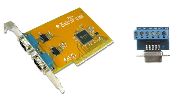

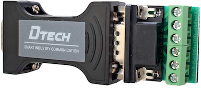

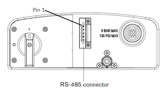

15.15. Hypertherm PowerMax Communications
Communications can be established with a Hypertherm PowerMax plasma cutter that has a RS485 port. This feature enables the setting of Cut Mode, Cutting Amperage and Gas Pressure automatically from the Cut Parameters of the material file. In addition, the user will be able to view the PowerMax’s Arc On Time in hh:mm:ss format on the STATISTICS Tab.
If Gas Pressure is set to Zero then the PowerMax will automatically calculate the required pressure from the Cut Mode, Cut Current, torch type, and torch length.
Changing the cutting mode will set the gas pressure to zero causing the machine to use its automatic gas pressure mode.
The maximum and minimum values of these parameters are read from the plasma cutter and the related spin-buttons in the Cut Parameters are then limited by these values. Gas pressure cannot be changed from zero until communications have been established.
This feature is enabled by setting the correct port name for the PM_PORT option in the [POWERMAX] section of the <machine_name>.prefs file. If the PM_PORT option is not set in the <machine_name>.prefs file then the widgets associated with this feature will not be visible.
Example showing enabling the Hypertherm PowerMax Communications on USB0:
[POWERMAX]
Port = /dev/ttyusb0
If the user is unsure of the name of the port, there is a Python script in the configuration directory that will show all available ports and can also be used to test communications with the plasma unit prior to enabling this feature in the QtPlasmaC GUI.
To use the test script follow these instructions:
pmx485-test
pmx485-test
The gas pressure units display (psi or bar) is determined by the data received during initial setup of the communication link and is then shown next to the Gas Pressure setting in the MATERIAL section of the PARAMETERS Tab.
Die PowerMax-Maschine wechselt nach dem Aufbau der Kommunikation in den Remote-Modus und kann zu diesem Zeitpunkt nur ferngesteuert werden (über die QtPlasmaC-GUI). Die Verbindung kann durch Beobachtung des PowerMax-Displays validiert werden.
Um den PowerMax wieder in den lokalen Modus zu schalten, kann der Benutzer entweder:
  1. Disable PowerMax Comms from the MAIN Tab
  2. LinuxCNC Schließen, wodurch der PowerMax während des Herunterfahrens in den lokalen Modus versetzt wird.
  3. Den PowerMax für 30 Sekunden aus- und dann wieder einschalten.
Tipp
If PowerMax communications is active then selecting Mesh Mode will automatically select CPA mode on the PowerMax unit.
Anmerkung
To use the PowerMax communications feature it is necessary to have the Python pyserial module installed.
If pyserial is not installed an error message will be displayed.
Um pyserial zu installieren, geben Sie den folgenden Befehl in ein Terminalfenster ein:
sudo apt install python3-serial
A typical connection diagram is shown in the appendix of this document as well as confirmed working interfaces.

Create temporary default material
(o=0, nu=2, na=5mm Mild Steel 40A, ph=3.1, pd=0.1, ch=0.75, fr=3000)
Material bearbeiten, falls nicht vorhanden, ein neues Material anlegen
(o=2, nu=2, na=5mm Mild Steel 40A, ph=3.1, pd=0.1, ch=0.75, fr=3000, kw=1.0)
17.5. Mesa THCAD
Das Mesa THCAD ist eine gängige Methode, um die Lichtbogenspannung von einem Plasmaschneider zu erhalten, und ist auch für die ohmsche Messung des Materials während des Abtastens nützlich. Das THCAD kann sowohl für Konfigurationen mit parallelen Anschlüssen als auch für Konfigurationen mit Mesa Electronics-Hardware verwendet werden. Das THCAD ist in drei verschiedenen Modellen erhältlich: THCAD-5, THCAD-10 und THCAD-300.
Auf jeder THCAD-Karte befindet sich ein Mode-Jumper, der auf UNIPOLAR gesetzt werden sollte.
Auf jeder THCAD-Karte befindet sich ein Frequenzteiler-Jumper, der je nach Hardware-Typ gesetzt werden sollte:
Input Device Recommended Setting
Parallele Schnittstelle mit sehr geringer Latenzzeit
F/32
Parallele Schnittstelle empfohlener Startpunkt
F/64
Paralleler Anschluss mit höherer Latenzzeit oder beim Schneiden von dickem Material
F/128
Mesa Card
F/32
This value is required to be entered into PnCconf during installation.
Anmerkung
If using a parallel port it may be necessary for the user to adjust the jumper setting and the subsequent scaling values on the Parameters Tab to achieve optimal results. Symptoms may include random torch raises or dives during otherwise stable cutting. Halscope plots may be useful in diagnosing these issues.
Auf der Rückseite des THCADs befindet sich ein Kalibrierungsaufkleber:
    THCAD-nnn
 0V  121.1 kHz
 5V  925.3 kHz
or similar values, these values are required to be entered into PnCconf during installation.
PnCconf has entries for all required THCAD parameters and will calculate and configure any required settings. The calculations used are as follows:
Voltage Scale
vs = r / ((f - z) / d / v)
Voltage Offset
vo = z / d
r = Teilerverhältnis (siehe unten).
f = Skalenendwert vom Kalibrierungsaufkleber.
z = 0 V value from calibration sticker.
d = Wert von Jumper oben.
v = full scale voltage of THCAD
Teiler-Verhältnis
THCAD-5 oder THCAD-10
If connecting to a plasma CNC port then the divider ratio is selected from the plasma machine. A common ratio used is 20:1.
If connecting to the plasma machines full arc voltage then a common setup for a THCAD-10 is to use a 1 MΩ resistor from arc negative to THCAD negative and a 1 MΩ resistor from arc positive to THCAD positive. The divider ratio is obtained by:
r = (total_resistance + 100000) / 100000
THCAD-300
r = 1
Wichtig
WENN DER BENUTZER EINE HF-STARTPLASMA-STROMVERSORGUNG VERWENDET, SOLLTE JEDER DIESER WIDERSTÄNDE AUS MEHREREN HOCHSPANNUNGSWIDERSTÄNDEN BESTEHEN.
Achtung
WENN DER BENUTZER EINE HF-STARTPLASMA-STROMVERSORGUNG VERWENDET, WIRD EINE OHMSCHE ABTASTUNG NICHT EMPFOHLEN.
Anmerkung
Diese Werte können mit diesem Online-Rechner berechnet werden.
Anmerkung
There is a lowpass filter available which may be useful if using a THCAD and there is a lot of noise on the returned arc voltage.

Hypertherm RS485 Verdrahtungsplan (Drahtfarben innerhalb des Hypertherm in Klammern):
Connection at Machine Pin # Connection at Breakout Board
1 - Tx+ (Rot)
->RXD+
2 - Tx- (schwarz)
->RXD-
3 - Rx+ (braun)
->T/R+
4 - Rx- (weiß)
->T/R-
5 - GND (grün)
->GND
images/qtplasmac_rs485_pmx.png
RS485-Schnittstellen, von denen bekannt ist, dass sie funktionieren:
DTECH DT-5019 USB zu RS-485 Konverter Adapter:
images/qtplasmac_rs485_dtech.png
Um eine serielle Verbindung der Hauptplatine oder eine serielle Karte (RS232) in RS485 umzuwandeln, sind folgende Schritte erforderlich:
DTECH RS-232 zu RS-485 Konverter:
images/qtplasmac_rs485_converter.png
Beispiel einer seriellen Karte (Sunnix SER5037A PCI-Karte mit Breakout Board):
images/qtplasmac_rs485_sunnix.png
