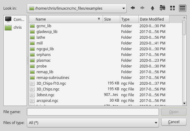

Gets line number from STATUS message gcode-line-selected.
run_from_line slot
Gets line number from Qt Designer int/str slot setRunFromLine.
abort
pause
load dialog
Requires a dialog widget present.

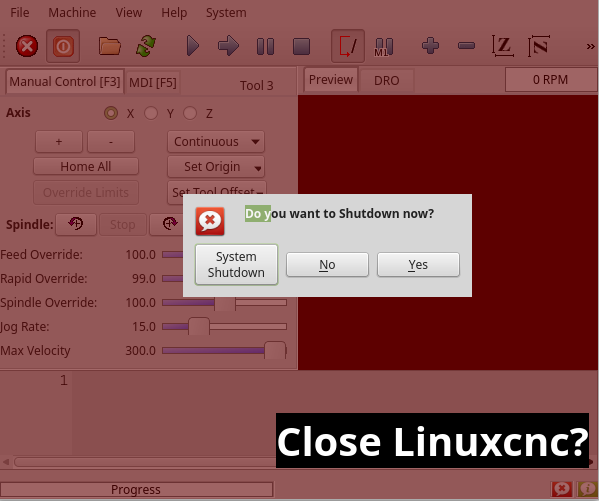

exit screen
Closes down LinuxCNC

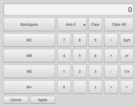

2.4. AxisToolButton - Select and Set Axis Widget
This allows one to select and set an axis.
If the button is set checkable, it will indicate which axis is selected.
If you press and hold the button a pop up menu will show allowing one to:
  • Nullen der Achse
  • Divide the axis by 2
  • Set the axis arbitrarily
  • Reset the axis to the last number recorded
You must have selected an entry dialog that corresponds to the dialog_code_string, usually this is selected from the screenOptions widget.
You can select the property halpin_option, it will then set a HAL pin true when the axis is selected. The property joint_number should be set to the appropriate joint number. The property axis_letter should be set to the appropriate axis letter.
The property dialog_code_string can be changed to ENTRY or CALCULATOR to call a typing only entry dialog or a touch/typing calculator type entry dialog.
Es basiert auf PyQts QToolButton.

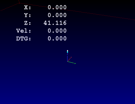

2.9. GCodeGraphics - G-code Graphic Backplot Widget
QtVCP GcodeGraphics: G-code Graphic Backplot Widget
Abbildung 6. QtVCP GcodeGraphics: G-code Graphic Backplot Widget
This displays the current G-code in a graphical form.

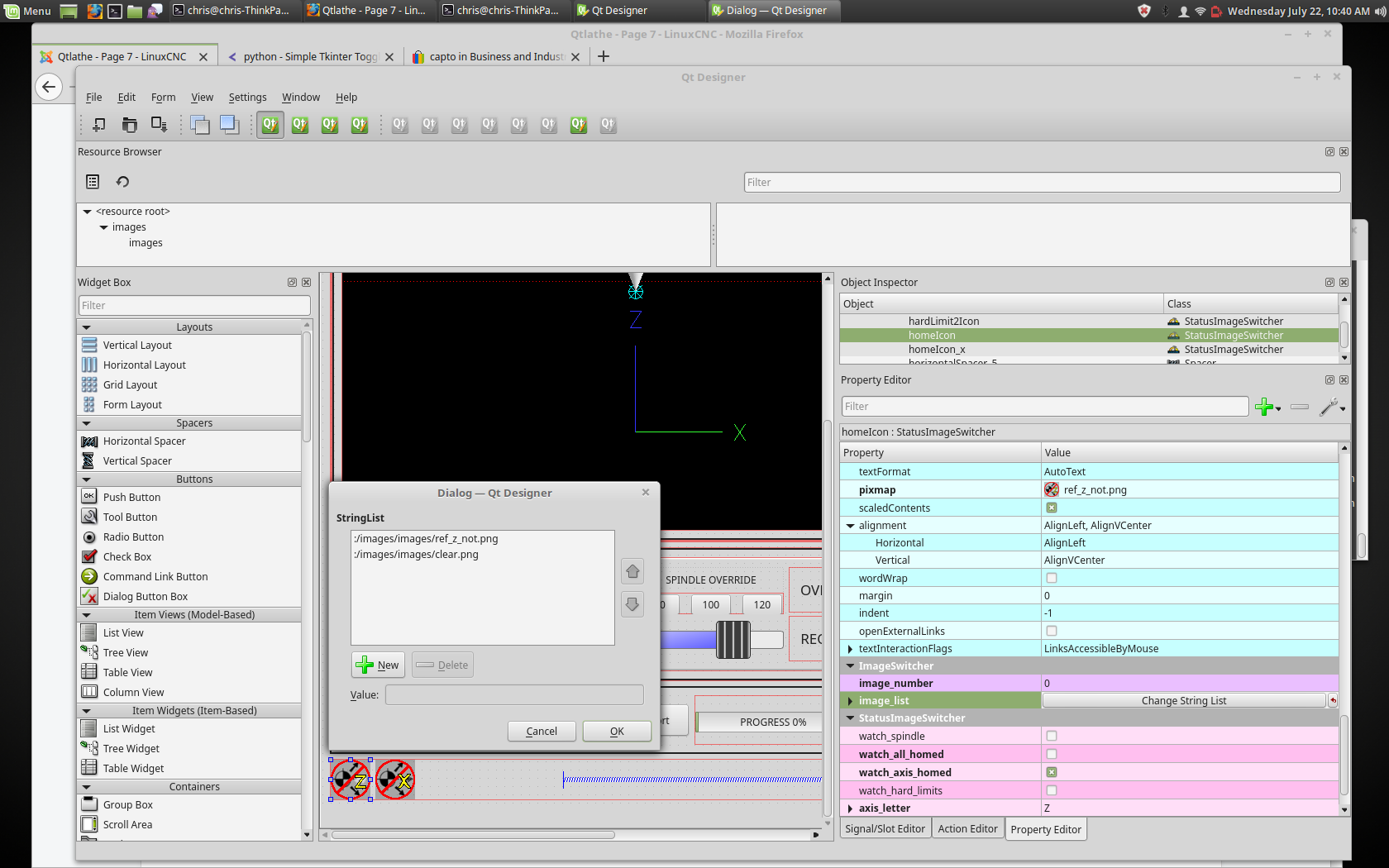

2.12. StatusImageSwitcher - Controller Status Image Switcher
Status image switcher will switch between images based on LinuxCNC states.
*watch_spindle
Wechselt zwischen 3 Bildern: stop, fwd, revs.
*watch_axis_homed
Toggles between 2 images: axis not homed, axis homed.
*watch_all_homed
Would toggle between 2 images: not all homed, all homed.
*watch_hard_limits
Würde zwischen 2 Bildern oder einem pro Gelenk umschalten.
Here is an example of using it to display an icon of Z axis homing state:
QtVCP StatusImageSwitcher: Controller Status Image Switcher
Abbildung 7. QtVCP StatusImageSwitcher: Controller Status Image Switcher
In the properties section notice that:
  • watch_axis_homed is checked
  • axis_letter is set to Z
If you double click the image_list a dialog will show and allow you to add image paths to.
If you have one image as an icon and one clear image then that will look like it shows and hides the icon.
Selecting image paths can be done by selecting the pixmap property and selecting an image.
Anmerkung
The pixmap setting is for test display only and will be ignored outside of Qt Designer.
  • Right click the image name and you should see Copy path.
  • Click Copy path.
  • Now double click the image list property so the dialog shows.
  • Click the New button.
  • Paste the image path in the entry box.
Do that again for the next image.
Use a clear image to represent a hidden icon.
Sie können die Anzeige der Bilder in der Bilderliste testen, indem Sie die image number (engl. für Bildnummer) ändern. In diesem Fall ist 0 unhomed und 1 würde homed sein.
Dies ist nur für die Testanzeige und wird außerhalb von Qt Designer ignoriert.

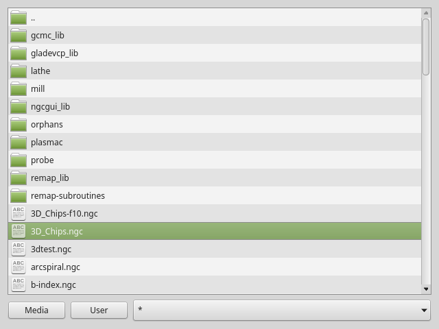

fileDialog_option
Richtet den Dateiauswahldialog ein.
file_overlay_color
Farbe der transparenten Ebene, die angezeigt wird, wenn der Dateidialog angezeigt wird.

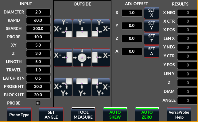

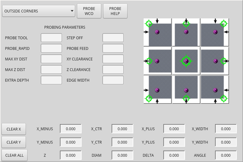

vesaProbe_option
Richtet den Versa-Style-Probe-Dialog ein.
versaProbe_overlay_color
Farbe der transparenten Ebene, die angezeigt wird, wenn der Dialog versaProbe angezeigt wird.

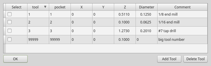

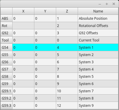

toolOffset_option
Sets up the tool offset display/editor dialog.
toolOffset_overlay_color
Farbe der transparenten Ebene, die angezeigt wird, wenn der toolOffset-Dialog angezeigt wird.

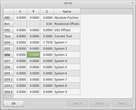

originOffset_option
Richtet das Dialogfeld für die Anzeige/Editierung des Ursprungs ein.
originOffset_overlay_color
Farbe der transparenten Ebene, die angezeigt wird, wenn der originOffset-Dialog angezeigt wird.
calculatorDialog_option
Sets up the calculator entry dialog.
calculator_overlay_color
Farbe der transparenten Ebene, die angezeigt wird, wenn das Dialogfeld "Rechner" angezeigt wird.

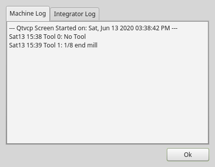

machineLogDialog_option
Richtet einen Dialog ein, um Protokolle von der Maschine und QtVCP anzuzeigen.
machineLog_overlay_color
Farbe der transparenten Ebene, die angezeigt wird, wenn der machineLog-Dialog angezeigt wird.

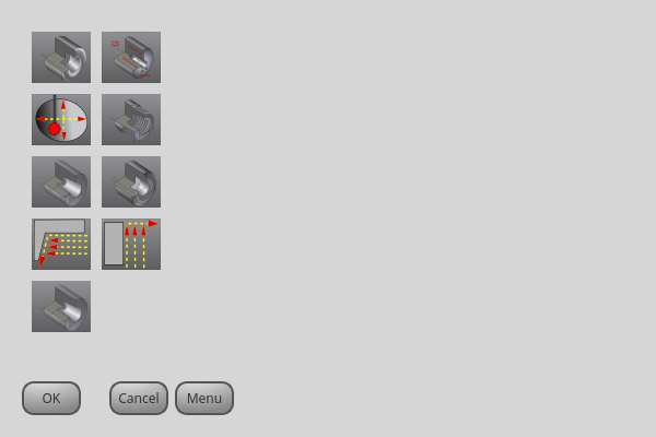

2.20. MacroTab - Spezielles Makro-Widget
QtVCP MacroTab: Special Macros Widget
Abbildung 8. QtVCP MacroTab: Spezielles Makro-Widget
Mit diesem Widget kann der Benutzer spezielle Makroprogramme für die Erledigung kleinerer Aufgaben auswählen und anpassen.
Es verwendet Bilder zur visuellen Darstellung des Makros und für ein Symbol.
Es sucht nach speziellen Makros unter Verwendung der INI-Definition:
[RS274NGC]
SUBROUTINE_PATH =
Die Makros sind O-Wort-Unterprogramme mit speziellen Kommentaren für die Zusammenarbeit mit dem Launcher. Die ersten drei Zeilen müssen die untenstehenden Schlüsselwörter enthalten, die vierte ist optional.
Hier ist ein Beispiel für die ersten vier Zeilen einer O-Word-Datei:
; MACROCOMMAND = Entry1,Entry2
; MACRODEFAULTS = 0,true
; MACROIMAGE = my_image.svg,Icon layer number,Macro layer number
; MACROOPTIONS = load:yes,save:yes,default:default.txt,path:~/macros

2.24. OriginOffsetView - Ursprungsansicht und Einstellungs-Widget
QtVCP OriginOffsetsView: Origins-Ansicht und Einstellungs-Widget
Abbildung 10. QtVCP OriginOffsetsView: Origins-Ansicht und Einstellungs-Widget
Dieses Widget ermöglicht es, Offsets von Benutzer-spezifizierten Ursprüngen direkt zu visualisieren und zu ändern.
Es wird die Parameterdatei von LinuxCNC für vorgenommene oder gefundene Änderungen aktualisieren.
Die Einstellungen können in LinuxCNC nur nach der Referenzfahrt und im Ruhezustand des Motion Controllers geändert werden.
The display and entry will change between metric and imperial, based on LinuxCNC’s current G20 / G21 setting.
The current in-use user system will be highlighted.
Extra actions can be integrated to manipulate settings.
These actions depend on extra code added either to a combined widget, like originoffsetview dialog, or the screens handler code.
Typical actions might be Clear Current User offsets or Zero X.
Clicking on the columns and rows allows one to adjust the settings.
A dialog can be made to popup for data or text entry.
The comments section will be recorded in the preference file.
Es basiert auf PyQt’s QTableView, QAbstractTableModel, und ItemEditorFactory.
Eigenschaften, Funktionen und Stile der PyQt-Basisobjekte sind immer verfügbar.
Eigenschaften
OriginOffsetView has the following properties:
dialog_code_string
Sets which dialog will pop up with numerical entry.
test_dialog_code_string
Sets which dialog will pop up with text entry.
metric_template
Metric numerical data format.
imperial_template
Imperial numerical data format.
styleCodeHighlight
Current in-use user system highlight color.
Diese können eingestellt werden in:
  • Qt Designer, in
  • Python handler code
    self.w.originoffsetview.setProperty('dialog_code','CALCULATOR')
    self.w.originoffsetview.setProperty('metric_template','%10.3f')
  • Or (if appropriate) in stylesheets
    OriginOffsetView{
      qproperty-styleColorHighlist: lightblue;

2.26. MachineLog - Machine Events Journal Display Widget
FIXME MachineLog documentation

2.28. StatusImageSwitcher - Controller Status Image Switching Widget
Dieses Widget wird Bilder basierend auf dem LinuxCNC-Status anzeigen.
You can watch:
  • the state of the spindle,
  • the state of all homed,
  • the state of a certain axis homed,
  • the state of hard limits.
It is based on PyQt’s FIXME
2.29. FileManager - File Loading Selector Widget
QtVCP FileManager: File Loading Selector Widget
Abbildung 11. QtVCP FileManager: File Loading Selector Widget
This widget is used to select files to load.
Sie verfügt über die Möglichkeit, die Namen mit Hardware wie einem Handgerät (engl. MPG) zu kennzeichnen.
One can class patch the function load(self,fname) to customize file loading.
The function getCurrentSelected() will return a Python tuple, containing the file path and whether it is a file.
temp = FILEMANAGER.getCurrentSelected()
print('filepath={}'.format(temp[0]))
if temp[1]:
    print('Is a file')

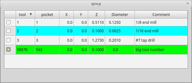

2.31. ToolOffsetView - Tools Offsets View And Edit Widget
QtVCP ToolOffsetView: Tools Offsets View And Edit Widget
Abbildung 12. QtVCP ToolOffsetView: Tools Offsets View And Edit Widget
This widget displays and allows one to modify tools offsets.
It will update LinuxCNC’s tool table for changes made or found.
The tool settings can only be changed in LinuxCNC after homing and when the motion controller is idle.
The display and entry will change between metric and imperial based on LinuxCNC’s current G20/G21 setting.
The current in-use tool will be highlighted, and the current selected tool will be highlighted in a different color.
The checkbox beside each tool can be used to select too for an action that depends on extra code added either to a combined widget, like the toolOffsetView dialog or the screens handler code.
Typical actions are load selected tool, delete selected tools, etc.
The comments section will typically be displayed in the manual tool change dialog.
If using a lathe configuration, there can be columns for X and Z wear.
To use these columns to adjust the tool wear, it requires a remapped tool change routine.
Eigenschaften
ToolOffsetView hat Eigenschaften, die im Qt Designer, im Python-Handler-Code oder (falls zutreffend) in Stylesheets eingestellt werden können:
dialog_code_string
metric_template
imperial_template
styleCodeHighlight
Current tool-in-use highlight color.
styleCodeSelected
Selected highlight color.
In a handler file:
self.w.tooloffsetview.setProperty('dialog_code','CALCULATOR')
self.w.tooloffsetview.setProperty('metric_template','%10.3f')
und in Stylesheets:
ToolOffsetView{
  qproperty-styleColorSelected: #444;

set_all_unchecked()
Hebt die Markierung aller ausgewählten Werkzeuge auf.
Example for handler file executing aforementioned functions.
self.w.tooloffsetview.add_tool()
self.w.tooloffsetview.delete_tools()
toolList = self.w.tooloffsetview.get_checked_list()
self.w.tooloffsetview.set_all_unchecked()

2.33. VersaProbe - Mill Probing Widget
QtVCP VersaProbe: Mill Probing Widget
Abbildung 14. QtVCP VersaProbe: Mill Probing Widget
Widget zum Sondieren auf einer Fräse. Wird vom QtDragon-Bildschirm verwendet.

3.3. FileDialog - Dialog Widget zum Laden und Speichern von Dateien
QtVCP FileDialog: Widget zum Laden und Speichern von Dateien
Abbildung 16. QtVCP FileDialog: Widget für das Laden und Speichern von Dateien
Dies wird zum Laden von G-Code-Dateien verwendet.
Wenn ein Fokus-Overlay-Widget vorhanden ist, signalisiert es, dass es angezeigt werden soll.
Wenn Sie die Request-Dialog-Funktion von STATUS verwenden, lauten die Standard-Startnamen LOAD oder SAVE.
Es gibt options, die beim Anfordern eines Dialogs gesetzt werden können, diese würden dem Meldungsdiktat hinzugefügt:
EXTENSIONS
FILENAME
DIRECTORY
Ein Beispiel für einen Python-Aufruf, für einen Load-Dialog:
mess = {'NAME':'LOAD','ID':'_MY_DIALOG_',
            'TITLE':'Load Some text File',
            'FILENAME':'~/linuxcnc/nc_files/someprogram.txt',
            'EXTENSIONS':'Text Files (*.txt);;ALL Files (*.*)'
ACTION.CALL_DIALOG(mess)
Und für einen Speicherdialog
mess = {'NAME':'SAVE','ID':'_MY_DIALOG_',
            'TITLE':'Save Some text File',
Sie basiert auf der QMessagebox von PyQt.
3.4. OriginOffsetDialog - Dialogfeld-Widget für die Einstellung des Ursprungsversatzes
QtVCP `OriginOffsetDialog`: Widget zur Einstellung des Ursprungsversatzes
Abbildung 17. QtVCP OriginOffsetDialog: Widget zur Einstellung des Ursprungsversatzes
Mit diesem Widget kann man die Nullpunktverschiebung des Benutzersystems direkt in einem Dialogformular ändern.
Wenn ein Fokus-Overlay-Widget vorhanden ist, wird es angezeigt.
Bei Verwendung der request-dialog-Funktion von STATUS ist der standardmäßige Startname ORIGINOFFSET.
Es basiert auf PyQts QDialog.
3.5. ToolOffsetDialog - Dialogfenster-Widget zur Einstellung des Werkzeugversatzes
QtVCP `ToolOffsetDialog`: Werkzeug-Offset-Einstellungsdialog-Widget
Abbildung 18. QtVCP ToolOffsetDialog: Werkzeug-Offset-Einstellungsdialog-Widget
Mit diesem Widget kann man die Werkzeugversätze direkt in einem Dialogformular ändern.
Bei Verwendung der request-dialog-Funktion von STATUS ist der standardmäßige Startname TOOLOFFSET.
3.6. MacroTabDialog - Dialog-Widget zum Starten von Makros
Dies ist ein Dialog zum Anzeigen des Makrotab-Widgets.
MacroTab zeigt eine Auswahl von Makroprogrammen an, die mit Symbolen ausgeführt werden.
When using ``STATUS``'s request-dialog function, the default launch name is MACROTAB.

3.9. CalculatorDialog - Calculator Dialog Widget
QtVCP CalculatorDialog: Calculator Dialog Widget
Abbildung 19. QtVCP CalculatorDialog: Calculator Dialog Widget
This is a dialog to display a calculator for numeric entry, such as origin offset.
It returns the entry via STATUS messages using a Python DICT.
The DICT contains at minimum, the name of the dialog requested and an ID code.
When using ``STATUS``'s request-dialog function, the default launch name is CALCULATOR.

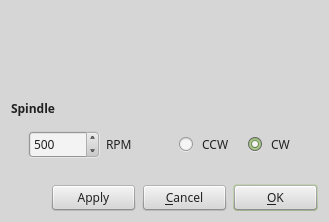

3.10. RunFromLine - Run-From-Line Dialog Widget
QtVCP RunFromLine: Run-From-Line Dialog Widget
Abbildung 20. QtVCP RunFromLine: Run-From-Line Dialog Widget
Dialog to preset spindle settings before running a program from a specific line.
3.11. VersaProbeDialog - Part Touch Probing Dialog Widget
QtVCP VersaProbeDialog: Part Touch Probing Dialog Widget
Abbildung 21. QtVCP VersaProbeDialog: Part Touch Probing Dialog Widget
This is a dialog to display a part probing screen based on Verser Probe v2.
3.12. MachineLogDialog - Machine and Debugging Logs Dialog Widget
QtVCP MachineLogDialog: Machine and Debugging Logs Dialog Widget
Abbildung 22. QtVCP MachineLogDialog: Machine and Debugging Logs Dialog Widget
This is a dialog to display the machine log and QtVCP’s debugging log.

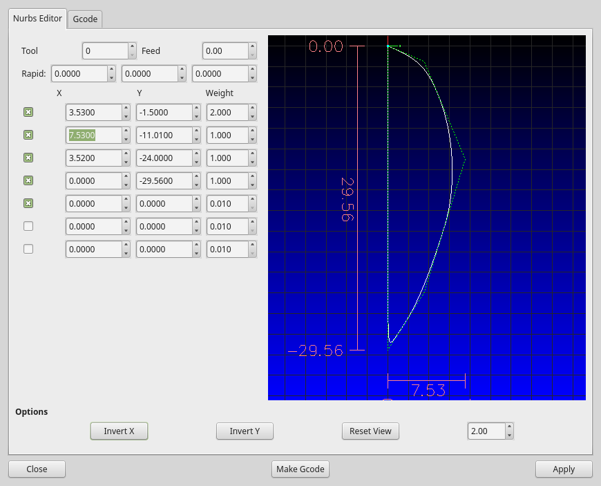

4.1. NurbsEditor - NURBS Editing Widget
QtVCP NurbsEditor: NURBS Editing Widget
Abbildung 23. QtVCP NurbsEditor: NURBS Editing Widget
The Nurbs editor allows you to manipulate a NURBS based geometry on screen and then convert NURBS to G-code.
You can edit the G-code on screen and then send it to LinuxCNC.

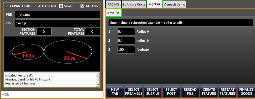

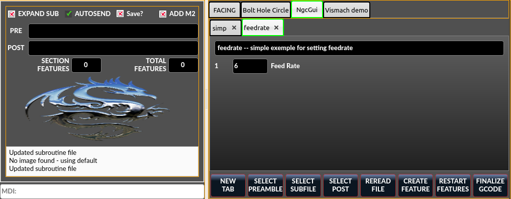

6.5. Qt NGCGUI
QtVCP NGCGUI: Shown from QtDragon
QtVCP’s version of NGC subroutine selector (Shown as used in QtDragon).
6.5.1. INI-Einstellungen
LinuxCNC needs to know where to look to run the subroutines.
If the subroutine calls other subroutines or custom M codes, those paths must be added too.
[RS274NGC]
SUBROUTINE_PATH = ~/linuxcnc/nc_files/examples/ngcgui_lib:~/linuxcnc/nc_files/examples/ngcgui_lib/utilitysubs
QtVCP needs to know where to open subroutines from.
You can also specify subroutines to be pre-opened in tabs.
[DISPLAY]
# NGCGUI subroutine path.
# This path must also be in [RS274NGC] SUBROUTINE_PATH
NGCGUI_SUBFILE_PATH = ~/linuxcnc/nc_files/examples/ngcgui_lib
# pre selected programs tabs
# specify filenames only, files must be in the NGCGUI_SUBFILE_PATH
NGCGUI_SUBFILE = slot.ngc
NGCGUI_SUBFILE = qpocket.ngc
6.5.2. Buttons
  • NEW TAB - add new blank tab to NGCGUI
  • SELECT PREAMBLE - select a file that add preamble G-code
  • SELECT SUBFILE - select a NGCGUI subroutine file
  • SELECT POST - select a file that add post G-code
  • REREAD FILE - reload the subroutine file
  • CREATE FEATURE - add feature to the list
  • RESTART FEATURE - remove all features from the list
  • FINALIZE GCODE - create the full G-code and send it to LinuxCNC/a file
6.5.3. Adding Custom Subroutines
You can create your own subroutines for use with NGCGUI. They must follow these rules:
  • Um ein Unterprogramm für die Verwendung mit NGCGUI zu erstellen, müssen der Dateiname und der Name des Unterprogramms identisch sein.
  • The subroutine must be in a folder within LinuxCNC’s INI designated search path.
  • On the first line there may be a comment of type info:
  • The subroutine must be surrounded by the sub and endsub tags.
  • Die verwendeten Variablen müssen nummerierte Variablen sein und dürfen keine Nummer überspringen.
  • Kommentare und Voreinstellungen können enthalten sein.
  • If an image file of the same name is in the folder, it will be shown.
(info: feedrate -- simple example for setting feedrate)
o<feedrate> sub
    #<feedrate>       = #1 (= 6 Feed Rate) ; comments in brackets will be shown in ngcui
    f#<feedrate>
o<feedrate> endsub
