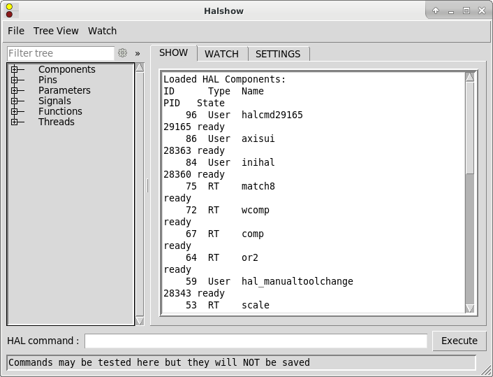

Halshow-Layout
Abbildung 1. Halshow-Layout
At the left of its display as shown in above figure is a tree view, resembling what you may have seen as file browsers. At the right is a tabbed notebook with tabs for show, watch and settings.

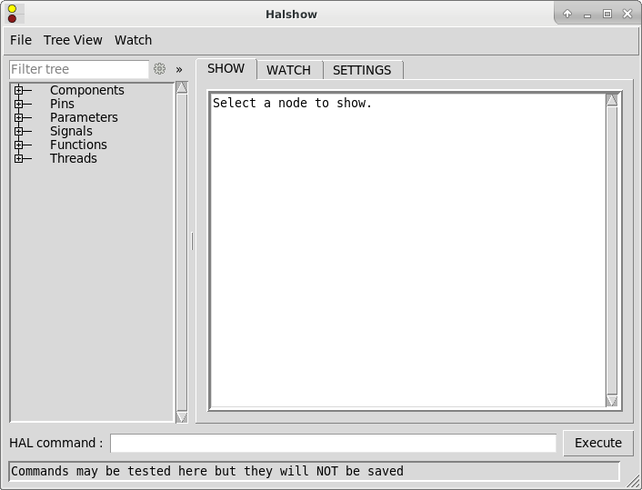

2.2. Tree
The tree shows all of the major parts of a HAL. In front of each is a small plus (+) or minus (-) sign in a box to expand or collapse the corresponding section of the tree.
You can also expand or collapse the tree display using the Tree View menu at the upper left edge of the display.
Under Tree View you will find: Expand All, Collapse All; Expand Pins, Expand Parameters, Expand Signals; and Reload tree view. Reload tree view is useful when new components are loaded during runtime and should be displayed.

Clicking on the node name, "Components" in the tree for example, will show you (under the "Show" tab) all that HAL knows about the contents of that node. Figure Halshow Show Tab shows a list exactly like you will see if you click the "Components" name. The information display is exactly like those shown in traditional text based HAL analysis tools. The advantage here is that we have mouse click access, access that can be as broad or as focused as you need.
If we take a closer look at the tree display we can see that the six major parts of a HAL can all be expanded at least one level. As these levels are expanded you can get more focused with the reply when you click on the rightmost tree node. You will find that there are some HAL pins and parameters that show more than one reply. This is due to the nature of the search routines in halcmd itself. If you search one pin you may get two, like this:

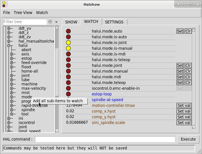

4. Watch Area
Clicking the watch tab produces a blank canvas. You can add signals and pins to this canvas and watch their values. You can add signals or pins when the watch tab is displayed by clicking on the name of it in the tree view.
New in 2.9
You can also add all sub-items of this node by selecting that in the right click menu (see figure Halshow Watch Tab).
The following figure shows this canvas with several pins.
Halshow Watch Tab
Abbildung 3. Halshow: Watch Tab
Watch displays bit type (binary) values using colored circles representing LEDs. They show as dark red when a bit signal or pin is false, and as light yellow whenever that signal is true. If you select a pin or signal that is not a bit type (binary) signal, watch will show it as a numerical value. Pins are displayed in black, signals in blue and parameters in brown.
Watch will quickly allow you to test switches or see the effect of changes that you make to LinuxCNC while using the graphical interface. Watch’s refresh rate is a bit slow to see stepper pulses, but you can use it for these if you move an axis very slowly or in very small increments of distance.

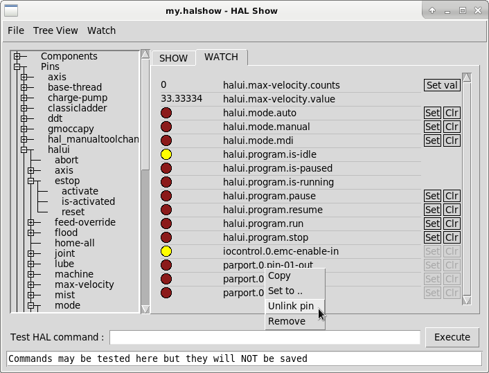

New in 2.9
The pins and signals that are writable have buttons for manipulation on the right side. Pins that are linked to a signal have disabled buttons. To set these values, the corresponding pin has to be unlinked from the signal. That can be done by right-click on the signal name and select "Unlink pin", see Watch Tach Context Menu.
The watch list will be saved automatically on exit. If you don’t want Halshow to save your watchlist, it can be disabled in the Settings.
Context Menu
New in 2.9
The context menu allows further:
  • Copy the pin name to clipboard
  • Set a value
  • Unlink a pin (if linked to a signal)
  • Show apin in the Tree view (highlights the pin, doesn’t scroll to the position)
  • Remove a pin from the list
Halshow: Kontextmenü der Registerkarte 'Watch'
Abbildung 4. Halshow: Kontextmenü der Registerkarte Watch

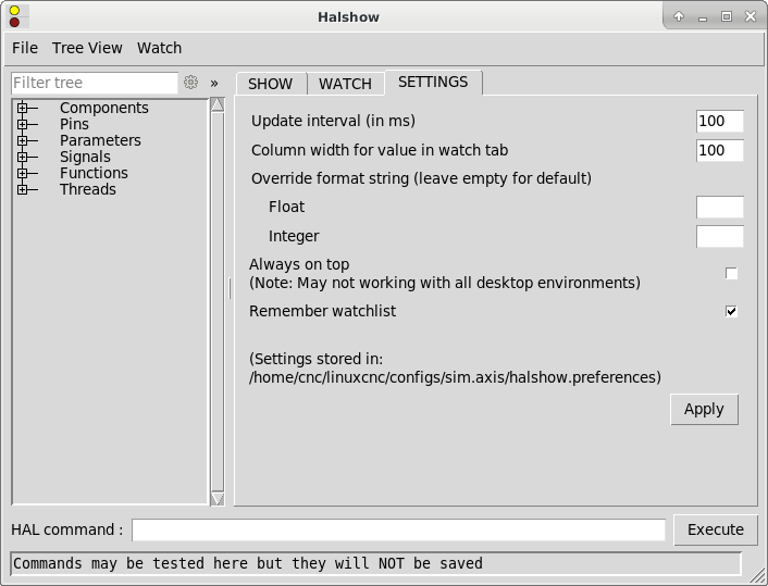

6. Settings
New in 2.9
The geometry of the window and the settings are saved in a file in the configuration directory on exit. If that path cannot be determined, they are stored in the home directory. The path will be displayed in the settings page. You can omit using the preferences file by calling halshow with the command line argument --no-prefs.
The further settings should be self-explaining.

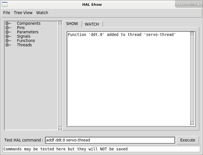

Here we look for owner #08 and see a function named ddt.0. We should be able to add ddt.0 to the servo thread and it will do its math each time the servo thread is updated. Once again we look up the addf command and find that it uses three arguments like this:
addf <Funktionsname> <Threadname> [<Position>]
We already know the functname=ddt.0 so let’s get the thread name right by expanding the thread node in the tree. Here we see two threads, servo-thread and base-thread. The position of ddt.0 in the thread is not critical. So we add the function ddt.0 to the servo-thread:
addf ddt.0 servo-thread
This is just for viewing, so we leave position blank and get the last position in the thread. The following figure shows the state of halshow after this command has been issued.
Addf-Befehl
Abbildung 6. Addf-Befehl
