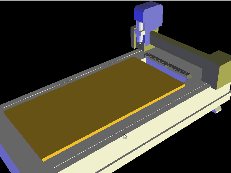

2.2. QtVCP vismach_router_atc
3D OpenGL view of a 3-Axis router style, gantry bed milling machine.
This particular panel shows how to define and connect the model parts in the handler file, rather then importing the pre-built model from QtVCP’s vismach library.
loadusr qtvcp vismach_router_atc
QtVCP vismach_router_atc - 3-Axis Gantry Bed Mill 3D View Panel
Figure 10. QtVCP vismach_router_atc - 3-Axis Gantry Bed Mill 3D View Panel
