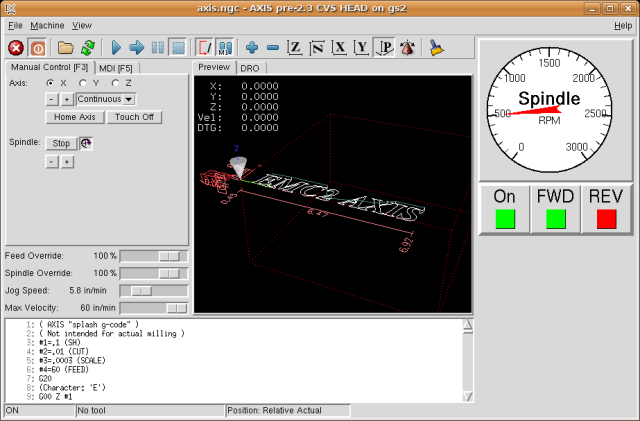

5. GS2 RPM Meter
The following example uses the Automation Direct GS2 VDF driver and displays the RPM and other info in a PyVCP panel. This example is based on the GS2 example in the Hardware Examples section this manual.

The above gives us a PyVCP panel that looks like the following.
GS2 Panel
5.2. The Connections
To make it work we add the following code to the custom_postgui.hal file.
# vis rotasjonshastigeten basert på frekvens * rpm per hz
loadrt mult2
addf mult2.0 servo-thread
setp mult2.0.in1 28.75
net cypher_speed mult2.0.in0 <= spindle-vfd.frequency-out
net speed_out pyvcp.spindle_rpm <= mult2.0.out
# run led
net gs2-run => pyvcp.on-led
# fwd led
net gs2-fwd => pyvcp.fwd-led
# rev led
net running-rev spindle-vfd.spindle-rev => pyvcp.rev-led
Some of the lines might need some explanations. The fwd led line uses the signal created in the custom.hal file whereas the rev led needs to use the spindle-rev bit. You can’t link the spindle-fwd bit twice so you use the signal that it was linked to.

pyvcp rth
In your configuration directory create the XML file. In this example it’s named rth.xml. In the rth.xml file add the following code to create the button.
<pyvcp>
<!-- rapid to home button example -->
<button>
<halpin>"rth-button"</halpin>
<text>"Rapid to Home"</text>
</button>
</pyvcp>
Open your INI file with a text editor and in the [DISPLAY] section add the following line. This is what loads the PyVCP panel.
PYVCP = rth.xml
If you don’t have a [HALUI] section in the INI file create it and add the following MDI command.
MDI_COMMAND = G53 G0 X0 Y0 Z0
Note
Informasjon om G-kodene G53 og G0.
In the [HAL] section if you don’t have a post gui file add the following and create a file called postgui.hal.
POSTGUI_HALFILE = postgui.hal
In the postgui.hal file add the following code to link the PyVCP button to the MDI command.
net rth halui.mdi-command-00 <= pyvcp.rth-button
