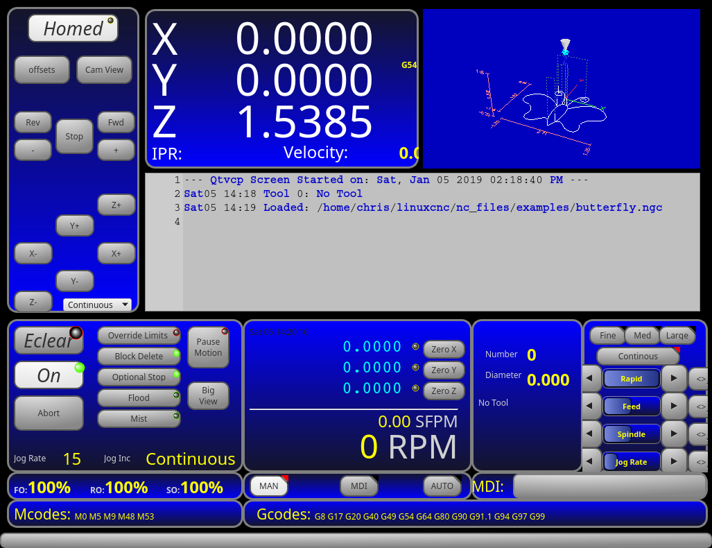

QtDragon Router
Figure 1. QtDragon - 3/4-Axis Sample
Qtscreen Mill
Figure 2. QtDefault - 3-Axis Sample
Qtscreen QtAxis
Figure 3. QtAxis - Self Adjusting Axis Sample
Qtscreen Blender
Figure 4. Blender - 4-Axis Sample
Qtscreen x1mill
Figure 5. X1mill - 4-Axis Sample
Qtscreen x1mill
Figure 6. cam_align - Camera Alignment VCP
Test Panel
Figure 7. test_panel - Test Panel VCP

4. Build A Simple Clean-sheet Custom Screen
QtVCP Ugly custom screen
Figure 12. QtVCP Ugly custom screen
4.1. Overview
To build a panel or screen:
  • Use Qt Designer to build a design you like and save it to your configuration folder with a name of your choice, ending with .ui
  • Modify the configuration INI file to load QtVCP using your new .ui file.
  • Then connect any required HAL pins in a HAL file.
4.2. Get Qt Designer To Include LinuxCNC Widgets
Install Qt Designer
