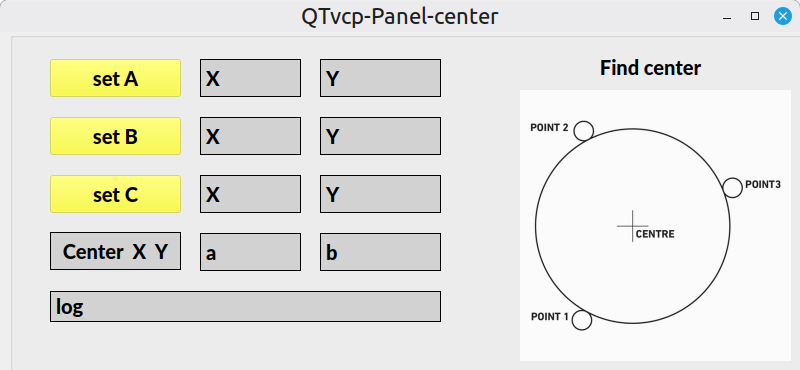

1. Builtin Virtual Control Panels
There are several builtin HAL panels available.
In a terminal type qtvcp list
to see a list.
1.1. copy
Used for copying QtVCP’s builtin Screens/VCP Panels/QtVismach code to a folder so one can customize it.
In a terminal run:
qtvcp copy
copy
Dialog - Screen, VCP Panel or QtVismach Code Copy Panel1.2. spindle_belts
