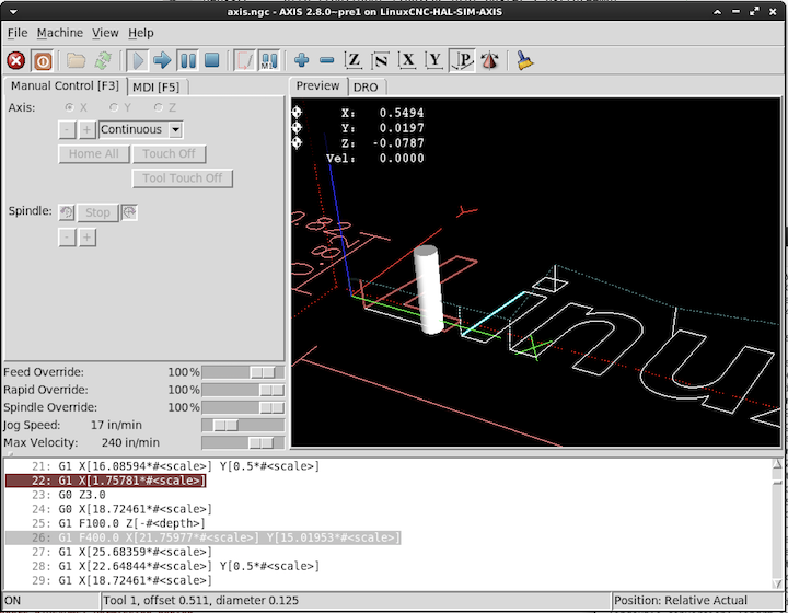

1. Giriş

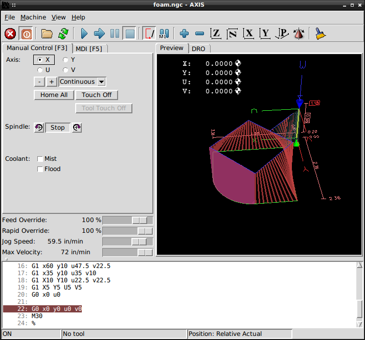

AXIS is a graphical front-end for LinuxCNC which features a live preview and backplot. It is written in Python and uses Tk and OpenGL to display its user interface.
AXIS main window

When AXIS starts, a window like the one in the figure [fig:axis-window] above opens.

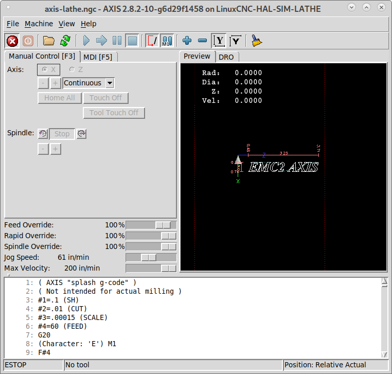

3. AXIS Window
The AXIS window contains the following elements:
  • A display area that shows one of the following:
    • A preview of the loaded file (in this case, axis.ngc), as well as the current location of the CNC machine’s controlled point. Later, this area will display the path the CNC machine has moved through, called the backplot.
    • A large readout showing the current position and all offsets.
  • A menu bar and toolbar that allow you to perform various actions
  • Manual Control Tab - which allows you to make the machine move, turn the spindle on or off, and turn the coolant on or off if included in the INI file.

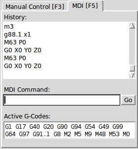

  • MDI Tab - where G-code programs can be entered manually, one line at a time. This also shows the Active G-codes which shows which modal G-codes are in effect.
  • Feed Override - which allows you to scale the speed of programmed motions. The default maximum is 120% and can be set to a different value in the INI file. See the Display Section of the INI file for more information.
  • Spindle Override - which allows you to scale the spindle speed up or down.
  • Jog Speed - which allows you to set the jog speed within the limits set in the INI file. See the Display Section of the INI file for more information.
  • Max Velocity - which allows you to restrict the maximum velocity of all programmed motions (except spindle synchronized motion).
  • A text display area that shows the loaded G-code.
  • A status bar which shows the state of the machine. In this screen shot, the machine is turned on, does not have a tool inserted, and the displayed position is Relative (showing all offsets), and Actual (showing feedback position).

  • Clear MDI history - Clears the MDI history window.
  • Copy from MDI history - Copies the MDI history to the clipboard
  • Paste to MDI history - Paste from the clipboard to the MDI history window

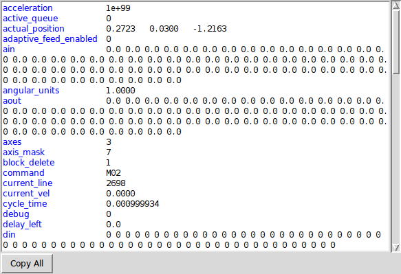

  • Show LinuxCNC Status - Opens a window showing LinuxCNC’s status.

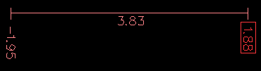

Program Extents
The extents of the program in each axis are shown. At the ends, the least and greatest coordinate values are indicated. In the middle, the difference between the coordinates is shown.
When some coordinates exceed the soft limits in the INI file, the relevant dimension is shown in a different color and enclosed by a box. In figure below the maximum soft limit is exceeded on the X axis as indicated by the box surrounding the coordinate value. The minimum X travel of the program is -1.95, the maximum X travel is 1.88, and the program requires 3.83 inches of X travel. To move the program so it’s within the machine’s travel in this case, jog to the left and Touch Off X again.

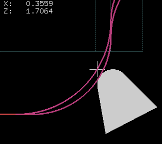

When no tool is loaded, the location of the tip of the tool is indicated by the tool cone. The tool cone does not provide guidance on the form, length, or radius of the tool.
When a tool is loaded (for instance, with the MDI command T1 M6 ), the cone changes to a cylinder which shows the diameter of the tool given in the tool table file.

When the program is running, the line currently being executed is highlighted in red. If no line has been selected by the user, the text display will automatically scroll to show the current line.
Current and Selected Lines

3.6. MDI
MDI allows G-code commands to be entered manually. When the machine is not turned on, or when a program is running, the MDI controls are unavailable.
MDI tab
  • History - This shows MDI commands that have been typed earlier in this session.
  • MDI Command - This allows you to enter a G-code command to be executed. Execute the command by pressing Enter or by clicking Go.
  • Active G-codes - This shows the modal codes that are active in the interpreter. For instance, G54 indicates that the G54 offset is applied to all coordinates that are entered. When in Auto the Active G-codes represent the codes after any read ahead by the interpreter.

5. Show LinuxCNC Status (linuxcnctop)
AXIS includes a program called linuxcnctop which shows some of the details of LinuxCNC’s state. You can run this program by invoking Machine > Show LinuxCNC Status
LinuxCNC Status Window
The name of each item is shown in the left column. The current value is shown in the right column. If the value has recently changed, it is shown on a red background.

10. Using AXIS in Lathe Mode
By including the line LATHE = 1 in the [DISPLAY] section of the INI file, AXIS selects lathe mode. The Y axis is not shown in coordinate readouts, the view is changed to show the Z axis extending to the right and the X axis extending towards the bottom of the screen, and several controls (such as those for preset views) are removed. The coordinate readouts for X are replaced with diameter and radius.
AXIS Lathe Mode
Pressing V zooms out to show the entire file, if one is loaded.
When in lathe mode, the shape of the loaded tool (if any) is shown.
Lathe Tool Shape
To change the display to a back tool lathe you need to have both LATHE = 1 and BACK_TOOL_LATHE = 1 in the [DISPLAY] section. This will invert the view and put the tool on the back side of the Z axis.
Lathe Back Tool Shape
11. Using AXIS in Foam Cutting mode
By including the line FOAM = 1 in the [DISPLAY] section of the INI file, AXIS selects foam-cutting mode. In the program preview, XY motions are displayed in one plane, and UV motions in another. In the live plot, lines are drawn between corresponding points on the XY plane and the UV plane. The special comments (XY_Z_POS) and (UV_Z_POS) set the Z coordinates of these planes, which default to 0 and 1.5 machine units.
Foam Cutting Mode
