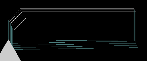

38. G70 Lathe finishing cycle
G70 Q- <X-> <Z-> <D-> <E-> <P->
  • Q - The subroutine number.
  • X - The starting X position, defaults to the initial position.
  • Z - The starting Z position, defaults to the initial position.
  • D - The starting distance of the profile, defaults to 0.
  • E - The ending distance of the profile, defaults to 0.
  • P - The number of passes to use, defaults to 1.
The G70 cycle is intended to be used after the shape of the profile given in the subroutine with number Q has been cut with G71 or G72.
  • Preliminary motion.
    • If Z or X are used a rapid move to that position is done. This position is also used between each finishing pass.
    • Then a rapid move to the start of the profile is executed.
    • The path given in Q- is followed using the G1 and [gcode:g2-g3] commands.
    • If a next pass is required there is another rapid to the intermediate location, before a rapid is done to the start of the profile.
    • After the final pass, the tool is left at the end of the profile including E-.
  • Multiple passes. The distance between the pass and the final profile is (pass-1)*(D-E)/P+E. Where pass the pass number and D,E and P are the D/E/P numbers.
  • The distance is computed using the starting position of the cycle, with a positive distance towards this point.
  • Fillet and chamfers in the profile. It is possible to add fillets or chamfers in the profile, see [gcode:g71-g72] for more details.

G76 Example Code
G0 Z-0.5 X0.2
G76 P0.05 Z-1 I-.075 J0.008 K0.045 Q29.5 L2 E0.045
In the figure the tool is in the final position after the G76 cycle is completed. You can see the entry path on the right from the Q29.5 and the exit path on the left from the L2 E0.045. The white lines are the cutting moves.
