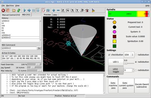

Run the sample GladeVCP panel integrated into AXIS like PyVCP as follows:
$ cd configs/sim/axis/gladevcp
$ linuxcnc gladevcp_panel.ini
images/example-panel-small.png

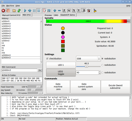

Run the same panel, but as a tab inside AXIS:
$ linuxcnc gladevcp_tab.ini
images/example-tabbed-small.png

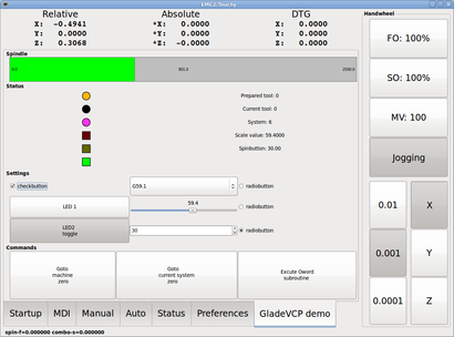

To run this panel inside Touchy:
$ cd configs/sim/touchy/gladevcp
$ linuxcnc gladevcp_touchy.ini
images/touchy-tab-33.png
Functionally these setups are identical - they only differ in screen real estate requirements and visibility. Since it is possible to run several GladeVCP components in parallel (with different HAL component names), mixed setups are possible as well - for instance a panel on the right hand side, and one or more tabs for less-frequently used parts of the interface.
2.1. Exploring the example panel
While running configs/sim/axis/gladevcp_panel.ini or configs/sim/axis/gladevcp_tab.ini, explore Show HAL Configuration - you will find the gladevcp HAL component and may observe their pin values while interacting with the widgets in the panel. The HAL setup can be found in configs/axis/gladevcp/manual-example.hal.
The example panel has two frames at the bottom. The panel is configured so that resetting ESTOP activates the Settings frame and turning the machine on enables the Commands frame at the bottom. The HAL widgets in the Settings frame are linked to LEDs and labels in the Status frame, and to the current and prepared tool number - play with them to see the effect. Executing the T<toolnumber> and M6 commands in the MDI window will change the current and prepared tool number fields.
The buttons in the Commands frame are MDI Action widgets - pressing them will execute an MDI command in the interpreter. The third button Execute Oword subroutine is an advanced example - it takes several HAL pin values from the Settings frame, and passes them as parameters to the Oword subroutine. The actual parameters received by the routine are displayed by (DEBUG, ) commands - see ../../nc_files/oword.ngc for the subroutine body.
To see how the panel is integrated into AXIS, see the [DISPLAY]GLADEVCP statement in configs/sim/axis/gladevcp/gladevcp_panel.ini, the [DISPLAY]EMBED* statement in configs/sim/axis/gladevcp/gladevcp_tab.ini and [HAL]POSTGUI_HALFILE statements in both configs/sim/axis/gladevcp/gladevcp_tab.ini and configs/sim/axis/gladevcp/gladevcp_panel.ini.

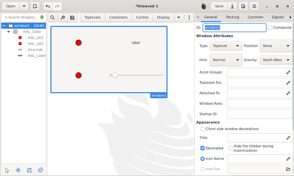

3.2. Running Glade to create a new user interface
This section just outlines the initial LinuxCNC-specific steps. For more information and a tutorial on Glade, see http://glade.gnome.org. Some Glade tips & tricks may also be found on youtube.
Either modify an existing UI component by running glade <file>.ui or start a new one by just running the glade command from the shell.
  • If LinuxCNC was not installed from a package, the LinuxCNC shell environment needs to be set up with source <linuxcncdir>/scripts/rip-environment, otherwise Glade won’t find the LinuxCNC-specific widgets.
  • When asked for unsaved preferences, just accept the defaults and hit Close.
  • From Toplevels (toolbar), pick GtkWindow (first entry) as top level window. Set window1 as ID in the right pane under the tab General. This naming is important because GladeVCP relies on it.
  • From the button with the three dots you can find the LinuxCNC specific widgets.
  • Add a container like a HAL_Box or a HAL_Table from HAL Python to the frame.
  • Pick and place some elements like LED, button, etc. within a container.
This will look like this:
images/glade-manual-small.png
Glade tends to write a lot of messages to the shell window, which mostly can be ignored. Select File'→'Save as, give it a name like myui.ui and make sure it is saved as GtkBuilder file (radio button left bottom corner in Save dialog). GladeVCP will also process the older libglade format correctly but there is no point in using it. The convention for GtkBuilder file extension is .ui.

3.6. Embedding as a Tab
To do so, edit your INI file and add to the DISPLAY and HAL sections of INI file as follows:
[DISPLAY]
# add GladeVCP panel as a tab next to Preview/DRO:
EMBED_TAB_NAME=GladeVCP demo
EMBED_TAB_COMMAND=halcmd loadusr -Wn gladevcp gladevcp -c gladevcp -x {XID} -u ./gladevcp/hitcounter.py ./gladevcp/manual-example.ui
[HAL]
# HAL commands for GladeVCP components in a tab must be executed via POSTGUI_HALFILE
POSTGUI_HALFILE =  ./gladevcp/manual-example.hal
[RS274NGC]
# gladevcp Demo specific Oword subs live here
SUBROUTINE_PATH = ../../nc_files/gladevcp_lib
Note the halcmd loadusr way of starting the tab command - this assures that POSTGUI_HALFILE will only be run after the HAL component is ready. In rare cases you might run a command here which uses a tab but does not have an associated HAL component. Such a command can be started without halcmd loadusr, and this signifies to AXIS that it does not have to wait for a HAL component since there is none.
When changing the component name in the above example, note that the names used in -Wn <component> and -c <component> must be identical.
Try it out by running AXIS - there should be a new tab called GladeVCP demo near the DRO tab. Select that tab, you should see the example panel nicely fit within AXIS.

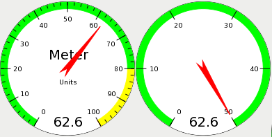

6.17. Meter
HAL_Meter is a widget similar to PyVCP meter - it represents a float value.
6.17.1. Pins
HAL_Meter has one input FLOAT HAL pin.
6.17.2. Properties
HAL Meter has the following properties:
min, max
Minimum and maximum value of desired range.
It is not an error condition if the current value is outside this range.
force_size
Forced diameter of widget.
If not set then size will be deduced from packing or from fixed widget size, and meter will fill all available space with respect to aspect ratio.
text_template
Like in Label, sets text format for current value.
Can be used to turn off value display.
label
Large label above center of meter.
sublabel
Small label below center of meter.
bg_color
Background color of meter.
z0_color, z1_color, z2_color
Colors of different value zones.
Defaults are green, yellow and red.
For description of zones see z*_border properties.
z0_border, z1_border
Define up bounds of color zones.
By default only one zone is enabled. If you want more then one zone set z0_border and z1_border to desired values so zone 0 will fill from min to first border, zone 1 will fill from first to second border and zone 2 from last border to max.
Borders are set as values in range min-max.
images/hal_meter.png

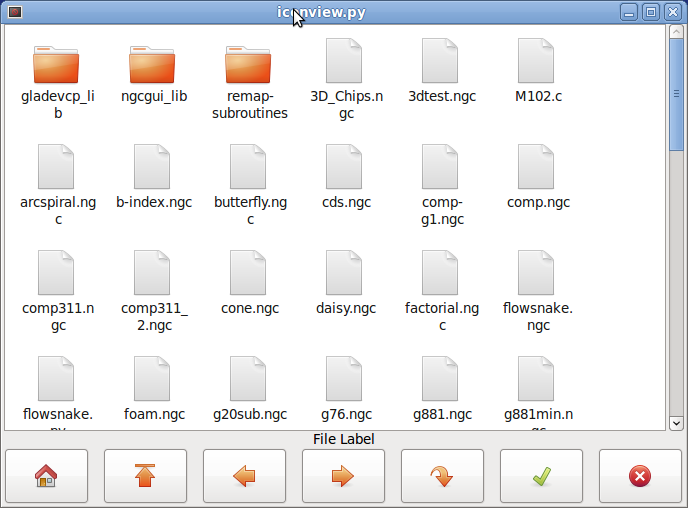

6.23. IconView (File Select)
This is a touch screen friendly widget to select a file and to change directories.
6.23.1. Properties
IconView widget has the following properties:
icon_size
Sets the size of the displayed icon.
Allowed values are integers in the range from 12 to 96.
Default is 48.
start_dir
Sets the directory to start in when the widget is shown first time.
Must be a string, containing a valid directory path.
Default is "/".
jump_to_dir
Sets the "jump to" directory, which is selected by the corresponding button in the bottom button list (the 5th button counting from the left).
Default is "\~".
filetypes
Sets the file filter for the objects to be shown.
Must be a string containing a comma separated list of extensions to be shown.
Default is "ngc,py".
sortorder
Sets the sorting order of the displayed icon.
Must be an integer value from 0 to 3, where:
  • 0 = ASCENDING (sorted according to file names)
  • 1 = DESCENDING (sorted according to file names)
  • 2 = FOLDERFIRST (show the folders first, then the files), default
  • 3 = FILEFIRST (show the files first, then the folders)
6.23.2. Direct program control
Using GObject to set the above listed properties:
[widget name].set_property(property,Value)
There are Python methods to control the widget:
  • [widget name].show_buttonbox(state)
    If False the bottom button box will be hidden.
    This is helpful in custom screens, with special buttons layouts to not alter the layout of the GUI. Good example for that is GMOCCAPY.
    state = boolean (True or False).
    Default is True.
  • [widget name].show_filelabel(state)
    If True the file label (between the IconView window and the bottom button box) will be shown.
    Hiding this label may save place, but showing it is very useful for debugging reasons.
    Default is True.
  • [widget name].set_icon_size(iconsize)
    Sets the icon size.
    Must be an integer in the range from 12 to 96.
    Default = 48.
  • [widget name].set_directory(directory)
    Allows to set an directory to be shown.
    directory = string (a valid file path).
  • [widget name].set_filetypes(filetypes)
    Sets the file filter to be used.
    Only files with the given extensions will be shown.
    filetypes = string containing a comma separated list of extensions.
    Default = "ngc,py".
  • [widget name].get_selected()
    Returns the path of the selected file, or None if a directory has been selected.
  • [widget name].refresh_filelist()
    Refreshes the filelist.
    Needed if you add a file without changing the directory.
If the button box has been hidden, you can reach the functions of this button through its clicked signals like so:
[widget name].btn_home.emit("clicked")
[widget name].btn_jump_to.emit("clicked")
[widget name].btn_sel_prev.emit("clicked")
[widget name].btn_sel_next.emit("clicked")
[widget name].btn_get_selected.emit("clicked")
[widget name].btn_dir_up.emit("clicked")
[widget name].btn_exit.emit("clicked")
6.23.3. Signals
The widget will emit the following signals:
  • selected
    This signal is emitted when the user selects an icon.
    It will return a string containing a file path if a file has been selected, or None if a directory has been selected.
  • sensitive
    This signal is emitted when the buttons change their state from sensitive to not sensitive or vice versa.
    This signal is useful to maintain surrounding GUI synchronized with the button of the widget. See GMOCCAPY as example.
    It will return the buttonname and the new state:
    • buttonname is one of btn_home, btn_dir_up, btn_sel_prev, btn_sel_next, btn_jump_to or btn_select.
    • state is a boolean and will be True or False.
  • exit
    This signal is emitted when the exit button has been pressed to close the IconView.
    Mostly needed if the application is started as stand alone.
images/iconview.png

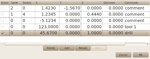

6.25. Tooleditor widget
This is a tooleditor widget for displaying and modifying a tool file.
If in lathe mode, it will display wear offsets and tool offsets separately.
Wear offsets are designated by tool number above 10000 (Fanuc style).
It checks the current file once a second to see if LinuxCNC updated it.
LinuxCNC requires remapping of tool calls to actually use wear offsets.
6.25.1. Properties
tooleditor has the following properties:
font
Display font to use
hide_columns
This will hide the given columns.
The columns are designated (in order) as such: s,t,p,x,y,z,a,b,c,u,v,w,d,i,j,q.
You can hide any number of columns including the select and comments.
lathe_display_type
Show lathe format
6.25.2. Direct program control
There a couple ways to directly control the widget using Python.
Using goobject to set the above listed properties:
[widget name].set_properties('hide_columns','uvwijq')
This would hide the uvwij and q columns and show all others.
There are Python methods:
  • [widget name].set_visible("ijq",False)
    Would hide ij and Q columns and leave the rest as they were.
  • [widget name].set_filename(path_to_file)
    Sets and loads the tool file.
  • [widget name].reload(None)
    Reloads the current toolfile.
  • [widget name].set_font('sans 16,tab='1')
    Sets the (Pango) font on the Tab, column title, and tool data.
    The all_offsets, wear_offsets, tool_offsets can be set at the same time by adding 1, 2 and/or 3 to the tab string.
    Default is all the tabs set.
  • [widget name].set_title_font('sans 16,tab='1')
    Sets the (Pango) font on the column titles only.

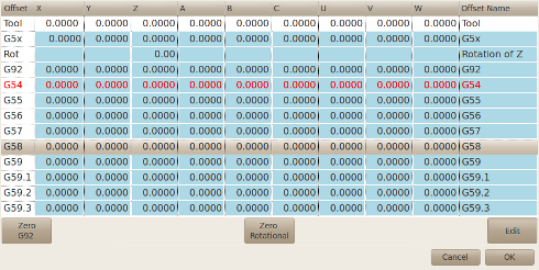

6.26. Offsetpage
The Offsetpage widget is used to display/edit the offsets of all the axes.
It has convenience buttons for zeroing G92 and Rotation-Around-Z offsets.
It will only allow you to select the edit mode when the machine is on and idle.
You can directly edit the offsets in the table at this time. Unselect the edit button to allow the OffsetPage to reflect changes.
6.26.1. Properties
It has the following properties:
display_units_mm
Display in metrice units
hide_columns
A no-space list of columns to hide. The columns are designated (in order) as such: xyzabcuvwt.
You can hide any of the columns.
hide_rows
A no-space list of rows to hide.
The rows are designated (in order) as such: 0123456789abc.
You can hide any of the rows.
font
Sets text font type and size.
highlight_color
When editing this is the highlight color.
foreground_color
When OffsetPage detects an active user coordinate system it will use this color for the text.
mm_text_template
You can use Python formatting to display the position with different precision.
imperial_text_template
6.26.2. Direct program control
[widget name].set_property("highlight_color",gdk.Color('blue'))
[widget name].set_property("foreground_color",gdk.Color('black'))
[widget name].set_property("hide_columns","xyzabcuvwt")
[widget name].set_property("hide_rows","123456789abc")
[widget name].set_property("font","sans 25")
  • [widget name].set_filename("../../../configs/sim/gscreen/gscreen_custom/sim.var")
  • [widget name].set_col_visible("Yabuvw",False)
  • [widget name].set_row_visible("456789abc",False)
  • [widget name].set_to_mm()
  • [widget name].set_to_inch()
  • [widget name].hide_button_box(True)
  • [widget name].set_font("sans 20")
  • [widget name].set_highlight_color("violet")
  • [widget name].set_foreground_color("yellow")
  • [widget name].mark_active("G55")
    Allows you to directly set a row to highlight, e.g., in case you wish to use your own navigation controls. See the chapter on GMOCCAPY.
  • [widget name].selection_mask = ("Tool","Rot","G5x")
    These rows are NOT selectable in edit mode.
  • [widget name].set_names([['G54','Default'],["G55","Vice1"],['Rot','Rotational']])
    This allows you to set the text of the T column of each/any row.
    This is a list of a list of offset-name/user-name pairs.
    The default text is the same as the offset name.
  • [widget name].get_names()
    This returns a list of a list of row-keyword/user-name pairs.
    The user name column is editable, so saving this list is user friendly.
    See set_names above.
images/offsetpage.png

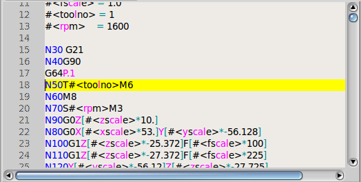

6.27. HAL_sourceview widget
This is for displaying and simple editing of G-code. It looks for .ngc highlighting specs in ~/share/gtksourceview-2.0/language-specs/. The current running line will be highlighted.
With external Python glue code it can:
  • Search for text, undo and redo changes.
  • Be used for program line selection.
6.27.1. Direct program control
  • [widget name].redo()
    Redo one level of changes.
  • [widget name].undo()
    Undo one level of changes
  • [widget name].text_search(direction=True,mixed_case=True,text='G92')
    Searches forward (direction = True) or backward,
    Searches with mixed case (mixed_case = True) or exact match
  • [widget name].set_line_number(linenumber)
    Sets the line to highlight.
    Uses the sourceview line numbers.
  • [widget name].get_line_number()
    Returns the currently highlighted line.
  • [widget name].line_up()
    Moves the highlighted line up one line.
  • [widget name].line_down()
    Moves the highlighted line down one line.
  • [widget name].load_file('filename')
    Loads a file.
    Using None (not a filename string) will reload the same program.
  • [widget name].get_filename()
    FIXME description
images/hal_sourceview.png

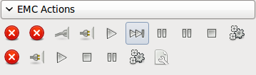

GladeVCP includes a collection of "canned actions" called VCP Action Widgets for the Glade user interface editor.
Other than HAL widgets, which interact with HAL pins, VCP Actions interact with LinuxCNC and the G-code interpreter.
VCP Action Widgets are derived from the Gtk.Action widget.
The Action widget in a nutshell:
  • It is an object available in Glade
  • It has no visual appearance by itself
  • Its purpose: Associate a visible, sensitive UI component like menu, toolbutton, button with a command. See these widget’s General→Related→Action property.
  • The "canned action" will be executed when the associated UI component is triggered (button press, menu click..).
  • It provides an easy way to execute commands without resorting to Python programming.
The appearance of VCP Actions in Glade is roughly as follows:
images/vcp-actions.png
Tooltip hovers provide a description.
7.1. VCP Action Widgets
VCP Action widgets are one-shot type widgets. They implement a single action and are for use in simple buttons, menu entries or radio/check groups.

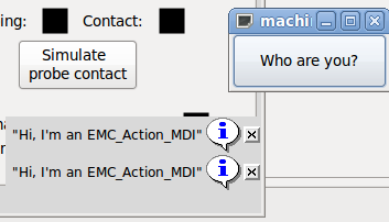

7.5. A simple example: Execute MDI command on button press
configs/apps/gladevcp/mdi-command-example/whoareyou.ui is a Glade UI file which conveys the basics:
  1. Open it in Glade and study how it is done.
  2. Start AXIS, and then start this from a terminal window with gladevcp whoareyou.ui.
  3. See the hal_action_mdi1 action and its MDI command property - this just executes (MSG, "Hi, I'm an VCP_Action_MDI") so there should be a message popup in AXIS like so:
images/whoareyou.png
You’ll notice that the button associated with the Action_MDI action is grayed out if the machine is off, in E-Stop or if the interpreter is running. It will automatically become active when the machine is turned on and out of E-Stop, and the program is idle.

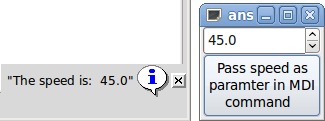

7.6. Parameter passing with Action_MDI and ToggleAction_MDI widgets
Optionally, MDI command strings may have parameters substituted before they are passed to the interpreter. Parameters currently may be names of HAL pins in the GladeVCP component. This is how it works:
  • assume you have a HAL SpinBox named speed, and you want to pass its current value as a parameter in an MDI command.
  • The HAL SpinBox will have a float-type HAL pin named speed-f (see HalWidgets description).
  • To substitute this value in the MDI command, insert the HAL pin name enclosed like so: ${pin-name}
  • for the above HAL SpinBox, we could use (MSG, "The speed is: ${speed-f}") just to show what’s happening.
The example UI file is configs/apps/gladevcp/mdi-command-example/speed.ui. Here’s what you get when running it:
images/speed.png

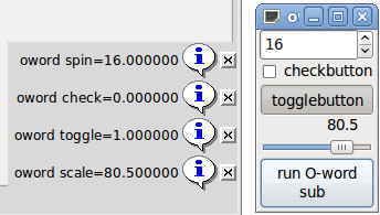

7.7. An advanced example: Feeding parameters to an O-word subroutine
It’s perfectly OK to call an O-word subroutine in an MDI command, and pass HAL pin values as actual parameters. An example UI file is in configs/apps/gladevcp/mdi-command-example/owordsub.ui.
Place nc_files/gladevcp_lib/oword.ngc so AXIS can find it, and run gladevcp owordsub.ui from a terminal window. This looks like so:
images/oword.png

8.16. Setting HAL widget properties programmatically
With Glade, widget properties are typically set fixed while editing. You can, however, set widget properties at runtime, for instance from INI file values, which would typically be done in the handler initialization code. Setting properties from HAL pin values is possible, too.
In the following example (assuming a HAL Meter widget called meter), the meter’s min value is set from an INI file parameter at startup, and the max value is set via a HAL pin, which causes the widget’s scale to readjust dynamically:
import linuxcnc
import os
import hal
import hal_glib
class HandlerClass:
    def _on_max_value_change(self,hal_pin,data=None):
        self.meter.max = float(hal_pin.get())
        self.meter.queue_draw() # force a widget redraw
    def __init__(self, halcomp,builder,useropts):
        self.builder = builder
        # HAL pin with change callback.
        # When the pin's value changes the callback is executed.
        self.max_value = hal_glib.GPin(halcomp.newpin('max-value',  hal.HAL_FLOAT, hal.HAL_IN))
        self.max_value.connect('value-changed', self._on_max_value_change)
        inifile = linuxcnc.ini(os.getenv("INI_FILE_NAME"))
        mmin = float(inifile.find("METER", "MIN") or 0.0)
        self.meter = self.builder.get_object('meter')
        self.meter.min = mmin
def get_handlers(halcomp,builder,useropts):
    return [HandlerClass(halcomp,builder,useropts)]
