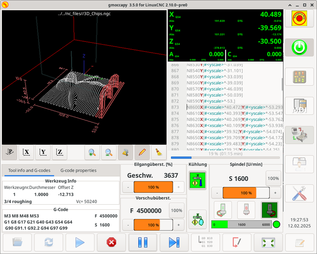

1. Giriş
GMOCCAPY is a GUI for LinuxCNC, designed to be used with a touch screen, but can also be used on normal screens with a mouse or hardware buttons and MPG wheels, as it presents HAL Pins for the most common needs. Please find more information in the following.
It offers the possibility to display up to 9 axes, support a lathe mode for normal and back tool lathe and can be adapted to nearly every need, because GMOCCAPY supports embedded tabs and side panels. As a good example for that see gmoccapy_plasma.
GMOCCAPY 3 does support up to 9 axes and 9 joints. As GMOCCAPY 3 has been changed in code to support the joint / axis changes in LinuxCNC it does not work on 2.7 or 2.6 branch!
It has support for integrated virtual keyboard (onboard or matchbox-keyboard), so there is no need for a hardware keyboard or mouse, but it can also be used with that hardware. GMOCCAPY offers a separate settings page to configure most settings of the GUI without editing files.
GMOCCAPY can be localized very easy, because the corresponding files are separated from the linuxcnc.po files, so there is no need to translate unneeded stuff. If you want to contribute a translation, please use the web based translation editor Weblate. For more information see the section Translations

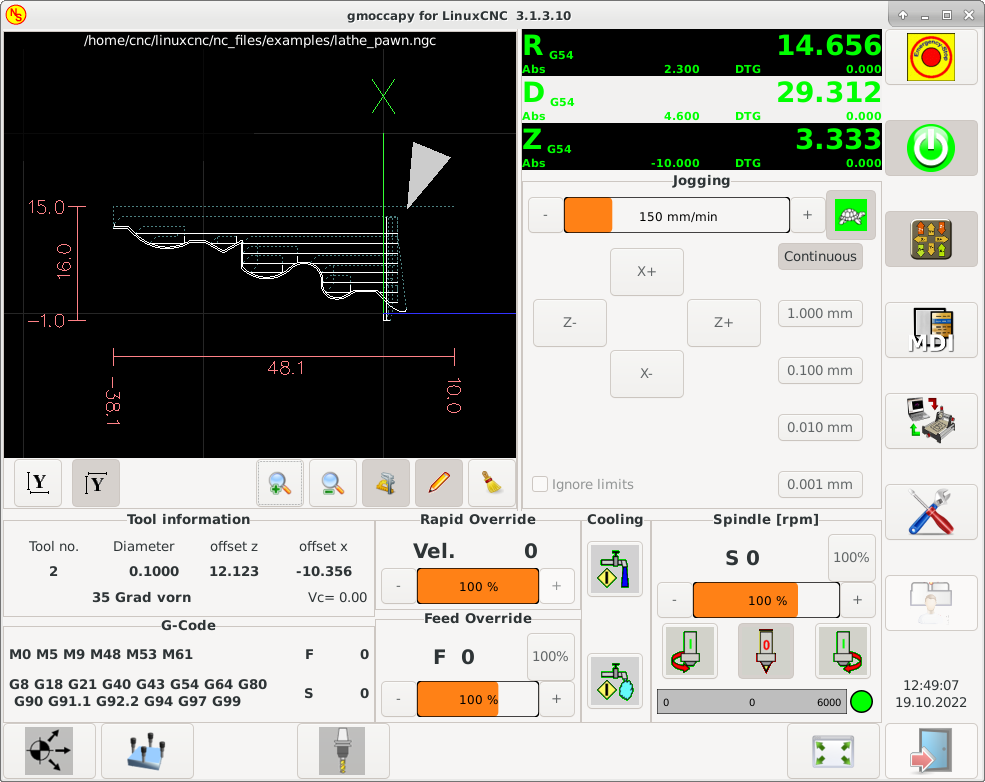

You will get a similar screen to the following (the design may vary depending on your config):

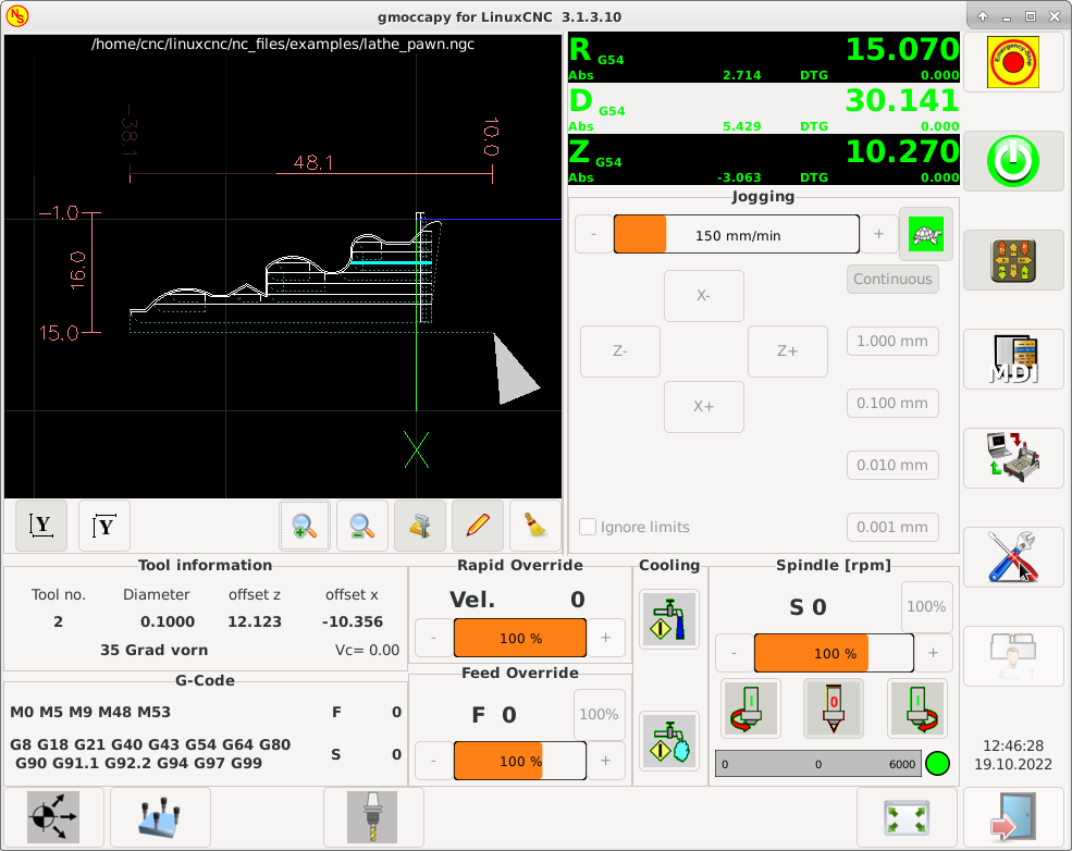

  • LATHE = 1 - Set the screen layout to control a lathe.
  • BACK_TOOL_LATHE = 1 - Is optional and will switch the X axis in a way you need for a back tool lathe. Also the keyboard shortcuts will react in a different way. It is allowed with GMOCCAPY to configure a lathe also with additional axes, so you may use also a XZCW config for a lathe.
    See also the Lathe Specific Section.

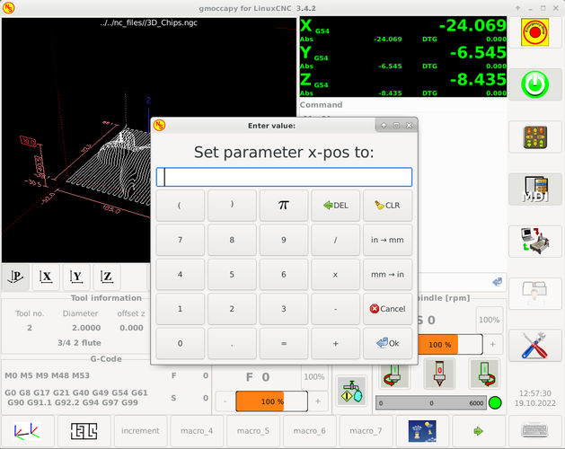

GMOCCAPY will also accept macros asking for parameters like:
[MACROS]
MACRO = go_to_position X-pos Y-pos Z-pos
The parameters must be separated by spaces. This example calls a file go_to_position.ngc with the following content:
; Test file "go to position"
; will jog the machine to a given position
O<go_to_position> sub
G17
G21
G54
G61
G40
G49
G80
G90
;#1 = <X-Pos>
;#2 = <Y-Pos>
;#3 = <Z-Pos>
(DBG, Will now move machine to X = #1 , Y = #2 , Z = #3)
G0 X #1 Y #2 Z #3
O<go_to_position> endsub
M2
After pushing the execute macro button, you will be asked to enter the values for X-pos Y-pos Z-pos and the macro will only run if all values have been given.
If you would like to use a macro without any movement, see also the notes in known problems.

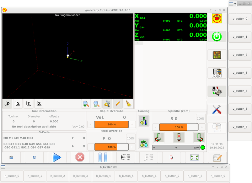

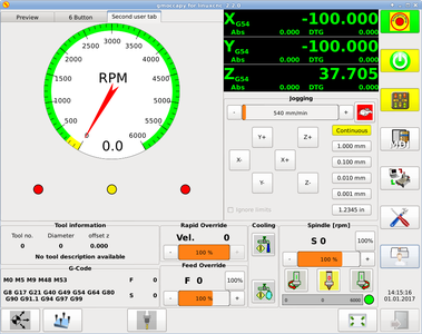

4.4. Embedded Tabs and Panels
You can add embedded programs to GMOCCAPY like you can do in AXIS, Touchy and Gscreen. All is done by GMOCCAPY automatically if you include a few lines in your INI file in the DISPLAY section.
If you have never used a Glade panel, I recommend to read the excellent documentation on Glade VCP.
Embedded Tab Example
EMBED_TAB_NAME = DRO
EMBED_TAB_LOCATION = ntb_user_tabs
EMBED_TAB_COMMAND = gladevcp -x {XID} dro.glade
EMBED_TAB_NAME = Second user tab
EMBED_TAB_COMMAND = gladevcp -x {XID} vcp_box.glade
All you have to take care of, is that you include for every tab or side panel the mentioned three lines:
  • EMBED_TAB_NAME = Represents the name of the tab or side panel, it is up to you what name you use, but it must be present!

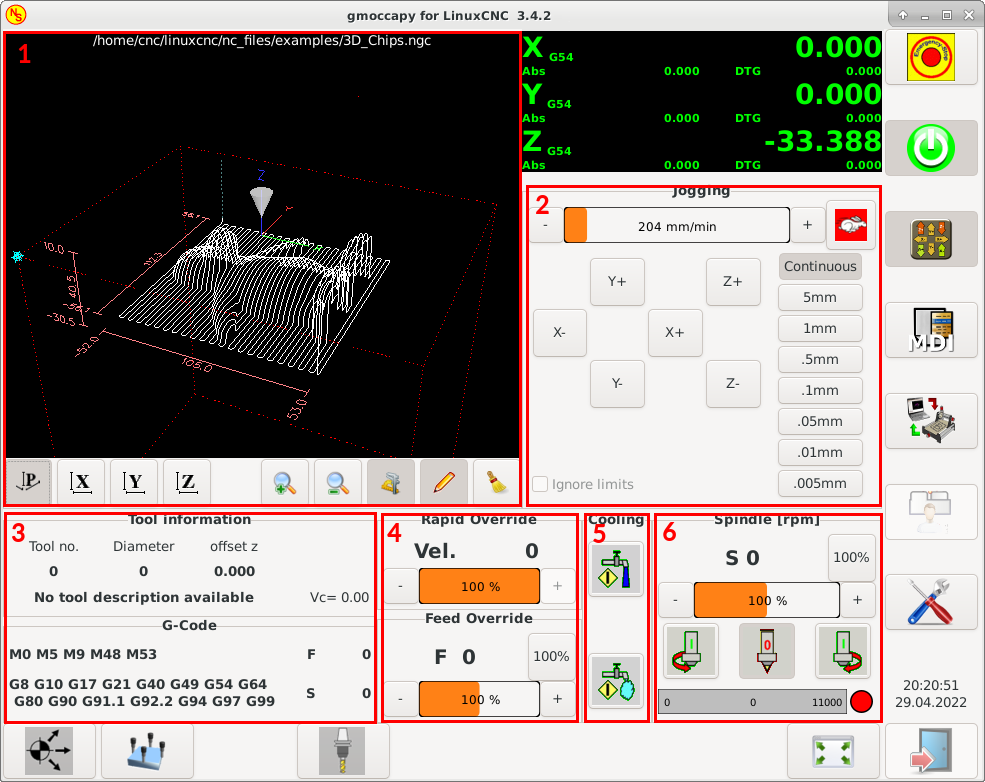

  • EMBED_TAB_LOCATION = The place where your program will be placed in the GUI, see figure Embedded tab locations. Valid values are:
    • ntb_user_tabs (as main tab, covering the complete screen)
    • ntb_preview (as tab on the preview side (1))
    • hbox_jog (will hide the jog buttons and introduce your glade file here (2))
    • box_left (on the left, complete high of the screen)
    • box_right (on the right, in between the normal screen and the button list)
    • box_tool_and_code_info (will hide the Tool information and G-code frames and introduce your glade file here (3))
    • box_tool_info (will hide the Tool information frame and introduce your glade file here)
    • box_code_info (will hide the G-code information frame and introduce your glade file here)
    • box_vel_info (will hide the velocity frames and introduce your glade file (4))
    • box_coolant_and_spindle (will hide the coolant and spindle frames and introduce your glade file here (5)+(6))
    • box_cooling (will hide the cooling frame and introduce your glade file (5))
    • box_spindle (will hide the spindle frame and introduce your glade file (6))
    • box_custom_1 (will introduce your glade file left of vel_frame)
    • box_custom_2 (will introduce your glade file left of cooling_frame)
    • box_custom_3 (will introduce your glade file left of spindle_frame)
    • box_custom_4 (will introduce your glade file right of spindle_frame)
    • box_dro_side (will introduce your glade file right of the DRO)
See also the included sample INI files to see the differences.
  • EMBED_TAB_COMMAND = The command to execute, i.e.
    includes a custom glade file called dro.glade in the mentioned location. The file must be placed in the config folder of your machine.
    gladevcp h_buttonlist.glade
    will just open a new user window called h_buttonlist.glade note the difference. This one is stand alone, and can be moved around independent from GMOCCAPY window.
    gladevcp -c gladevcp -u hitcounter.py -H manual-example.hal manual-example.ui
    will add a the panel manual-example.ui, include a custom Python handler, hitcounter.py and make all connections after realizing the panel according to manual-example.hal.
    hide
    will hide the chosen box.
images/gmoccapy_embedded_tabs.png
If you make any HAL connections to your custom glade panel, you need to do that in the HAL file specified in the EMBED_TAB_COMMAND line, otherwise you may get an error that the HAL pin does not exist — this is because of race conditions loading the HAL files. Connections to GMOCCAPY HAL pins need to be made in the postgui HAL file specified in your INI file, because these pins do not exist prior of realizing the GUI.
Here are some examples:

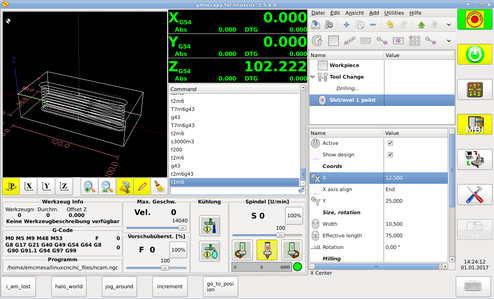

box_right - and GMOCCAPY in MDI mode
images/gmoccapy_with_right_panel_in_MDI_mode_small.png

5.1. Right and Bottom Button Lists
The screen has two main button lists, one on the right side an one on the bottom. The right handed buttons will not change during operation, but the bottom button list will change very often. The buttons are count from up to down and from left to right beginning with 0.
The pin names have changed in GMOCCAPY 2 to order them in a better way.
The pins for the right (vertical) buttons are:
  • gmoccapy.v-button.button-0 (bit IN)
  • gmoccapy.v-button.button-1 (bit IN)
  • gmoccapy.v-button.button-2 (bit IN)
  • gmoccapy.v-button.button-3 (bit IN)
  • gmoccapy.v-button.button-4 (bit IN)
  • gmoccapy.v-button.button-5 (bit IN)
  • gmoccapy.v-button.button-6 (bit IN)
For the bottom (horizontal) buttons they are:
  • gmoccapy.h-button.button-0 (bit IN)
  • gmoccapy.h-button.button-1 (bit IN)
  • gmoccapy.h-button.button-2 (bit IN)
  • gmoccapy.h-button.button-3 (bit IN)
  • gmoccapy.h-button.button-4 (bit IN)
  • gmoccapy.h-button.button-5 (bit IN)
  • gmoccapy.h-button.button-6 (bit IN)
  • gmoccapy.h-button.button-7 (bit IN)
  • gmoccapy.h-button.button-8 (bit IN)
  • gmoccapy.h-button.button-9 (bit IN)
As the buttons in the bottom list will change according to the mode and other influences, the hardware buttons will activate the displayed functions. So you don’t have to take care about switching functions around in HAL, because that is done completely by GMOCCAPY!
For a three axes XYZ machine the HAL pins will react as shown in the following three tables:

So we have 67 reactions with only 10 HAL pins!
These pins are made available to be able to use the screen without a touch panel, or protect it from excessive use by placing hardware buttons around the panel. They are available in a sample configuration like shown in the image below.
Sample configuration "gmoccapy_sim_hardware_button" showing the side buttons
images/gmoccapy_sim_hardware_button_mid.png

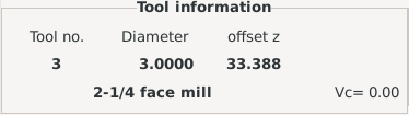

Tool Offset Pins
These pins allow you to show the active tool offset values for X and Z in the tool information frame. You should know that they are only active after G43 has been sent.
Tool information
  • gmoccapy.tooloffset-x (float IN)
  • gmoccapy.tooloffset-z (float IN)
The tooloffset-x line is not needed on a mill, and will not be displayed on a mill with trivial kinematics.
To display the current offsets, the pins have to be connected like this in the postgui HAL file:
net tooloffset-x gmoccapy.tooloffset-x <= motion.tooloffset.x
net tooloffset-z gmoccapy.tooloffset-z <= motion.tooloffset.z
Please note, that GMOCCAPY takes care of its own to update the offsets, sending an G43 after any tool change, but not in auto mode!
So writing a program makes you responsible to include an G43 after each tool change!

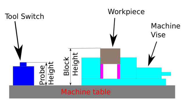

Tool Measurement in GMOCCAPY is done a little bit different to many other GUIs. You should follow these steps:
  1. Touch off your workpiece in X and Y.
  2. Measure the height of your block from the base where your tool switch is located, to the upper face of the block (including chuck etc.).
  3. Push the button block height and enter the measured value.
  4. Go to auto mode and start your program.
Here is a small sketch:
images/sketch_auto_tool_measurement.png
With the first given tool change the tool will be measured and the offset will be set automatically to fit the block height. The advantage of the GMOCCAPY way is, that you do not need a reference tool.
Your program must contain a tool change at the beginning! The tool will be measured, even it has been used before, so there is no danger, if the block height has changed. There are several videos showing the way to do that on YouTube.

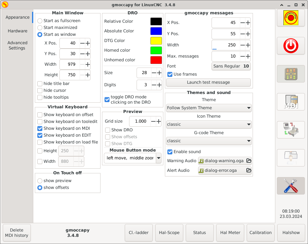

7. The Settings Page
To enter the page you will have to click on images/gmoccapy_settings_button.png and give an unlock code, which is 123 by default. If you want to change it at this time you will have to edit the hidden preference file, see the display section for details.
The page is separated in three main tabs:
7.1. Appearance
Configuration page
On this tab you will find the following options:
Main Window
Here you can select how you wish the GUI to start. The main reason for this was the wish to get an easy way for the user to set the starting options without the need to touch code. You have three options:
  • Start as full screen
  • Start maximized
  • Start as window - If you select start as window the spinboxes to set the position and size will get active. One time set, the GUI will start every time on the place and with the size selected. Nevertheless the user can change the size and position using the mouse, but that will not have any influence on the settings.
  • hide title bar - Allows the title bar to be hidden. (default: title bar visible).
  • hide cursor - Does allow to hide the cursor, what is very useful if you use a touch screen.
  • hide tooltips - Hides the tool tips.

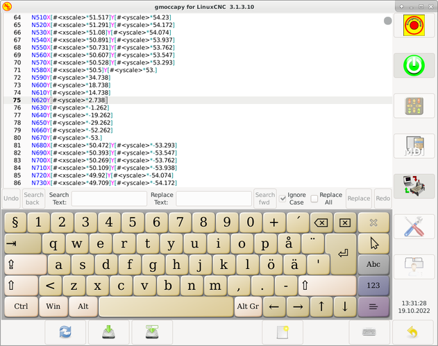

Virtual Keyboard
The checkboxes allow the user to select if he wants the on board keyboard to be shown immediately when entering the MDI Mode, the offset page, the tooledit widget or when open a program in the EDIT mode. The keyboard button on the bottom button list will not be affected by these settings, so you are able to show or hide the keyboard by pressing the button.
The default setting is:
  • Show keyboard on offset = False
  • Show keyboard on tooledit = False
  • Show keyboard on MDI = True
  • Show keyboard on EDIT = True
  • Show keyboard on load file = False
If this section is not sensitive, you have not installed a virtual keyboard, supported ones are onboard and matchbox-keyboard.
If the keyboard layout is not correct, i.e. clicking Y gives Z, than the layout has not been set properly, related to your locale settings. For onboard it can be solved with a small batch file with the following content:
#!/bin/bash
setxkbmap -model pc105 -layout de -variant basic
The letters "de" are for German, you will have to set them according to your locale settings. Just execute this file before starting LinuxCNC, it can be done also adding a starter to your local folder.
./config/autostart
So that the layout is set automatically on starting.
For matchbox-keyboard you will have to make your own layout, for a German layout ask in the forum.
GMOCCAPY with Onboard keyboard in edit mode
Onboard keyboard
On Touch Off
This gives the option whether to show the preview tab or the offset page tab when you enter the touch off mode by clicking the corresponding bottom button.
  • show preview
  • show offsets
DRO Options
You have the option to select the background colors of the different DRO states. So users suffering from protanopia (red/green weakness) are able to select proper colors.
By default, the background colors are:
  • Relative Color = black
  • Absolute Color = blue
  • DTG Color = yellow
The foreground color of the DRO can be selected with:
  • Homed Color = green
  • Unhomed Color = red
You can change through the DRO modes (absolute, relative, distance to go) by clicking the number on the DRO! If you click on the left side letter of the DRO a popup window will allow you to set the value of the axes, making it easier to set the value, as you will not need to go over the touch off bottom button.
  • size - Allows to set the size of the DRO font, default is 28, if you use a bigger screen you may want to increase the size up to 56. If you do use 4 axes, the DRO font size will be 3/4 of the value, because of space reason.
  • digits - Sets the number of digits of the DRO from 1 to 5.
    Imperial will show one digit more that metric. So if you are in imperial machine units and set the digit value to 1, you will get no digit at all in metric.
  • toggle DRO mode - If not active, a mouse click on the DRO will not take any action.
    By default this checkbox is active, so every click on any DRO will toggle the DRO readout from actual to relative to DTG (distance to go).
    Neverthereless a click on the axis letter will open the popup dialog to set the axis value.
Preview
  • Grid Size - Sets the grid size of the preview window. Unfortunately the size has to be set in inches, even if your machine units are metric. We do hope to fix that in a future release.
    The grid will not be shown in perspective view.
  • Show DRO - Will show the a DRO also in the preview pane, it will be always shown in fullsize preview.
  • Show DTG - Will show the DTG (direct distance to end point) in the preview pane if Show DRO is active. Otherwise only in full size preview.
  • Show Offsets - Will show the offsets in the preview pane when Show DRO is active. Otherwise only in full size preview.
  • Mouse Button Mode - This combobox allows you to select the button behavior of the mouse to rotate, move or zoom within the preview:
    • left rotate, middle move, right zoom
    • left zoom, middle move, right rotate
    • left move, middle rotate, right zoom
    • left zoom, middle rotate, right move
    • left move, middle zoom, right rotate
    • left rotate, middle zoom, right move
Default is left move, middle zoom, right rotate.
The mouse wheel will still zoom the preview in every mode.
If you select an element in the preview, the selected element will be taken as rotation center point and in auto mode the corresponding code line will be highlighted.
Gmoccapy Messages
This will display small pop up windows displaying a message or error text, similar to the ones known from AXIS. You can delete a specific message by clicking on its close button. If you want to delete the last one, just hit the WINDOWS key on your keyboard, or delete all messages at once with Control + Space.
You are able to set some options:
  • X Pos - The position of the top left corner of the message in X counted in pixel from the top left corner of the screen.
  • Y Pos - The position of the top left corner of the message in Y counted in pixel from the top left corner of the screen.
  • Width - The width of the message box.
  • Max. messages - The maximum number of messages you want to see at once. If you set this to 10, the 11th message will delete the first one, so you will only see the last 10.
  • Font - The font and size you want to use to display the messages.
  • Use frames - If you activate the checkbox, each message will be displayed in a frame, so it is much easier to distinguish the messages. But you will need a little bit more space.
  • Launch test message-button - It will show a message, so you can see the changes of your settings without the need to generate an error.
Themes and Sounds
This lets the user select what desktop theme to apply and what error and messages sounds should be played.
By default "Follow System Theme" is set.
It further allows to change the icon theme. Currently there are three themes available:
  • classic
  • material
  • material light
To create custom icon themes, see section Icon Theme for details.

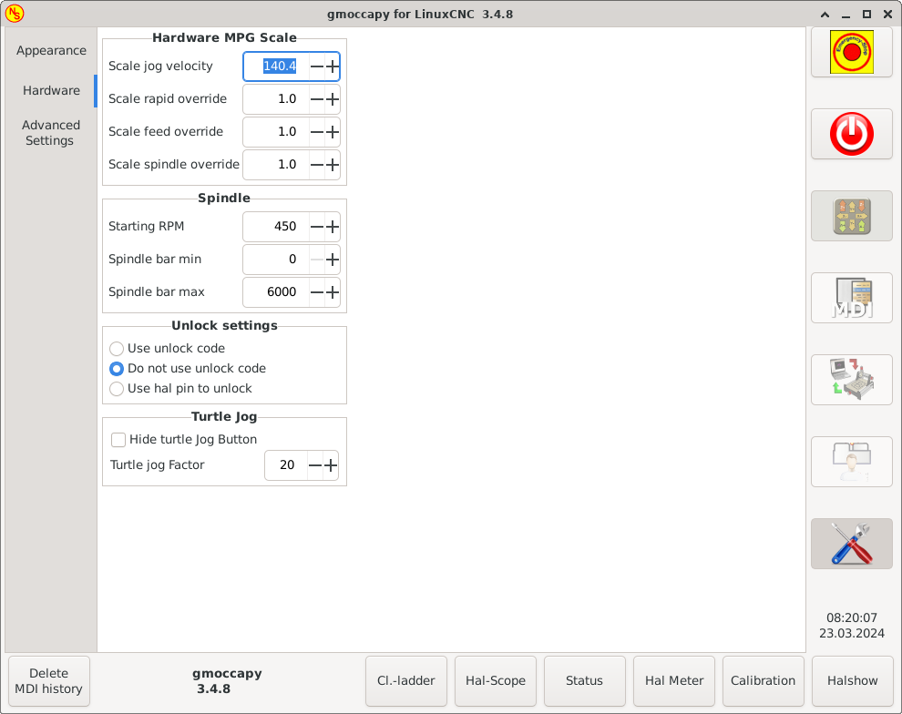

7.2. Hardware
Hardware settings
Hardware MPG Scale
For the different HAL pins to connect MPG wheels to, you may select individual scales to be applied. The main reason for this was my own test to solve this through HAL connections, resulting in a very complex HAL file. Imagine a user having an MPG Wheel with 100 ppr and he wants to slow down the max. vel. from 14000 to 2000 mm/min, that needs 12000 pulses, resulting in 120 turns of the wheel! Or an other user having a MPG Wheel with 500 ipr and he wants to set the spindle override which has limits from 50 to 120 % so he goes from min to max within 70 pulses, meaning not even 1/4 turn.
By default all scales are set using the calculation:
(MAX - MIN)/100
Spindle
  • Starting RPM - Sets the rpm to be used if the spindle is started and no S value has been set.
    This value will be presetted according to your settings in [DISPLAY] DEFAULT_SPINDLE_SPEED of your INI file. If you change the settings on the settings page, that value will be default from that moment, your INI file will not be modified.
  • Spindle bar min and Spindle bar max - Sets the limits of the spindle bar shown in the INFO frame on the main screen.
    Default values are:
    MIN = 0
    MAX = 6000
    It is no error giving wrong values. If you give a maximum of 2000 and your spindle makes 4000 RPM, only the bar level will be wrong on higher speeds than 2000 RPM.
Unlock options
There are three options to unlock the settings page:
  • Use unlock code - The user must give a code to get in.
  • Do not use unlock code - There will be no security check.
  • Use HAL pin to unlock - Hardware pin must be high to unlock the settings, see hardware unlock pin.
Default is use unlock code (default code is 123).
Turtle Jog
This settings will have influence on the jog velocities.
  • Hide turtle jog button - Will hide the button right of the jog velocity slider. If you hide this button, please take care that the "rabbit mode" is activated, otherwise you will not be able to jog faster than the turtle jog velocity, which is calculated using the turtle jog factor.
  • Turtle jog factor - Sets the scale to apply for turtle jog mode (button pressed, showing the turtle). If you set a factor of 20, the turtle max. jog velocity will be 1/20 of the max. velocity of the machine.
This button can be controlled using the Turtle-Jog HAL Pin.

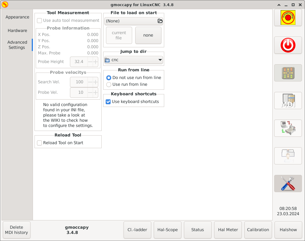

7.3. Advanced Settings
Advanced settings
Tool Measurement
Please check Auto Tool Measurement
If this part is not sensitive, you do not have a valid INI file configuration to use tool measurement.
  • Use auto tool measurement - If checked, after each tool change, a tool measurement will be done, the result will be stored in the tool table and a G43 will be executed after the change.
    Probe Information
    The following information are taken from your INI file and must be given in absolute coordinates:
    • X Pos. - The X position of the tool switch.
    • Y Pos. - The Y position of the tool switch.
    • Z Pos. - The Z position of the tool switch, we will go as rapid move to this coordinate.
    • Max. Probe - The distance to search for contact, an error will be launched, if no contact is given in this range. The distance has to be given in relative coordinates, beginning the move from Z Pos., so you have to give a negative value to go down!
    • Probe Height - The height of your probe switch, you can measure it. Just touch off the base where the probe switch is located and set that to zero. Then make a tool change and watch the tool_offset_z value, that is the height you must enter here.
    Probe velocities
    • Search Vel. - The velocity to search for the tool switch. After contact the tool will go up again and then goes towards the probe again with probe vel, so you will get better results.
    • Probe Vel. - The velocity for the second movement to the switch. It should be slower to get better touch results. In simulation mode, this is commented out in macros/change.ngc, otherwise the user would have to click twice on the probe button.
Reload Tool::
  • Reload Tool on Start - Loads the last tool on start after homing.
If checked, the tool in spindle will be saved on each change in the preference file, making it possible to reload the last mounted tool on start up. The tool will be loaded after all axes are homed, because before it is not allowed to execute MDI commands. If you use NO_FORCE_HOMING you can not use this feature, because the needed all_homed_signal will never be emitted.
File to load on start up
Select the file you want to be loaded on start up. If a file is loaded, it can be set by pressing the current button. To avoid that any program is loaded at start up, just press the None button.
The file selection screen will use the filters you have set in the INI file, if there aren’t any filters given, you will only see NGC files. The path will be set according to the INI settings in [DISPLAY] PROGRAM_PREFIX.
Jump to dir
You can set here the directory to jump to if you press the corresponding button in the file selection dialog.
Run from Line
You can allow or disallow the run from line. This will set the corresponding button insensitive (grayed out), so the user will not be able to use this option. The default is disable run from line.
It is not recommend to use run from line, as LinuxCNC will not take care of any previous lines in the code before the starting line. So errors or crashes are fairly likely.
Keyboard shortcuts
Some users want to jog their machine using the keyboard buttons and there are others that will never allow this. So everybody can select whether to use them or not.
Keyboard shortcuts are disabled by default. They can be activated by the checkbox
  • Use keyboard shortcuts
It is not recommended to use keyboard jogging, as it represents a serious risk for operator and machine.
Please take care if you use a lathe, then the shortcuts will be different, see the Lathe Specific Section.

9. Lathe Specific Section
If in the INI file LATHE = 1 is given, the GUI will change its appearance to the special needs for a lathe. Mainly the Y axis will be hidden and the jog buttons will be arranged in a different order.
images/gmoccapy_lathe.png
images/gmoccapy_back_tool_lathe.png
As you see the R DRO has a black background and the D DRO is gray. This will change according to the active G-code G7 or G8. The active mode is visible by the black background, meaning in the shown images G8 is active.
The next difference to the standard screen is the location of the jog buttons. X and Z have changed places and Y is gone. You will note that the X+ and X- buttons changes there places according to normal or back tool lathe.
Also the keyboard behavior will change:
Normal Lathe:
  • Arrow_Left or NumPad_Left - Jog Z minus
  • Arrow_Right or NumPad_Right - Jog Z plus
  • Arrow_up or NumPad_Up - Jog X minus
  • Arrow_Down or NumPad_Down - Jog X plus
Back Tool Lathe:
  • Arrow_up or NumPad_Up - Jog X plus
  • Arrow_Down or NumPad_Down - Jog X minus
The tool information frame will show not only the Z offset, but also the X offset and the tool table is showing all lathe relevant information.

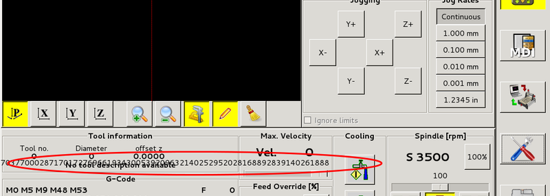

12. Known Problems
12.1. Strange numbers in the info area
If you get strange numbers in the info area of GMOCCAPY like:
Strange numbers
You have made your config file using an older version of StepConfWizard. It has made a wrong entry in the INI file under the [TRAJ] named MAX_LINEAR_VELOCITY = xxx. Change that entry to MAX_VELOCITY = xxx.
