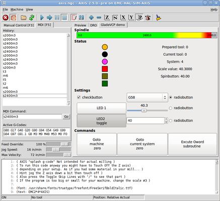

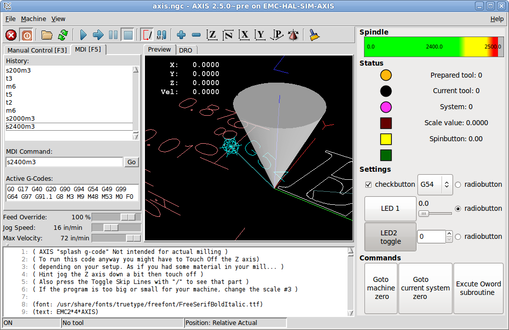

Run the sample GladeVCP panel integrated into AXIS like PyVCP as follows:
$ cd configs/sim/axis/gladevcp
$ linuxcnc gladevcp_panel.ini

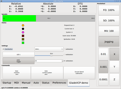

To run this panel inside Touchy:
$ cd configs/sim/touchy/gladevcp
$ linuxcnc gladevcp_touchy.ini

2.1. Exploring the example panel
While running configs/sim/axis/gladevcp_panel.ini or configs/sim/axis/gladevcp_tab.ini,
explore Show HAL Configuration - you will find the gladevcp HAL component and may observe their pin values while interacting with the widgets in the panel.
The HAL setup can be found in configs/axis/gladevcp/manual-example.hal.

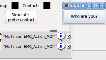

The example panel has two frames at the bottom. The panel is configured so that resetting ESTOP activates the Settings frame and turning the machine on enables the Commands frame at the bottom. The HAL widgets in the Settings frame are linked to LEDs and labels in the Status frame, and to the current and prepared tool number - play with them to see the effect. Executing the T<toolnumber> and M6 commands in the MDI window will change the current and prepared tool number fields.
The buttons in the Commands frame are MDI Action widgets - pressing them will execute an MDI command in the interpreter. The third button Execute Oword subroutine is an advanced example - it takes several HAL pin values from the Settings frame, and passes them as parameters to the Oword subroutine. The actual parameters received by the routine are displayed by (DEBUG, ) commands - see ../../nc_files/oword.ngc for the subroutine body.
To see how the panel is integrated into AXIS, see the [DISPLAY]GLADEVCP statement in configs/sim/axis/gladevcp/gladevcp_panel.ini, the [DISPLAY]EMBED* statement in configs/sim/axis/gladevcp/gladevcp_tab.ini and [HAL]POSTGUI_HALFILE statements in both configs/sim/axis/gladevcp/gladevcp_tab.ini and configs/sim/axis/gladevcp/gladevcp_panel.ini.

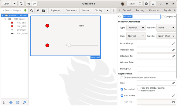

3.2. Running Glade to create a new user interface
This section just outlines the initial LinuxCNC-specific steps. For more information and a tutorial on Glade, see http://glade.gnome.org. Some Glade tips & tricks may also be found on youtube.
Either modify an existing UI component by running glade <file>.ui or start a new one by just running the glade command from the shell.
If LinuxCNC was not installed from a package, the LinuxCNC shell environment needs to be set up with
source <linuxcncdir>/scripts/rip-environment, otherwise Glade won’t find the LinuxCNC-specific widgets. -
When asked for unsaved preferences, just accept the defaults and hit Close.
From Toplevels (toolbar), pick GtkWindow (first entry) as top level window. Set window1 as ID in the right pane under the tab General. This naming is important because GladeVCP relies on it.
From the button with the three dots you can find the LinuxCNC specific widgets.
Add a container like a HAL_Box or a HAL_Table from HAL Python to the frame.
Pick and place some elements like LED, button, etc. within a container.
This will look like this:
Glade tends to write a lot of messages to the shell window, which mostly can be ignored. Select File→Save as, give it a name like myui.ui and make sure it is saved as GtkBuilder file (radio button left bottom corner in Save dialog). GladeVCP will also process the older libglade format correctly but there is no point in using it. The convention for GtkBuilder file extension is .ui.

3.7. Integrating into Touchy
To do add a GladeVCP tab to Touchy, edit your INI file as follows:
[DISPLAY] # add GladeVCP panel as a tab EMBED_TAB_NAME=GladeVCP demo EMBED_TAB_COMMAND=gladevcp -c gladevcp -x {XID} -u ./hitcounter.py -H ./gladevcp-touchy.hal ./manual-example.ui [RS274NGC] # gladevcp Demo specific Oword subs live here SUBROUTINE_PATH = ../../nc_files/gladevcp_lib
Note
The file specifiers like ./hitcounter.py, ./manual-example.ui, etc. indicate that the files are located in the same directory as the INI file. You might have to copy them to you directory (alternatively, specify a correct absolute or relative path to the file(s)). |
Note the following differences to the AXIS tab setup:
The HAL command file is slightly modified since Touchy does not use the halui components so its signals are not available and some shortcuts have been taken.
There is no POSTGUI_HALFILE= INI option, but passing the HAL command file on the EMBED_TAB_COMMAND= line is ok.
The halcmd loaduser -Wn … incantation is not needed.

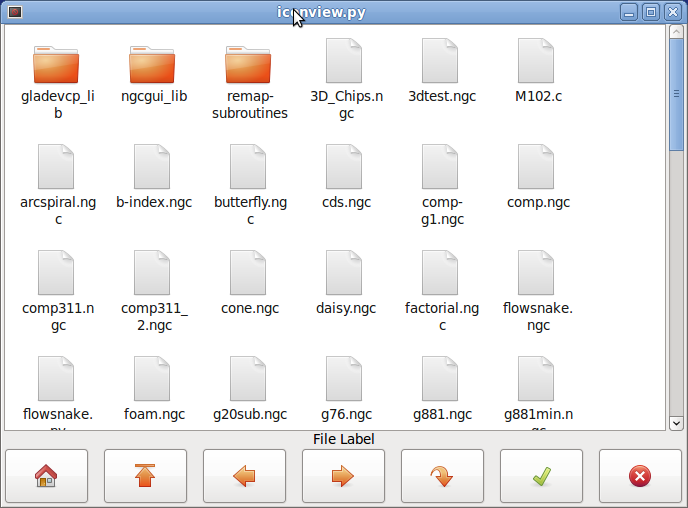

Widgets for file handling: IconView File Selection

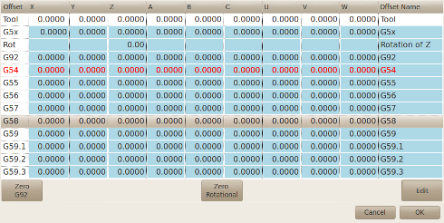

Widgets for display/edit of all axes offsets: OffsetPage

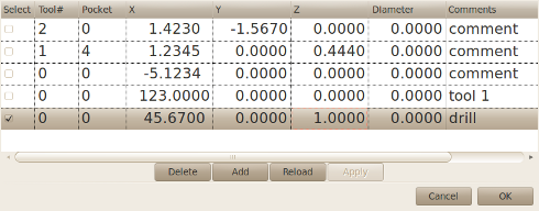

Widgets for display/edit of all tool offsets: Tooloffset editor

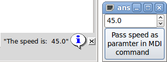

Widget for MDI input and history display: MDI History

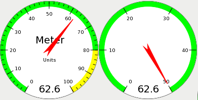

6.17. Meter
HAL_Meter is a widget similar to PyVCP meter - it represents a float value.
6.17.1. Pins
HAL_Meter has one input FLOAT HAL pin.
6.17.2. Properties
HAL Meter has the following properties:
- min, max
Minimum and maximum value of desired range.
It is not an error condition if the current value is outside this range. - force_size
Forced diameter of widget.
If not set then size will be deduced from packing or from fixed widget size, and meter will fill all available space with respect to aspect ratio. - text_template
Like in Label, sets text format for current value.
Can be used to turn off value display. - label
Large label above center of meter.
- sublabel
Small label below center of meter.
- bg_color
Background color of meter.
- z0_color, z1_color, z2_color
Colors of different value zones.
Defaults aregreen,yellowandred.
For description of zones seez*_borderproperties. - z0_border, z1_border
Define up bounds of color zones.
By default only one zone is enabled. If you want more then one zone setz0_borderandz1_borderto desired values so zone 0 will fill from min to first border, zone 1 will fill from first to second border and zone 2 from last border to max.
Borders are set as values in range min-max.

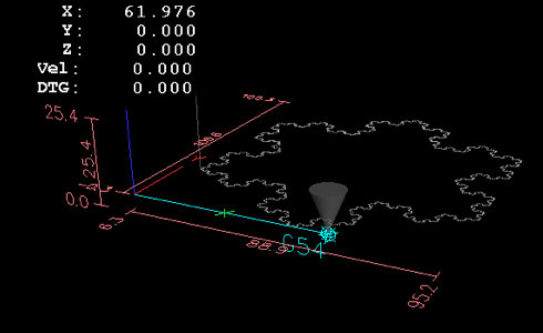

6.19. Gremlin tool path preview for NGC files
Gremlin is a plot preview widget similar to the AXIS preview window. It assumes a running LinuxCNC environment like AXIS or Touchy. To connect to it, inspects the INI_FILE_NAME environment variable. Gremlin displays the current NGC file - it does monitor for changes and reloads the ngc file if the file name in AXIS/Touchy changes. If you run it in a GladeVCP application when LinuxCNC is not running, you might get a traceback because the Gremlin widget can’t find LinuxCNC status, like the current file name.
6.19.1. Pins
Gremlin does not export any HAL pins.
6.19.2. Properties
Gremlin has the following properties:
- enable_dro
This displays the dro on the graphics.
Default = true. - show_velocity
This displays the tool speed.
Default = true. - use_commanded
This selects the DRO to use: commanded or actual values.
Default = true. - metric_units
This selects the DRO to use: metric or imperial units.
Default = true. - show_rapids
This tells the plotter to show the rapid moves.
Default = true. - show_dtg_
This selects the DRO to display the distance-to-go value.
Default = true. - use_relative
This selects the DRO to show values relative to user system or machine coordinates.
Default = true. - show_live_plot
This tells the plotter to draw or not.
Default = true. - show_limits
This tells the plotter to show the machine’s limits.
Default = true. - show_lathe_radius
This selects the DRO to display the X axis in radius or diameter, if in lathe mode (selectable in the INI file with LATHE = 1).
Default = true. - show_extents_option
This tells the plotter to show the machine’s extents.
Default = true. - show_tool
This tells the plotter to draw the tool.
Default = true. - show_program
Shows the G-code program.
Default = True - use_joints_mode
Used in non trivialkins machines (e.g., robots).
Default = false. - grid_size
Sets the size of the grid (only visible in the X, Y and Z views).
Defaults to 0 - use_default_controls
This disables the default mouse controls.
This is most useful when using a touchscreen as the default controls do not work well. You can programmatically add controls using Python and the handler file technique.
Default = true. - view
May be any of
x,y,y2,z,z2,p(perspective).
Defaults tozview. - enable_dro
Type = boolean.
Whether to draw a DRO on the plot or not.
Default = true. - mouse_btn_mode
Type = integer.
Mouse button handling: leads to different functions of the button:-
0 = default: left rotate, middle move, right zoom
1 = left zoom, middle move, right rotate
2 = left move, middle rotate, right zoom
3 = left zoom, middle rotate, right move
4 = left move, middle zoom, right rotate
5 = left rotate, middle zoom, right move
6 = left move, middle zoom, right zoom
Mode 6 is recommended for plasmas and lathes, as rotation is not needed for such machines.
6.19.3. Direct program control
There a couple ways to directly control the widget using Python.
Using GObject to set the above listed properties:
[widget name].set_property('view','P')
[widget name].set_property('metric_units',False)
[widget name].set_property('use_default_controls',False)
[widget name].set_property('enable_dro' False)
[widget name].set_property('show_program', False)
[widget name].set_property('show_limits', False)
[widget name].set_property('show_extents_option', False)
[widget name].set_property('show_live_plot', False)
[widget name].set_property('show_tool', False)
[widget name].set_property('show_lathe_radius',True)
[widget name].set_property('show_dtg',True)
[widget name].set_property('show_velocity',False)
[widget name].set_property('mouse_btn_mode', 4)
There are Python methods:
[widget name].show_offsets = True
[widget name].grid_size = .75
[widget name].select_fire(event.x,event.y)
[widget name].select_prime(event.x,event.y)
[widget name].start_continuous_zoom(event.y)
[widget name].set_mouse_start(0,0)
[widget name].gremlin.zoom_in()
[widget name].gremlin.zoom_out()
[widget name].get_zoom_distance()
[widget name].set_zoom_distance(dist)
[widget name].clear_live_plotter()
[widget name].rotate_view(x,y)
[widget name].pan(x,y)
- Hints
If you set all the plotting options false but show_offsets true you get an offsets page instead of a graphics plot.
If you get the zoom distance before changing the view then reset the zoom distance, it is much more user friendly.
if you select an element in the preview, the selected element will be used as rotation center point
6.20. HAL_Offset
The HAL_Offset widget is used to display the offset of a single axis.
6.20.1. Properties
HAL_Offset has the following properties:
- display_units_mm
Display in metric units.
- joint_number
Used to select which axis (technically which joint) is displayed.
On a trivialkins machine (mill, lathe, router) axis vs. joint number are:0:X 1:Y 2:Z 3:A 4:B 5:C 6:U 7:V 8:W - mm_text_template
You can use Python formatting to display the position with different precision.
- imperial_text_template
- reference_type
0:G5x 1:tool 2:G92 3:Rotation around Z

6.23. IconView (File Select)
This is a touch screen friendly widget to select a file and to change directories.
6.23.1. Properties
IconView widget has the following properties:
- icon_size
Sets the size of the displayed icon.
Allowed values are integers in the range from 12 to 96.
Default is 48. - start_dir
Sets the directory to start in when the widget is shown first time.
Must be a string, containing a valid directory path.
Default is "/". - jump_to_dir
Sets the "jump to" directory, which is selected by the corresponding button in the bottom button list (the 5th button counting from the left).
Default is "\~". - filetypes
Sets the file filter for the objects to be shown.
Must be a string containing a comma separated list of extensions to be shown.
Default is "ngc,py". - sortorder
Sets the sorting order of the displayed icon.
Must be an integer value from 0 to 3, where:
0 = ASCENDING (sorted according to file names)
1 = DESCENDING (sorted according to file names)
2 = FOLDERFIRST (show the folders first, then the files), default
3 = FILEFIRST (show the files first, then the folders)
6.23.2. Direct program control
[widget name].set_property(property,Value)
There are Python methods to control the widget:
[widget name].show_buttonbox(state)
If False the bottom button box will be hidden.
This is helpful in custom screens, with special buttons layouts to not alter the layout of the GUI. Good example for that is GMOCCAPY.
state= boolean (True or False).
Default is True. -
[widget name].show_filelabel(state)
If True the file label (between the IconView window and the bottom button box) will be shown.
Hiding this label may save place, but showing it is very useful for debugging reasons.
Default is True. -
[widget name].set_icon_size(iconsize)
Sets the icon size.
Must be an integer in the range from 12 to 96.
Default = 48. -
[widget name].set_directory(directory)
Allows to set an directory to be shown.
directory= string (a valid file path). -
[widget name].set_filetypes(filetypes)
Sets the file filter to be used.
Only files with the given extensions will be shown.
filetypes= string containing a comma separated list of extensions.
Default = "ngc,py". -
[widget name].get_selected()
Returns the path of the selected file, orNoneif a directory has been selected. -
[widget name].refresh_filelist()
Refreshes the filelist.
Needed if you add a file without changing the directory.
If the button box has been hidden, you can reach the functions of this button through its clicked signals like so:
[widget name].btn_home.emit("clicked")
[widget name].btn_jump_to.emit("clicked")
[widget name].btn_sel_prev.emit("clicked")
[widget name].btn_sel_next.emit("clicked")
[widget name].btn_get_selected.emit("clicked")
[widget name].btn_dir_up.emit("clicked")
[widget name].btn_exit.emit("clicked")

6.25. Tooleditor widget
This is a tooleditor widget for displaying and modifying a tool file.
If in lathe mode, it will display wear offsets and tool offsets separately.
Wear offsets are designated by tool number above 10000 (Fanuc style).

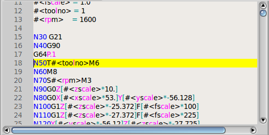

6.27. HAL_sourceview widget
This is for displaying and simple editing of G-code.
It looks for .ngc highlighting specs in ~/share/gtksourceview-4/language-specs/.
The current running line will be highlighted.
With external Python glue code it can:
Search for text, undo and redo changes.
Be used for program line selection.
6.27.1. Direct program control
[widget name].redo()
Redo one level of changes. -
[widget name].undo()
Undo one level of changes -
[widget name].text_search(direction=True,mixed_case=True,text='G92')
Searches forward (direction = True) or backward,
Searches with mixed case (mixed_case = True) or exact match -
[widget name].set_line_number(linenumber)
Sets the line to highlight.
Uses the sourceview line numbers. -
[widget name].get_line_number()
Returns the currently highlighted line. -
[widget name].line_up()
Moves the highlighted line up one line. -
[widget name].line_down()
Moves the highlighted line down one line. -
[widget name].load_file('filename')
Loads a file.
Using None (not a filename string) will reload the same program. -
[widget name].get_filename()
FIXME description

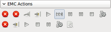

7. Action Widgets Reference
GladeVCP includes a collection of "canned actions" called VCP Action Widgets for the Glade user interface editor.
Note
Other than HAL widgets, which interact with HAL pins, VCP Actions interact with LinuxCNC and the G-code interpreter. |
VCP Action Widgets are derived from the Gtk.Action widget.
The Action widget in a nutshell:
It is an object available in Glade
It has no visual appearance by itself
Its purpose: Associate a visible, sensitive UI component like menu, toolbutton, button with a command. See these widget’s General→Related→Action property.
The "canned action" will be executed when the associated UI component is triggered (button press, menu click..).
It provides an easy way to execute commands without resorting to Python programming.
The appearance of VCP Actions in Glade is roughly as follows:
Tooltip hovers provide a description.
7.1. VCP Action Widgets
VCP Action widgets are one-shot type widgets. They implement a single action and are for use in simple buttons, menu entries or radio/check groups.

7.5. A simple example: Execute MDI command on button press
configs/apps/gladevcp/mdi-command-example/whoareyou.ui is a Glade UI file which conveys the basics:
Open it in Glade and study how it is done.
Start AXIS, and then start this from a terminal window with
gladevcp whoareyou.ui. -
See the
hal_action_mdi1action and itsMDI commandproperty - this just executes(MSG, "Hi, I'm an VCP_Action_MDI")so there should be a message popup in AXIS like so:
You’ll notice that the button associated with the Action_MDI action is grayed out if the machine is off, in E-Stop or if the interpreter is running. It will automatically become active when the machine is turned on and out of E-Stop, and the program is idle.

The example UI file is configs/apps/gladevcp/mdi-command-example/speed.ui.
Here’s what you get when running it:

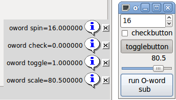

7.7. An advanced example: Feeding parameters to an O-word subroutine
It’s perfectly OK to call an O-word subroutine in an MDI command, and pass HAL pin values as actual parameters.
An example UI file is in configs/apps/gladevcp/mdi-command-example/owordsub.ui.
Place nc_files/gladevcp_lib/oword.ngc so AXIS can find it, and run gladevcp owordsub.ui from a terminal window.
This looks like so:

import linuxcnc import os import hal import hal_glib class HandlerClass: def _on_max_value_change(self,hal_pin,data=None): self.meter.max = float(hal_pin.get()) self.meter.queue_draw() # force a widget redraw def __init__(self, halcomp,builder,useropts): self.builder = builder # HAL pin with change callback. # When the pin's value changes the callback is executed. self.max_value = hal_glib.GPin(halcomp.newpin('max-value', hal.HAL_FLOAT, hal.HAL_IN)) self.max_value.connect('value-changed', self._on_max_value_change) inifile = linuxcnc.ini(os.getenv("INI_FILE_NAME")) mmin = float(inifile.find("METER", "MIN") or 0.0) self.meter = self.builder.get_object('meter') self.meter.min = mmin def get_handlers(halcomp,builder,useropts): return [HandlerClass(halcomp,builder,useropts)]
