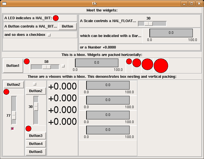

The following graphic displays many of the PyVCP widgets.
images/pyvcp_group.png

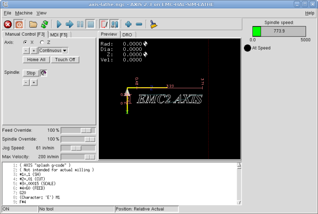

images/pyvcp_axis_lathe.png
This is what the newly created PyVCP panel should look like in AXIS. The sim/lathe configuration is already configured this way.
