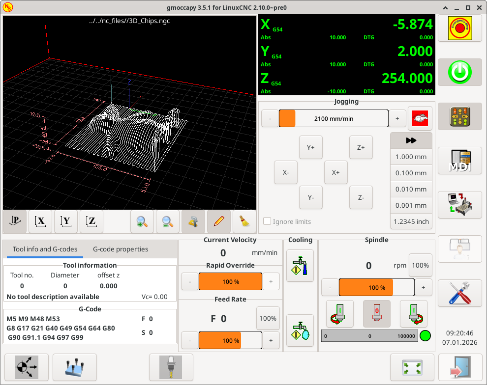

You will get a similar screen to the following (the design may vary depending on your config):

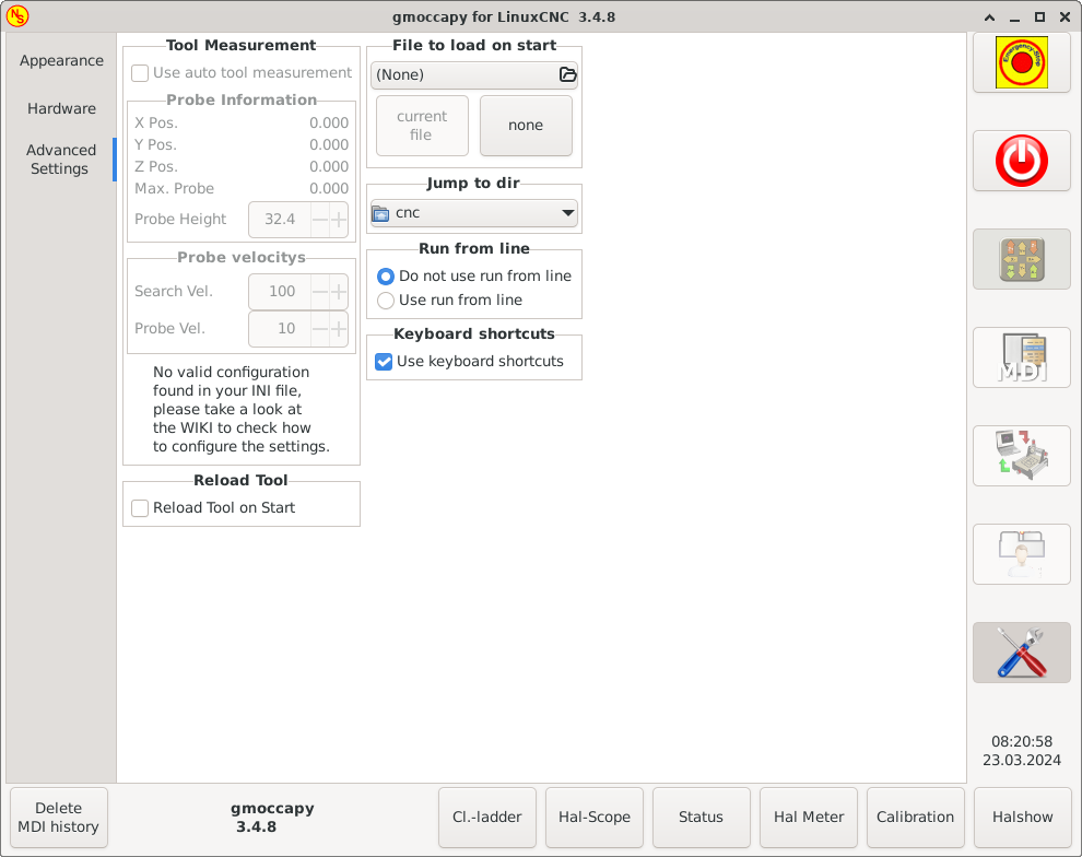

4. Basic Configuration
GMOCCAPY 3 supports the following command line options:
  • -user_mode: If set, the setup button will be disabled, so normal machine operators are not able to edit the settings of the machine.
  • -logo <path to logo file>: If given, the logo will hide the jog button tab in manual mode, this is only useful for machines with hardware buttons for jogging and increment selection.

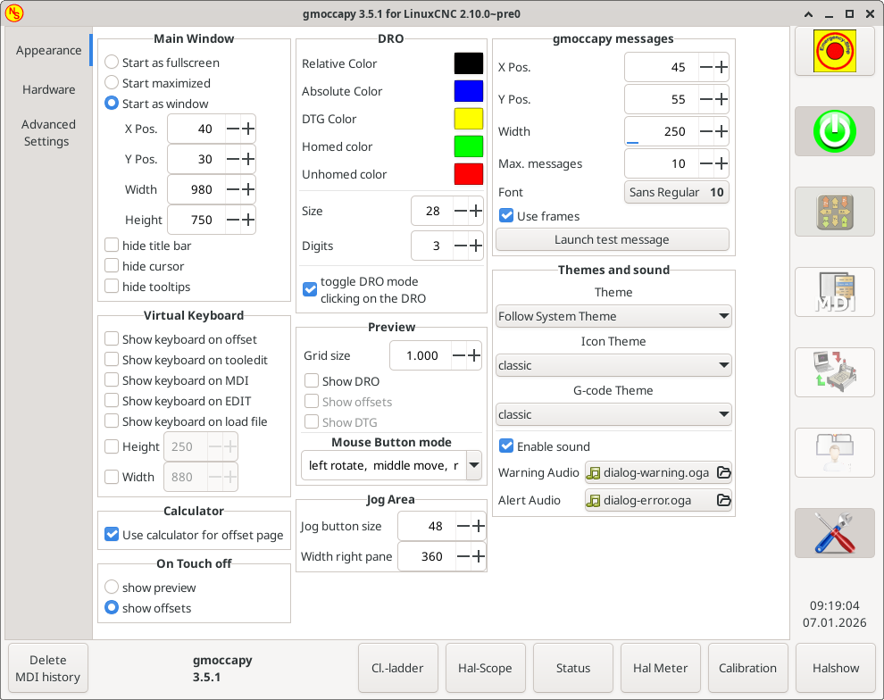

4.1. The DISPLAY Section
[DISPLAY]
DISPLAY = gmoccapy
PREFERENCE_FILE_PATH = gmoccapy_preferences
MAX_FEED_OVERRIDE = 1.5
MAX_SPINDLE_OVERRIDE = 1.2
MIN_SPINDLE_OVERRIDE = 0.5
DEFAULT_SPINDLE_SPEED = 500
LATHE = 1
BACK_TOOL_LATHE = 1
PROGRAM_PREFIX = ../../nc_files/
  • DISPLAY = gmoccapy - This tells LinuxCNC to use GMOCCAPY.
  • PREFERENCE_FILE_PATH - Gives the location and name of the preferences file to be used. In most cases this line will not be needed, it is used by GMOCCAPY to store your settings of the GUI, like themes, DRO units, colors, and keyboard settings, etc., see settings page for more details.
    Note
    If no path or file is given, GMOCCAPY will use as default <your_machinename>.pref, if no machine name is given in your INI File it will use gmoccapy.pref. The file will be stored in your config directory, so the settings will not be mixed if you use several configs. If you only want to use one file for several machines, you need to include PREFERENCE_FILE_PATH in your INI.
  • MAX_FEED_OVERRIDE = 1.5 - Sets the maximum feed override, in the example given, you will be allowed to override the feed by 150%.
    Note
    If no value is given, it will be set to 1.0.
  • MIN_SPINDLE_OVERRIDE = 0.5 and MAX_SPINDLE_OVERRIDE = 1.2 - Will allow you to change the spindle override within a limit from 50% to 120%.
    Note
    If no values are given, MIN will be set to 0.1 and MAX to 1.0.
  • LATHE = 1 - Set the screen layout to control a lathe.
  • BACK_TOOL_LATHE = 1 - Is optional and will switch the X axis in a way you need for a back tool lathe. Also the keyboard shortcuts will react in a different way. It is allowed with GMOCCAPY to configure a lathe also with additional axes, so you may use also a XZCW config for a lathe.
    Astuce
    See also the Lathe Specific Section.
  • PROGRAM_PREFIX = ../../nc_files/ - Is the entry to tell LinuxCNC/GMOCCAPY where to look for the NGC files.
    Note
    If not specified, GMOCCAPY will look in the following order for NGC files: First linuxcnc/nc_files and then the users home directory.
  • DEFAULT_SPINDLE_SPEED - Start value for "Starting RPM" if value not present in preferences file or file is not present. Will have no effect with valid preferences file.
  • MIN_ANGULAR_VELOCITY - Sets the minimal jog velocity of the machine for rotary axes.
  • MAX_ANGULAR_VELOCITY - Sets the maximal jog velocity of the machine for rotary axes.
  • DEFAULT_ANGULAR_VELOCITY - Sets the default jog velocity of the machine for rotary axes.

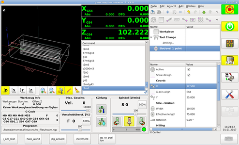

4.3. Macro Buttons
You can add macros to GMOCCAPY, similar to Touchy’s way. A macro is nothing else than a NGC file. You are able to execute complete CNC programs in MDI mode by just pushing one button. To do so, you first have to specify the search path for macros:
[RS274NGC]
SUBROUTINE_PATH = macros
This sets the path to search for macros and other subroutines. Several subroutine paths can be separated ":".
Then you just have to add a section like this:
Configuration of Five Macros to be Shown in the MDI Button List
[MACROS]
MACRO = i_am_lost
MACRO = hello_world
MACRO = jog_around
MACRO = increment xinc yinc
MACRO = go_to_position X-pos Y-pos Z-pos
Then you have to provide the corresponding NGC files which have to follow these rules:
  • The name of the file need to be exactly the same as the name mentioned in the macro line, just with the ".ngc" extension (case sensitive).
  • The file must contain a subroutine like O<i_am_lost> sub, the name of the sub must match exactly (case sensitive) the name of the macro.
  • The file must end with an endsub O<i_am_lost> endsub followed by an M2 command.
  • The files need to be placed in a folder specified in your INI file by SUBROUTINE_PATH in the RS274NGC section
The code between sub and endsub will be executed by pushing the corresponding macro button.
Note
A maximum of 16 macros will be shown in the GUI. Due to space reasons you may need to click on an arrow to switch the page and display hidden macro buttons. The macro buttons will be displayed in the order of the INI entries. It is no error placing more than 16 macros in your INI file, they will just not be shown.
Note
You will find the sample macros in a folder named macros placed in the GMOCCAPY sim folder. If you have given several subroutine paths, they will be searched in the order of the given paths. The first file found will be used.

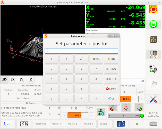

GMOCCAPY will also accept macros asking for parameters like:
[MACROS]
The parameters must be separated by spaces. This example calls a file go_to_position.ngc with the following content:
; Test file "go to position"
; will jog the machine to a given position
O<go_to_position> sub
G17
G21
G54
G61
G40
G49
G80
G90
;#1 = <X-Pos>
;#2 = <Y-Pos>
;#3 = <Z-Pos>
(DEBUG, Will now move machine to X = #1 , Y = #2 , Z = #3)
G0 X #1 Y #2 Z #3
O<go_to_position> endsub
M2
After pushing the execute macro button, you will be asked to enter the values for X-pos Y-pos Z-pos and the macro will only run if all values have been given.
Note
If you would like to use a macro without any movement, see also the notes in known problems.
Macro example using the "go to position"-macro

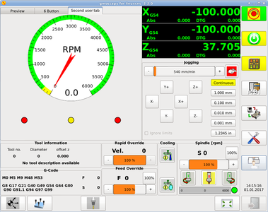

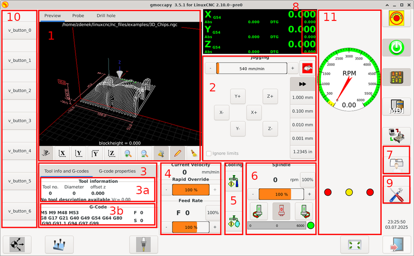

4.4. Embedded Tabs and Panels
You can add embedded programs to GMOCCAPY like you can do in AXIS, Touchy and Gscreen. All is done by GMOCCAPY automatically if you include a few lines in your INI file in the DISPLAY section.
If you have never used a Glade panel, I recommend to read the excellent documentation on Glade VCP.
Embedded Tab Example
EMBED_TAB_NAME = DRO
EMBED_TAB_LOCATION = ntb_user_tabs
EMBED_TAB_COMMAND = gladevcp -x {XID} dro.glade
EMBED_TAB_NAME = Second user tab
EMBED_TAB_COMMAND = gladevcp -x {XID} vcp_box.glade
All you have to take care of, is that you include for every tab or side panel the mentioned three lines:
  • EMBED_TAB_NAME = Represents the name of the tab or side panel, it is up to you what name you use, but it must be present!
  • EMBED_TAB_LOCATION = The place where your program will be placed in the GUI, see figure Embedded tab locations. Valid values are:
    • ntb_user_tabs (as main tab, covering the complete screen (7))
    • ntb_preview (as tab on the preview side (1))
    • hbox_jog (will hide the jog buttons and introduce your glade file here (2))
    • box_left (on the left, complete height of the screen (10))
    • box_right (on the right, in between the normal screen and the button list (11))
    • box_tool_and_code_info (will hide the Tool information and G-code frames and introduce your glade file here (3))
    • box_tool_info (will hide the Tool information frame and introduce your glade file here (3a))
    • box_code_info (will hide the G-code information frame and introduce your glade file here (3b))
    • box_vel_info (will hide the velocity frames and introduce your glade file (4))
    • box_coolant_and_spindle (will hide the coolant and spindle frames and introduce your glade file here (5)+(6))
    • box_cooling (will hide the cooling frame and introduce your glade file (5))
    • box_spindle (will hide the spindle frame and introduce your glade file (6))
    • box_custom_1 (will introduce your glade file left of vel_frame)
    • box_custom_2 (will introduce your glade file left of cooling_frame)
    • box_custom_3 (will introduce your glade file left of spindle_frame)
    • box_custom_4 (will introduce your glade file right of spindle_frame)
    • box_dro_side (will introduce your glade file right of the DRO (8))
    • ntb_setup (as tab on the setup page (9))
Note
See also the included sample INI files to see the differences.
  • EMBED_TAB_COMMAND = The command to execute, i.e.
    includes a custom glade file called dro.glade in the mentioned location. The file must be placed in the config folder of your machine.
    gladevcp h_buttonlist.glade
    will just open a new user window called h_buttonlist.glade note the difference. This one is stand alone, and can be moved around independent from GMOCCAPY window.
    gladevcp -c gladevcp -u hitcounter.py -H manual-example.hal manual-example.ui
    will add a the panel manual-example.ui, include a custom Python handler, hitcounter.py and make all connections after realizing the panel according to manual-example.hal.
    hide
    will hide the chosen box.
Figure 1. Embedded tab locations

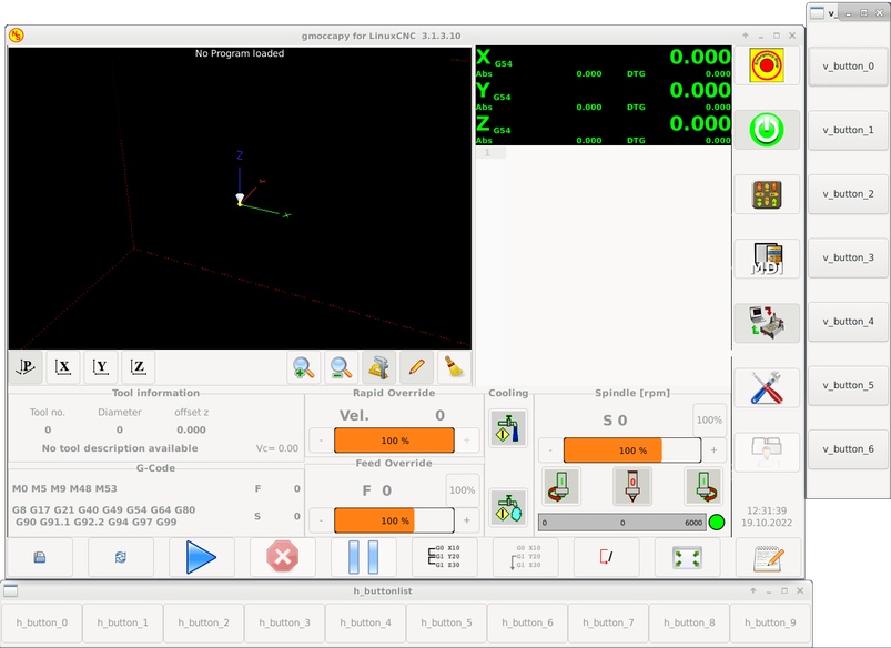

Here are some examples:
ntb_preview
images/gmoccapy_ntb_preview_small.png
box_right - and GMOCCAPY in MDI mode
images/gmoccapy_with_right_panel_in_MDI_mode_small.png

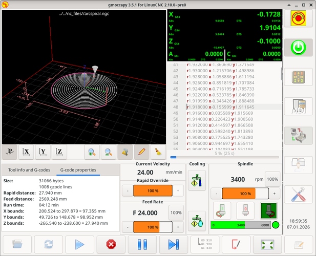

4.6. Preview Control
Magic comments can be used to control the G-code preview. On very large programs the preview can take a long time to load. You can control what is shown and what is hidden on the graphics screen by adding the appropriate comments from this list into your G-code:

4.7. User Command File
If a file ~/.gmoccapyrc exists, its contents are executed as Python source code just after the GUI is displayed. The details of what may be written in the ~/.gmoccapyrc are subject to change during the development cycle.
A configuration-specific Python file may be specified with an INI file setting
[DISPLAY]
USER_COMMAND_FILE=filename.py
If this file is specified, this file is sourced just after the GMOCCAPY GUI is displayed instead of ~/.gmoccapyrc.
The following example changes the size of the vertical buttons: .Example of .gmoccapyrc file
self.widgets.vbtb_main.set_size_request(85,-1)
BB_SIZE = (70, 70) # default = (90, 56)
self.widgets.tbtn_estop.set_size_request(*BB_SIZE)
self.widgets.tbtn_on.set_size_request(*BB_SIZE)
self.widgets.rbt_manual.set_size_request(*BB_SIZE)
self.widgets.rbt_mdi.set_size_request(*BB_SIZE)
self.widgets.rbt_auto.set_size_request(*BB_SIZE)
self.widgets.tbtn_setup.set_size_request(*BB_SIZE)
self.widgets.tbtn_user_tabs.set_size_request(*BB_SIZE)
self.widgets.btn_exit.set_size_request(*BB_SIZE)
The widget names can the looked up in the /usr/share/gmoccapy.glade file
4.8. User CSS File
Similar to the User command file it’s possible to influence the appearance by cascading style sheets (CSS). If a file ~/.gmoccapy_css exists, its contents are loaded into the stylesheet provider and are so being applied to the GUI.
A configuration-specific CSS file may be specified with an INI file setting
[DISPLAY]
USER_CSS_FILE=filename.css
If this file is specified, this file is used instead of ~/.gmoccapy_css.
Information what can be controlled by CSS can be found here: Overview of CSS in GTK
Here an example how the color of checked buttons can be set to yellow: .Example Yellow color for checked buttons
button:checked {
    background: rgba(250,230,0,0.8);
4.9. Logging
GMOCCAPY supports specifying the level of information (log level) that will be printed to the console and to the log file.
The order is VERBOSE, DEBUG, INFO, WARNING, ERROR, CRITICAL. Default is WARNING, that means WARNING, ERROR and CRITICAL are printed.
You can specify the log level in the INI file like this:
[DISPLAY]
DISPLAY = gmoccapy <log_level_param>
using these parameters:
Log level   <log_level_param>
DEBUG       -d
INFO        -i
VERBOSE     -v
ERROR       -q
Example: Configure logging to print only errors
[DISPLAY]
DISPLAY = gmoccapy -q
You can specify where to save the log file:
[DISPLAY]
LOG_FILE = gmoccapy.log
If LOG_FILE is not set, logging happens to $HOME/<base_log_name>.log.

5.1. Right and Bottom Button Lists
The screen has two main button lists, one on the right side an one on the bottom. The right handed buttons will not change during operation, but the bottom button list will change very often. The buttons are count from up to down and from left to right beginning with 0.
Note
The pin names have changed in GMOCCAPY 2 to order them in a better way.
The pins for the right (vertical) buttons are:
  • gmoccapy.v-button.button-0 (bit IN)
  • gmoccapy.v-button.button-1 (bit IN)
  • gmoccapy.v-button.button-2 (bit IN)
  • gmoccapy.v-button.button-3 (bit IN)
  • gmoccapy.v-button.button-4 (bit IN)
  • gmoccapy.v-button.button-5 (bit IN)
  • gmoccapy.v-button.button-6 (bit IN)
For the bottom (horizontal) buttons they are:
  • gmoccapy.h-button.button-0 (bit IN)
  • gmoccapy.h-button.button-1 (bit IN)
  • gmoccapy.h-button.button-2 (bit IN)
  • gmoccapy.h-button.button-3 (bit IN)
  • gmoccapy.h-button.button-4 (bit IN)
  • gmoccapy.h-button.button-5 (bit IN)
  • gmoccapy.h-button.button-6 (bit IN)
  • gmoccapy.h-button.button-7 (bit IN)
  • gmoccapy.h-button.button-8 (bit IN)
  • gmoccapy.h-button.button-9 (bit IN)
As the buttons in the bottom list will change according to the mode and other influences, the hardware buttons will activate the displayed functions. So you don’t have to take care about switching functions around in HAL, because that is done completely by GMOCCAPY!
For a three axes XYZ machine the HAL pins will react as shown in the following three tables:
Tableau 1. Functional assignment of horizontal buttons (1)
Pin Manual Mode MDI Mode Auto Mode
open homing button
macro 1 (if defined)
open file
open touch off stuff
macro 2 (if defined)
reload program
macro 3 (if defined)
run
open tool dialogs
macro 4 (if defined)
stop
macro 5 (if defined)
pause
macro 6 (if defined)
step by step
macro 7 (if defined)
run from line if enabled in settings, otherwise nothing
macro 8 (if defined)
optional blocks
full-size preview
macro 9 or button to show additional macros
full-size preview
exit if machine is off, otherwise nothing
open keyboard or abort if macro is running
edit code
Tableau 2. Functional assignment of horizontal buttons (2)
Pin Settings Mode Homing Mode Touch off Mode
delete MDI history
touch X
home all
touch Y
touch Z
home x
open classic ladder
home y
open HAL scope
home z
open HAL status
open HAL meter
open HAL calibration
unhome all
open HAL show
back
back
Tableau 3. Functional assignment of horizontal buttons (3)
Pin Tool Mode Edit Mode Select File
go to home directory
reload file
one directory level up
save
save as
move selection left
change tool by number T? M6
move selection right
set tool by number without change M61 Q?
jump to directory as set in settings
change tool to the selected one
new file
select / ENTER
touch of tool in Z
show keyboard
back
back
back
So we have 67 reactions with only 10 HAL pins!

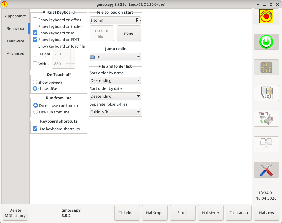

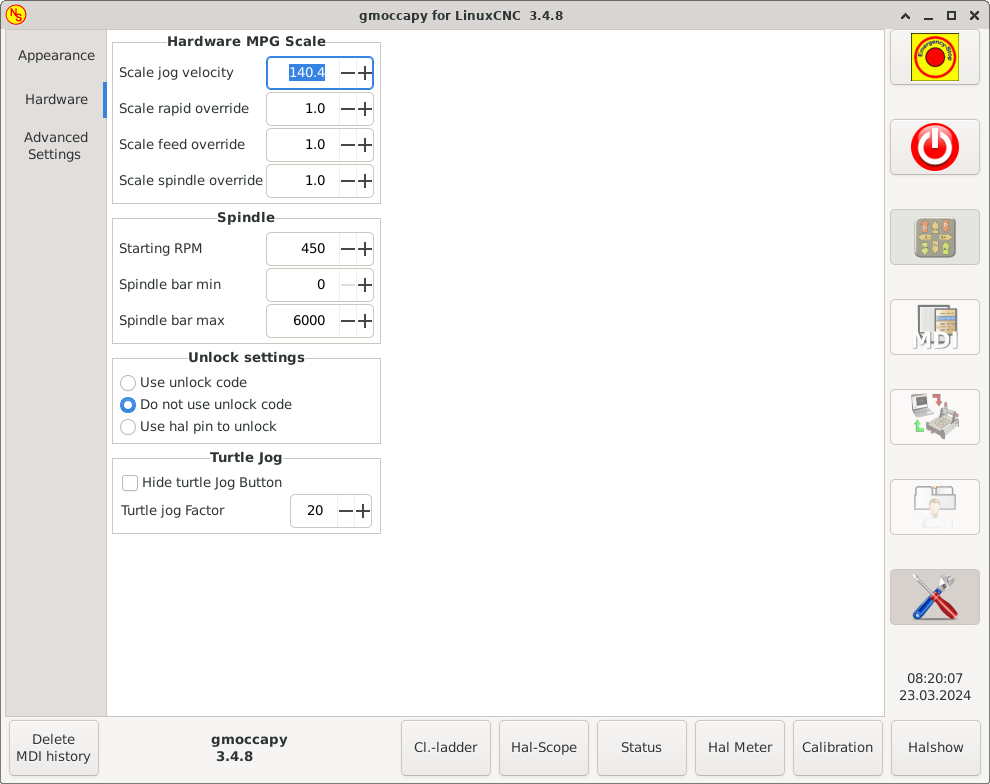

These pins are made available to be able to use the screen without a touch panel, or protect it from excessive use by placing hardware buttons around the panel. They are available in a sample configuration like shown in the image below.
Sample configuration "gmoccapy_sim_hardware_button" showing the side buttons
images/gmoccapy_sim_hardware_button_mid.png

7. The Settings Page
To enter the page you will have to click on images/gmoccapy_settings_button.png and give an unlock code, which is 123 by default. If you want to change it at this time you will have to edit the hidden preference file, see the display section for details.
The page is separated in three main tabs:

7.2. Behaviour
Configuration page
Figure 6. GMOCCAPY settings page Behaviour
Virtual Keyboard
The checkboxes allow the user to select if he wants the on board keyboard to be shown immediately when entering the MDI Mode, the offset page, the tooledit widget or when open a program in the EDIT mode. The keyboard button on the bottom button list will not be affected by these settings, so you are able to show or hide the keyboard by pressing the button.
The default setting is:
  • Show keyboard on offset = False
  • Show keyboard on tooledit = False
  • Show keyboard on MDI = True
  • Show keyboard on EDIT = True
  • Show keyboard on load file = False

Some users want to jog their machine using the keyboard buttons and there are others that will never allow this. So everybody can select whether to use them or not.
Keyboard shortcuts are disabled by default. They can be activated by the checkbox
  • Use keyboard shortcuts
Attention
It is not recommended to use keyboard jogging, as it represents a serious risk for operator and machine.
Please take care if you use a lathe, then the shortcuts will be different, see the Lathe Specific Section.
Général
  • F1 - Trigger Estop (will work even if keyboard shortcuts are disabled)
  • F2 - Toggle machine on/off
  • F3 - Manual mode
  • F5 - MDI mode
  • ESC - Abort
In Manual Mode
  • Arrow_Left or NumPad_Left - Jog X minus
  • Arrow_Right or NumPad_Right - Jog X plus
  • Arrow_up or NumPad_Up - Jog Y plus
  • Arrow_Down or NumPad_Down - Jog Y minus
  • Page_Up or NumPad_Page_Up - Jog Z plus
  • Page_Down or NumPad_Page_Down - Jog Z minus
In Auto Mode
  • R or r - Run program
  • P or p - Pause program
  • S or s - Resume program
  • Control + R or Control + r - Reload the loaded file
Message handling (see Message behavior and appearance)
  • WINDOWS - Delete last message
  • Control + Space - Delete all messages
File to load on start up

7.4. Advanced Settings
Advanced settings
Tool Measurement
Please check Auto Tool Measurement
Note
If this part is not sensitive, you do not have a valid INI file configuration to use tool measurement.
  • Use auto tool measurement - If checked, after each tool change, a tool measurement will be done, the result will be stored in the tool table and a G43 will be executed after the change.
    Probe Information
    The following information are taken from your INI file and must be given in absolute coordinates:
    • X Pos. - The X position of the tool switch.
    • Y Pos. - The Y position of the tool switch.
    • Z Pos. - The Z position of the tool switch, we will go as rapid move to this coordinate.
    • Max. Probe - The distance to search for contact, an error will be launched, if no contact is given in this range. The distance has to be given in relative coordinates, beginning the move from Z Pos., so you have to give a negative value to go down!
    • Probe Height - The height of your probe switch, you can measure it. Just touch off the base where the probe switch is located and set that to zero. Then make a tool change and watch the tool_offset_z value, that is the height you must enter here.
    Probe velocities
    • Search Vel. - The velocity to search for the tool switch. After contact the tool will go up again and then goes towards the probe again with probe vel, so you will get better results.
    • Probe Vel. - The velocity for the second movement to the switch. It should be slower to get better touch results. In simulation mode, this is commented out in macros/change.ngc, otherwise the user would have to click twice on the probe button.
Reload Tool::
  • Reload Tool on Start - Loads the last tool on start after homing.
If checked, the tool in spindle will be saved on each change in the preference file, making it possible to reload the last mounted tool on start up. The tool will be loaded after all axes are homed, because before it is not allowed to execute MDI commands. If you use NO_FORCE_HOMING you can not use this feature, because the needed all_homed_signal will never be emitted.

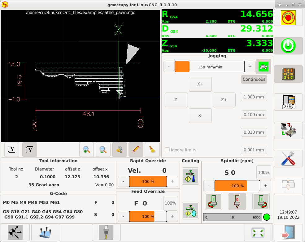

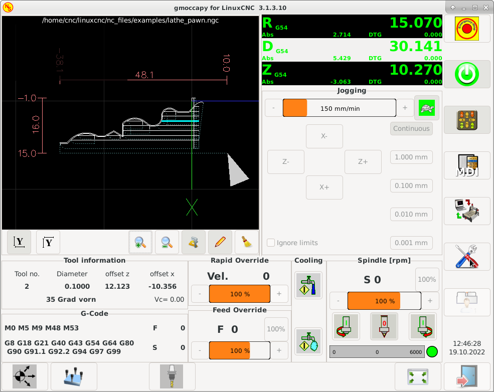

9. Lathe Specific Section
If in the INI file LATHE = 1 is given, the GUI will change its appearance to the special needs for a lathe. Mainly the Y axis will be hidden and the jog buttons will be arranged in a different order.
images/gmoccapy_lathe.png
Figure 7. Normal Lathe
images/gmoccapy_back_tool_lathe.png
Figure 8. Back Tool Lathe
As you see the R DRO has a black background and the D DRO is gray. This will change according to the active G-code G7 or G8. The active mode is visible by the black background, meaning in the shown images G8 is active.
The next difference to the standard screen is the location of the jog buttons. X and Z have changed places and Y is gone. You will note that the X+ and X- buttons changes there places according to normal or back tool lathe.
Also the keyboard behavior will change:
Normal Lathe:
  • Arrow_Left or NumPad_Left - Jog Z minus
  • Arrow_Right or NumPad_Right - Jog Z plus
  • Arrow_up or NumPad_Up - Jog X minus
  • Arrow_Down or NumPad_Down - Jog X plus
Back Tool Lathe:
  • Arrow_up or NumPad_Up - Jog X plus
  • Arrow_Down or NumPad_Down - Jog X minus
The tool information frame will show not only the Z offset, but also the X offset and the tool table is showing all lathe relevant information.

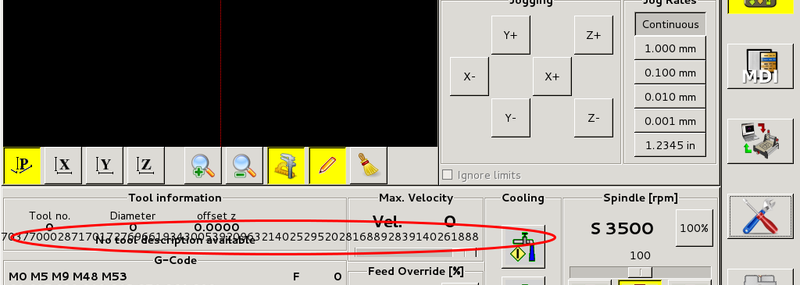

12.1. Strange numbers in the info area
If you get strange numbers in the info area of GMOCCAPY like:
Strange numbers
You have made your config file using an older version of StepConfWizard. It has made a wrong entry in the INI file under the [TRAJ] named MAX_LINEAR_VELOCITY = xxx. Change that entry to MAX_VELOCITY = xxx.
