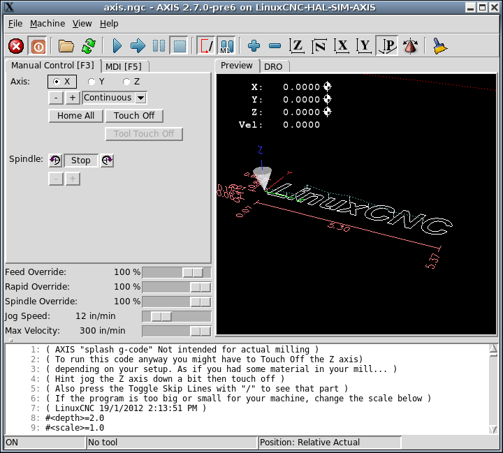

When AXIS starts, a window like the one in the figure [fig:axis-window] above opens.

3. AXIS Window
The AXIS window contains the following elements:
A display area that shows one of the following:
A preview of the loaded file (in this case, axis.ngc), as well as the current location of the CNC machine’s controlled point. Later, this area will display the path the CNC machine has moved through, called the backplot.
A large readout showing the current position and all offsets.
A menu bar and toolbar that allow you to perform various actions

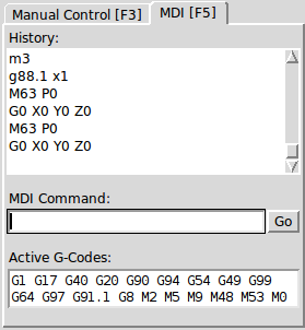

Manual Control Tab - which allows you to make the machine move, turn the spindle on or off, and turn the coolant on or off if included in the INI file.
MDI Tab - where G-code programs can be entered manually, one line at a time. This also shows the Active G-codes which shows which modal G-codes are in effect.
Feed Override - which allows you to scale the speed of programmed motions. The default maximum is 120% and can be set to a different value in the INI file. See the Display Section of the INI file for more information.
Spindle Override - which allows you to scale the spindle speed up or down.
Jog Speed - which allows you to set the jog speed within the limits set in the INI file. See the Display Section of the INI file for more information.
Max Velocity - which allows you to restrict the maximum velocity of all programmed motions (except spindle synchronized motion).
A text display area that shows the loaded G-code.
A status bar which shows the state of the machine. In this screen shot, the machine is turned on, does not have a tool inserted, and the displayed position is Relative (showing all offsets), and Actual (showing feedback position).

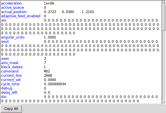

Show LinuxCNC Status - Opens a window showing LinuxCNC’s status.

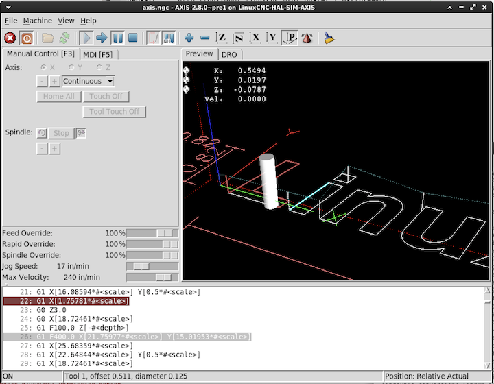

3.3. Graphical Display Area
In the upper-left corner of the program display is the coordinate position
display for each axis. To the right of the number an origin symbol
is shown if the axis has been homed.
A limit symbol
is shown on the right side of the
coordinate position number if the axis is on one of its limit switches.
To properly interpret the coordinate position numbers, refer to the Position:
indicator in the status bar. If the position is Machine Actual, then the
displayed number is in the machine coordinate system. If it is
Relative Actual, then the displayed number is in the offset coordinate
system. When the coordinates displayed are relative and an offset has been set,
the display will include a cyan machine origin
marker.
If the position is Commanded, then the exact coordinate given in a G-code command is displayed. If it is Actual, then it is the position the machine has actually moved to. These values can be different from commanded position due to following error, dead band, encoder resolution, or step size. For instance, if you command a movement to X 0.0033 on your mill, but one step of your stepper motor or one encoder count is 0.00125, then the Commanded position might be 0.0033, but the Actual position will be 0.0025 (2 steps) or 0.00375 (3 steps).
When a file is loaded, a preview of it is shown in the display area. Fast moves (such as those produced by the G0 command) are shown as cyan lines. Moves at a feed rate (such as those produced by the G1 command) are shown as solid white lines. Dwells (such as those produced by the G4 command) are shown as small pink X marks.
G0 (Rapid) moves prior to a feed move will not show on the preview plot. Rapid moves after a T<n> (Tool Change) will not show on the preview until after the first feed move. To turn either of these features off program a G1 without any moves prior to the G0 moves.
The extents of the program in each axis are shown. At the ends, the least and greatest coordinate values are indicated. In the middle, the difference between the coordinates is shown.
When some coordinates exceed the soft limits in the INI file, the relevant dimension is shown in a different color and enclosed by a box. In figure below the maximum soft limit is exceeded on the X axis as indicated by the box surrounding the coordinate value. The minimum X travel of the program is -1.95, the maximum X travel is 1.88, and the program requires 3.83 inches of X travel. To move the program so it’s within the machine’s travel in this case, jog to the left and Touch Off X again.
When no tool is loaded, the location of the tip of the tool is indicated by the tool cone. The tool cone does not provide guidance on the form, length, or radius of the tool.
When a tool is loaded (for instance, with the MDI command T1 M6 ), the cone changes to a cylinder which shows the diameter of the tool given in the tool table file.
When the machine moves, it leaves a trail called the backplot. The color of the line indicates the type of motion: Yellow for jogs, faint green for rapid movements, red for straight moves at a feed rate, and magenta for circular moves at a feed rate.

3.6. MDI
MDI allows G-code commands to be entered manually. When the machine is not turned on, or when a program is running, the MDI controls are unavailable.
History - This shows MDI commands that have been typed earlier in this session.
MDI Command - This allows you to enter a G-code command to be executed. Execute the command by pressing Enter or by clicking Go.
Active G-codes - This shows the modal codes that are active in the interpreter. For instance, G54 indicates that the G54 offset is applied to all coordinates that are entered. When in Auto the Active G-codes represent the codes after any read ahead by the interpreter.

5. Show LinuxCNC Status (linuxcnctop)
AXIS includes a program called linuxcnctop which shows some of the details of LinuxCNC’s state. You can run this program by invoking Machine > Show LinuxCNC Status
The name of each item is shown in the left column. The current value is shown in the right column. If the value has recently changed, it is shown on a red background.

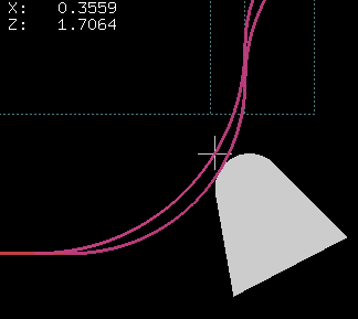

10. Using AXIS in Lathe Mode
By including the line LATHE = 1 in the [DISPLAY] section of the INI file, AXIS selects lathe mode. The Y axis is not shown in coordinate readouts, the view is changed to show the Z axis extending to the right and the X axis extending towards the bottom of the screen, and several controls (such as those for preset views) are removed. The coordinate readouts for X are replaced with diameter and radius.
Pressing V zooms out to show the entire file, if one is loaded.
When in lathe mode, the shape of the loaded tool (if any) is shown.
To change the display to a back tool lathe you need to have both LATHE = 1 and BACK_TOOL_LATHE = 1 in the [DISPLAY] section. This will invert the view and put the tool on the back side of the Z axis.
