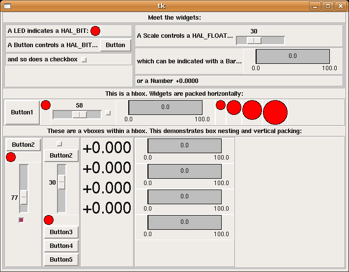

Virtual Control Panels can be used for testing or monitoring things to temporarily replace real I/O devices while debugging ladder logic, or to simulate a physical panel before you build it and wire it to an I/O board.
The following graphic displays many of the PyVCP widgets.

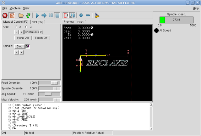

4. AXIS
Since AXIS uses the same GUI toolkit (Tkinter) as PyVCP, it is possible to include a PyVCP panel at either the right side or the bottom of the AXIS user interface. It is not possible to display a panel in both of these positions simultaneously. A typical example is explained below.
In addition to or instead of displaying a PyVCP panel as described above,
it is possible to display one or more PyVCP panels as embedded tabs in the AXIS GUI.
This is achieved by the following in the [DISPLAY]
section of the INI file:
EMBED_TAB_NAME = Spindle EMBED_TAB_COMMAND = pyvcp spindle.xml
The text label of the AXIS tab will display Spindle
4.1. Example Panel
Place your PyVCP XML file describing the panel in the same directory where your INI file is. Say we we want to display the current spindle speed using a Bar widget. Place the following in a file called spindle.xml:
<pyvcp> <label> <text>"Spindle speed:"</text> </label> <bar> <halpin>"spindle-speed"</halpin> <max_>5000</max_> </bar> </pyvcp>
Here we’ve made a panel with a Label and a Bar widget,
specified that the HAL pin connected to the Bar should be named spindle-speed,
and set the maximum value of the bar to 5000 (see widget reference below for all options).
To make AXIS aware of this file, and call it at start up,
we need to specify the following in the [DISPLAY]
PYVCP = spindle.xml
If the panel should appear at the bottom of the AXIS user interface
then we need to specify the following in the [DISPLAY]
PYVCP_POSITION = BOTTOM
Anything other than BOTTOM or omitting this variable will place the PYVCP panel at the right.
To make our widget actually display the spindle-speed it needs to be hooked up to the appropriate HAL signal. A HAL file that will be run once AXIS and PyVCP have started can be specified in the [HAL] section of the INI file:
POSTGUI_HALFILE = spindle_to_pyvcp.hal
This change will run the HAL commands specified in spindle_to_pyvcp.hal. In our example the contents could look like this:
net spindle-rpm-filtered => pyvcp.spindle-speed
assuming that a signal called spindle-rpm-filtered already exists. Note that when running together with AXIS, all PyVCP panel widget HAL pins have names that start with pyvcp., all PyVCP embedded tab widget HAL pins start with the name specified as EMBED_TAB_NAME converted to lower case.
This is what the newly created PyVCP panel should look like in AXIS. The sim/lathe configuration is already configured this way.
