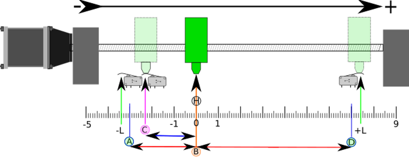

3. Separate Home Switch Example Layout
This example shows minimum and maximum limit switches with a separate home switch.
A is the negative soft limit
B is the G53 machine coordinate Origin
C is the home switch trip point
D is the positive soft limit
H is the final home position (HOME) = 0 units
The -L and +L are the limit switches trip points
A<->B is the negative soft limits (MIN_LIMITS) = -3 units
B<->C is the home_offset (HOME_OFFSET) = -2.3 units
B<->D is the positive soft limits (MAX_LIMITS) = 7 units
A<->D is the total travel = 10 units
The distance between the limit switches and soft limits (-L<->A and D<-+L) is magnified in this example
Note that there is distance between the limit switches and actual physical hard contact for coasting after the amplifier is disabled.
Note
Homing sets the G53 coordinate system, while the machine origin (zero point) can be anywhere, setting the zero point at the negative soft limit makes all G53 coordinates positive, which is probably easiest to remember. Do this by setting MIN_LIMIT = 0 and make sure MAX_LIMIT is positive. |

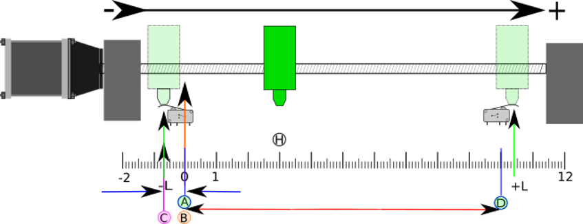

4. Shared Limit/Home Switch Example Layout
This example shows a maximum limit switch and a combined minimum limit/home switch.
A is the negative soft limit.
B is the G53 machine coordinate Origin.
C is the home switch trip point shared with (-L) minimum limit trip.
D is the positive soft limit.
H is the final home position (HOME) = 3 units.
The -L and +L are the limit switch trip points.
A<->B is the negative soft limits (MIN_LIMITS) = 0 units.
B<->C is the home_offset (HOME_OFFSET) = -0.7 units.
B<->D is the positive soft limits (MAX_LIMITS) 10 units.
A<->D is the total travel = 10 units.
The distance between the limits switches and soft limits (-L<->A and D<->+L) is magnified in this example.

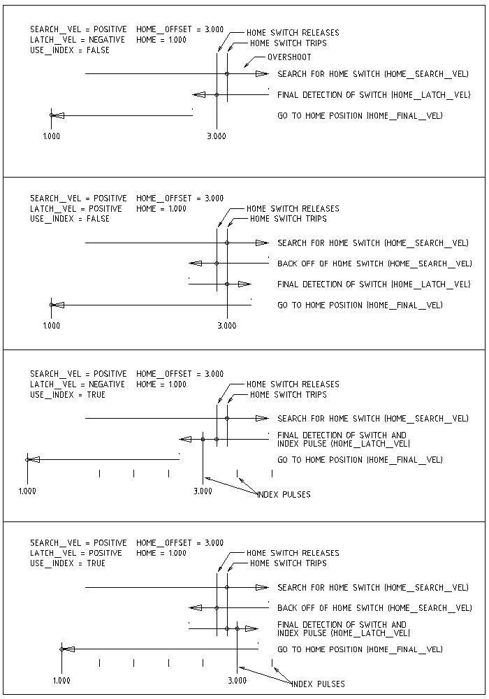

5. Homing Sequence
There are four possible homing sequences defined by the sign of HOME_SEARCH_VEL and HOME_LATCH_VEL, along with the associated configuration parameters as shown in the following table. Two basic conditions exist, HOME_SEARCH_VEL and HOME_LATCH_VEL are the same sign or they are opposite signs. For a more detailed description of what each configuration parameter does, see the following section.
6. Configuration
The following determines exactly how the home sequence behaves. They are defined in an [JOINT_n] section of the INI file.
Homing Type | HOME_SEARCH_VEL | HOME_LATCH_VEL | HOME_USE_INDEX |
Immediate |
0 |
0 |
NO |
Index-only |
0 |
nonzero |
YES |
Switch-only |
nonzero |
nonzero |
NO |
Switch and Index |
nonzero |
nonzero |
YES |
Note
Any other combinations may result in an error. |
6.1. HOME_SEARCH_VEL
This variable has units of machine-units per second.
The default value is zero. A value of zero causes LinuxCNC to assume that there is no home switch; the search stage of homing is skipped.
If HOME_SEARCH_VEL is non-zero, then LinuxCNC assumes that there is a home switch. It begins by checking whether the home switch is already tripped. If tripped it backs off the switch at HOME_SEARCH_VEL. The direction of the back-off is opposite the sign of HOME_SEARCH_VEL. Then it searches for the home switch by moving in the direction specified by the sign of HOME_SEARCH_VEL, at a speed determined by its absolute value. When the home switch is detected, the joint will stop as fast as possible, but there will always be some overshoot. The amount of overshoot depends on the speed. If it is too high, the joint might overshoot enough to hit a limit switch or crash into the end of travel. On the other hand, if HOME_SEARCH_VEL is too low, homing can take a long time.
6.2. HOME_LATCH_VEL
Specifies the speed and direction that LinuxCNC uses when it makes its final accurate determination of the home switch (if present) and index pulse location (if present). It will usually be slower than the search velocity to maximize accuracy. If HOME_SEARCH_VEL and HOME_LATCH_VEL have the same sign, then the latch phase is done while moving in the same direction as the search phase. (In that case, LinuxCNC first backs off the switch, before moving towards it again at the latch velocity.) If HOME_SEARCH_VEL and HOME_LATCH_VEL have opposite signs, the latch phase is done while moving in the opposite direction from the search phase. That means LinuxCNC will latch the first pulse after it moves off the switch. If HOME_SEARCH_VEL is zero (meaning there is no home switch), and this parameter is nonzero, LinuxCNC goes ahead to the index pulse search. If HOME_SEARCH_VEL is non-zero and this parameter is zero, it is an error and the homing operation will fail. The default value is zero.
6.3. HOME_FINAL_VEL
It specifies the speed that LinuxCNC uses when it makes its move from HOME_OFFSET to the HOME position. If the HOME_FINAL_VEL is missing from the INI file, then the maximum joint speed is used to make this move. The value must be a positive number.
6.4. HOME_IGNORE_LIMITS
Can hold the values YES / NO. The default value for this parameter is NO. This flag determines whether LinuxCNC will ignore the limit switch input for this joint while homing. This setting will not ignore limit inputs for other joints. If you do not have a separate home switch set this to YES and connect the limit switch signal to the joint home switch input in HAL. LinuxCNC will ignore the limit switch input for this joint while homing. To use only one input for all homing and limits you will have to block the limit signals of the joints not homing in HAL and home one joint at a time.
6.5. HOME_USE_INDEX
Specifies whether or not there is an index pulse. If the flag is true (HOME_USE_INDEX = YES), LinuxCNC will latch on the rising edge of the index pulse. If false, LinuxCNC will latch on either the rising or falling edge of the home switch (depending on the signs of HOME_SEARCH_VEL and HOME_LATCH_VEL). The default value is NO.
Note
HOME_USE_INDEX requires connections in your HAL file to joint.n.index-enable from the encoder.n.index-enable . |
