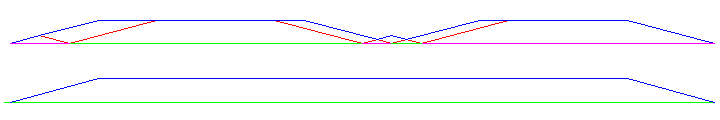

In the following figure the blue line represents the actual machine velocity. The red lines are the acceleration capability of the machine. The horizontal lines below each plot is the planned move. The upper plot shows how the trajectory planner will slow the machine down when short moves are encountered, to stay within the limits of the machines acceleration setting to be able to come to an exact stop at the end of the next move. The bottom plot shows the effect of the Naive Cam Detector to combine the moves and do a better job of keeping the velocity as planned.
1.4. Planning Moves
Make sure moves are long enough to suit your machine/material. Principally because of the rule that the machine will never move at such a speed that it cannot come to a complete stop at the end of the current movement, there is a minimum movement length that will allow the machine to keep up a requested feed rate with a given acceleration setting.
The acceleration and deceleration phase each use half the INI file MAX_ACCELERATION. In a blend that is an exact reversal, this causes the total axis acceleration to equal the INI file MAX_ACCELERATION. In other cases, the actual machine acceleration is somewhat less than the INI file acceleration.
To keep up the feed rate, the move must be longer than the distance it takes to accelerate from 0 to the desired feed rate and then stop again. Using A as 1/2 the INI file MAX_ACCELERATION and F as the feed rate in units per second, the acceleration time is ta = F/A and the acceleration distance is da = F*ta/2. The deceleration time and distance are the same, making the critical distance d = da + dd = 2 * da = F2/A.
For example, for a feed rate of 1 inch per second and an acceleration of 10 inches/sec2, the critical distance is 12/10 = 1/10 = 0.1 inches.
For a feed rate of 0.5 inch per second, the critical distance is 52/100 = 25/100 = 0.025 inches.
