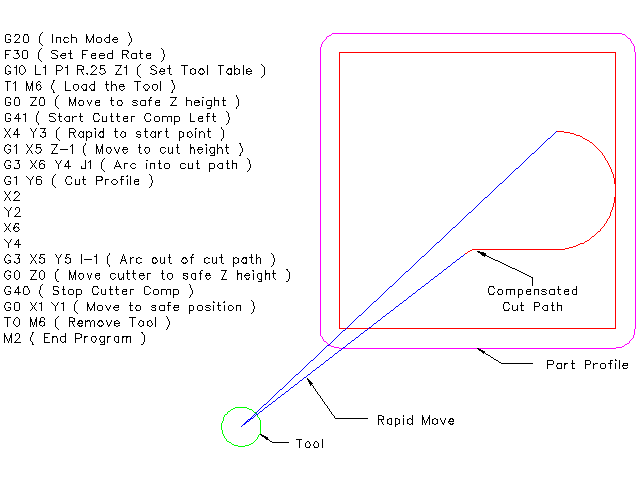

4.2.1. Outside Profile Example

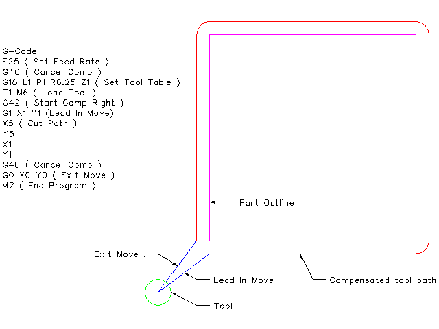

4.2.2. Inside Profile Example
