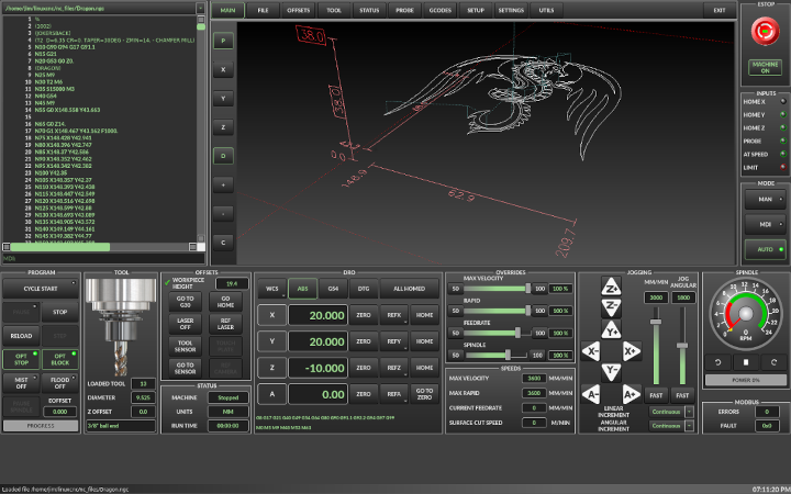

1. مقدمة
QtDragon and QtDragon_hd are built with the QtVCP framework. It is the creative vision of forum personality Persei8. Much of it is based on the excellent work of others in the LinuxCNC community. LinuxCNC’s version is adapted from Persei8’s Github versions. It is primarily meant for 3/4 axes machines such as mills or routers. It works well with a touchscreen and/or mouse. QtDragon supports multiple ways to touch off tools and probing work pieces. You can use LinuxCNC’s external offsets capability to automatically raise the spindle during a pause. If you the VersaProbe option and remap code you can add auto tool length probing at tool changes.
QtDragon and QtVCP are relatively new programs added into LinuxCNC. Bugs and oddities are possible. Please test carefully when using a dangerous machine. Please forward reports to the forum or maillist. |

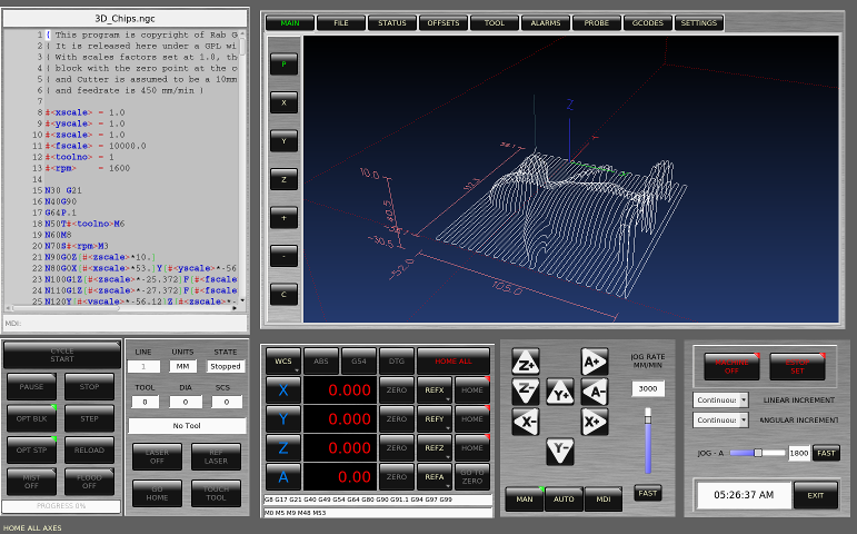

1.1. QtDragon
QtDragon is resizable from a resolution of 1280x768 to 1680x1200. It will work in window mode on any monitor with higher resolution but not on monitors with lower resolution.

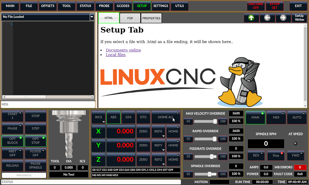

1.2. QtDragon_hd
QtDragon_hd is a similar design as QtDragon but modified to utilize the extra space of modern larger monitors. There are some small differences in layout and utility.
QtDragon_hd has a resolution of 1920x1056 and is not resizeable. It will work in window mode on any monitor with higher resolution but not on monitors with lower resolution.

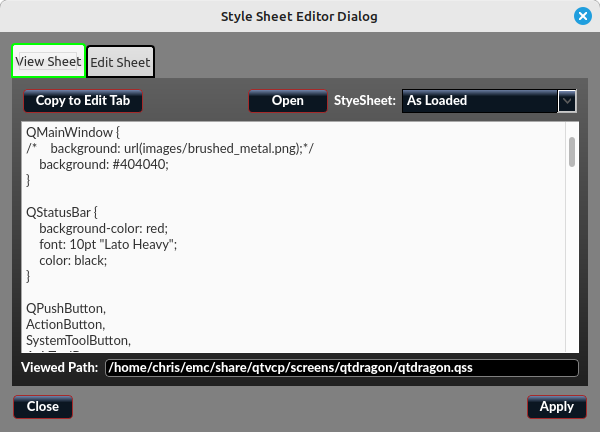

F12 - Style Editor

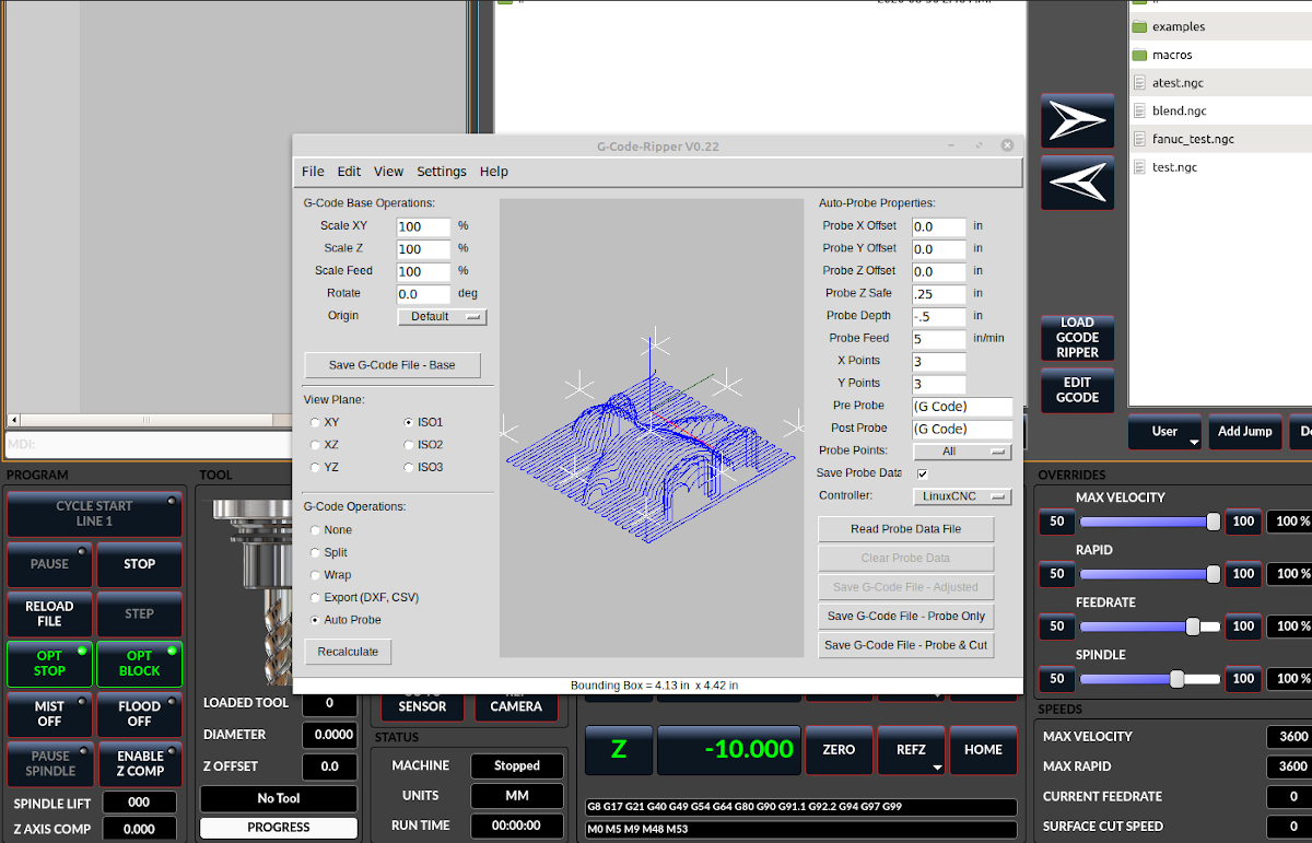

11. Z level compensation
QtDragon_hd can be set up to probe and compensate for Z level height changes by utilizing the external program G-code Ripper.
This is only available in the QtDragon_hd version. |
Z level compensation is a bed levelling/distortion correction function typically used in 3D printing or engraving. It uses a HAL non-realtime component which utilizes the external offsets feature of LinuxCNC. The component has a HAL pin that specifies an interpolation type, which must be one of cubic, linear or nearest (0, 1, 2 respectively). If none is specified or if an invalid number is specified, the default is assumed to be cubic.
When Z LEVEL COMP is enabled, the compensation component reads a probe data file, which must be called probe_points.txt. The file can be modified or updated at any time while compensation is disabled. When next enabled, the file will be reread and the compensation map is recalculated. This file is expected to be in the configuration directory.
The probe data file is generated by a probing program, which itself is generated by an external python program called gcode_ripper
, which can be launched from the file manager tab using the G-code Ripper button.
11.1. Using G-code Ripper for Z level Compensation
G-code Ripper offers many functions that we will not go in to here. This is only available in the QtDragon_hd version. |
In qtdragon_hd, switch to the file tab and press the load G-code Ripper button.
Set origin to match the origin of the G-code file to be probed.
Under G-Code Operations, check Auto Probe.
File -> Open G-Code File (The file you will run after compensation)
If necessary, make adjustments and press Recalculate.
Press Save G-Code File - Probe Only.
Save the generated file to the nc_files folder.
Exit gcode_ripper.
Without changing the offsets, run this program. Make sure the probe tool is installed. When complete, there will be a file in the config directory called probe_points.txt.
In qtdragon_hd, press the Enable Z Comp button to enable compensation. Look at the status line for indication of success or failure. Active compensation will be displayed beside the label: Z Level Comp While jogging that display should change based on the compensation component.
If you use auto raise Z to lift the spindle on pause, you must combine the two with a HAL component and feed that to LinuxCNC’s motion component. |
# load components ######################################################################## loadrt logic names=logic-and personality=0x102 addf logic-and servo-thread # load a summing component for adding spindle lift and Z compensation loadrt scaled_s32_sums addf scaled-s32-sums.0 servo-thread loadusr -Wn z_level_compensation z_level_compensation # method parameter must be one of nearest(2), linear(1), cubic (0) setp z_level_compensation.fade-height 0.0 setp z_level_compensation.method 1 # connect signals to LinuxCNC's motion component ######################################################################## net eoffset-clear axis.z.eoffset-clear net eoffset-counts axis.z.eoffset-counts setp axis.z.eoffset-scale .001 net eoffset-total axis.z.eoffset setp axis.z.eoffset-enable True # external offsets for spindle pause function ######################################################################## net eoffset-clear qtdragon.eoffset-clear net eoffset-spindle-count <= qtdragon.eoffset-spindle-count net spindle-pause qtdragon.spindle-inhibit => spindle.0.inhibit net eoffset-state qtdragon.eoffset-is-active <= motion.eoffset-active ## Z level compensation #################################################### net eoffset-clr2 z_level_compensation.clear => logic-and.in-01 net xpos-cmd z_level_compensation.x-pos <= axis.x.pos-cmd net ypos-cmd z_level_compensation.y-pos <= axis.y.pos-cmd net zpos-cmd z_level_compensation.z-pos <= axis.z.pos-cmd net z_compensation_on z_level_compensation.enable-in <= qtdragon.comp-on net eoffset-zlevel-count z_level_compensation.counts => qtdragon.eoffset-zlevel-count # add Z level and scaled spindle raise level values together net eoffset-spindle-count scaled-s32-sums.0.in0 net eoffset-zlevel-count scaled-s32-sums.0.in1 setp scaled-s32-sums.0.scale0 1000 net eoffset-counts scaled-s32-sums.0.out-s

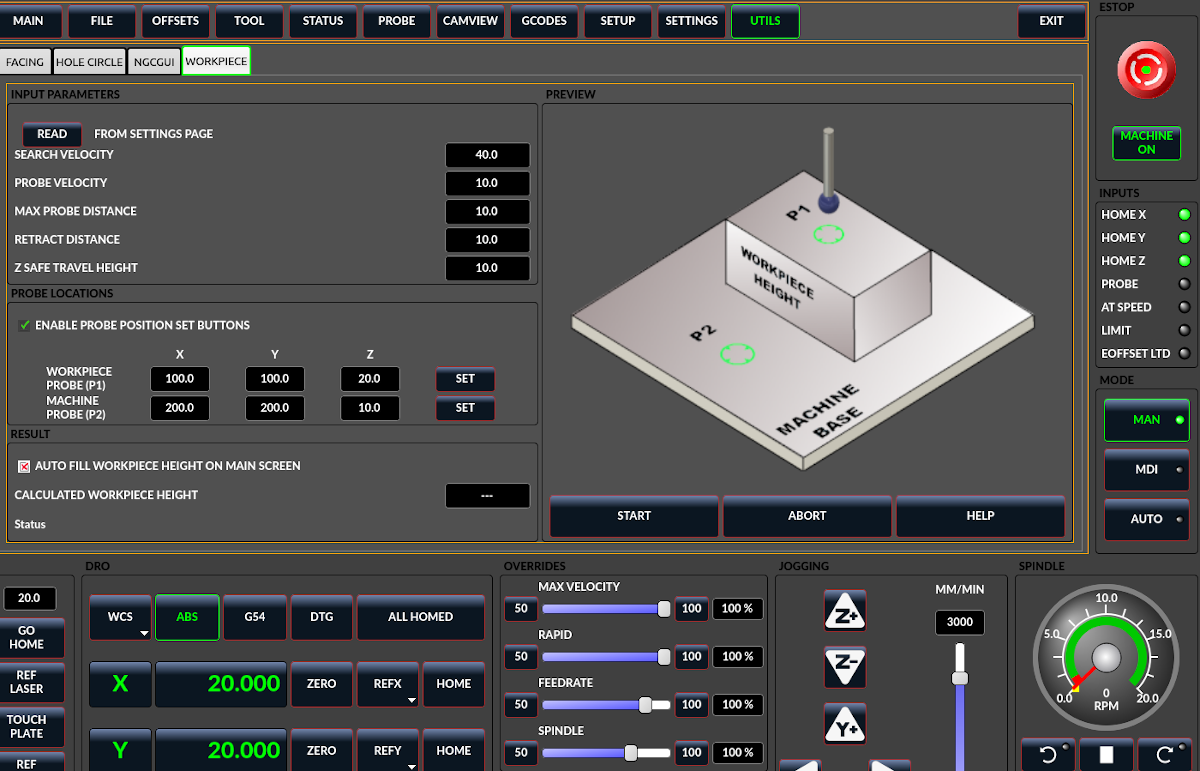

There are three toggle buttons:
- Auto Zero
This selects if after probing the relevant axis is set to zero in the current user system.
- Auto Skew
This selects if after probing, the system will be rotated or just display the calculated rotation.
- Tool Measure
This (if integrated) turns auto tool probing on and off.
12.1.1. HAL Pins
Versaprobe offers 5 output pins for tool measurement purpose and one that can be used to inhibit the spindle when the probe is loaded.

14.5. Work Piece Height Probing
This program probes 2 user specified locations in the Z axis and calculates the difference in heights.
When checked, the SET buttons are enabled.
This allows the user to automatically fill in the X, Y and Z parameters with the current position as displayed on the DROs.
When checked, the calculated height is automatically transferred to the Workpiece Height field in the main screen.
Otherwise, the main screen is not affected.
the X, Y and Z coordinates specify where the first probing routine should start, in current WCS
the X, Y and Z coordinates specify where the second probing routine should start, in current WCS
The machine is raised to the Z safe travel height before jogging to the X and Y coordinates.
The spindle then lowers to the specified Z coordinate.
It should be selected so that the tool clears all obstructions while jogging.
The machine will jog to the first location and then probe down.
The machine then jogs to the second location and probes down again.
The difference in probed values is reported as Calculated Workpiece Height.
The parameters for search velocity, probe velocity, maximum probe distance and return distance are read from the main GUI Settings page.
causes all jog and probe routines currently executing to stop.
displays this help file.
Any 2 points within the machine operating volume can be specified.
If the first point is higher than the second, the calculated height will be a positive number.
If the first point is lower than the second, the calculated height will be a negative number.
Units are irrelevant in this program. The probed values are not saved and only the difference is reported.
Setting incorrect values can lead to crashes into fixtures on the machine work surface. Initial testing with no tool and safe heights is recommended. |

17.1. Main tab
This tab displays the graphical representation of the current program. The side buttons will control the display.
User View: Select/restore a user set view of the current program.
P,X,Y,Z: Set standard views.
D: Toggle display of dimensions.
+, -: Zoom controls.
C: Clear graphics of tool movement lines.
In qtdragon_hd
there are also macro buttons available on the right side. Up to tens buttons can be defined in the INI.

You can use this tab to load or transfer programs. Editing of G-code programs can be selected from this tab. With qtdragon_hd
, this is where you can load the G-code Ripper.

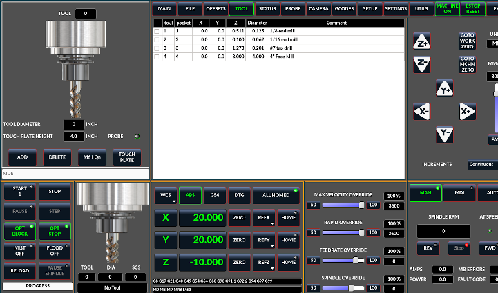

17.4. Tool Tab
You can monitor/modify tool offsets from this tab. Adding and deleting tools from the tool file can also be done from this tab. When this tab is selected the individual home buttons in the DRO area will change to tool offset setting buttons. They will return to home buttons when you select another tab. Pressing this tool button will drop down a when menu of options:
Set Current Tool Position
Adjust Current Tool Position
Zero Current Tool Position
Set Tool Offset Directly
Reset To Last

17.9. Setup Tab
It’s possible to load HTML or PDF file (.html / .pdf ending) with setup notes, and will be displayed in the setup tab.
If you load a G-code program and there is an HTML/PDF file of the same name, it will load automatically.
Some program, such as Fusion 360 and Aspire will create these files for you. You can also write your own HTML docs with the included SetUp Writer button.
There are three sub tabs:
HTML - any loaded HTML pages are displayed here. The navigation buttons work on this page.
PDF - any loaded PDF setup pages are displayed here.
PROPERTIES - when a program is loaded its G-code properties are displayed here.
There are navigation buttons for HTML page:
The up arrow returns you to the default HTML page.
The left arrow moves backward one HTML page.
The right arrow moves forward one HTML page.
If you wish to include a custom default HTML page, name it default_setup.html and place it in your configuration folder.
Custom QtVCP panels can be displayed in this tab by setting the EMBED_TAB_LOCATION option to tabWidget_setup.

18. Styles
Nearly all aspects of the GUI appearance are configurable via the QtDragon.qss stylesheet file. The file can be edited manually or through the stylesheet dialog widget in the GUI. To call up the dialog, press F12 on the main window. New styles can be applied temporarily and then saved to a new qss file, or overwrite the current qss file.

20.1. Stylesheets
Stylesheets can be leveraged to do a fair amount of customization, but you usually need to know a bit about the widget names. Pressing F12 will display a stylesheet editor dialog to load/test/save modification.
The View Sheet tab will allow you to select and apply what stylesheet QtDragon will use when it’s first loaded.
Press the button Copy to Edit Tab to copy the current stylesheet to the edit tab.
The Edit Sheet tab allows editing, applying and saving of changes od the displayed stylesheet.
Sometimes these lines will be present and you can change them, otherwise you will need to add them.
