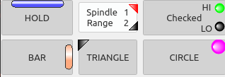

1.13. LED
- Indicator Widget
A LED like indicator that optionally follows a HAL pin’s logic.
halpin_option
Selects if the LED follows an input HAL pin or program state.
diameter
Diameter of the LED (defaults to 15).
color
Color of the LED when on (defaults to green).
off_color
Color of the LED when off (defaults to black).
gradient
turns the gradient high light on or off (defaults to on).

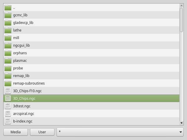

2.7. FileManager
- File Loading Selector Widget
This widget is used to select files to load.
It has a the ability to scroll the names with hardware such as a MPG.
One can class patch the function load(self,fname)
to customize file loading.
The function getCurrentSelected()
will return a Python tuple, containing the file path and whether it is a file.
temp = FILEMANAGER.getCurrentSelected() print('filepath={}'.format(temp[0])) if temp[1]: print('Is a file')
doubleClickSelection
(bool) -
Determines whether or not to require double clicking on a folder.
Single clicking a folder (False) is enabled by default and is intended for touch screen users.
The following shows an example of how to set this property:#filemanager { qproperty-doubleClickSelection: True; }
showListView
(bool) -
Determines whether or not to show the file/folder structure in list form.
Table view (False) is enabled by default.
The following shows an example of how to set this property:#filemanager { qproperty-showListView: True; }
It is based on PyQt’s FIXME

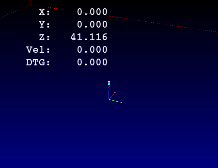

2.10. GCodeGraphics
- G-code Graphic Backplot Widget
This displays the current G-code in a graphical form.
dro-font/dro-large-font
(string) -
Sets the small and large DRO font properties
Here we reference with the widget base name; GCodeGraphics
GCodeGraphics{ qproperty-dro_font:"monospace bold 12"; } GCodeGraphics{ qproperty-dro_large_font:"Times 25"; }
_view
(string) -
Sets the default view orientation on GUI load.
Valid choices for a lathe are p, y, y2. For other screens, valid choices are p, x, y, z, z2.
The following shows an example of how to set this property (referenced using the widget user selected name):#gcodegraphics{ qproperty-_view: z; }
_dro
(bool) -
Determines whether or not to show the DRO.
The following shows an example of how to set this property:#gcodegraphics{ qproperty-_dro: False; }

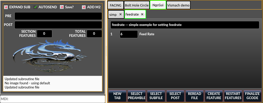

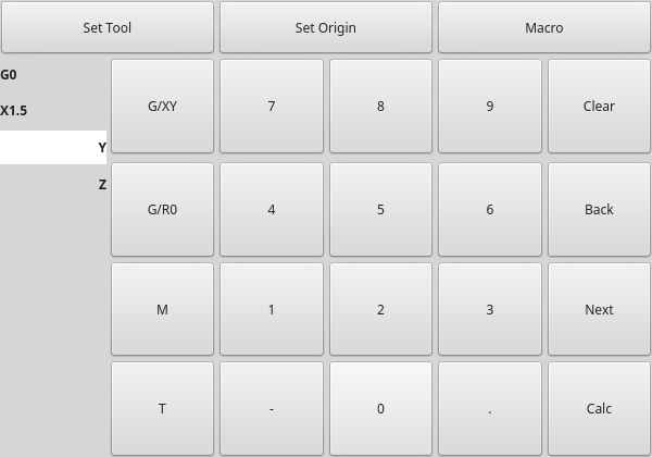

2.16. MDITouchy
- Touch Screen MDI Entry Widget
This widget displays buttons and entry lines to use for entering MDI commands.
Based on LinuxCNC’s Touchy screen’s MDI entry process, its large buttons are most useful for touch screens.
To use MDITouchy
First press one of the
G/XY
,G/RO
,M
orT
button. On the left will show the entry fields that can be filled out. -
Then press
Next
andBack
to navigate between fields. -
Calc
will pop up a calculator dialog. -
Clear
clears the current entry. -
Set Tool
will call for a tool change. -
Set Origin
will allow setting the origin of the current G6x system. -
Macro
will call any available macro ngc programs.
The widget requires an explicit call to MDITouchy Python code to actually run the MDI command:
For handler file code
If the widget was named mditouchy in Qt Designer, the command below would run the displayed MDI command:self.w.mditouchy.run_command()
For action button use
If the widget was named mditouchy in Qt Designer, use the action button’s Call Python commands option and enter:INSTANCE.mditouchy.run_command()
The macro button cycles though macros defined in the INI [DISPLAY] heading.
Add one or more MACRO
lines of the following format:
MACRO = macro_name [param1] [... paramN]
In the example below, increment
is the name of the macro, and it accepts two parameters, named xinc
and yinc
MACRO = incerment xinc yinc
Now, place the macro in a file named macro_name.ngc
in the PROGRAM_PREFIX

O<increment> sub G91 G0 X#1 Y#2 G90 O<increment> endsub
Notice the name of the sub matches the file name and macro name exactly, including case.
When you invoke the macro by pressing the Macro button you can enter values for parameters (xinc
and yinc
in our example).
These are passed to the macro as positional parameters: #1
, #2
… #N
respectively.
Parameters you leave empty are passed as value 0
If there are several different macros, press the Macro button repeatedly to cycle through them.
In this simple example, if you enter -1 for xinc and invoke the running of the MDI cycle, a rapid G0 move will be invoked, moving one unit to the left.
This macro capability is useful for edge/hole probing and other setup tasks, as well as perhaps hole milling or other simple operations that can be done from the panel without requiring specially-written G-code programs.

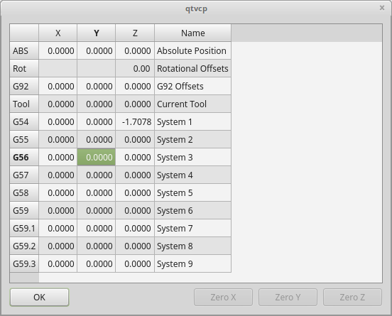

2.17. OriginOffsetView
- Origins View and Setting Widget
This widget allows one to visualize and modify User System Origin offsets directly.
It will update LinuxCNC’s Parameter file for changes made or found.
The settings can only be changed in LinuxCNC after homing and when the motion controller is idle.
The display and entry will change between metric and imperial, based on LinuxCNC’s current G20
/ G21
setting.
The current in-use user system will be highlighted.
Extra actions can be integrated to manipulate settings.
These actions depend on extra code added either to a combined widget, like originoffsetview
dialog, or the screens handler code.
Typical actions might be Clear Current User offsets or Zero X.
Clicking on the columns and rows allows one to adjust the settings.
A dialog can be made to popup for data or text entry.
The comments section will be recorded in the preference file.
It is based on PyQt’s QTableView, QAbstractTableModel, and ItemEditorFactory.
Properties, functions and styles of the PyQt base objects are always available.
OriginOffsetView
has the following properties:
dialog_code_string
Sets which dialog will pop up with numerical entry.
test_dialog_code_string
Sets which dialog will pop up with text entry.
metric_template
Metric numerical data format.
imperial_template
Imperial numerical data format.
styleCodeHighlight
Current in-use user system highlight color.
These can be set in:
Qt Designer, in
Python handler code
self.w.originoffsetview.setProperty('dialog_code','CALCULATOR') self.w.originoffsetview.setProperty('metric_template','%10.3f')
Or (if appropriate) in stylesheets
OriginOffsetView{ qproperty-styleColorHighlist: lightblue; }

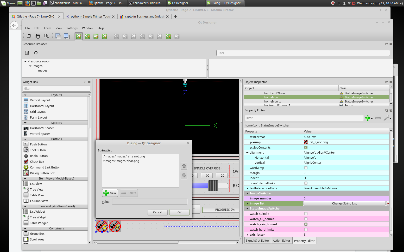

2.22. StatusImageSwitcher
- Controller Status Image Switcher
Status image switcher will switch between images based on LinuxCNC states.
watch_spindle
Toggles between 3 images:
stop
,fwd
,revs
watch_axis_homed
Toggles between 2 images:
axis not homed
,axis homed
watch_all_homed
Would toggle between 2 images:
not all homed
,all homed
watch_hard_limits
Would toggle between 2 images or one per joint.
Here is an example of using it to display an icon of Z axis homing state:
In the properties section notice that:
watch_axis_homed
is checked -
axis_letter
is set to Z
If you double click the image_list
a dialog will show and allow you to add image paths to.
If you have one image as an icon and one clear image then that will look like it shows and hides the icon.
Selecting image paths can be done by selecting the pixmap
property and selecting an image.
The pixmap setting is for test display only and will be ignored outside of Qt Designer. |
Right click the image name and you should see Copy path.
Click Copy path.
Now double click the image list property so the dialog shows.
Click the New button.
Paste the image path in the entry box.
Do that again for the next image.
Use a clear image to represent a hidden icon.
You can test the images display from the image list by changing the image number
. In this case 0
is unhomed and 1
would be homed.
This is for test display only and will be ignored outside of Qt Designer.

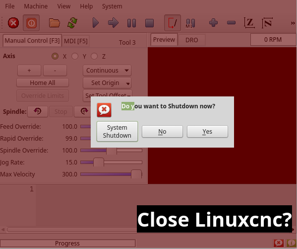

catch_close_option
Catching the close event to pop up a 'are you sure' prompt.
close_overlay_color
Color of transparent layer shown when quitting.

calculatorDialog_option
Sets up the calculator entry dialog.
calculator_overlay_color
Color of transparent layer shown when the calculator dialog is shown.

shutdown_check
(bool) -
Whether to pop a confirmation dialog.

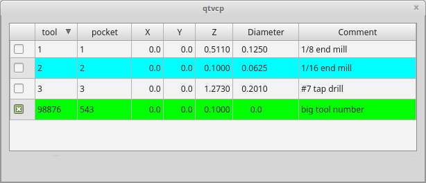

2.31. ToolOffsetView
- Tools Offsets View And Edit Widget
This widget displays and allows one to modify tools offsets.
It will update LinuxCNC’s tool table for changes made or found.
The tool settings can only be changed in LinuxCNC after homing and when the motion controller is idle.
The display and entry will change between metric and imperial based on LinuxCNC’s current G20
/G21
setting.
The current in-use tool will be highlighted, and the current selected tool will be highlighted in a different color.
The checkbox beside each tool can be used to select too for an action that depends on extra code added either to a combined widget, like the toolOffsetView
dialog or the screens handler code.
Typical actions are load selected tool, delete selected tools, etc.
The comments section will typically be displayed in the manual tool change dialog.
If using a lathe configuration, there can be columns for X and Z wear.
To use these columns to adjust the tool wear, it requires a remapped tool change routine.
ToolOffsetView
has properties that can be set in Qt Designer, in Python handler code or (if appropriate) in stylesheets:
dialog_code_string
text_dialog_code_string
metric_template
imperial_template
styleCodeHighlight
Current tool-in-use highlight color.
styleCodeSelected
Selected highlight color.
In a handler file:
self.w.tooloffsetview.setProperty('dialog_code','CALCULATOR') self.w.tooloffsetview.setProperty('metric_template','%10.3f')
and in style sheets:
ToolOffsetView{ qproperty-styleColorHighlist: lightblue; qproperty-styleColorSelected: #444; }
ToolOffsetView
has some functions useful for screen builders to add actions:
add_tool()
Adds a blank dummy tool (99) that the user can edit to suit.
delete_tools()
Deletes the currently checkbox selected tools.
get_checked_list()
Returns a list of tools selected by checkboxs.
set_all_unchecked()
Uncheck all selected tools.
self.w.tooloffsetview.add_tool() self.w.tooloffsetview.delete_tools() toolList = self.w.tooloffsetview.get_checked_list() self.w.tooloffsetview.set_all_unchecked()

# process the STATUS return message def return_value(self, w, message): rtn = message.get('RETURN') code = bool(message.get('ID') == '__test1__') name = bool(message.get('NAME') == 'ENTRY') if code and name and not rtn is None: print('Entry return value from {} = {}'.format(code, rtn))
3.1. LcncDialog
- General Message Dialog Widget
This is a general message dialog widget.
If there is a Focus Overlay widget present, it can signal it to display.
If the sound library is set up it can play sounds.
There are options that can be set when requesting a dialog, these would be added to the message dict
TITLE
Title of the dialog window.
MESSAGE
Title message text in bold.
MORE
Standard text under the heading.
DETAILS
Initial hidden text.
TYPE
(OK
|YESNO
|OKCANCEL
ICON
(QUESTION
|INFO
|CRITICAL
|WARNING
PINNAME
Not implemented yet.
FOCUSTEXT
(overlay text|None
Text to display if focus overlay is used. Use
None
for no text. -
FOCUSCOLOR
(QColor(_R, G, B, A_)
Color to use if focus overlay is used.
PLAYALERT
Sound to play if sound is available, i.e.,
SPEAK
<spoken_message> .
When using STATUS
's request-dialog
function, the default launch name is MESSAGE
It is based on PyQt’s QMessagebox.

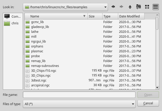

3.3. FileDialog
- Load and Save File Chooser Dialog Widget
This is used to load G-code files.
If there is a Focus Overlay widget present, it will signal it to display.
When using STATUS
's request-dialog
function, the default launch names are LOAD
or SAVE
There are options that can be set when requesting a dialog, these would be added to the message dict:
EXTENSIONS
FILENAME
DIRECTORY
An example Python call, for a load dialog:
mess = {'NAME':'LOAD','ID':'_MY_DIALOG_', 'TITLE':'Load Some text File', 'FILENAME':'~/linuxcnc/nc_files/someprogram.txt', 'EXTENSIONS':'Text Files (*.txt);;ALL Files (*.*)' } ACTION.CALL_DIALOG(mess)
And for a save dialog
mess = {'NAME':'SAVE','ID':'_MY_DIALOG_', 'TITLE':'Save Some text File', 'FILENAME':'~/linuxcnc/nc_files/someprogram.txt', 'EXTENSIONS':'Text Files (*.txt);;ALL Files (*.*)' } ACTION.CALL_DIALOG(mess)

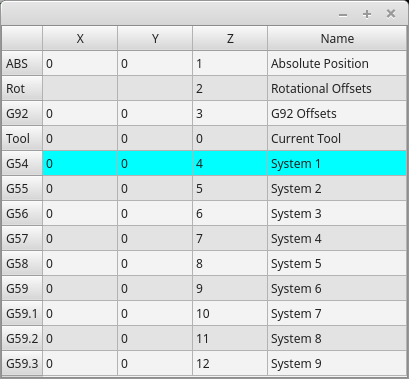

3.4. OriginOffsetDialog
- Origin Offset Setting Dialog Widget
This widget allows one to modify User System origin offsets directly in a dialog form.
If there is an Focus Overlay widget present, it will signal it to display.
When using STATUS
's request-dialog
function, the default launch name is ORIGINOFFSET
It is based on PyQt’s QDialog.

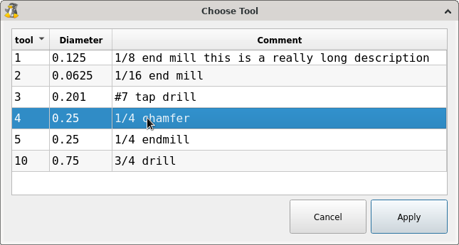

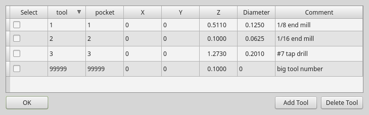

3.5. ToolOffsetDialog
- Tool Offset Setting Dialog Widget
This widget allows one to modify Tool offsets directly in a dialog form.
When using STATUS
's request-dialog
function, the default launch name is TOOLOFFSET

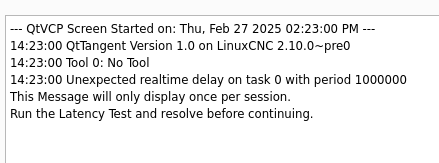

3.6. MachineLog
- Machine Events Journal Display Widget
FIXME MachineLog documentation

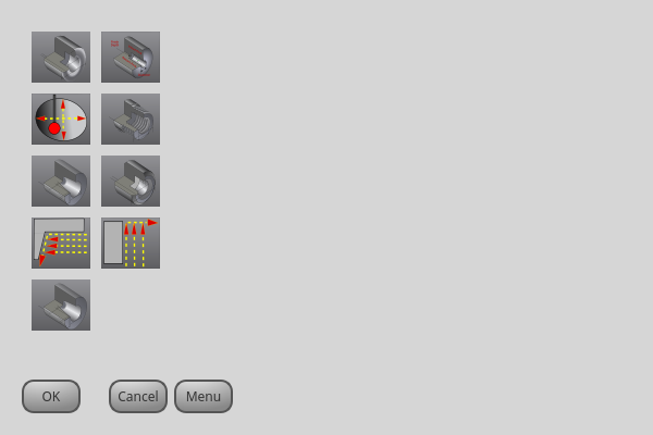

3.7. MacroTabDialog
- Macro Launch Dialog Widget
This is a dialog to display the macrotab widget.
MacroTab
displays a choice of macro programs to run using icons.
When using ``STATUS``'s request-dialog
function, the default launch name is MACROTAB

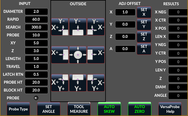

3.12. VersaProbeDialog
- Part Touch Probing Dialog Widget
This is a dialog to display a part probing screen based on Verser Probe v2.

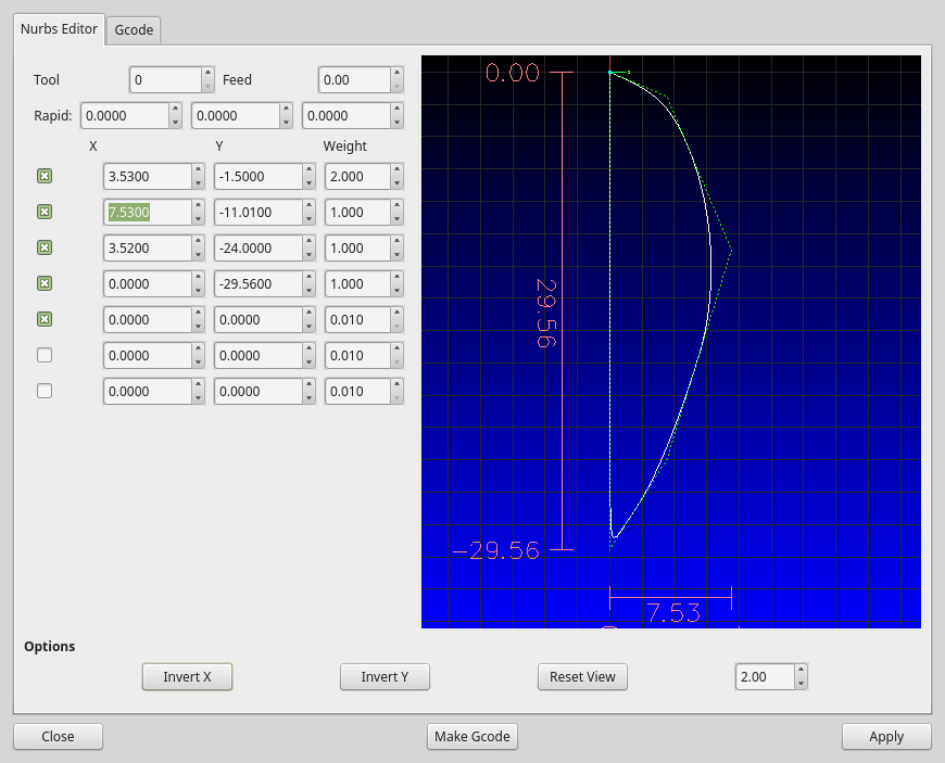

4.1. NurbsEditor
- NURBS Editing Widget
The Nurbs editor allows you to manipulate a NURBS based geometry on screen and then convert NURBS to G-code.
You can edit the G-code on screen and then send it to LinuxCNC.

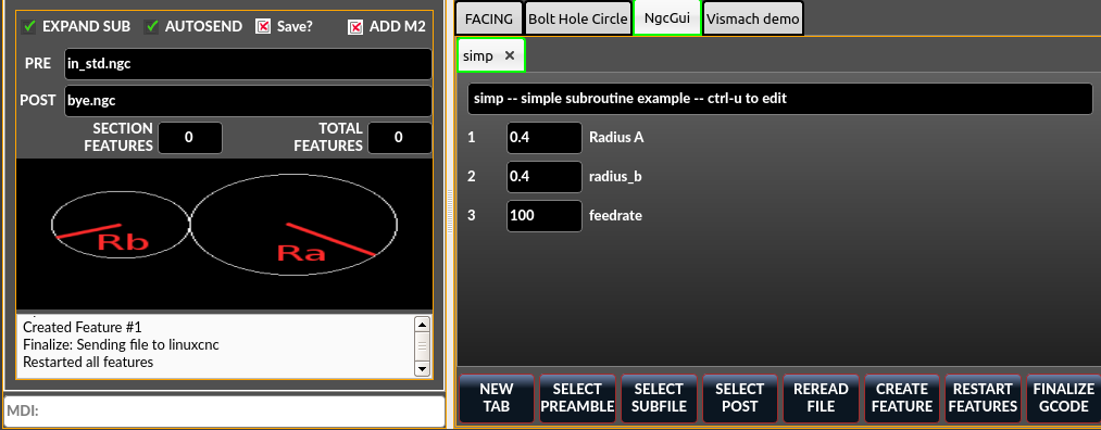

6.5. Qt NGCGUI
QtVCP’s version of NGC subroutine selector (Shown as used in QtDragon).
6.5.1. INI settings
LinuxCNC needs to know where to look to run the subroutines.
If the subroutine calls other subroutines or custom M codes, those paths must be added too.
[RS274NGC] SUBROUTINE_PATH = ~/linuxcnc/nc_files/examples/ngcgui_lib:~/linuxcnc/nc_files/examples/ngcgui_lib/utilitysubs
QtVCP needs to know where to open subroutines from.
You can also specify subroutines to be pre-opened in tabs.
[DISPLAY] # NGCGUI subroutine path. # This path must also be in [RS274NGC] SUBROUTINE_PATH NGCGUI_SUBFILE_PATH = ~/linuxcnc/nc_files/examples/ngcgui_lib # pre selected programs tabs # specify filenames only, files must be in the NGCGUI_SUBFILE_PATH NGCGUI_SUBFILE = slot.ngc NGCGUI_SUBFILE = qpocket.ngc
6.5.2. Buttons
NEW TAB - add new blank tab to NGCGUI
SELECT PREAMBLE - select a file that add preamble G-code
SELECT SUBFILE - select a NGCGUI subroutine file
SELECT POST - select a file that add post G-code
REREAD FILE - reload the subroutine file
CREATE FEATURE - add feature to the list
RESTART FEATURE - remove all features from the list
FINALIZE GCODE - create the full G-code and send it to LinuxCNC/a file
6.5.3. Adding Custom Subroutines
You can create your own subroutines for use with NGCGUI. They must follow these rules:
For creating a subroutine for use with NGCGUI, the filename and the subroutine name must be the same.
The subroutine must be in a folder within LinuxCNC’s INI designated search path.
On the first line there may be a comment of type info:
The subroutine must be surrounded by the sub and endsub tags.
The variables used must be numbered variables and must not skip number.
Comments and presets may be included.
If an image file of the same name is in the folder, it will be shown.
(info: feedrate -- simple example for setting feedrate) o<feedrate> sub #<feedrate> = #1 (= 6 Feed Rate) ; comments in brackets will be shown in ngcui f#<feedrate> o<feedrate> endsub
