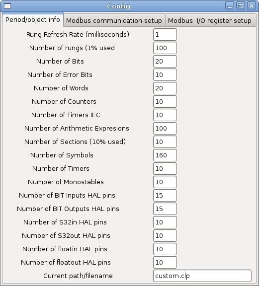

3.3. Variables
It is possible to configure the number of each type of ladder object while loading the ClassicLadder real time module. If you do not configure the number of ladder objects ClassicLadder will use the default values.
Object Name Variable Name Default Value
Number of rungs
(numRungs)
100
Number of bits
(numBits)
20
Number of word variables
(numWords)
20
Number of timers
(numTimers)
10
Number of timers IEC
(numTimersIec)
10
Number of monostables
(numMonostables)
10
Number of counters
(numCounters)
10
Number of HAL inputs bit pins
(numPhysInputs)
15
Number of HAL output bit pins
(numPhysOutputs)
15
Number of arithmetic expressions
(numArithmExpr)
50
Number of Sections
(numSections)
10
Number of Symbols
(numSymbols)
Auto
Number of S32 inputs
(numS32in)
10
Number of S32 outputs
(numS32out)
10
Number of Float inputs
(numFloatIn)
10
Number of Float outputs
(numFloatOut)
10
Objects of most interest are numPhysInputs, numPhysOutputs, numS32in, and numS32out.
Changing these numbers will change the number of HAL bit pins available. numPhysInputs and numPhysOutputs control how many HAL bit (on/off) pins are available. numS32in and numS32out control how many HAL signed integers (+- integer range) pins are available.
For example (you don’t need all of these to change just a few):
loadrt classicladder_rt numRungs=12 numBits=100 numWords=10
numTimers=10 numMonostables=10 numCounters=10 numPhysInputs=10
numPhysOutputs=10 numArithmExpr=100 numSections=4 numSymbols=200
numS32in=5 numS32out=5
To load the default number of objects:

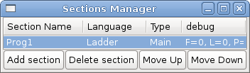

5.1. Sections Manager
When you first start up ClassicLadder you get an empty Sections Manager window.
Sections Manager Default Window
This window allows you to name, create or delete sections and choose what language that section uses. This is also how you name a subroutine for call coils.

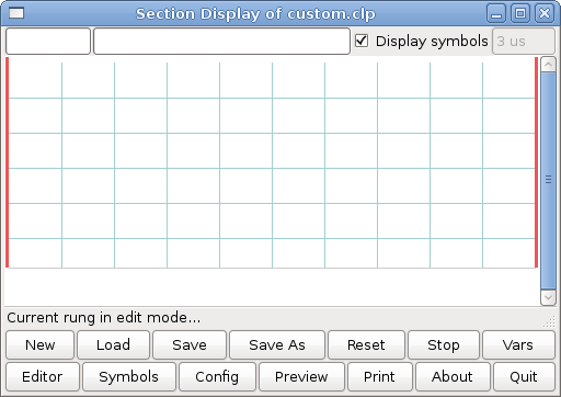

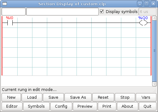

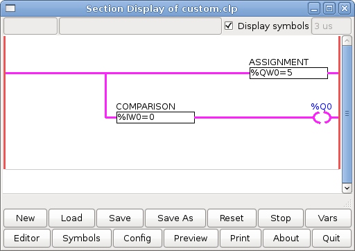

5.2. Section Display
When you first start up ClassicLadder you get an empty Section Display window. Displayed is one empty rung.
Section Display Default Window
Most of the buttons are self explanatory:
The Vars button is for looking at variables, toggle it to display one, the other, both, then none of the windows.
The Config button is used for modbus and shows the max number of ladder elements that was loaded with the real time module.
The Symbols button will display an editable list of symbols for the variables (hint you can name the inputs, outputs, coils etc).
The Quit button will shut down the non-realtime program, i.e. Modbus and the display. The realtime ladder program will still run in the background.
The check box at the top right allows you to select whether variable names or symbol names are displayed
You might notice that there is a line under the ladder program display that reads "Project failed to load…". That is the status bar that gives you info about elements of the ladder program that you click on in the display window. This status line will now display HAL signal names for variables %I, %Q and the first %W (in an equation). You might see some funny labels, such as (103) in the rungs. This is displayed (on purpose) because of an old bug- when erasing elements older versions sometimes didn’t erase the object with the right code. You might have noticed that the long horizontal connection button sometimes did not work in the older versions. This was because it looked for the free code but found something else. The number in the brackets is the unrecognized code. The ladder program will still work properly, to fix it erase the codes with the editor and save the program.

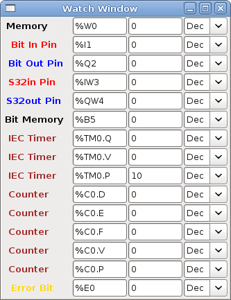

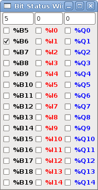

5.3. The Variable Windows
This are two variable windows: the Bit Status Window (boolean) and the Watch Window (signed integer). The Vars button is in the Section Display Window, toggle the Vars button to display one, the other, both, then none of the variable windows.
Bit Status Window
The Bit Status Window displays some of the boolean (on/off) variable data. Notice all variables start with the % sign. The %I variables represent HAL input bit pins. The %Q represents the relay coil and HAL output bit pins. The %B represents an internal relay coil or internal contact. The three edit areas at the top allow you to select what 15 variables will be displayed in each column. For instance, if the %B Variable column were 15 entries high, and you entered 5 at the top of the column, variables %B5 to %B19 would be displayed. The check boxes allow you to set and unset %B variables manually as long as the ladder program isn’t setting them as outputs. Any Bits that are set as outputs by the program when ClassicLadder is running can not be changed and will be displayed as checked if on and unchecked if off.
Watch Window
The Watch Window displays variable status. The edit box beside it is the number stored in the variable and the drop-down box beside that allow you to choose whether the number to be displayed in hex, decimal or binary. If there are symbol names defined in the symbols window for the word variables showing and the display symbols checkbox is checked in the section display window, symbol names will be displayed. To change the variable displayed, type the variable number, e.g. %W2 (if the display symbols check box is not checked) or type the symbol name (if the display symbols checkbox is checked) over an existing variable number/name and press the Enter Key.

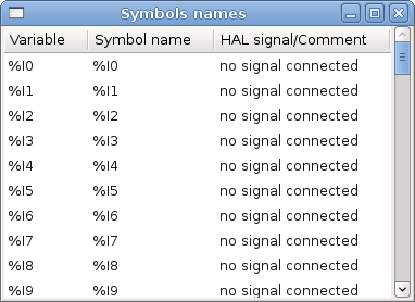

5.4. Symbol Window
Symbol Names window
This is a list of symbol names to use instead of variable names to be displayed in the section window when the display symbols check box is checked. You add the variable name (remember the % symbol and capital letters), symbol name. If the variable can have a HAL signal connected to it (%I, %Q, and %W-if you have loaded s32 pin with the real time module) then the comment section will show the current HAL signal name or lack thereof. Symbol names should be kept short to display better. Keep in mind that you can display the longer HAL signal names of %I, %Q and %W variable by clicking on them in the section window. Between the two, one should be able to keep track of what the ladder program is connected to!

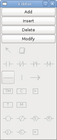

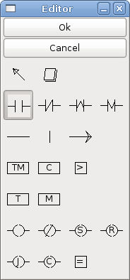

5.5. The Editor window
Editor Window
  • Add - adds a rung after the selected rung
  • Insert - inserts a rung before the selected rung
  • Delete - deletes the selected rung
  • Modify - opens the selected rung for editing
Starting from the top left image:
  • Object Selector, Eraser
  • N.O. Input, N.C. Input, Rising Edge Input, Falling Edge Input
  • Horizontal Connection, Vertical Connection, Long Horizontal Connection
  • Timer IEC Block, Counter Block, Compare Variable
  • Old Timer Block, Old Monostable Block (These have been replaced by the IEC Timer)
  • COILS - N.O. Output, N.C. Output, Set Output, Reset Output
  • Jump Coil, Call Coil, Variable Assignment
A short description of each of the buttons:
  • Selector - allows you to select existing objects and modify the information.
  • Eraser - erases an object.
  • N.O. Contact - creates a normally open contact. It can be an external HAL-pin (%I) input contact, an internal-bit coil (%B) contact or a external coil (%Q) contact. The HAL-pin input contact is closed when the HAL-pin is true. The coil contacts are closed when the corresponding coil is active (%Q2 contact closes when %Q2 coil is active).
  • N.C. Contact - creates a normally closed contact. It is the same as the N.O. contact except that the contact is open when the HAL-pin is true or the coil is active.
  • Rising Edge Contact - creates a contact that is closed when the HAL-pin goes from False to true, or the coil from not-active to active.
  • Falling Edge Contact - creates a contact that is closed when the HAL-pin goes from true to false or the coil from active to not.
  • Horizontal Connection - creates a horizontal connection to objects.
  • Vertical Connection - creates a vertical connection to horizontal lines.
  • Horizontal Running Connection - creates a horizontal connection between two objects and is a quick way to connect objects that are more than one block apart.
  • IEC Timer - creates a timer and replaces the Timer.
  • Timer - creates a Timer Module (depreciated use IEC Timer instead).
  • Monostable - creates a one-shot monostable module
  • Counter - creates a counter module.
  • Compare - creates a compare block to compare variable to values or other variables, e.g. %W1<=5 or %W1=%W2. Compare cannot be placed in the right most side of the section display.
  • Variable Assignment - creates an assignment block so you to assign values to variables, e.g. %W2=7 or %W1=%W2. ASSIGNMENT functions can only be placed at the right most side of the section display.

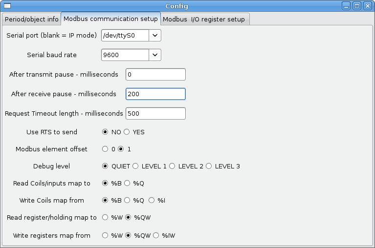

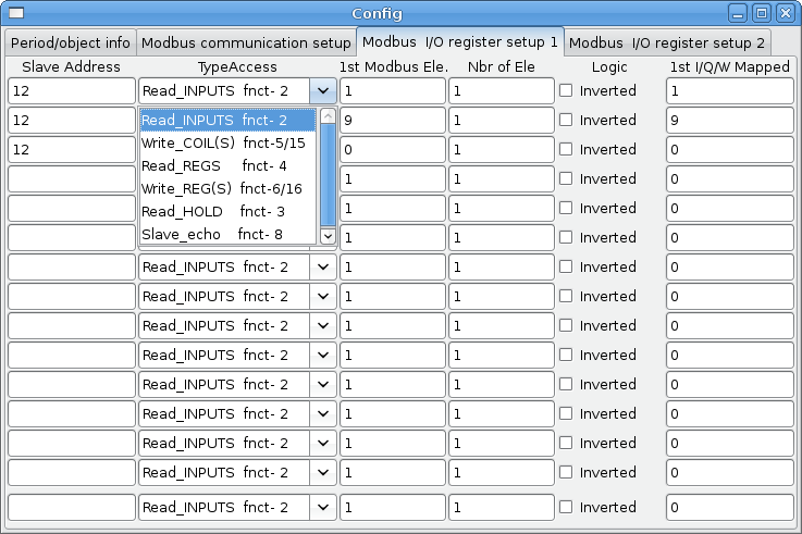

5.6. Config Window
The config window shows the current project status and has the Modbus setup tabs.
Config Window

6.7. VARIABLE ASSIGNMENT
For variable assignment, e.g. assign this number (or evaluated number) to this variable %xxx, there are two math functions MINI and MAXI that check a variable for maximum (0x80000000) and minimum values (0x07FFFFFFF) (think signed values) and keeps them from going beyond.
When a new variable assignment block is opened be sure to delete the # symbol when you enter an assignment.
To assign a value of 10 to the timer preset of IEC Timer 0 the syntax would be:
%TM0.P=10
To assign the value of 12 to s32out bit 3 the syntax would be:
%QW3=12
When you assign a value to a variable with the variable assignment block the value is retained until you assign a new value using the variable assignment block. The last value assigned will be restored when LinuxCNC is started.
The following figure shows an Assignment and a Comparison Example. %QW0 is a S32out bit and %IW0 is a S32in bit. In this case the HAL pin classicladder.0.s32out-00 will be set to a value of 5 and when the HAL pin classicladder.0.s32in-00 is 0 the HAL pin classicladder.0.out-00 will be set to True.
Assign/Compare Example
images/Assignment_Expression.png
images/Comparison_Expression.png
6.8. COILS
Coils represent relay coils. They are controlled by the variable letter and number assigned to them.
The variable letter can be B or Q and the number can be up to a three digit number, e.g., %Q3, or %B123. Q coils control HAL out pins, e.g. if %Q15 is energized then HAL pin classicladder.0.out-15 will be true. B coils are internal coils used to control program flow.
  • N.O. COIL - A relay coil: When coil is energized, then its contact that is normally open (short: N.O.) will be closed (turned on, true, etc.) and the current may pass.
  • N.C. COIL - A relay coil that inverses its contacts: When coil is energized, then its contact that is normally closed (short: N.C.) will be opened (turned off, false, etc) and the current flow is interrupted.
  • SET COIL - A relay coil with latching contacts: When coil is energized then its N.O. contact will be latched closed.
  • RESET COIL - A relay coil with latching contacts: When coil is energized then its N.O. contact will be latched open.
  • JUMP COIL - A goto coil: When coil is energized then the ladder program jumps to a rung (in the CURRENT section) - jump points are designated by a rung label. (Add rung labels in the section display, top left label box.)
  • CALL COIL - A gosub coil: When coil is energized then the program jumps to a subroutine section designated by a subroutine number - subroutines are designated SR0 to SR9 (designate them in the section manager).
If you use a N.C. contact with a N.C. coil the logic will work (when the coil is energized the contact will be closed) but that is really hard to follow!

If you go to the sections manager window hit the add section button. You can name this section, select what language it will use (ladder or sequential), and select what type (main or subroutine).
Select a subroutine number (SR0 for example). An empty section will be displayed and you can build your subroutine.
When you’ve done that, go back to the section manager and click on the your main section (default name prog1).
Now you can add a CALL COIL to your program. CALL COILs are to be placed at the rightmost position in the rung.
Remember to change the label to the subroutine number you chose before.
7. ClassicLadder Variables
These Variables are used in COMPARE or OPERATE to get information about, or change specs of, ladder objects such as changing a counter preset, or seeing if a timer is done running.
List of variables :
  • %Bxxx - Bit memory xxx (Boolean)
  • %Wxxx - Word memory xxx (32 bits signed integer)
  • %IWxxx - Word memory xxx (S32 in pin)
  • %QWxxx - Word memory xxx (S32 out pin)
  • %IFxx - Word memory xx (Float in pin) (converted to S32 in ClassicLadder)
  • %QFxx - Word memory xx (Float out pin) (converted to S32 in ClassicLadder)
  • %T`__xx__.R` - Timer xx running (Boolean, user read only)
  • %T`__xx__.D` - Timer xx done (Boolean, user read only)
  • %T`__xx__.V` - Timer xx current value (integer, user read only)
  • %T`__xx__.P` - Timer xx preset (integer)
  • %TM`__xxx__.Q` - Timer xxx done (Boolean, read write)
  • %TM`__xxx__.P` - Timer xxx preset (integer, read write)
  • %TM`__xxx__.V` - Timer xxx value (integer, read write)
  • %M`__xx__.R` - Monostable xx running (Boolean)
  • %M`__xx__.V` - Monostable xx current value (integer, user read only)
  • %M`__xx__.P` - Monostable xx preset (integer)
  • %C`__xx__.D` - Counter xx done (Boolean, user read only)
  • %C`__xx__.E` - Counter xx empty overflow (Boolean, user read only)
  • %C`__xx__.F` - Counter xx full overflow (Boolean, user read only)
  • %C`__xx__.V` - Counter xx current value (integer)
  • %C`__xx__.P` - Counter xx preset (integer)
  • %Ixxx - Physical input xxx (Boolean) (HAL input bit)
  • %Qxxx - Physical output xxx (Boolean) (HAL output bit)
  • %Xxxx - Activity of step xxx (sequential language)
  • %X`__xxx__.V` - Time of activity in seconds of step xxx (sequential language)
  • %Exx - Errors (Boolean, read write(will be overwritten))

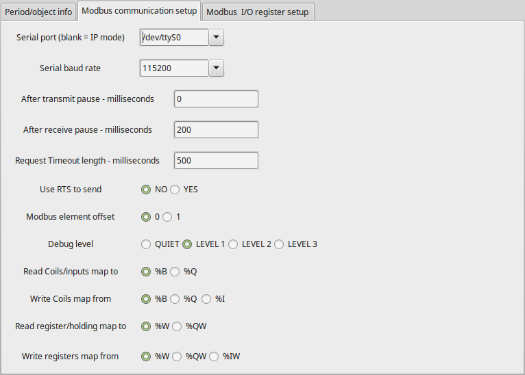

Config I/O
Config Coms
  • SERIAL PORT - For IP blank. For serial the location/name of serial driver, e.g., /dev/ttyS0 ( or /dev/ttyUSB0 for a USB-to-serial converter).
  • SERIAL SPEED - Should be set to speed the slave is set for - 300, 600, 1200, 2400, 4800, 9600, 19200, 38400, 57600, 115200 are supported.
  • PAUSE AFTER TRANSMIT - Pause (milliseconds) after transmit and before receiving answer, some devices need more time (e.g., USB-to-serial converters).
  • PAUSE INTER-FRAME - Pause (milliseconds) after receiving answer from slave. This sets the duty cycle of requests (it’s a pause for EACH request).
  • REQUEST TIMEOUT LENGTH - Length (milliseconds) of time before we decide that the slave didn’t answer.
  • MODBUS ELEMENT OFFSET - used to offset the element numbers by 1 (for manufacturers numbering differences).
  • DEBUG LEVEL - Set this to 0-3 (0 to stop printing debug info besides no-response errors).
  • READ COILS/INPUTS MAP TO - Select what variables that read coils/inputs will update. (B or Q).
  • WRITE COILS MAP TO - Select what variables that write coils will updated from (B,Q,or I).
  • READ REGISTERS/HOLDING - Select what variables that read registers will update (W or QW).
  • WRITE REGISTERS MAP TO - Select what variables that read registers will updated from (W, QW, or IW).
  • SLAVE ADDRESS - For serial the slaves ID number usually settable on the slave device (usually 1-256). For IP the slave IP address plus optionally the port number.
  • TYPE ACCESS - This selects the MODBUS function code to send to the slave (eg what type of request).
  • COILS / INPUTS - Inputs and Coils (bits) are read from/written to I, B, or Q variables (user selects).
  • REGISTERS (WORDS) - Registers (Words/Numbers) map to IW, W, or QW variables (user selects).
  • 1st MODBUS ELEMENT - The address (or register number) of the first element in a group (remember to set MODBUS ELEMENT OFFSET properly).
  • NUMBER OF ELEMENTS - The number of elements in this group.
  • LOGIC - You can invert the logic here.
  • 1st%I%Q IQ WQ MAPPED - This is the starting number of %B, %I, %Q, %W, %IW, or %QW variables that are mapped onto/from the modbus element group (starting at the first modbus element number).
In the example above: Port number - for my computer /dev/ttyS0 was my serial port.
The serial speed is set to 9600 baud.
Slave address is set to 12 (on my VFD I can set this from 1-31, meaning I can talk to 31 VFDs maximum on one system).
The first line is set up for 8 input bits starting at the first register number (register 1). So register numbers 1-8 are mapped onto ClassicLadder’s %B variables starting at %B1 and ending at %B8.
The second line is set for 2 output bits starting at the ninth register number (register 9) so register numbers 9-10 are mapped onto ClassicLadder’s %Q variables starting at %Q9 ending at %Q10.
The third line is set to write 2 registers (16 bits each) starting at the 0th register number (register 0), so register numbers 0-1 are mapped onto ClassicLadder’s %W variables starting at %W0 ending at %W1.
It’s easy to make an off-by-one error as sometimes the modbus elements are referenced starting at one rather then 0 (actually by the standard that is the way it’s supposed to be!). You can use the modbus element offset radio button to help with this.
The documents for your modbus slave device will tell you how the registers are set up- there is no standard way.
The SERIAL PORT, PORT SPEED, PAUSE, and DEBUG level are editable for changes (when you close the config window values are applied, though Radio buttons apply immediately).
To use the echo function select the echo function and add the slave number you wish to test. You don’t need to specify any variables.
The number 257 will be sent to the slave number you specified and the slave should send it back. You will need to have ClassicLadder running in a terminal to see the message.

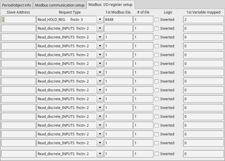

11. Debugging modbus problems
A good reference for the protocol: https://www.modbus.org/docs/Modbus_Application_Protocol_V1_1b.pdf. If you run linuxcnc/classicladder from a terminal, it will print the Modbus commands and slave responses.
Here we set ClassicLadder to request slave 1, to read holding registers (function code 3) starting at address 8448 (0x2100). We ask for 1 (2 byte wide) data element to be returned. We map it to a ClassicLadder variable starting at 2.
Config I/O Register Setting
Note in this image we have set the debug level to 1 so modbus messages are printed to the terminal. We have mapped our read and written holding registers to ClassicLadder’s %W variables so our returned data will be in %W2 as in the other image we mapped the data starting at the 2nd element.
Communication Setting
11.1. Request
Lets look at an example of reading one hold register at 8448 Decimal (0x2100 Hex).
Looking in the Modbus protocol reference:
Name number of bytes Value (hex)
Function code
(1 Byte)
3 (0x03)
Starting Address
(2 Bytes)
0 - 65535 (0x0000 to 0xFFFF)
Number of Registers
(2 Bytes)
1 to 125 (0x7D)
Checksum
(2 bytes)
Calculated automatically
Here is an example sent command as printed in the terminal (all Hex):
INFO CLASSICLADDER-   Modbus I/O module to send: Lgt=8 <-  Slave address-1  Function code-3  Data-21 0 0 1 8E 36
Meaning (Hex):
  • Lgt = 8 = message is 8 bytes long including slave number and checksum number
  • Slave number = 1 (0x1) = Slave address 1
  • Function code = 3 (0x3) = read holding register
  • Start at address = highbyte 33 (0x21) lowbyte 0 (0x00) = combined address = 8448 (0x2100)
  • Number of Registers = 1 (0x1) = return 1 2-byte register (holding and reading registers are always 2 bytes wide)
  • Checksum = high byte 0x8E lowbyte 0x36 = (0x8E36)

11.3. Data response
Looking in the Modbus protocol reference for Response:
Function code
1 Byte
3 (0x03)
Byte count
1 Byte
2 x N*
Register value
N* x 2 Bytes
returned value of requested address
Checksum
(2 bytes)
calculated automatically
*N = Number of registers
Here is an example received command as printed in the terminal (all Hex):
INFO CLASSICLADDER-   Modbus I/O module received: Lgt=7 ->   (Slave address-1  Function code-3 2 0 0 B8 44)
meaning (Hex):
  • Requested function code = 3 (0x3) = read holding register requested
  • count of byte registers = 2 (0x1) = return 2 bytes (each register value is 2 bytes wide)
  • value of highbyte = 0 (0x0) = high byte value of address 8448 (0x2100)
  • value of lowbyte = 0 (0x0) = high byte value of address 8448 (0x2100)
  • Checksum = (0xB844)
(high and low bytes are combined to create a 16 bit value and then transferred to ClassicLadder’s variable.) Read Registers can be mapped to %W or %QW (internal memory or HAL out pins). Write registers can be mapped from %W, %QW or %IW (internal memory, HAL out pins or HAL in pins). The variable number will start at the number entered in the modbus I/O registry setup page’s column: First variable mapped. If multiple registers are requested in one read/write then the variable number are sequential after the first one.

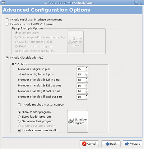

12. Setting up ClassicLadder
In this section we will cover the steps needed to add ClassicLadder to a StepConf Wizard generated config. On the advanced Configuration Options page of StepConf Wizard check off "Include ClassicLadder PLC".
Stepconf ClassicLadder
12.1. Add the Modules
If you used the StepConf Wizard to add ClassicLadder you can skip this step.
To manually add ClassicLadder you must first add the modules. This is done by adding a couple of lines to the custom.hal file.

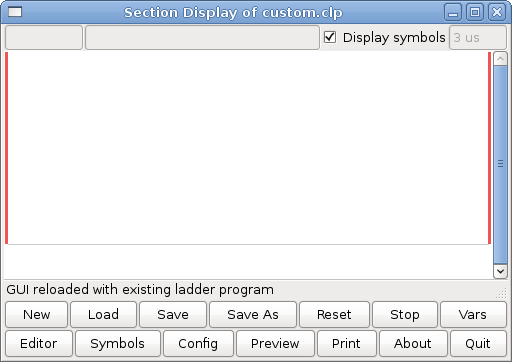

12.2. Adding Ladder Logic
Now start up your config and select "File/Ladder Editor" to open up the ClassicLadder GUI. You should see a blank Section Display and Sections Manager window as shown above. In the Section Display window open the Editor. In the Editor window select Modify. Now a Properties window pops up and the Section Display shows a grid. The grid is one rung of ladder. The rung can contain branches. A simple rung has one input, a connector line and one output. A rung can have up to six horizontal branches. While it is possible to have more than one circuit in a run the results are not predictable.
Section Display with Grid

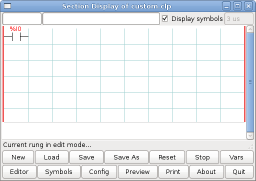

Now click on the N.O. input in the Editor Window.
Editor Window
Now click in the upper left grid to place the N.O. Input into the ladder.
Section Display with Input

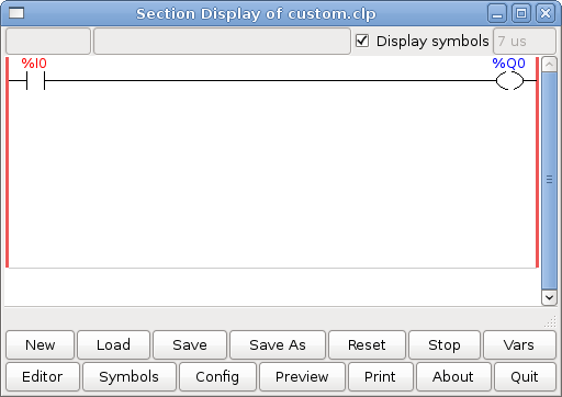

Repeat the above steps to add a N.O. output to the upper right grid and use the Horizontal Connection to connect the two. It should look like the following. If not, use the Eraser to remove unwanted sections.
Section Display with Rung
Now click on the OK button in the Editor window. Now your Section Display should look like this:

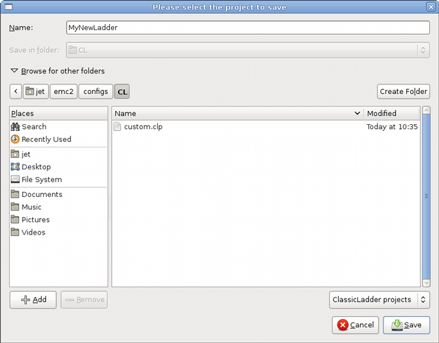

Section Display Finished
To save the new file select Save As and give it a name. The .clp extension will be added automatically. It should default to the running config directory as the place to save it.
Save As Dialog
