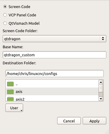

1.1. copy
Used for copying QtVCP’s builtin Screens/VCP Panels/QtVismach code to a folder so one can customize it.
In a terminal run:
qtvcp copy
![QtVCP copy Dialog - Screen, Panel or Vismach Code Copy Panel](images/qtvcp_copy_dialog.png)

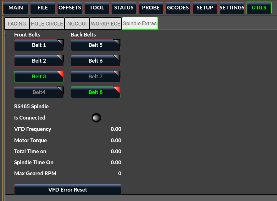

1.2. spindle_belts
This panel is designed to display additional RS485 VFD data and also to configure a 4 sheave, 2 belt spindle drive via a series of buttons.
![QtVCP spindle_belts Panel - Spindle Belts VCP](images/qtvcp_spindle_belts.png)
In addition, it is also a useful template to use for your custom panel because it includes:
Display of additional HAL data
Buttons and button groups
Dynamic changes to button enabled/disabled state based on the state of other buttons
Saving data to the qtdragon.prefs file
Custom button to reset the VFD
Modify this panel to suit your own requirements. Most common features are used. The advantage of using panels is that it separates your custom display code from the qtdragon core code so upgrading the system will not break your customization.
1.2.1. Additional Requirements
A spindle drive (for instance VFDMOD)
A custom component that scales the VFD frequency to obtain the desired spindle speed.
A belt driven spindle that uses two belts and an intermediate idler pulley much like a drill press.
Connect the input pins qtdragon.belts.<pin-name> in your postgui HAL file.
1.2.2. Function
The belts are broken into two button groups, the front belts and the rear belts. These are numbered as per the plate on the machine. Buttons in a group are mutually exclusive, i.e., only one can be selected in the group.
Additionally, it’s not possible to have both belts on the same level with this kind of mechanism because you cannot fit two belts to the one idler pulley sheave. So if a belt is selected, its opposite button is disabled. E.g., if belt 3 is selected, belt 7 is disabled.
1.2.3. Embedding commands
Add these lines to the [DISPLAY] section in your .ini file
The example tab_location is for the QtDragon screen.
EMBED_TAB_NAME=Spindle Extras
EMBED_TAB_COMMAND=qtvcp spindle_belts
EMBED_TAB_LOCATION=tabWidget_utilities
Here is how to load spindle_belt
from a HAL script:
loadusr qtvcp spindle_belts

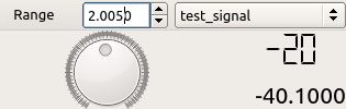

1.3. test_dial
This panel has a dial that adjusts S32 and Float HAL output pins.
The dial’s range can be adjusted from a drop down menu.
The output can be scaled with the
spinbox
A
combobox
can be used to automatically select and connect to a signal.
loadusr qtvcp test_dial
![QtVCP test_dial Panel - Test Dial VCP](images/qtvcp_test_dial.png)

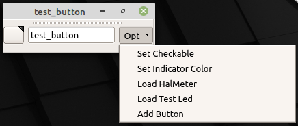

1.4. test_button
This panel has a button that will set a HAL pin.
The button can be selected as a momentary or a toggle button.
A HAL pin will be created that follows the button state
The button’s indicator color can be adjusted from a drop down menu.
A HAL pin or signal can be selected to follow the button state
You can add more buttons from the drop down menu.
You can load a Halmeter from the drop down menu.
You can load a test LED from the drop down menu.
The button can be detached from the main windows.
Here is how to load test_button
from a HAL script:
loadusr qtvcp test_button loadusr qtvcp -o 4 test_button
The -o
switch sets how many buttons the panel starts with.
If loading directly from a terminal omit the loadusr

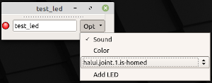

1.5. test_led
This panel has an LED that can selected to watch HAL bit pins/signals.
The LED’s color can be adjusted from a drop down menu.
The text box and state can be output as speech if sound is selected.
A
combobox
can be used to automatically select and connect to a pin/signal. -
You can add more LEDs from the drop down menu.
The LED can be detached from the main windows.
Here is how to load test_led
from a HAL script:
loadusr qtvcp test_led loadusr qtvcp -o 4 test_led
The -o
switch sets how many LEDs the panel starts with.
If loading directly from a terminal omit the loadusr.

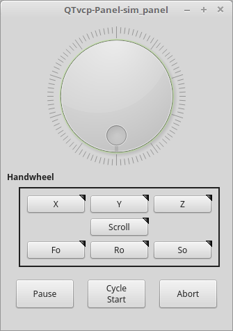

1.8. sim_panel
Small control panel to simulate MPG jogging controls etc for simulated configurations.
The MPG, selection buttons and control buttons export HAL pins to connect to linuxcnc.
The selection and control group boxes can be hidden if not needed by using the -o hide= option.
groupBoxControl and groupBoxSelection are the widget names that can be hidden.
If you want to hide both, use a comma between them with no spaces.
The -a option will make the panel always-on-top of all windows.
loadusr qtvcp sim_panel
Here we load the panel with no MPG selection buttons and the always-on-top option.
loadusr qtvcp -a -o hide=groupBoxSelection sim_panel

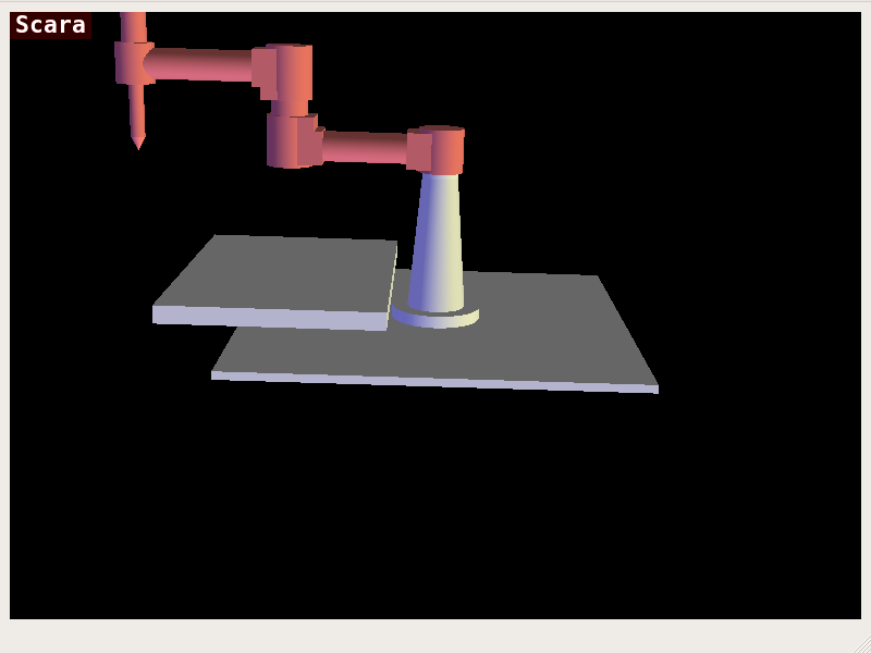

2.3. QtVCP vismach_scara
3D OpenGL view of a SCARA based milling machine.
loadusr qtvcp vismach_scara
![QtVCP vismach_scara - SCARA Mill 3D View Panel](images/qtvismach_scara.png)

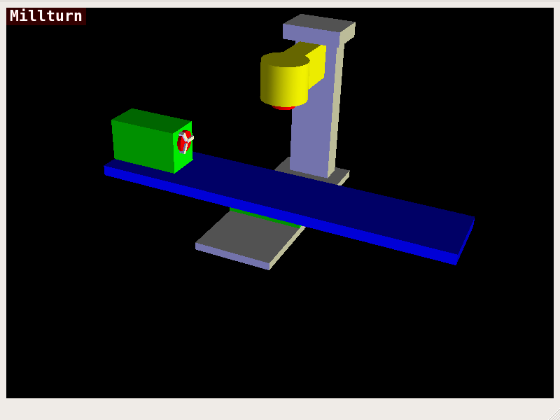

2.4. QtVCP vismach_millturn
3D OpenGL view of a 3-Axis milling machine with an A axis/spindle.
loadusr qtvcp vismach_millturn
![QtVCP vismach_millturn - 4 Axis MillTurn 3D View Panel](images/qtvismach_millturn.png)

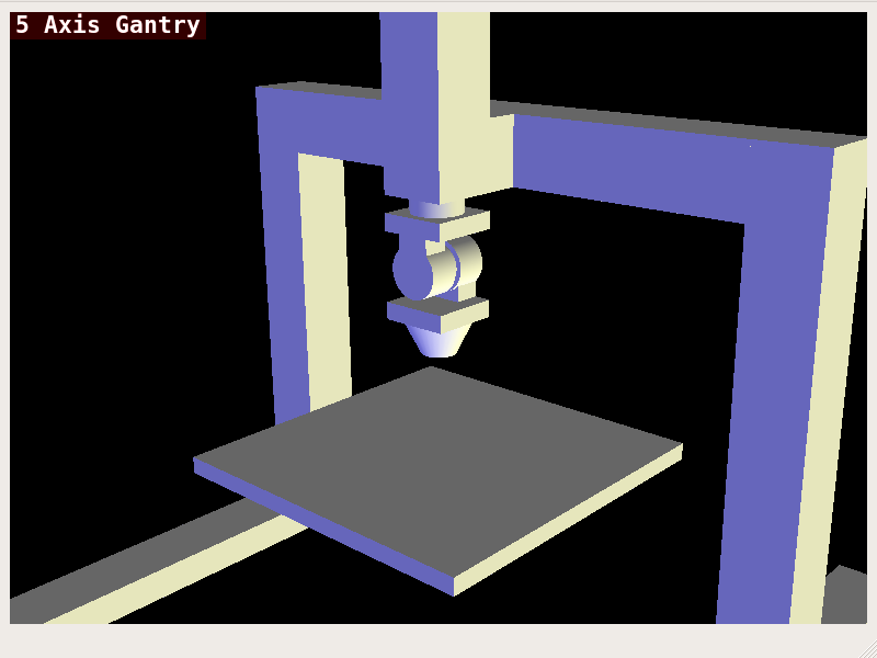

2.5. QtVCP vismach_mill_5axis_gantry
3D OpenGL view of a 5-Axis gantry type milling machine.
loadusr qtvcp vismach_mill_5axis_gantry
![QtVCP vismach_mill_5axis_gantry - 5-Axis Gantry Mill 3D View Panel](images/qtvismach_5axis_gantry.png)

4.6. Handler Patching - Subclassing Builtin Panels
We can have QtVCP load a subclassed version of the standard handler file. in that file we can manipulate the original functions or add new ones.
Subclassing just means our handler file first loads the original handler file and adds our new code on top of it - so a patch of changes.
This is useful for changing/adding behaviour while still retaining standard handler updates from LinuxCNC repositories.
You may still need to use the handler copy dialog to copy the original handler file to decide how to patch it.
There should be a folder in the config folder; for panel: named <CONFIG FOLDER>/qtvcp/panels/<PANEL NAME>/
add the handle patch file there, named like so <ORIGINAL PANEL NAME>_handler.py,
i.e. for cam_align the file would be called cam_align_handler.py.
Here is a sample to change the circle color in cam_align:
import sys import os import importlib from PyQt5.QtCore import Qt from qtvcp.core import Path PATH = Path() # get reference to original handler file so we can subclass it sys.path.insert(0, PATH.PANELDIR) panel = os.path.splitext(os.path.basename(os.path.basename(__file__)))[0] base = panel.replace('_handler','') module = "{}.{}".format(base,panel) mod = importlib.import_module(module, PATH.PANELDIR) sys.path.remove(PATH.PANELDIR) HandlerClass = mod.HandlerClass # return our subclassed handler object to Qtvcp def get_handlers(halcomp, widgets, paths): return [UserHandlerClass(halcomp, widgets, paths)] # subclassed from HandlerClass which was imported above class UserHandlerClass(HandlerClass): print('Custom subclassed panel handler loaded\n') def initialized__(self): # call original handler initialized function super().initialized__() # add our customization self.w.camview.circle_color = Qt.green
